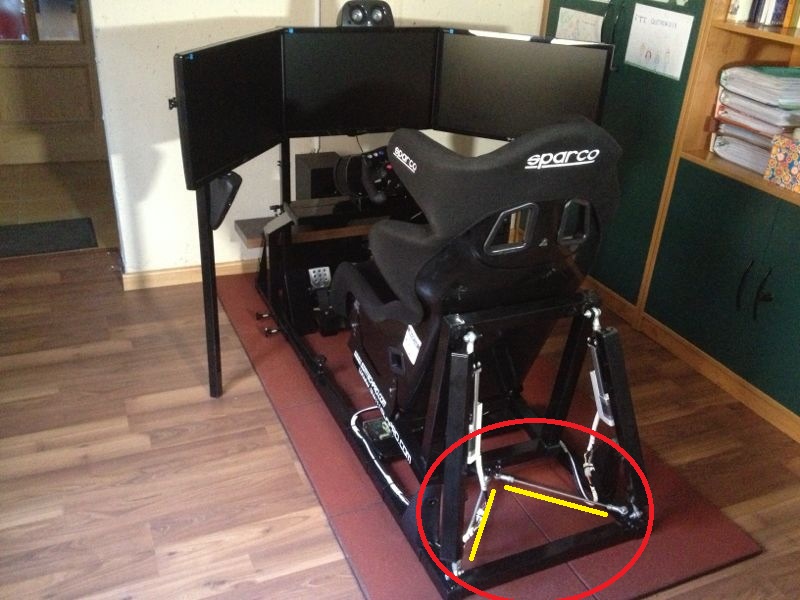

    I will start out with a 2 dof seat mover and see where it ends, but there is one thing that I can't really find the answer for: why not use a cv joint?
    I have tried mounting it to a plate and for me it looks like it is moving in just the same way as a u-joint. Being from Denmark where most cars are fwd,it is way easier to find a cv.

    Many CV joint allow lateral rotation and if used require additional panhard style control rods to prevent unwanted twist of the motion sim. A uni joint prevents lateral twist so is a far simpler solution.
    It is worth hunting around and finding an old car to get the tailshaft and uni joint, just cut it to the suitable length, mounting the uni joint as close to the seat base as possible.

    From what have read a cv will work ok but you can have a small amount of twist in your motion and u might need to address that if you want the best feel.

    I have tried twisting it, but there doesn't seem to be any rotation, but maybe it will show up when mounted?

    there are Cv joints that doesn´t twist but if It does you can put one or two edge rod like in the picture and solved 2wnw9ps.jpg

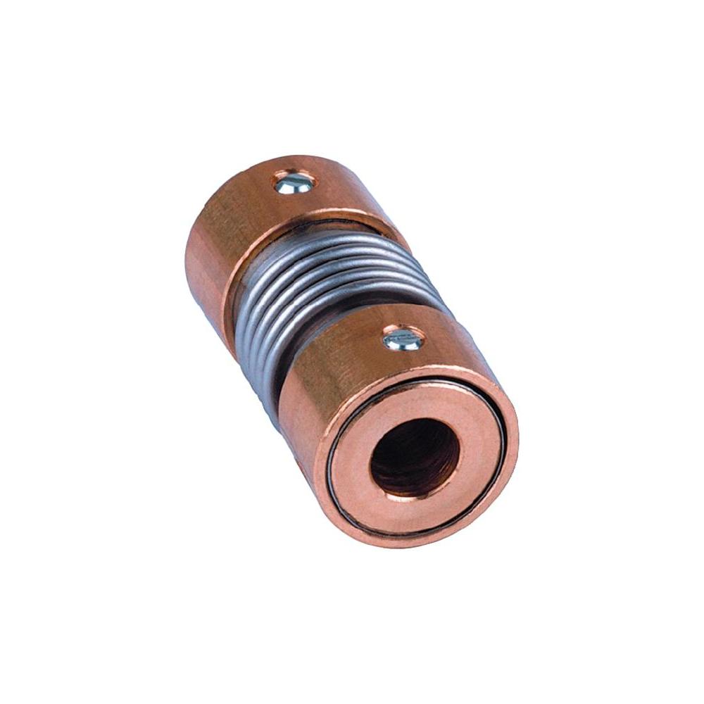

    I have a doubt about flexible coupling. that flexiblity doesn´t interfere in the precision of the movement?

    I mean, it isn´t better something like this? or is there another advantage i didn´t know on flexible couples? rigid.jpg

    Do not use a solid coupling, the slightest misalignment can cause damage. A Flexible coupling maintains precise movement and also provides misalignment protection.

    Thanks, I think I will use a piece of rubber hose as a coupler :)

    a piece of hose is NOT a flex coupler. a hose can actually build up some "twist" as the motor's move and overshoot its position every time. (Not suggested)
    Flex couplers are a couple bucks a piece. (when you search)...I Highly suggest buying the right parts once VS buying thing's twice you "think" will work.
