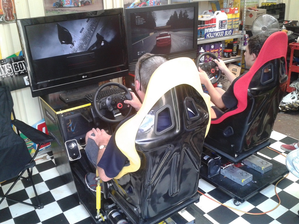

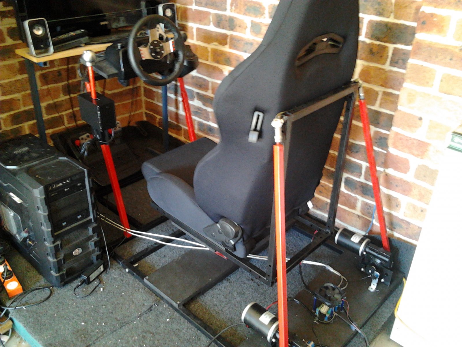

    @GIB SimRacing , theres probably a zillion variations for 2 DOF seat mover, most popular is the shoulder mount motors at rear.
    Or the desk racer design
    have a dig through the threads and see what takes your fancy
    Pots for JRK are 5kohm recommended, preferably single turn 360 deg pots, so they dont break if you go past or the motors go haywire and spin over during set up

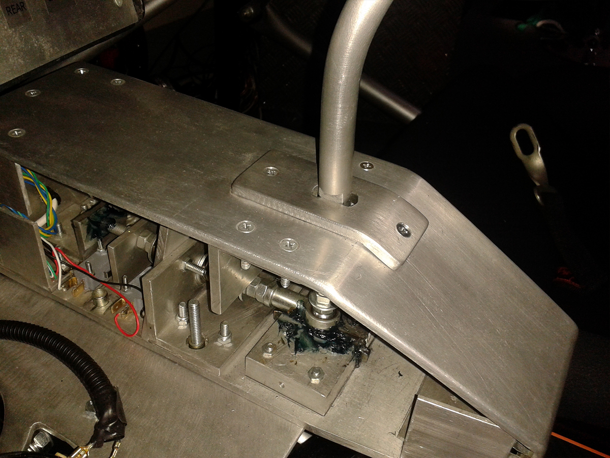

    Here is a DIY sequential shifter I built a while back.
    The reason I made this shifter was because I wanted a very mechanical feel to my gear changes. I used the stock G25 shifter before and while it was working without any issues, it always felt a bit like a toy.
    So, something more "chunky" was needed.:)
    This is an all aluminium build except for the nuts and bolts.
    The golden coloured bolt at the top is a high tensile bolt.
    At the bottom of the gear lever, between the 2 alu blocks, there are 2 spring loaded steel balls to provide a bit of resistance and a bit of a "clunk" when changing gears. Works really well.
    It might look a bit complicated and I'm sure the same result can be achieved a lot easier but, this wasn't too hard and a lot of fun to build.
    Unfortunately I did not take any photos during the build of this project. But any questions, just ask.:)

    Back to making desk racer seat movers, if thats the way you are thinking, use 60:1 boxes on the motors. Then you have the extra power needed for larger drivers. Like up to 140kg Id guess. I can do 120kg on mine, but thats the limit really. I will eventually re-gearbox my dual racers in time, but the seat is a squeeze for anyone over 120kg anyway.
    Cheers, David.
