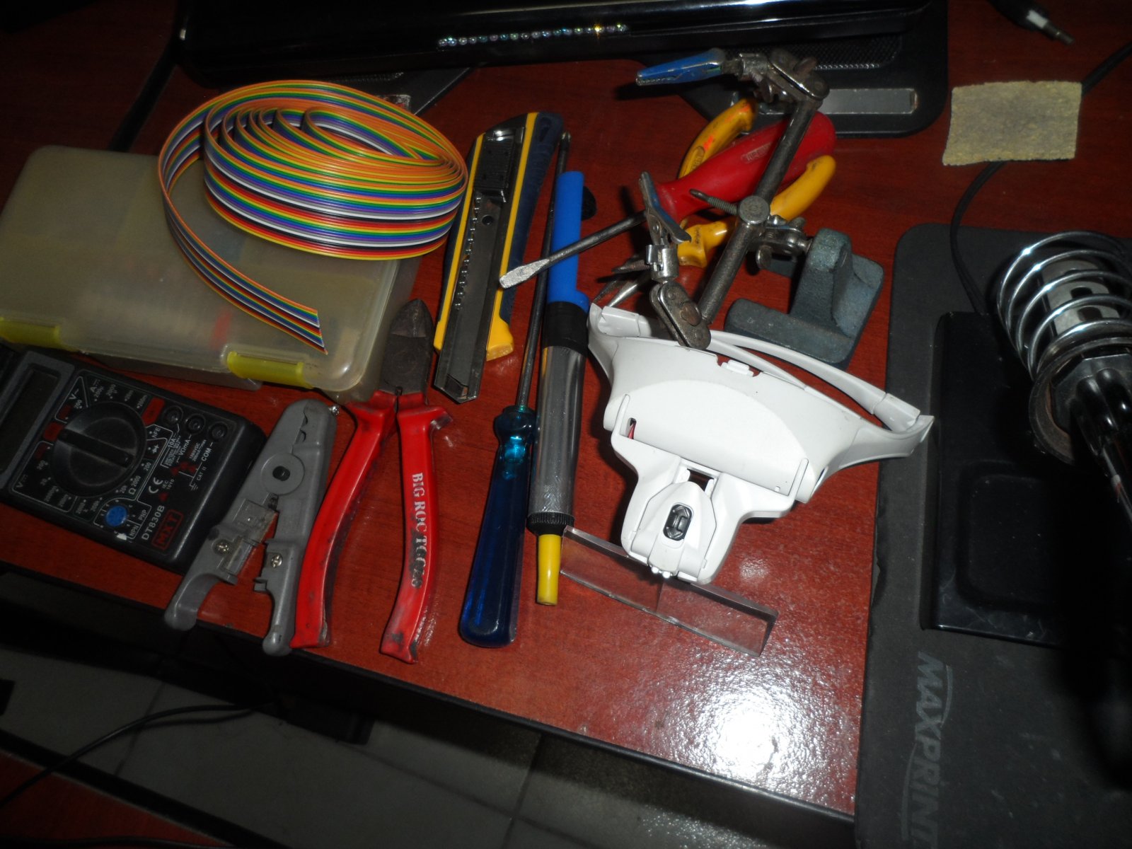

    things you must learn.
    a bit the arduino
    welding for wires and also steel tubes.
    cut metals. ( with safety)
    search before ask ( rsrrss)
    network, software,race games and hardware. ahhh sorry, writing english too... (my problem)
    this last i dont no well.
    reading without stop, archives posted by racingmatt, until understand.
    then i started building.
    the first MOTOMONSTER ARRIVED DEAD. ( i dont know, at moment)
    AND...NOW ? ARDUINO TROUBLES ? WIRING ? MONSTER CHINA ? ARDUINO CODE ? WELDINGS
    NO ! ONLY MONSTERMOTO china...
    I BOUGHT ANOTHER, and this resolved.

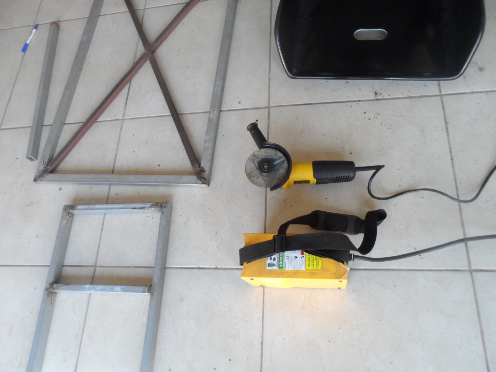

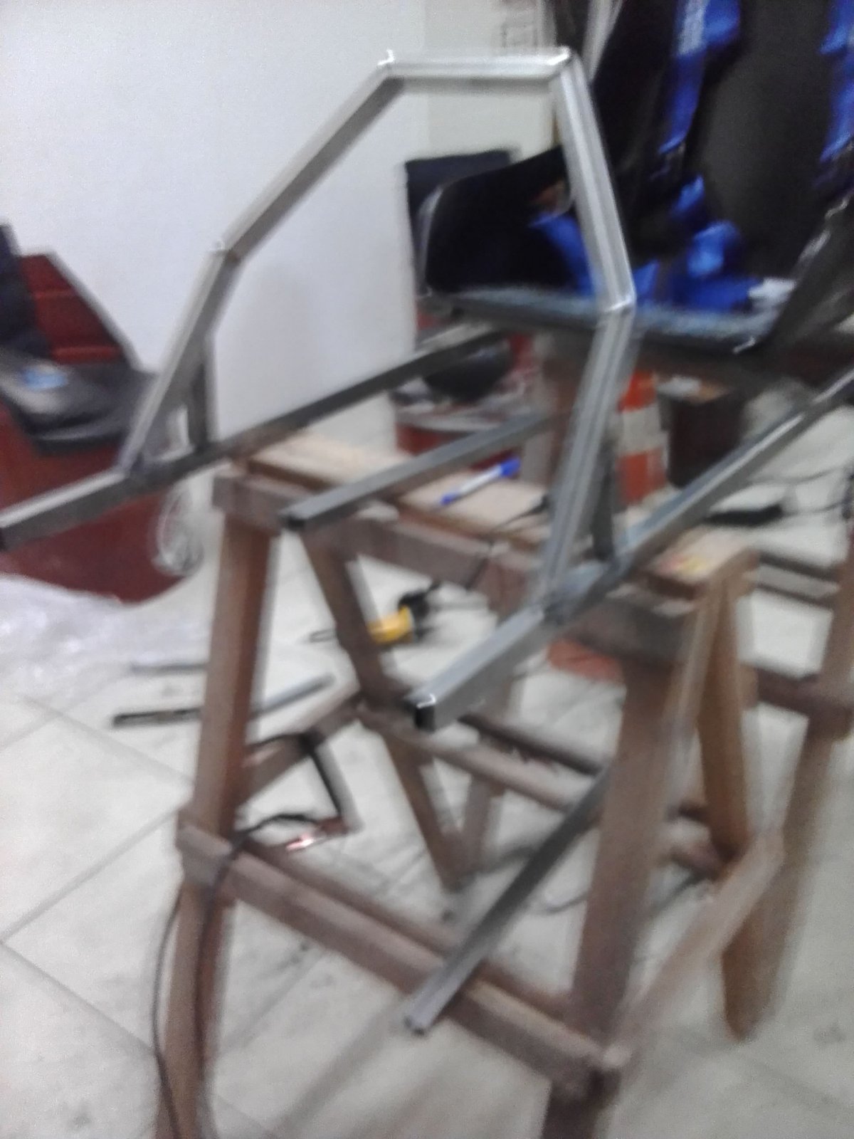

    I bought the seat.
    the steel tubes.
    welding machine.
    cutting metals machine .
    and hands on work.
    Then, is not DIY ?
    learn
    learn
    all days learning.

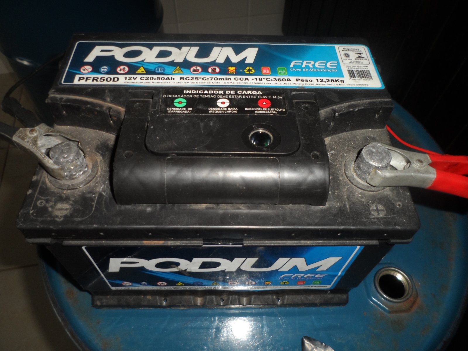

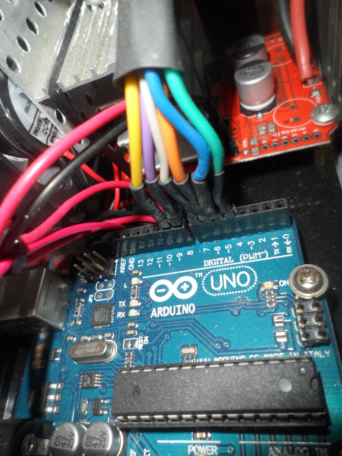

    things you need...

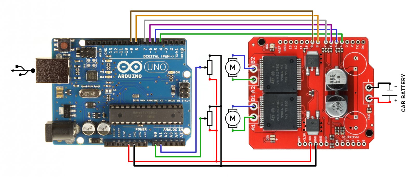

    a batery
    welding the base

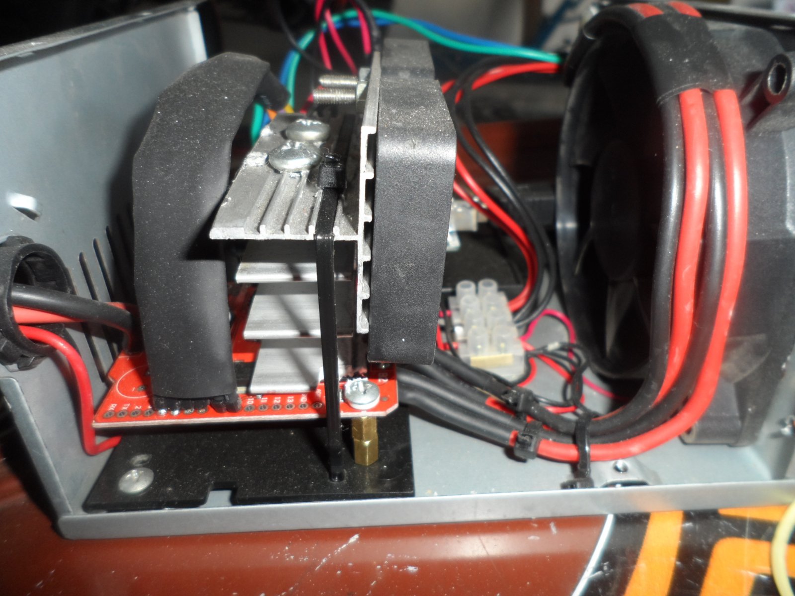

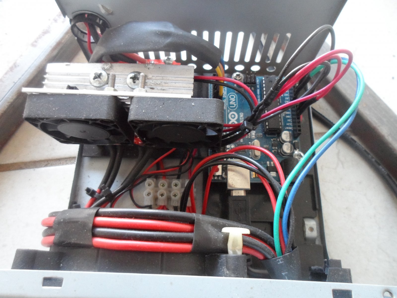

    schematic Arduino Monstermoto used
    final mount arduino + Monstermoto

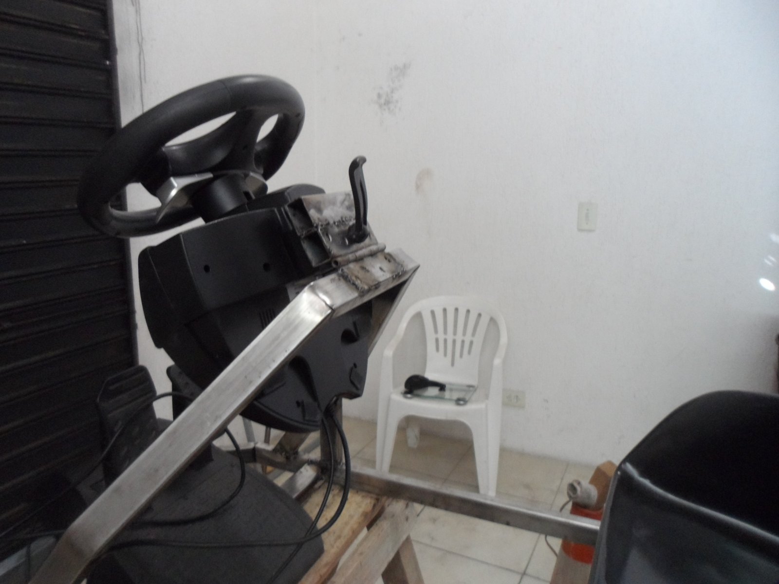

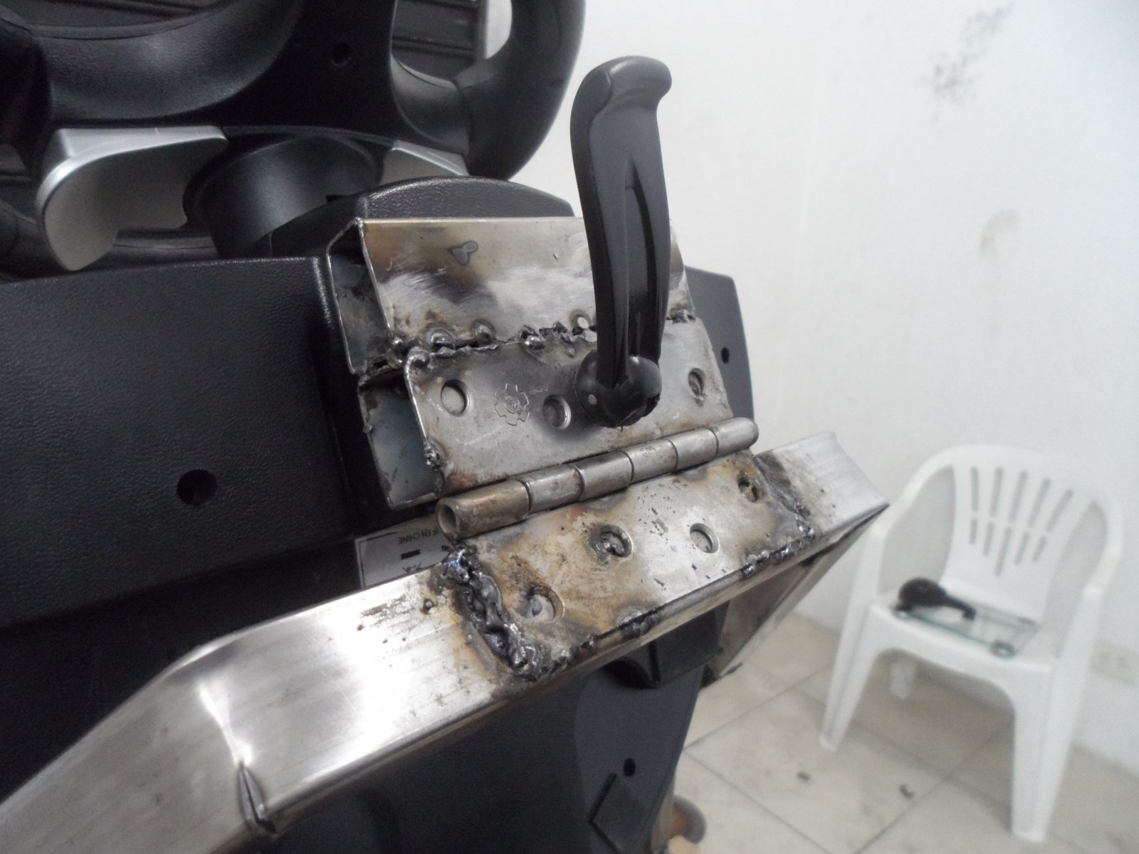

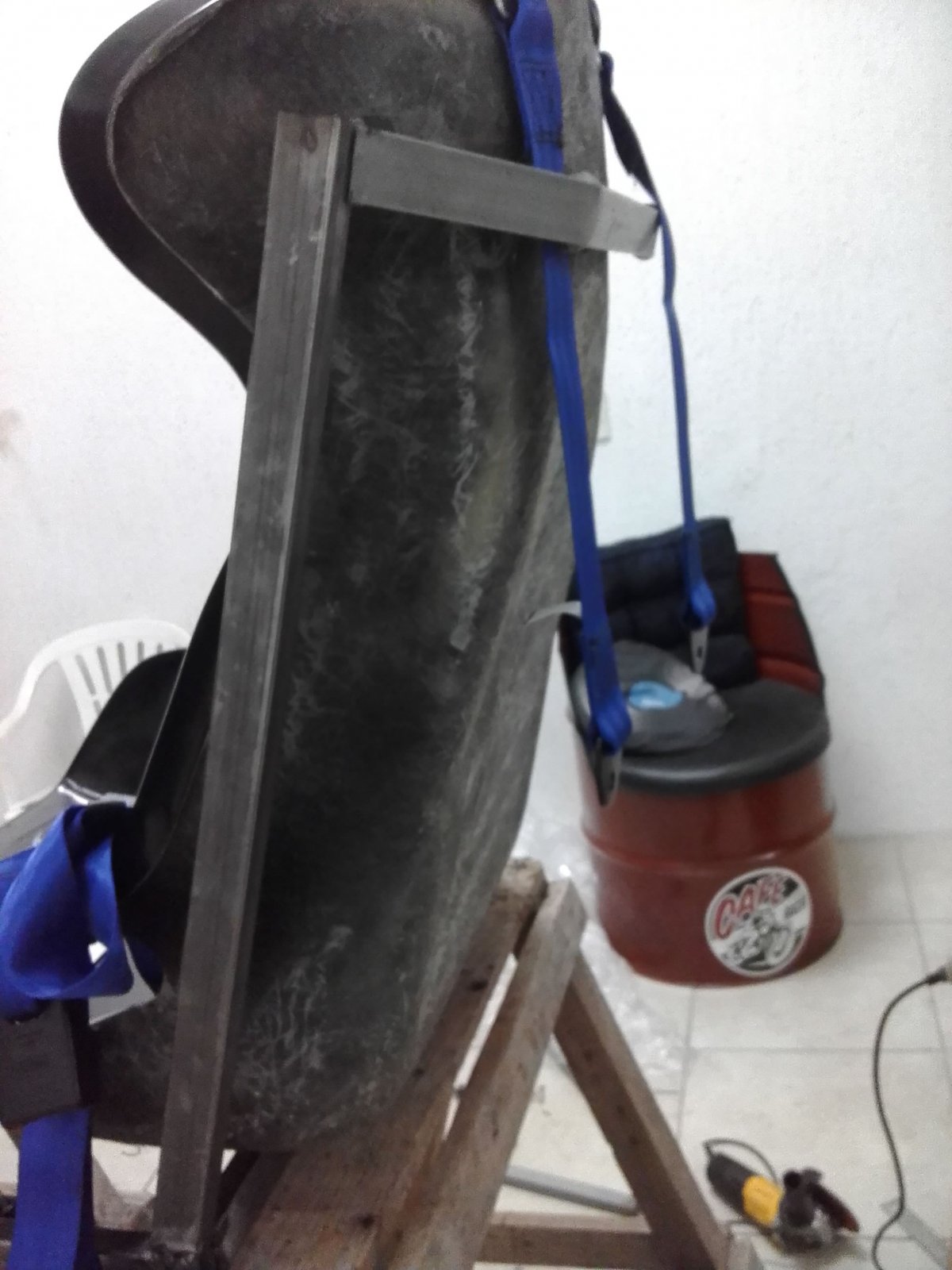

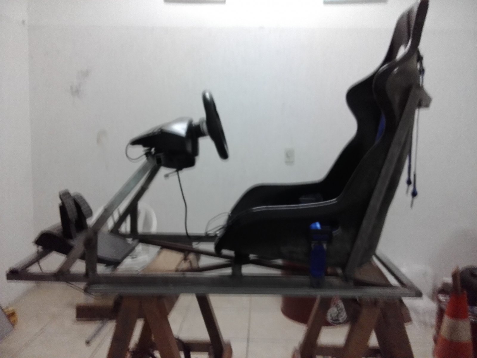

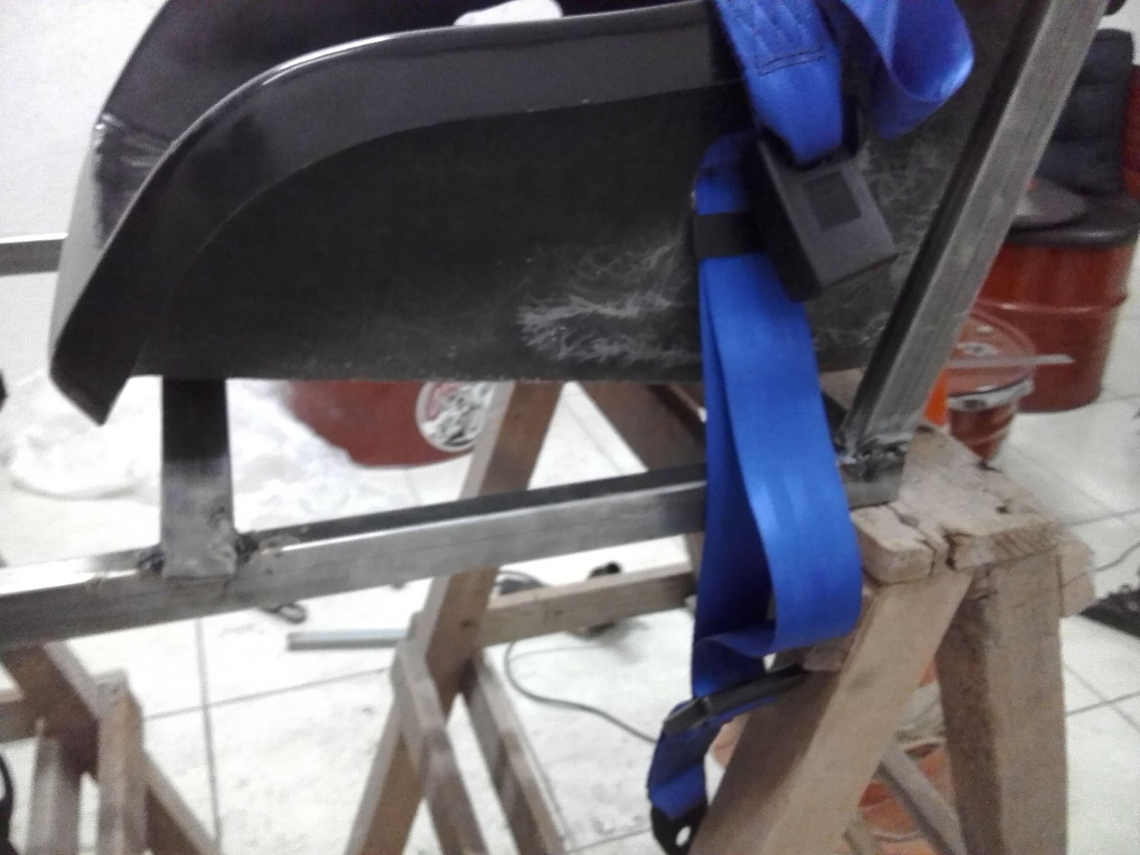

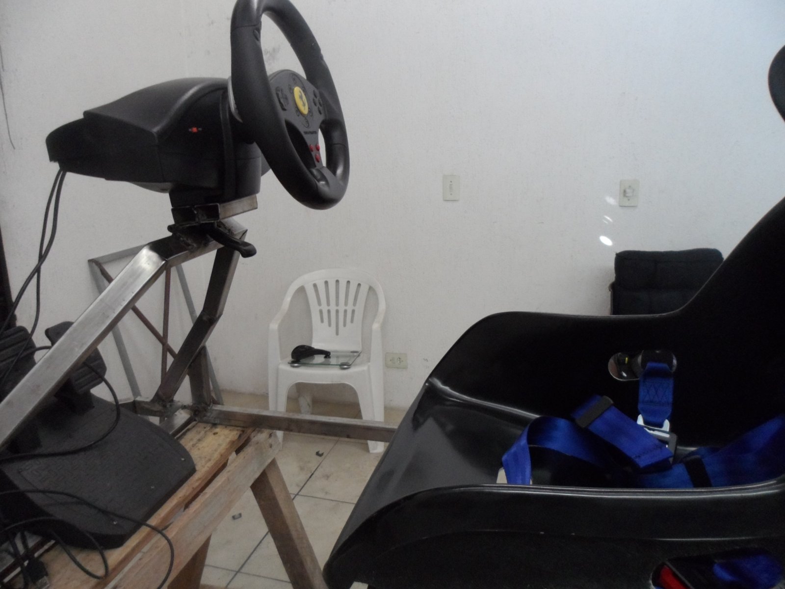

    Finally welding the base and the seat.
    No rails under the seat.
    I gave the seat single seat car ergonomics, I liked the result.

    Hi all
    solved problem with getting in and out
    The space was small
    it's working

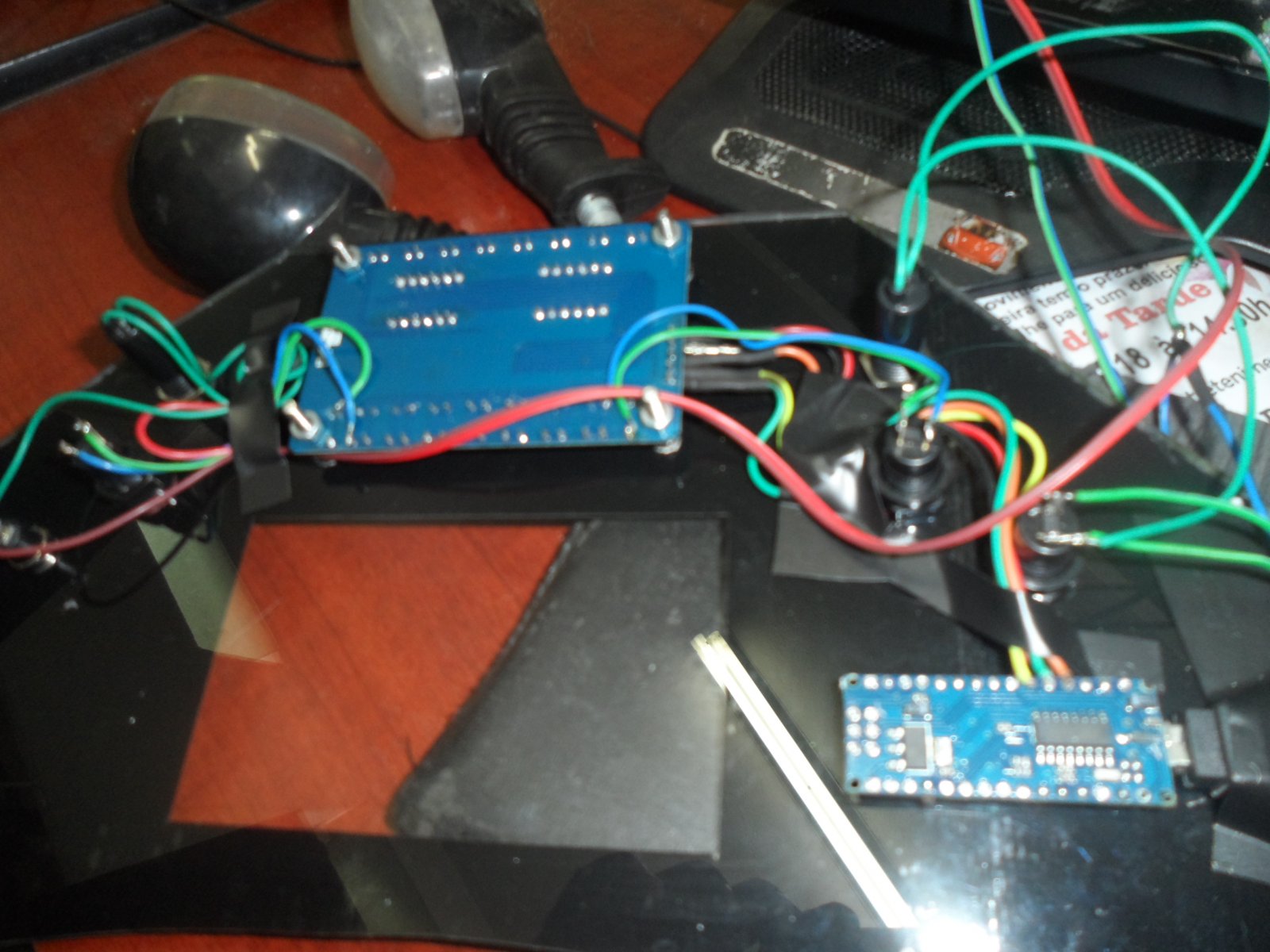

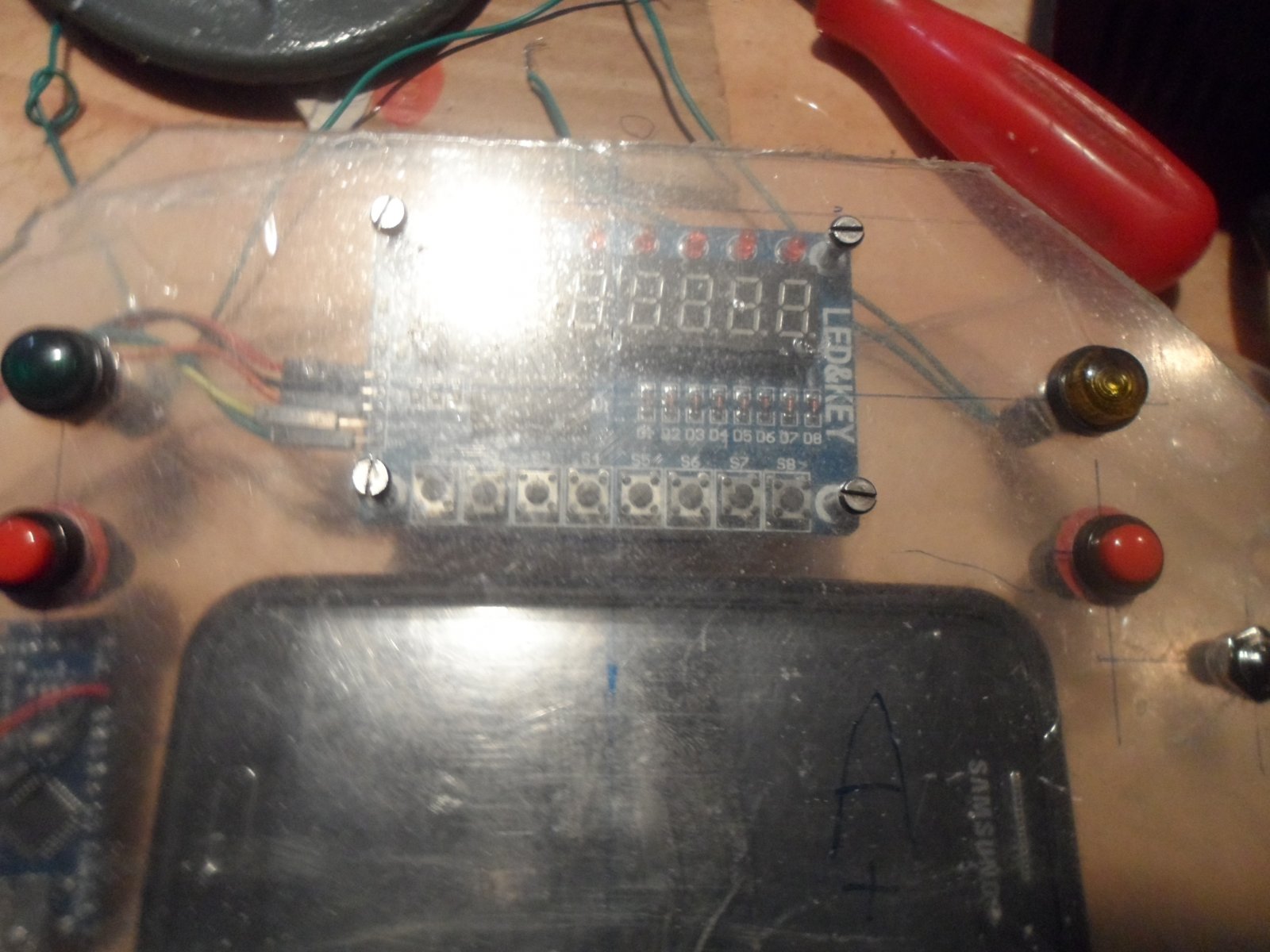

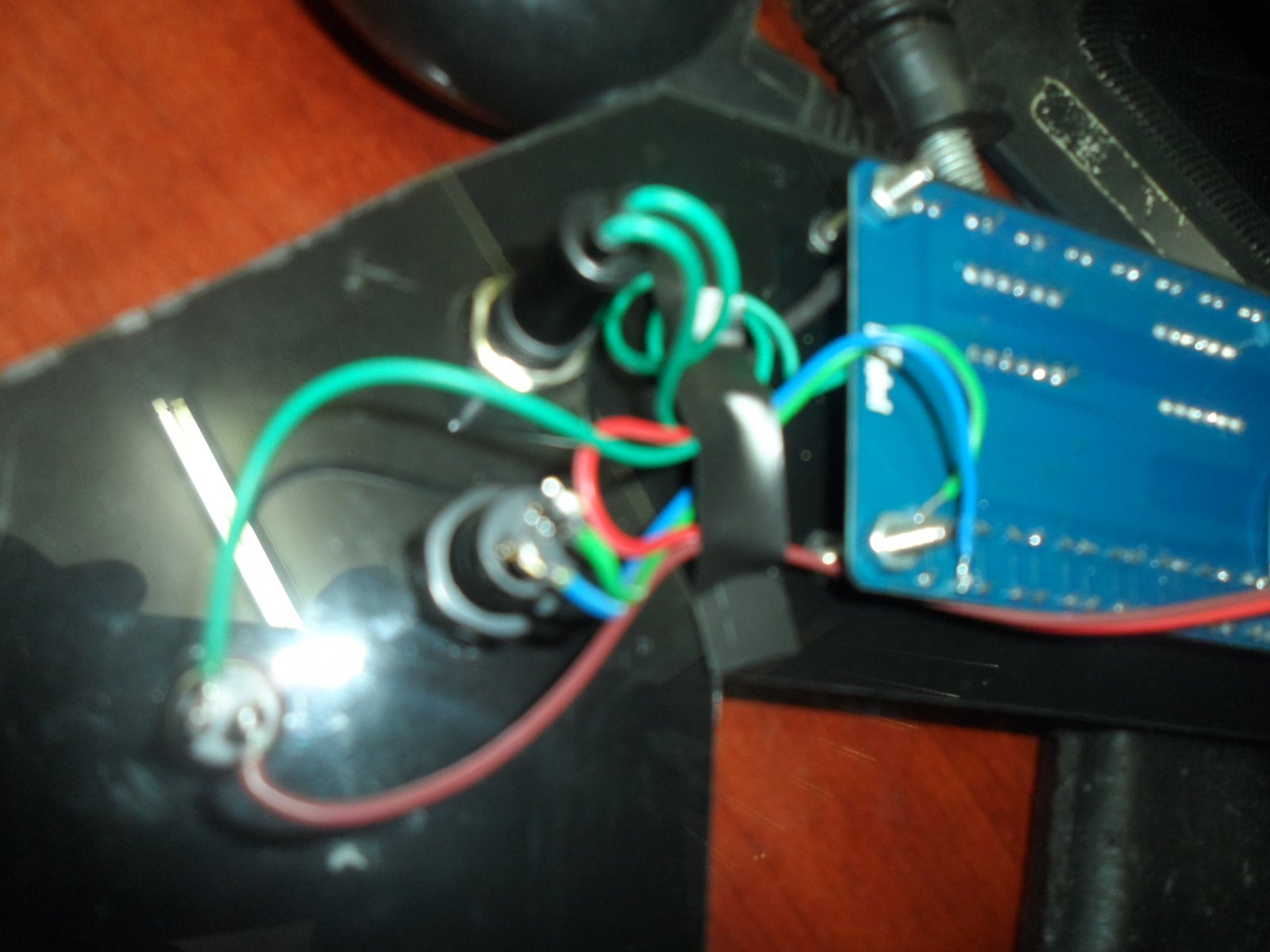

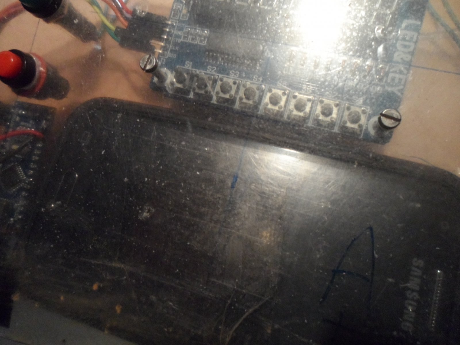

    Hello people
    i'm finishing dashboard .
    simhub software is used for now.
    the amber light is PIT
    the green light is ....coming soon.
    i'm using arduino nano and one TM1638 display and android mobile.
    big hug to all

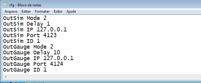

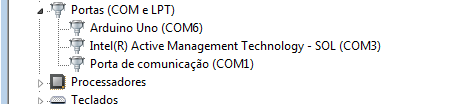

    Can someone help me.
    I no longer receive a VIRTUAL AXIS signal
    It only happens, it seems to me only the initial movement. watch the video please
    When I start LFS it makes two moves and stops.
    txs a lot

    now when starting LFS shake it few movements and stopped
    already installed patch
    patch uninstalled
    uninstalled LFS
    installed LFS.
    I d'ont no what do...
    Serial commandas work it.
    Arduino code from RacingMatt.
    anyone ?
    i forget anything ?
    see video
    txs

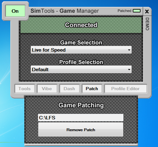

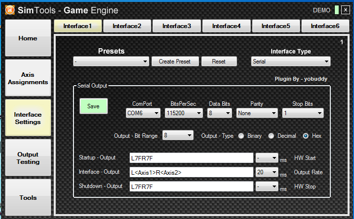

    Hi Noorbeast
    explanation:
    When starting lfs the "GAME MANAGER" does not change to GAME RUNNING".
    if I uninstall lfs and install from and do the "PATCH" it works until reboot.
    but even when this works the seat only moves to the starting position.
    grateful for your help
    The machine is an i5.
    16 GB
    HD SSD
    Radeon R5 230
  18. noorbeast
    20,464
    144,620Coins

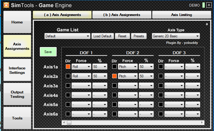

    +10,741 / 52 / -2

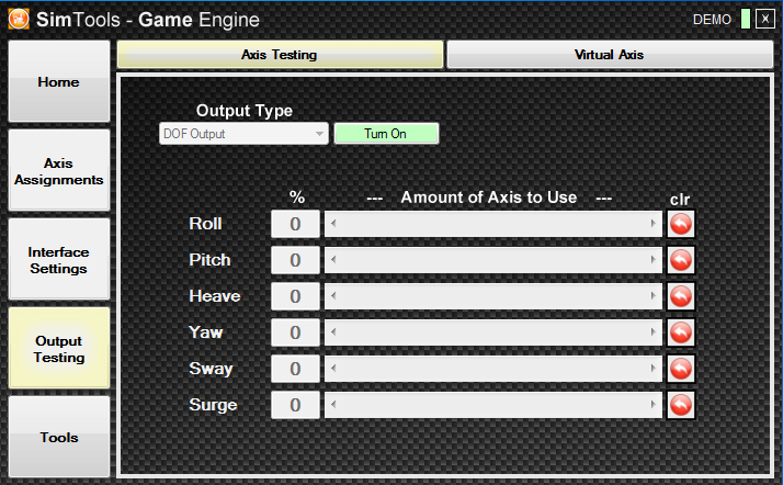

    In the Interface Settings instead of axis defined like this <Axis1> it now has designate grouping a or b in SimTools 2 for each axis assignment, like this L<Axis1a>R<Axis2a>
    The DIR box being checked orange or not determines which way and axis moves, they should be set in the Default Profile so Output Testing moves like this: https://www.xsimulator.net/community/faq/which-way-to-set-simtool-axis-movements.230/
    And follow these steps to create and refine a motion profile: https://www.xsimulator.net/community/faq/steps-to-create-a-motion-profile.228/

    Ah !!
    Nothing moves at the start of the test when moving the sliders.
    starting position only.
