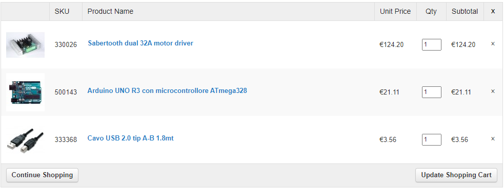

  3. Boštjan
    Boštjan New Member
    Feb 15, 2021
    11Coins
    So this parts should work I guess
    What do I have to watch on motors DC Motors
    12/24 V DC
    ? RPM
    ? N.m [min/Max]
    ? A [min/Max]

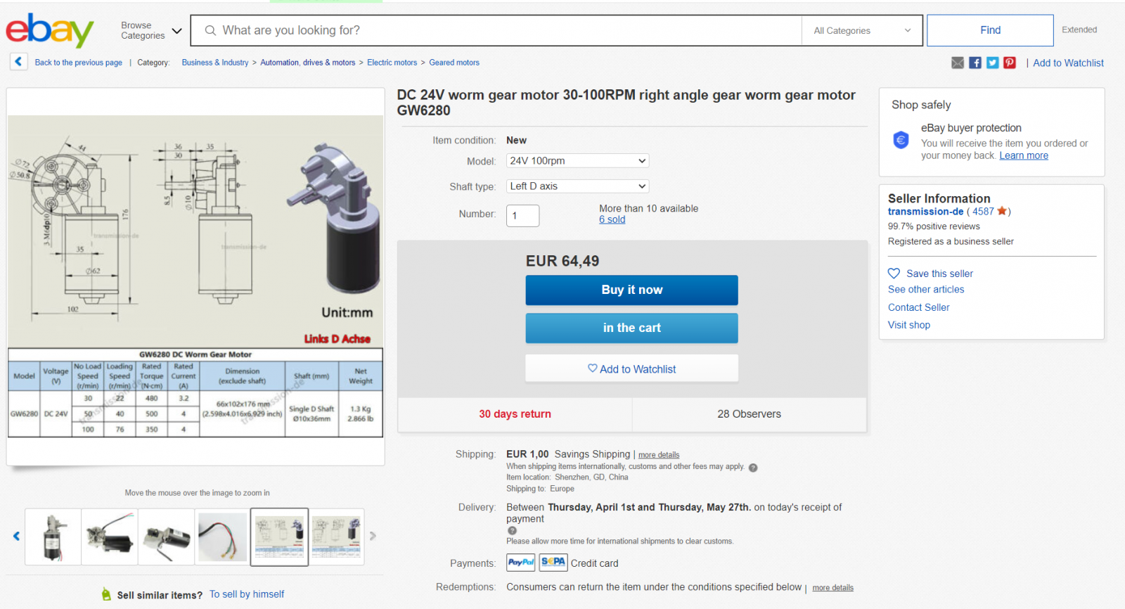

  5. Boštjan
    Boštjan New Member
    Feb 15, 2021
    11Coins
    s this motor better (ok) choice ? I'm looking for something with low shipping to Slovenia :)
    https://www.ebay.de/itm/DC-24V-Schn...20e1b236d:g:kOYAAOSwL05d7bfs&var=585091199235
    20,461
    144,596Coins
    +10,741 / 52 / -2
    That motor is available with different wormdrives, so use SimCalc to compare them with your chosen design, using the motor specs provided.
