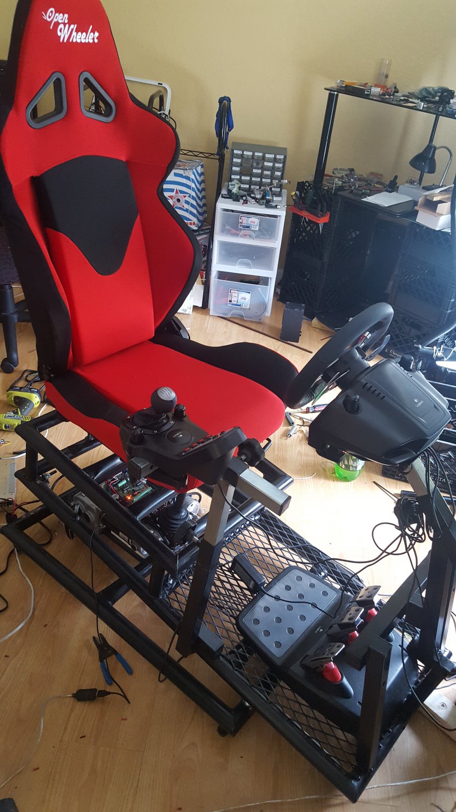

    Here Is My Motion Platform DIY project..developed and constructed myself with some ideas this site...

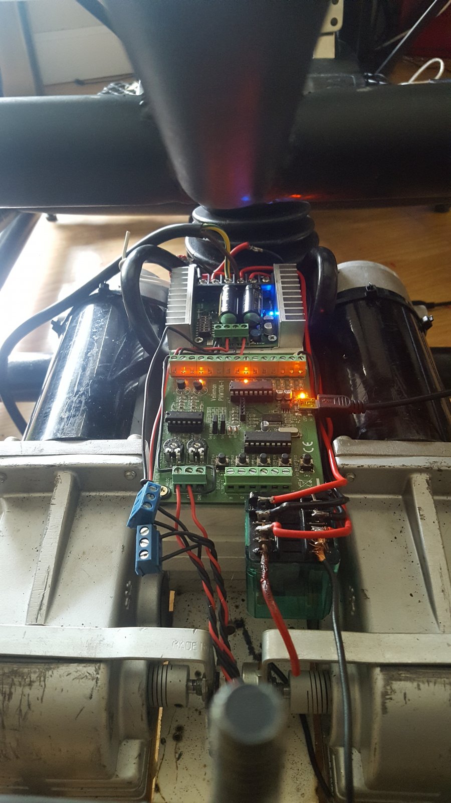

    waiting for the full developed and tutorial for the k8055.exe interfaceing with sabertooth and simtools...by eaorobbie. 20170325_113640.jpg

    Wheel chair motors..came from a hoveround:
    Weight (per motor): 13.5 lbs.
    Left side model number: MTS:62010023
    Right side model number: MTS:62020023
    The motor assembly also includes:
    • Axle key 0.236W x 0.236H x 1.566L
    • Brake cap, E610--(-eleminated)
    • Brake solenoid, E610---(eliminated)
    • 2 x Motor, brush (MTS: 62400001)
    • 2 x Motor, brush cap (MTS: 62400013)
    • 3 x Screw M6-1.0 x 16 mm
    • 3 x Screw M6-1.0 x 30 mm

    I do have 3 new arduino uno r3..for some reazon I dont like this card, to complicate to program !!! I like Velleman VM110 N(k8055) ...the card is easy to wiring, setup and is pre programmed -not flashing needed or codes to mess with..only need the drivers and is good to go....great for motion platform and the led analog/digital indicator shows when is working......!!!
    I will use an Arduino for CNCs ,laser printing or 3d printing they are awesome for that...

    Also the arduinos , does not hold wire firm on the tiny pins holes...even with screw type piggyback shields... with vibration have the tendency of coming out and lose connectivity..and send the motor on a crazy spin damaging the pots..the K8055 the cables are firmed bolted and tied..and take a lot of vibration and abuse...!!!just my 2 cents....thanks

    Just solder the wires to the Arduino or use a kangaroo.
    You won't beat SMC3 Sabertooth for setup and profiling.
