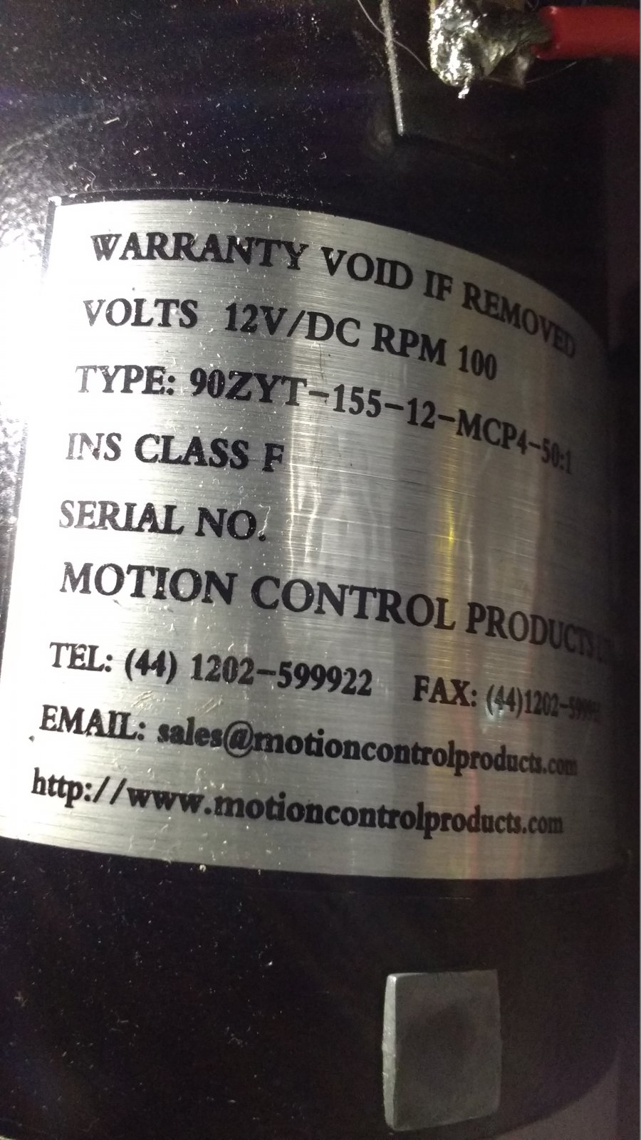

    A friend and I both decided to make our own DIY motion rig after finding this site.
    We were going to go the arduino route at first for the cost benefits but later decided to go JRK.
    At first I made a model so that I could get the software working, SimTools v1.3 at the time, and get my head around the basics. I have a video of this working but not on me. I will add it soon.
    So we both started collecting the ingredients required to build our rigs and eventually about a month ago I had the below delivered.
    My Kind friend had welded up a UJ to some plates, made some brackets and made some arms for the motors. He also sourced the motors.
    The only thing I've done here is attach the rose joints.
    Laying the main components out to see how they will fit into the space available.
    The JRK's really are tiny

    What are the specs for the motors you are using?

    Very good, do you have how many pounds on those engines along with the chair?
  11. Nick Mckerron
    Nick Mckerron New Member
    Oct 21, 2016
    15
    Cornwall
    316Coins
    :) too many pounds Joao.
