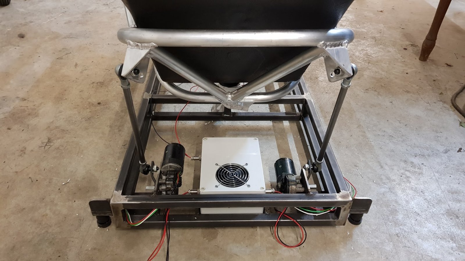

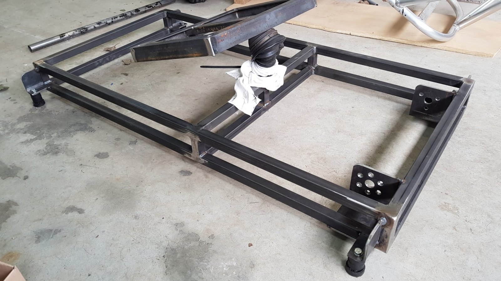

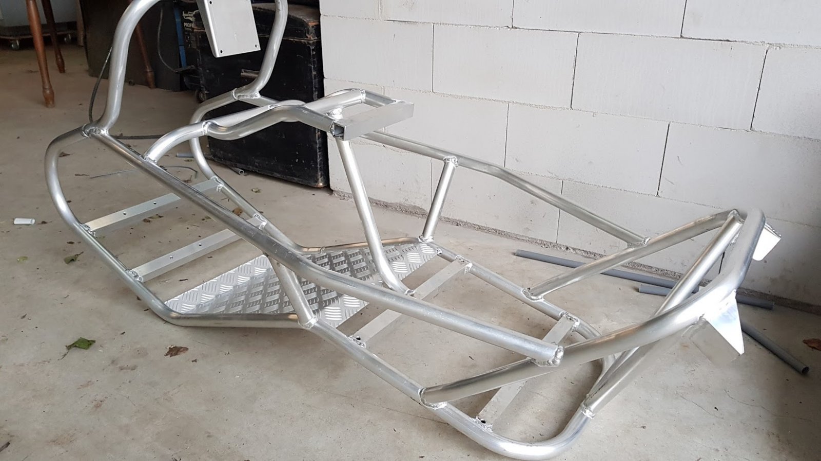

    That's a very nice bit of aluminum fabrication, you must have a great combination of low weight and stiffness. Did you weigh the upper frame ?
    20,551
    145,124Coins
    +10,778 / 52 / -2
    Nice work, I will look forward to following your updates.
    There is an eligibility criteria for a free license, which includes length of membership and progressing your build thread: https://www.xsimulator.net/community/faq/request-a-free-diy-simtools-2-0-license.262/
    That looks to be a CV joint used for the pivot, if it allows lateral rotation then you will need to add a panhard style rod between the top and bottom frame to prevent torsional twist
    With wiper motors you need to ensure they are ground isolated: https://www.xsimulator.net/community/faq/wiper-motor-mandatory-ground-isolation.25/

    @Limongi No sorry I didn't weigh the frame. But i need to take it appart before painting so I will weigh it then.
    @noorbeast Homokinetic joint don't allow lateral rotations so I should be fine. Thanks for the advise!
    Yesterday I mounted the pots and finished up the wiring. Should be ready to test the motion in a few days. Just hoping the motor's are strong enough. I used the point of mass for my cv joint, but when the seat turn forward the point of mass moves so the motors have to come up with a lot of force.

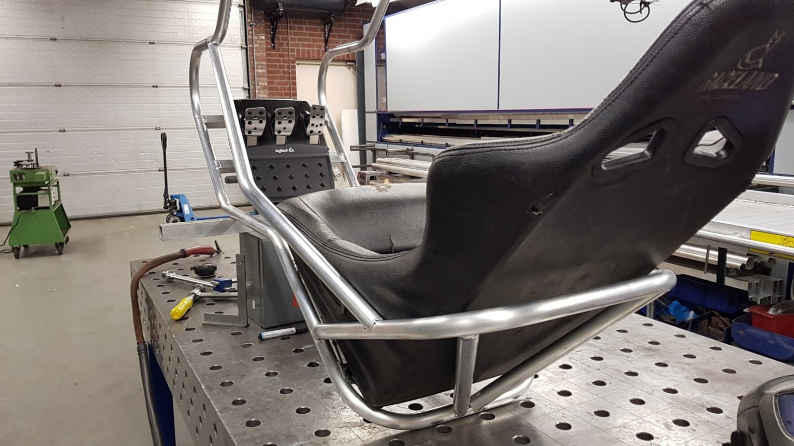

    The upper frame looks very nice ! Did you weld it with a TIG ?
    Why did you double the bottom frame ? to limit torsion ?

    @creazyrider I've seen some simulators who lift their own feet while moving the seat from left te right. To prevent this I decided to make the frame stiff. Another plus side is that I can use the space between the square tubing frames to mount all the electronics.
