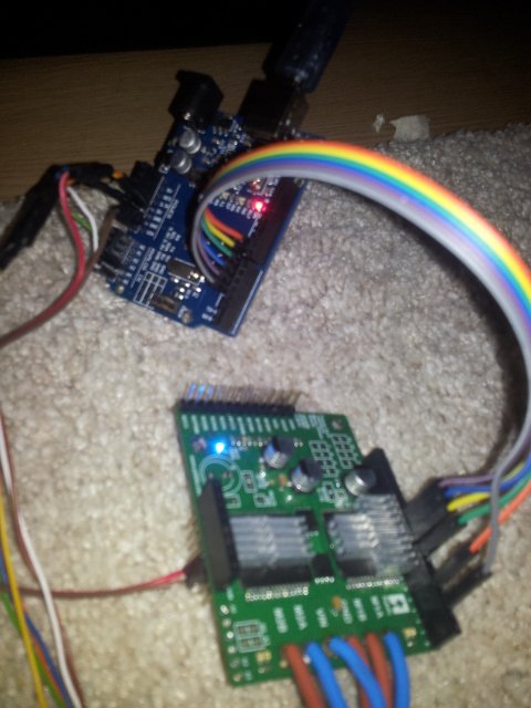

    My hardware is
    Arduino Uno R3
    Pololu VNH5019- 24 V 12A ( Peak 30A )

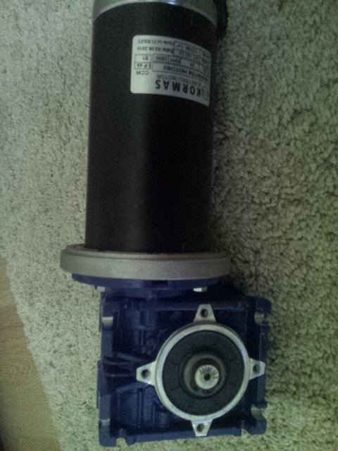

    24V 2800 RPM 190W Motor
    Reductor Ratio 29

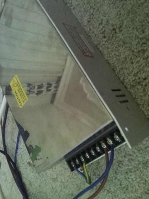

    Here is my wiring,
    Power Supply 24v 20A
    24v 2800 RPM 190W Motor and Ratio 29 Reductor
    here is the video while driver working with pots and with simtools
    My problem is that when I connect the pots on the motors and pull the axis to -100 or +100 motors doesnt stop and continue to run. I also tried to reduce the axis limits to %50 but nothing changed :(
    I think I need to send some codes to give a working angle to the motors but I dont know how to do it.
    Do I need to change the startup and shutdown values on the simtool ?
    Thanks to all

    one thing you could try is to reverse the polarity from the potentiometers (5v -> gnd and gnd -> 5v). Or you could reverse the wiring to your motors. but don't do both of them as then you're back where you started.

    @RacingMat's code comments seem to detail what you are describing:
    The code is written to put the simulator on middle position at start :
    /* init position value*/
    int DataValueL=512; //middle position
    - if your pot is fully turned to max, as Arduino reads potentiometer value as motor position, Arduino believes that motor is in max position.
    - but the order is to be in middle position
    - so the Arduino will ask the motor to go reverse in order to go to middle position
    - your motor is turning
    - but while your pot keeps still, the motor will turn non stop !
    - when you manually turn the pot backward to min, Arduino reads that motor is in min position
    - but the order is still middle position, so Arduino will tell the motor to go forward
    - motor runs non stop until the pot is in middle position
    In the code, you have a tolerance parameter : when the pot is around middle position (<middle+tolerance and >middle-tolerance), the motor stops.
    You can broader Tolerance value to stop your motor more easily manually.

    @Pit I bought them form the dealer of kormas. Do you think they are good ?
