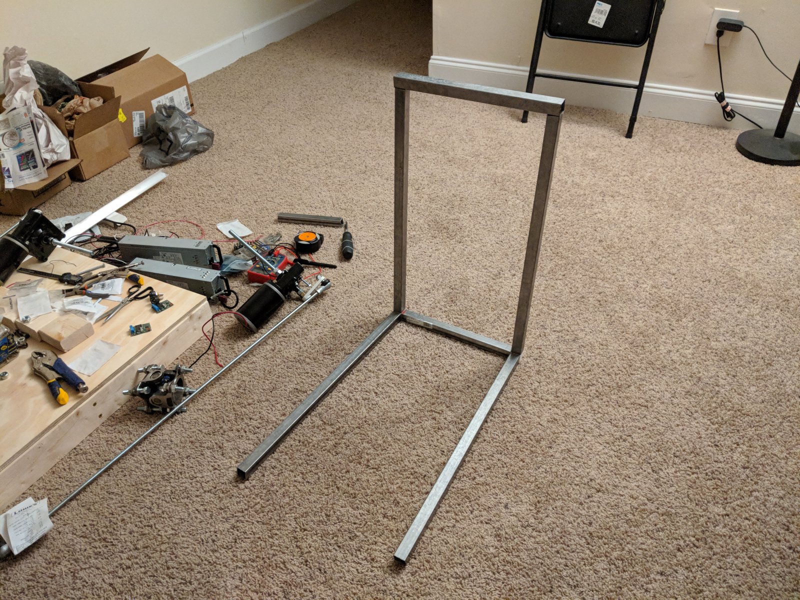

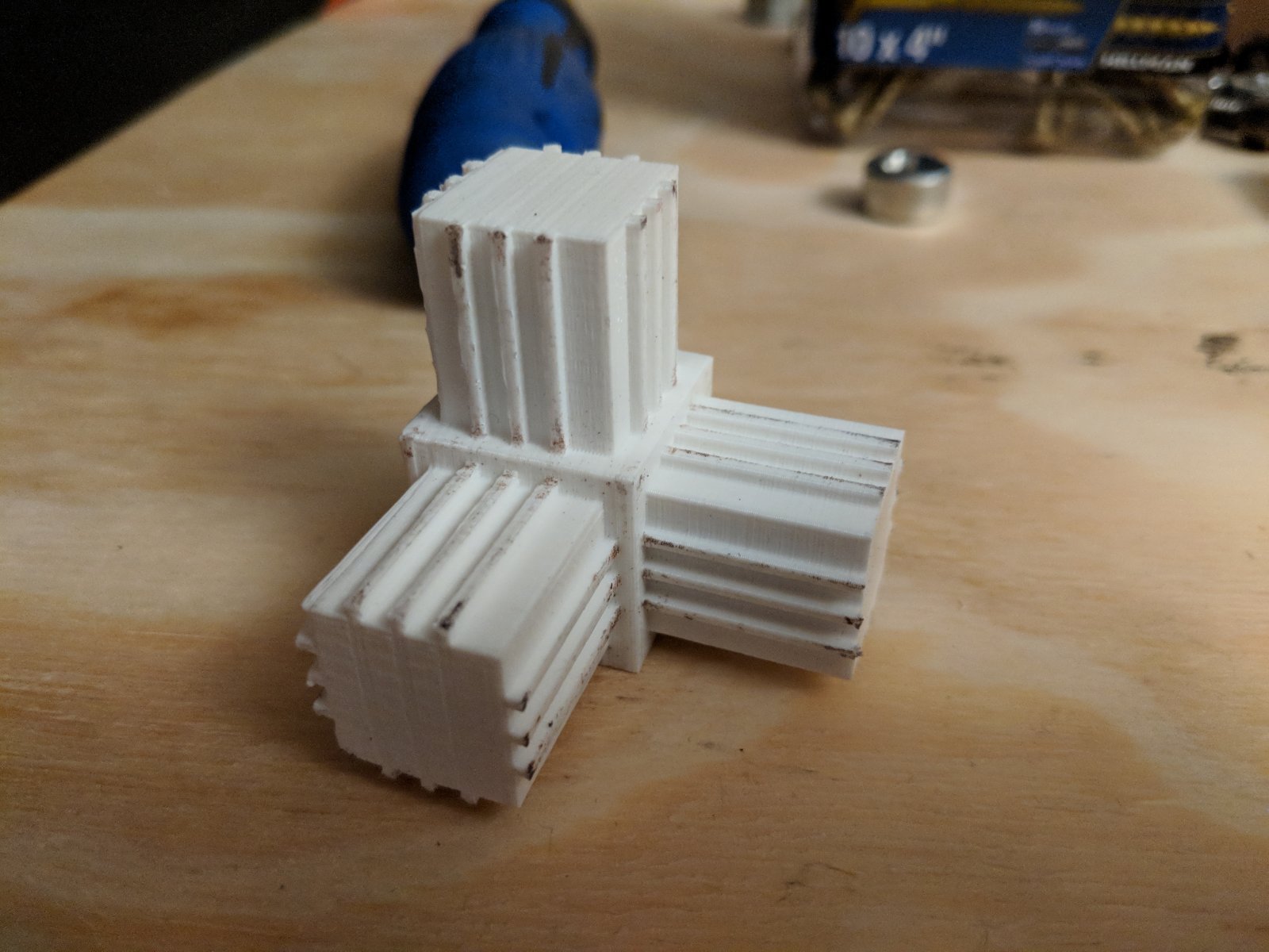

    Starting off, I began cutting steel tube to use as the frame for the chair. In addition, I 3D printed tube connectors to use as temporary support for the frame to make sure that my measurements fit properly before taking it to a shop this weekend to get it welded together.

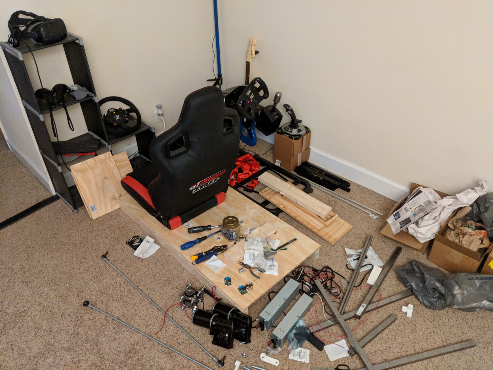

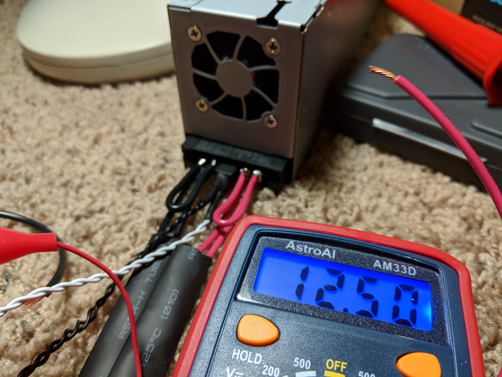

    Not a lot of updates so far: did the wiring for the PSUs and verified that they output 12V.

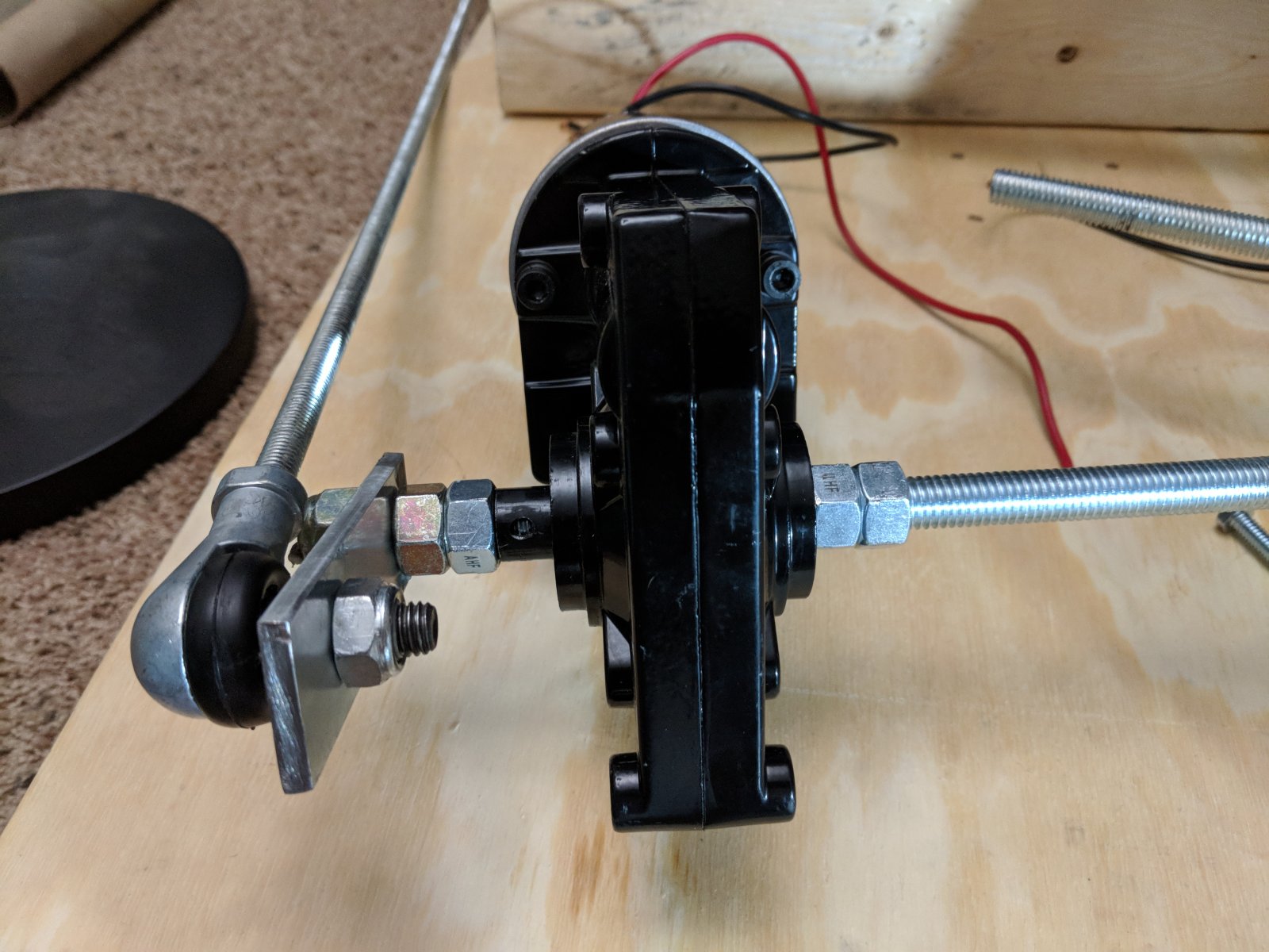

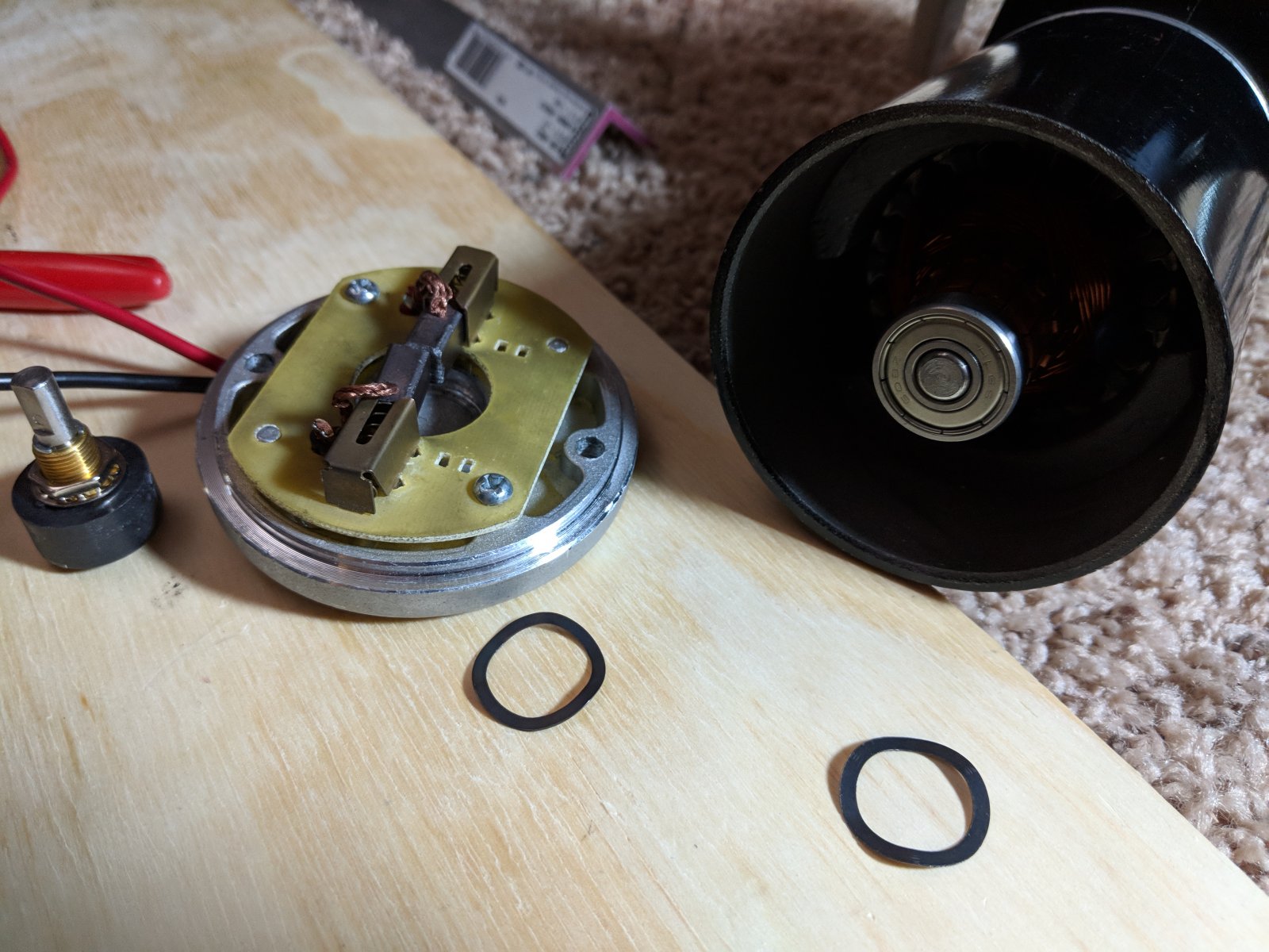

    I did run into an issue though, which I'm hoping someone may know the answer to. I took apart the DC motor out of curiosity and 2 pieces flew out.
    I want to say they both go on top of the bearing but I am not sure why there is a need for 2 of them. If anyone has any insight on how they are put back, I would greatly appreciate it! Tomorrow I am looking to getting the seat frame welded together and mounting the seat.
  4. SeatTime
    2,573
    28,320Coins
    They are normally there to take up the play and stop the armature from moving back and forth. I would have only ever pulled these apart if I had to :).

    SeatTIme is right.
    They are definitely spring washers for armature play. Though looking at your photo, the reassembly is going to be somewhat tedious. My simple opinion is that you may have to take the whole motor apart to reassemble it all together correctly....

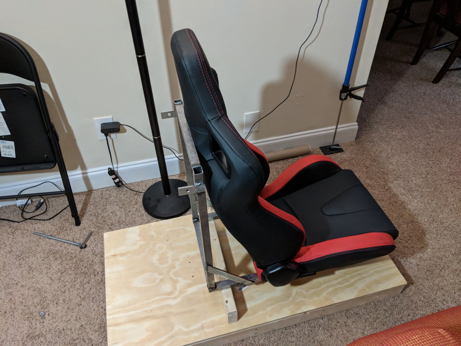

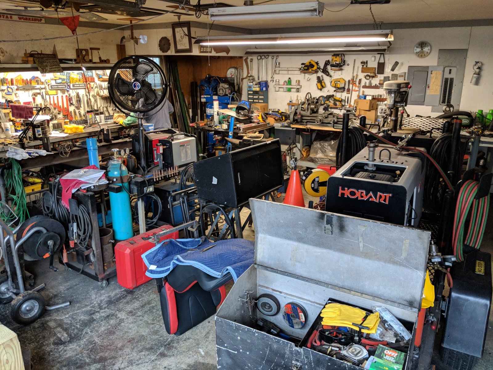

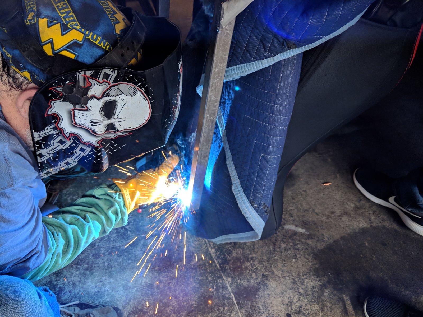

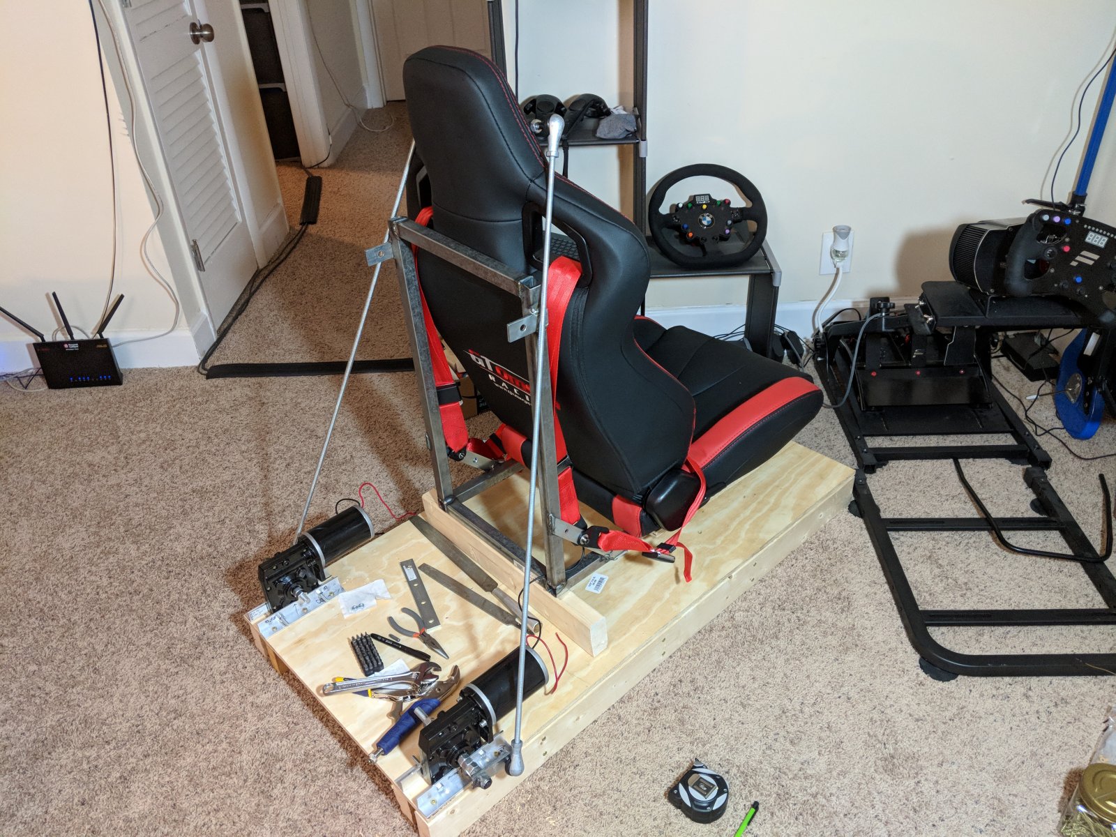

    I met an awesome fellow this past weekend with a very impressive workshop who was able to help me weld the steel frame together.
    With that completed, I was then able to get the seat mounted on top and onto the base platform.
    I am liking how things are coming along so far and can't wait to see (and play with) the finished product!

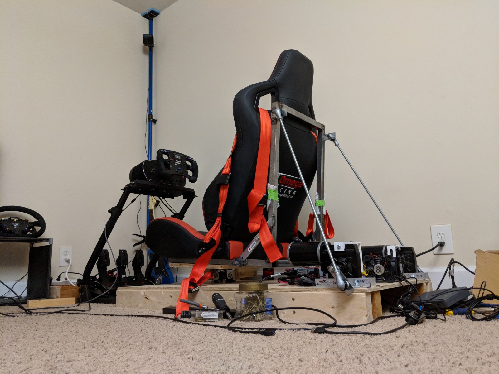

    Got the lever arms for the motor installed and mounted onto the base. I'm using 3/8" threaded rod for the shoulder mount rods shown below and am a little concerned if it will start to bend over time with usage. Would it be better to reinforce it somehow? MVIMG_20180211_173201.jpg
    21,493
    150,578Coins
    +11,017 / 55 / -2
    Some steel tubing with a suitable nut welded either end will adequately reinforce the threaded rod.

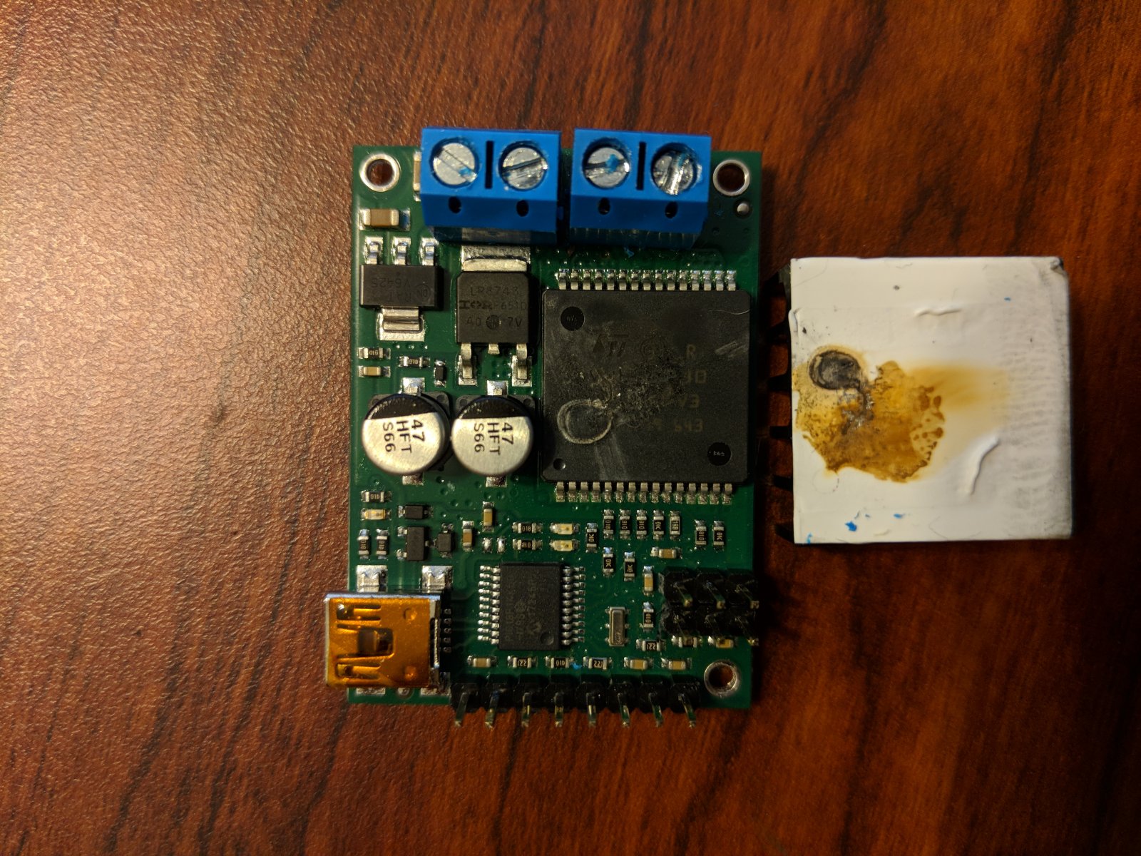

    I feel like one of my JRKs may be out of luck :( I went to test them and can't remember exactly what I did but I smelt something burning. Now when I get to the "Detect motor direction" in the JRK Config Utility, it spits out an error saying "Error detecting motor direction. Driving the motor with a duty cycle of __ did not change the measured feedback. Check your motor and feedback connections."
    At first I thought the motor was at fault so I plugged it in to the other JRK which worked fine. Upon taking apart the heatsink I saw this and don't know if there is anything that can be done or if a replacement is my only option.
    21,493
    150,578Coins
    +11,017 / 55 / -2
    My guess would be that a replacement is likely needed, but contact Pololu as they often offer discounts on replacement JRKs.

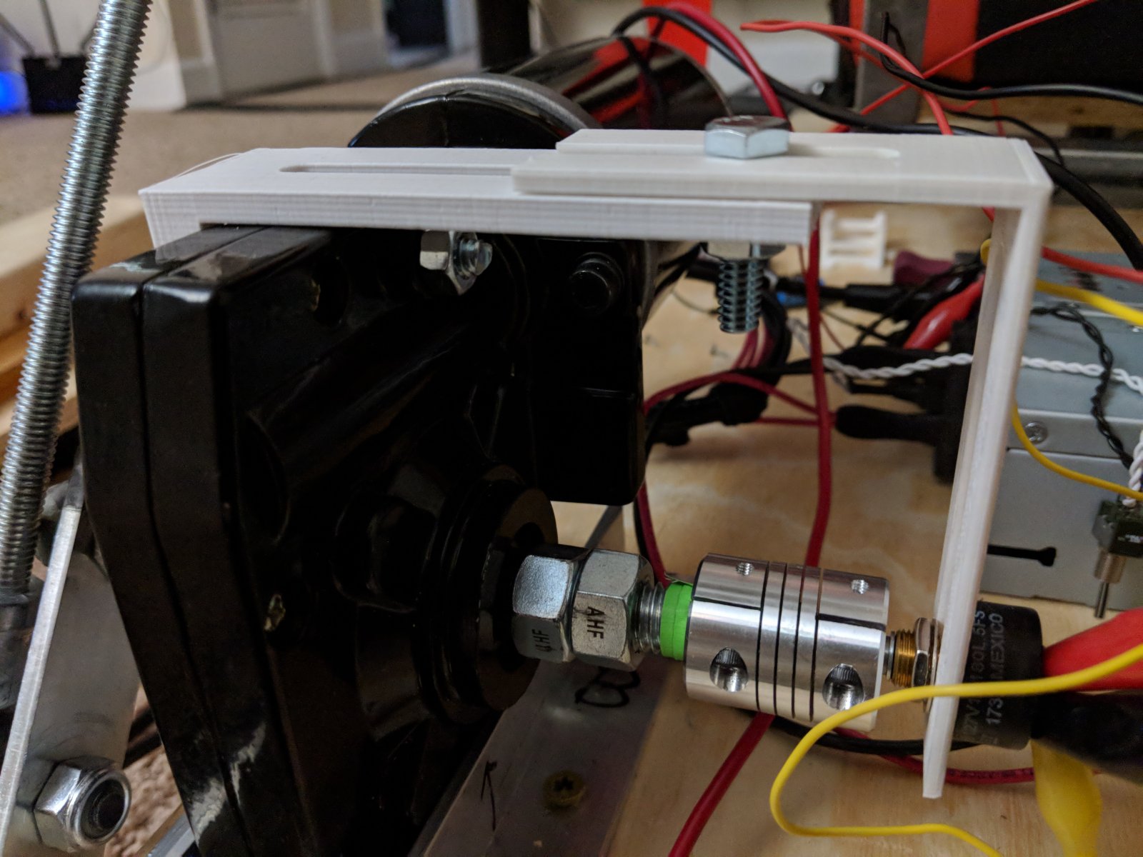

    I have a general idea of how I want the placement of the PSUs and JRKs to be placed. Also ordered some 80mm fans to help with cooling the JRKs. For now, I only have 1 motor controller wired up because I fried the other and have a replacement on order. Also inverted one of the 3D printed potentiometer mounts temporarily as it is not long enough. IMG_20180218_224622.jpg
    Also a video demonstrating basic movement of my seat mover. I may consider shaving a bit off the levers as they seem to be coming in near contact with the rod ends.

    I modified the pot mount to extend the length far enough to mount my potentiometers. IMG_20180222_162639.jpg

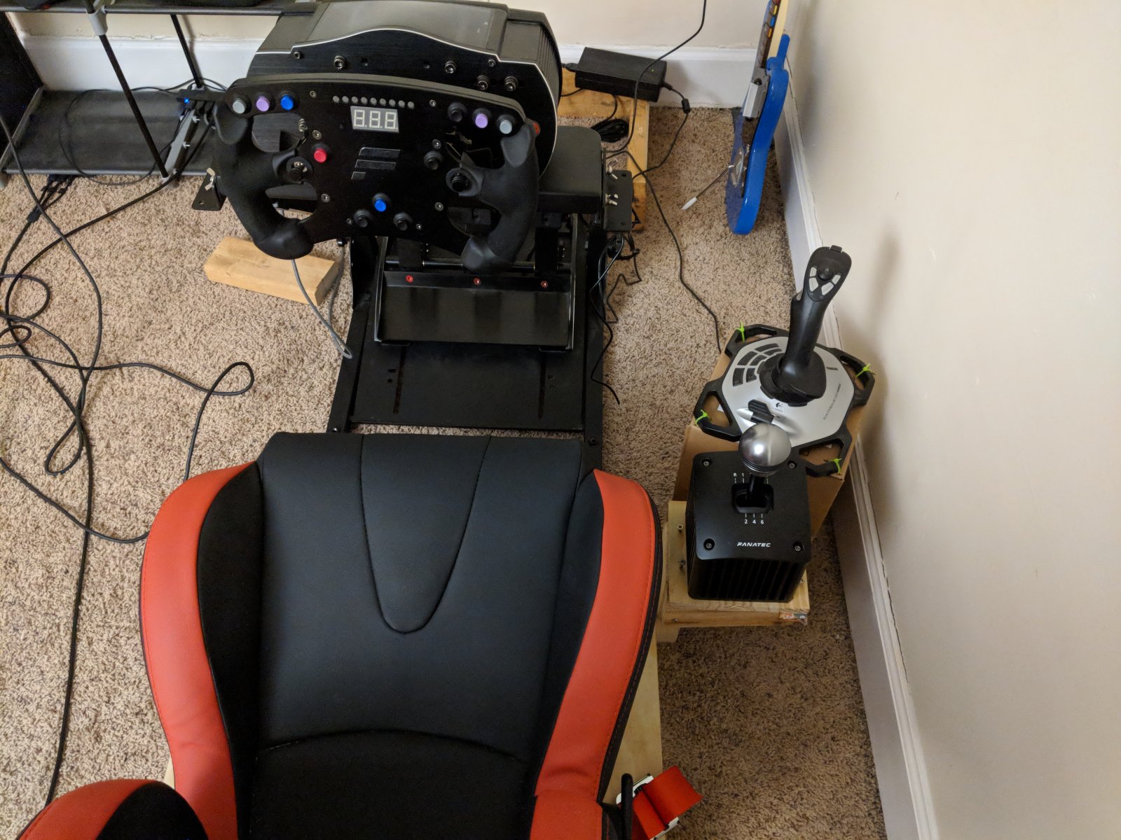

    Very late post but it's better late than never. I've been busy with school and other things so I never had a lot of time to work on the motion rig. But after 3 months since starting this project, I'm happy to announce that this project is pretty much complete!
    The only major update that I've really made is mounting the shifter down to a more natural position on the rig.

    Great job :thumbs
    My initial thoughts are that sway and surge look good, it looks like heave could be a bit more refined and aggressive.
