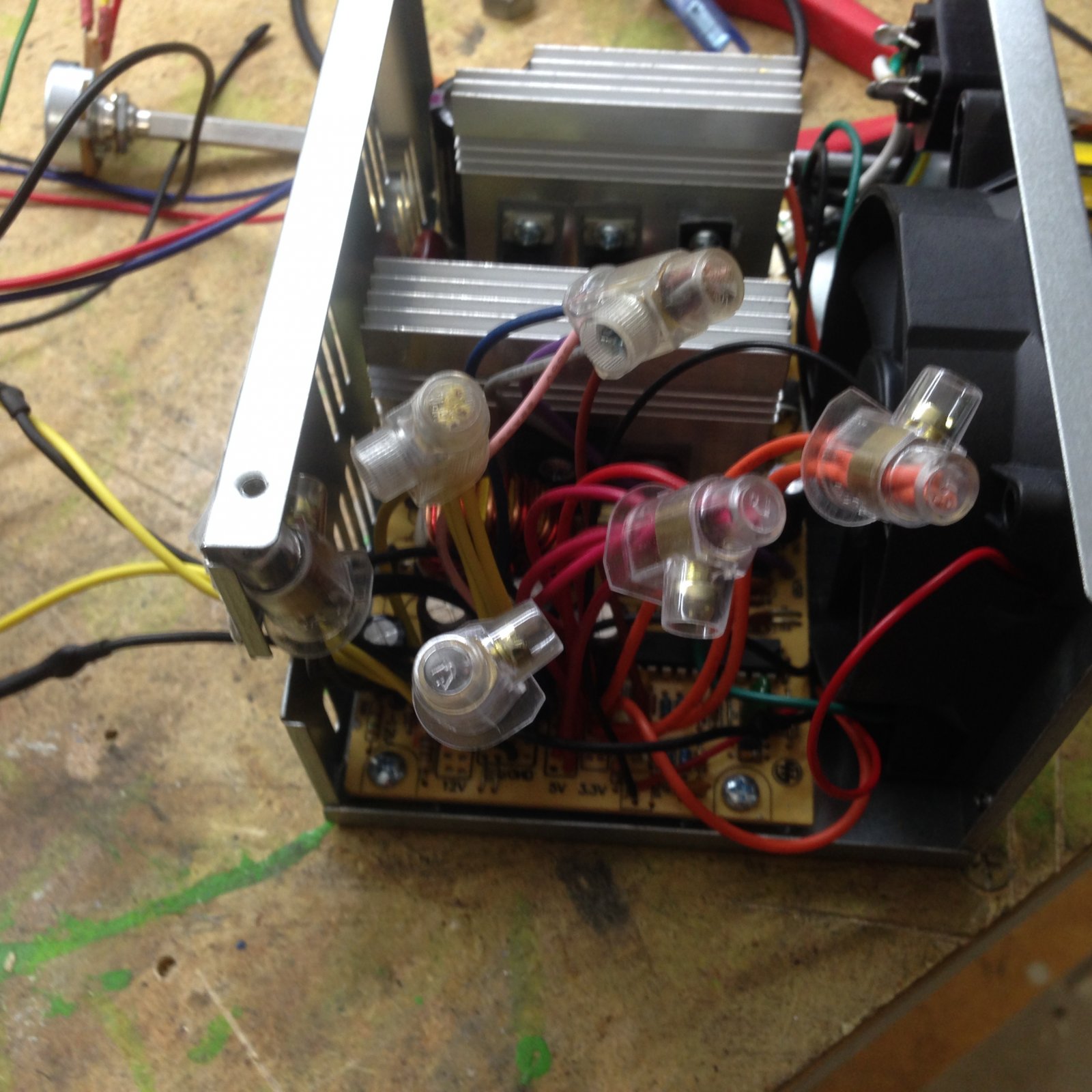

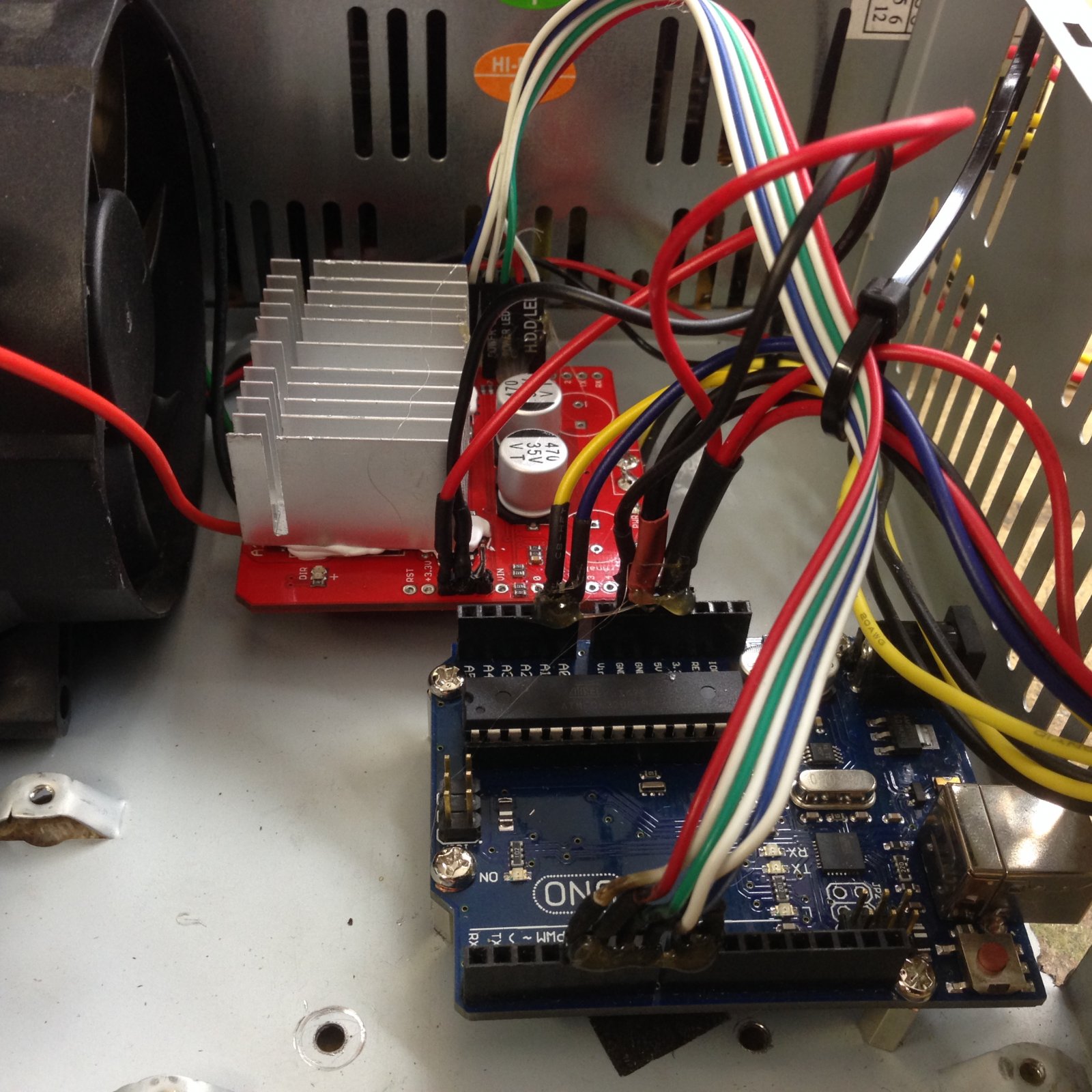

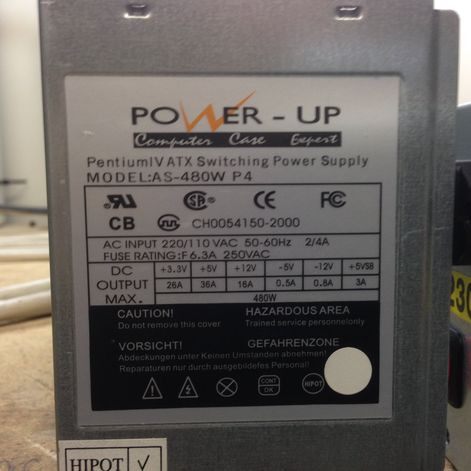

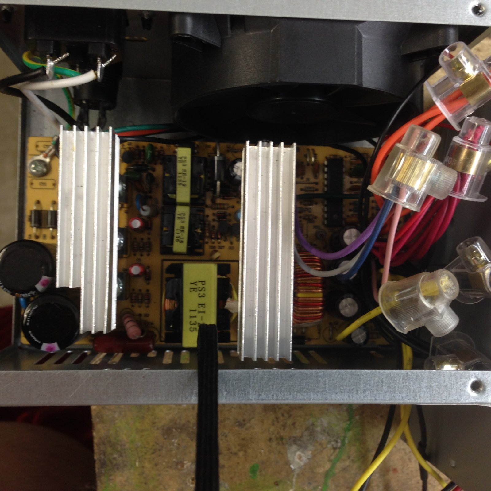

    Stage 1.
    Ardunio Uno $39.00 including delivery
    Motor Driver Module 30A Monster Moto $15.00 from Ebay ( Took a month to get it)
    Power supply from a computer that couldn't run Pacman if it wanted to $0.00 ( to be upgraded upon success and testing)
    Power supply housing from a dead power unit $0.00
    Various parts from Jaycar ( 2 x 12 volt mini motors for testing and 2 x 10k pots) $24.00
    Total so far $63.00
    After spending a Saturday soldering and drilling. Here is the finished result.
    Nice and compact.
    Stage 2
    Get the motors working and test the software.
    Keep you posted
    Regards Simon

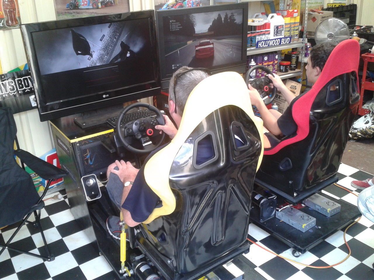

    if you use wipers, look for cheap, hunt around wrecking yards, I eventually found $10 ones that did the job. Mind you , these days I use bigger motors
    as for $1 per min, thats a cheap rate compared to motion rides, they run $1.50-$2 per min, also they only offer rfactor, not the codies games kids love to play.
    these are going to car show next Sunday and I am charging about $1 a min.

    Most of the SMPS similar to the one you have shuts down when it detects large fluctuation in current. Also the maximum power available on the 12 volt rail is 200 watts, 2 large motors will need more power. It will work with the mini motor but not with wiper motors...
    Also monster moto can only handle 30 amps max. Choosing a motor will be very critical, you can end up with problems similar to this.
    http://www.xsimulator.net/community/threads/problem-motors-shutting-down.5888/
    http://www.xsimulator.net/community/threads/monster-moto-shield-amps-per-channel.5366/#post-53439

    Good start @headbangersball!
    Nice little box! heat sink will be nicely cooled.
    If you're unsure about max current, put a fuse to protect your motomonster ;-)
    or use a single motomonster per motor (double wiring) like Pit did.

    Hi, In my first build, my biggest problem was constant worry about project's failure and loosing money.... Ended up realizing that I could have done better if I didn't worry about it.
    Also with the Current Sense feature of Monster Moto, it is possible to calculate the Motor Watts (rating).
    All you need is to find a Sketch for MM based on Arduino that will send the current usage to your serial monitor. There should be one on Google or an example code on Sparkfun website.

    The Current Sense pin on the VNH2sp30 outputs .13 volts per amps used by the motor. Simply connect the Current sense pin on the MM to any analog pin on the Arduino and read its value by using the analog read command. We should get a value between 0 and 1024. Dividing this by 26.59 should give the amps used by the motor.
    For example,
    int cspin = 2; //Current sense pin from MM connected to A2 pin on arduino
    int value; // variable to store current sense
    int output; // variable to store .13volt per amp converted to amps ie 5v/1024 counts/130milliVolts per Amps
    value= analogRead(cspin);
    output= value/26.59;
    Serial.println(output);
    (You will need additional codes to run your motor. )
    Suppose your motor is rated at 8 amps, Serial monitor should print values between 7.9 and 8.1 with some minor variations . Motor should be running at a constant speed without any load. Also, dont forget to set pwm to 255 to get the correct motor rating.
