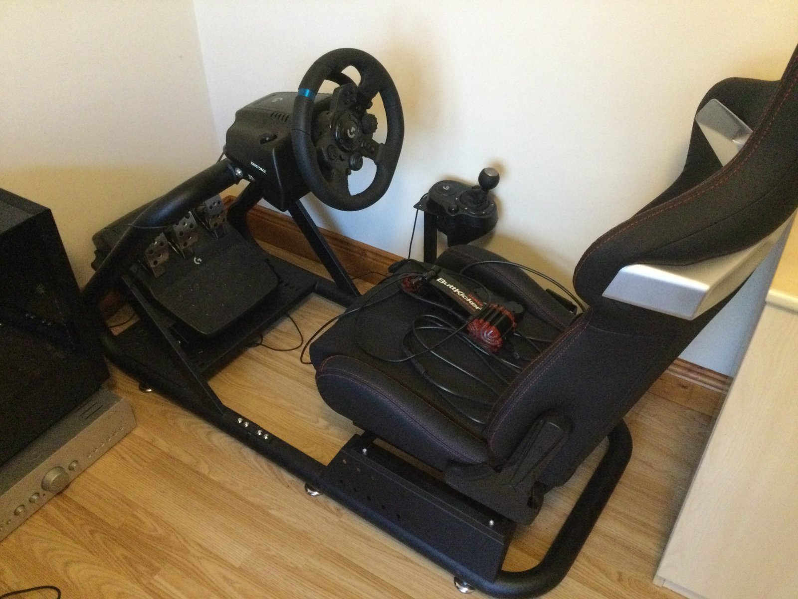

    Think i have got the bug. What to do with my driving rig. Thinking 2dof seat mover. Would like something a bit beefier that wiper motors. All opinions welcome. I only drive in vr with reverb g2 so probably no motion cancellation. So i dont want too much motion.

    A 2DOF with decent DC motors, or these days even servo powered actuators, is a great starting place, it adds a lot of bang for your buck, but can also be a slippery slope to more complex, hence increasingly expensive upgrades.

    Cheers Noorbeast. can you point me towards an example of suitable servo motors and an example of what you think is a good design / build would be great. yea this could get real expensive real quick.

    You can build or commercially buy AASD15A servo powered actuators, with their being a number of controllers now that pretty much make them plug and play, though they are still more expensive than basic DC powered rigs: https://www.xsimulator.net/community/faq/motor-drivers.11/category
    Design wise there are lots of possibilities, and tradeoffs between design/cost Vs physics. The simplest design with the greatest inherent design leverage is a shoulder mount 2DOF, closely followed by a foot mount, but knee mount and even compact designs can work.
