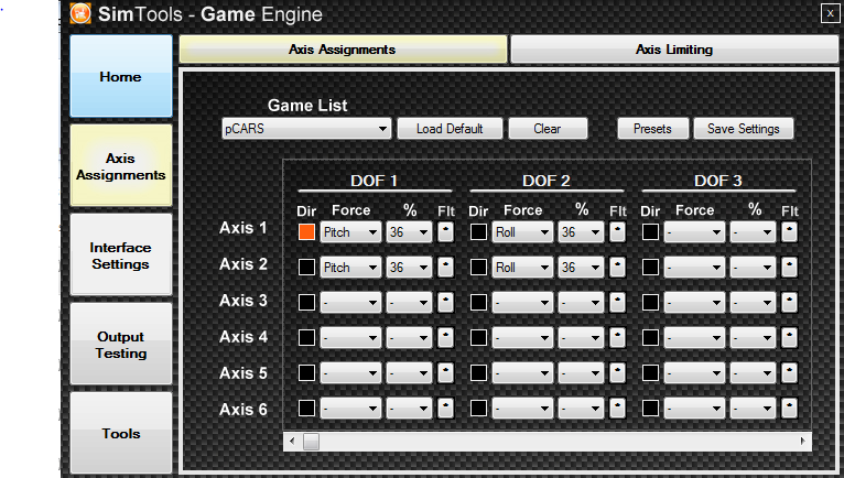

    r1206uno and monster motor shield
    [​IMG] Hello guys I started this project and I am lost with the electronic part and software, need help.

    Follow the tutorial racingmat but do not know if I did everything right .
    Is working as follows: feedback is only the position of the wheels on the track.
    Anyone know if this is correct ?

    I mean the 2dof this simulating only the position of the wheels in relation to the track.
  8. furiano
    furiano New Member
    Nov 14, 2015
    20
    - 88Coins
    I realize that the problem would be the plugin that takes telemetry tire instead of the chase .

    Please post a video showing both the track and the chair movement.
    And screenshots of your settings.
    Only this way someone will be able to help.
    It is possible that you have the wrong settings.

    Seems like you only use pitch and roll.
    Are you using surge and sway?
    EDIT...
    On, I just saw the settings picture.
    You need to add surge and sway in DOF3 and DOF4.

    surge and sway don't work
  16. pipis2015
    pipis2015 over-boost
    Feb 18, 2015
    222
    Athens, GREECE
    10,248Coins
    +271 / 1 / -0
    What game are you playing?
    Does your game support surge and sway?
    If the game you are playing does not give surge and sway values to simtools there is nothing you can do.

    Just roll and picht work on virtual axis show surge, sway working but don't move
    Projectcars

    If all works OK on output testing then it is just a matter of tunning(tunning center).
    Wait until someone who plays project cars sees your message and you will get some help.
