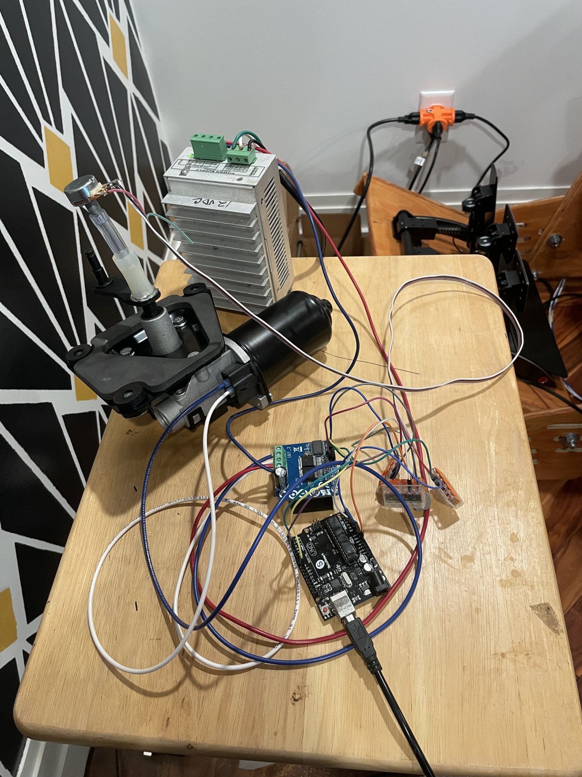

    Since I already had a 12VDC 8.4A power supply, a 3/4 turn pot, and an old Arduino Uno from other projects I could get started on the proof of concept rather quickly.
    I purchased a wiper motor and IBT-2 and I'm setting off.

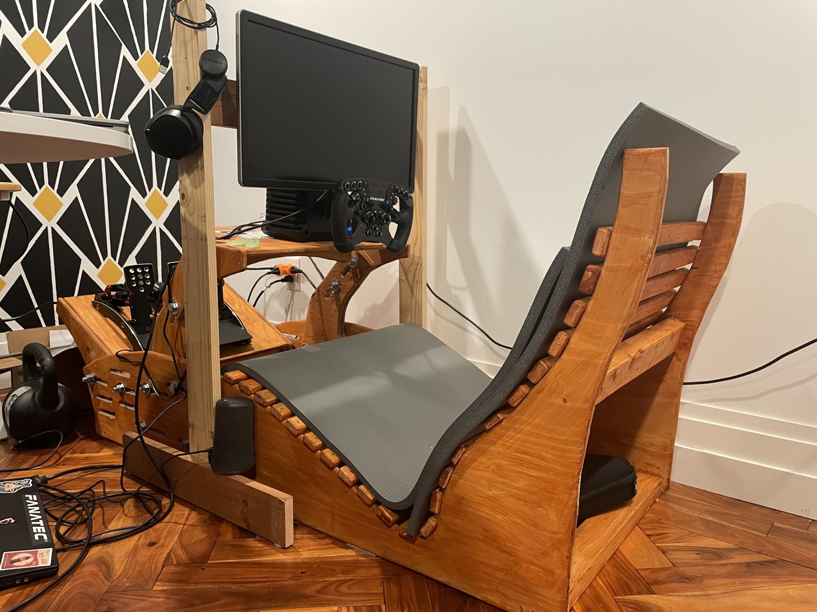

    Right now I plan on attach this to my OSR F1 style seat (that I built myself from the plans). I'm thinking a base plate that everything sits on. Then a lazy susan bearing and some skate board wheels to stand the traction loss platform off the base. Mount the cockpit to the traction loss platform and then mount the motor to the "back" of the seat. Run the linkage from the motor to the base plate and (fingers crossed)...motion.

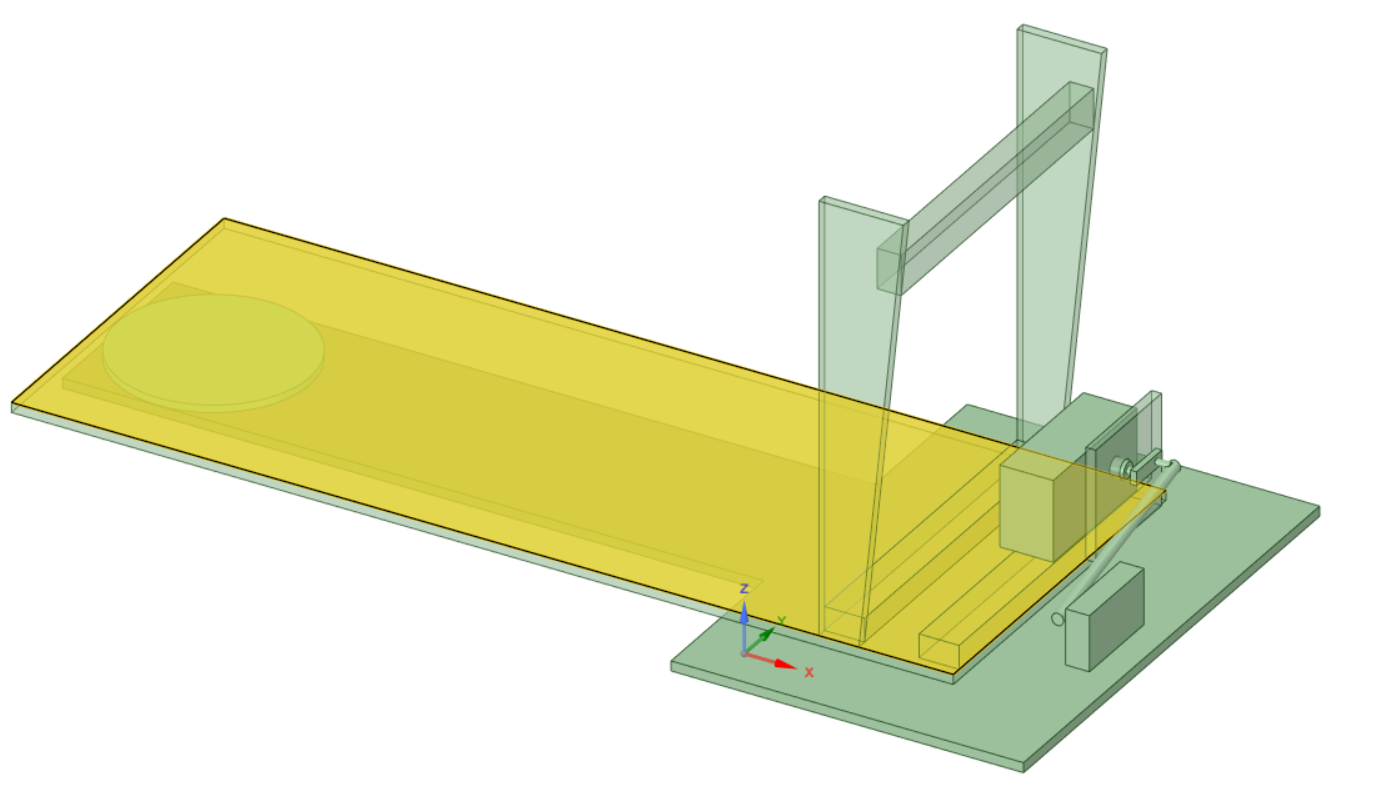

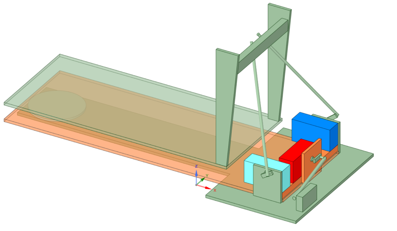

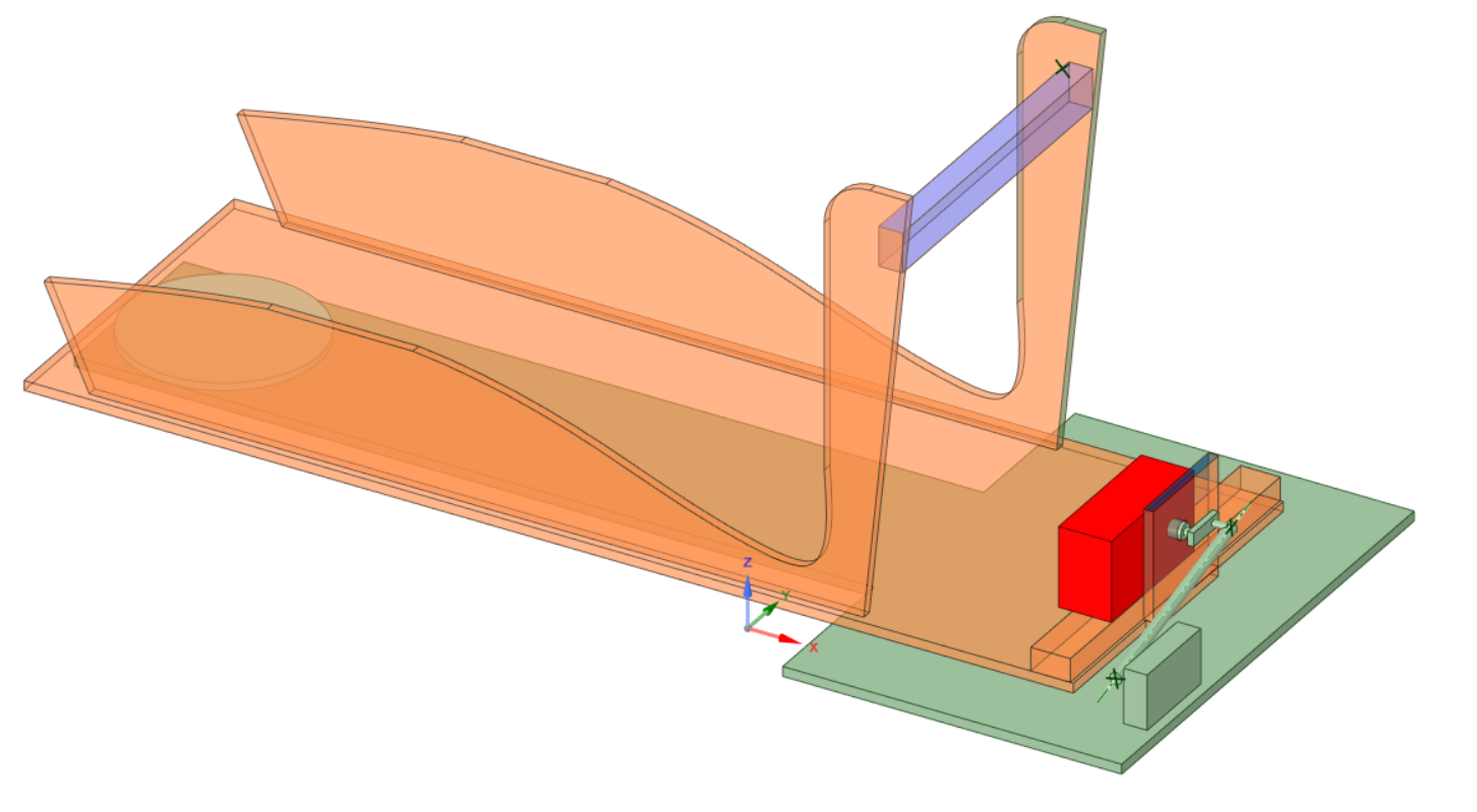

    I've been working on the design for the 1Dof with an eventual 3DoF upgrade path.
    Here is the model for the 1DOF. I'm mounting the TL motor to the plate that will go under the cockpit. The linkage connects to the base plate. The seat base will pivot on a 12" lazy Susan bearing under the brakes.

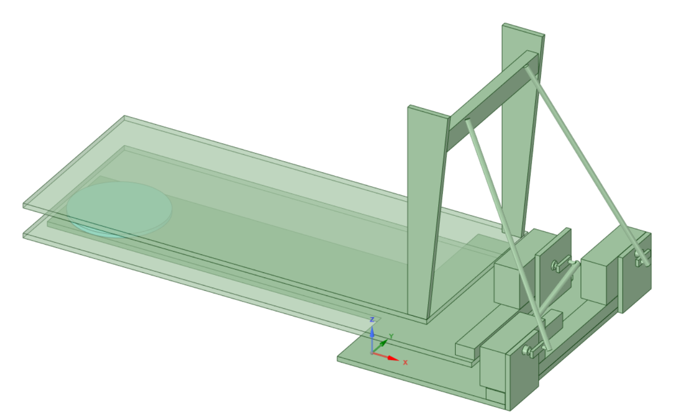

    Updated drawings. I moved the TL motor more to the center to accommodate upgrading this to a 3dof in the future.
    The bottom plate is 12" at the front where the lazy susan bearing is. At the back it is 32" wide.
    The top plate that the existing cockpit would sit on is 23" wide. That would give about 4" of swing from side to side for the TL motion.
    I have 5/8" flange mount ball bearings for a conveyor transfer table.
    I also have 52mm skateboard wheels.
    I've read that many prefer a higher durometer caster for the TL, but these seem like a bit more of a PIA to mount with how my design is coming together. I am concerned that the transfer table bearings will be noisy though.
    I may cut my plywood and try and take it to the next step in the next week.

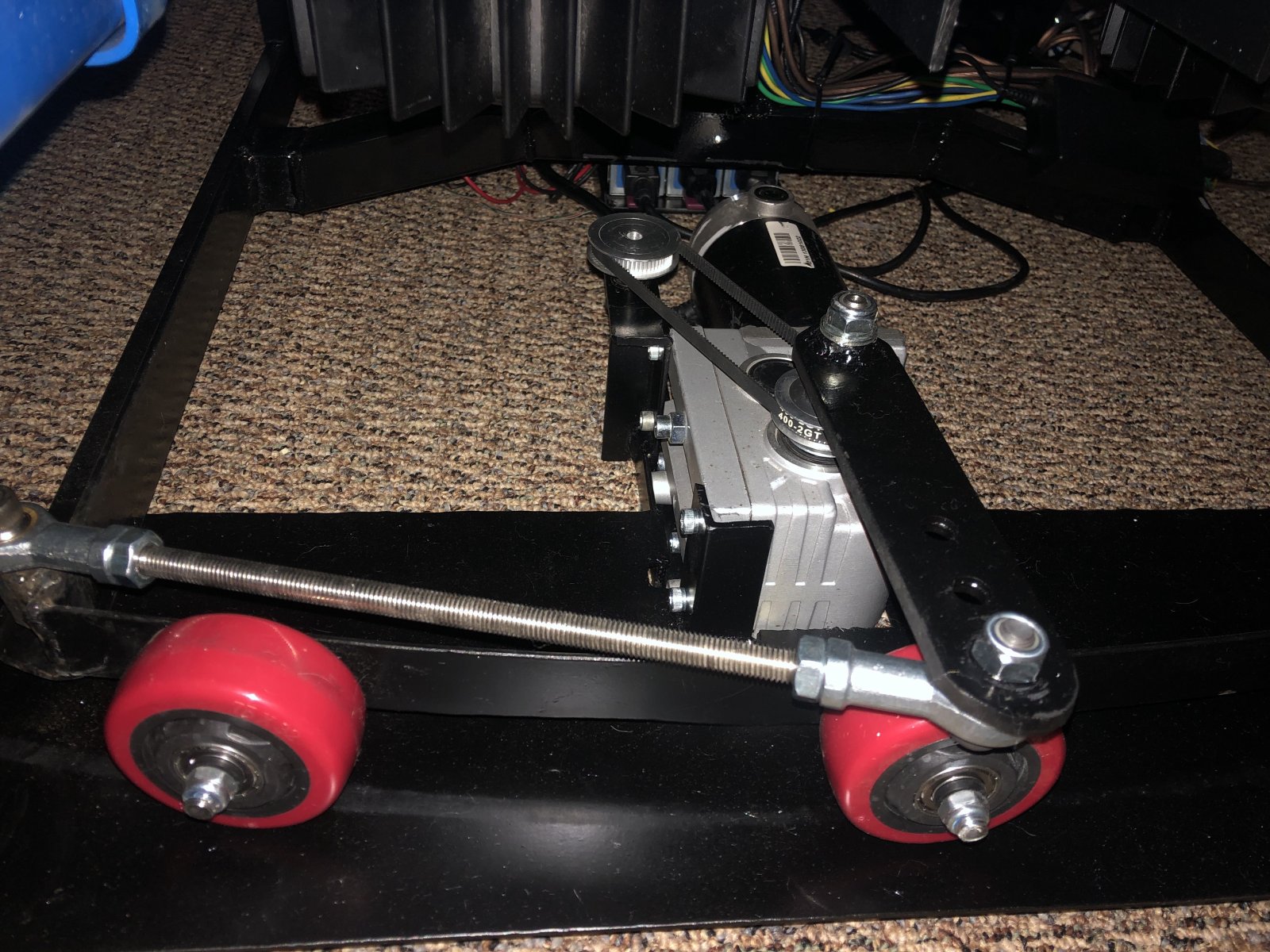

    Your rig is looking great. I just finished the traction loss for mine. I initially wanted to mount the motor just like your planing, on the moving seat plate. After some testing, I realized it was just adding more weight to the moving structure so I decided to mount the motor on the base plate that stays rigid on the floor. That way the linkage is just pushing/pulling the seat plate instead of moving the extra weight mass and it does it with much less effort. traction loss.jpg Here is a picture in case you like to reconsider redesigning that part.

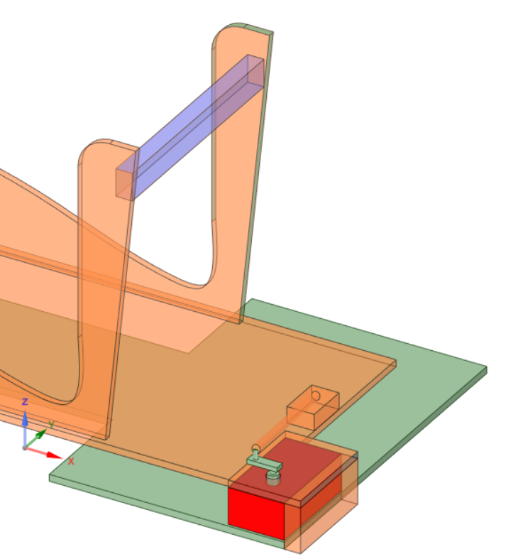

    I think reversing the locations should be fine and you are 100% right that moving the motor off the traction plate reduces the mass that needs to be moved. I'm trying to do this with a wiper motor right now and I'm not sure if that will have the muscles to accomplish this. I should probably just go to a bigger motor but I'm reluctant to spend more on that right now as I'm in proof-of-concept phase.
    I would have to think about the TL mounting location on the TL plate so it doesn't interfere with the other motors long term.

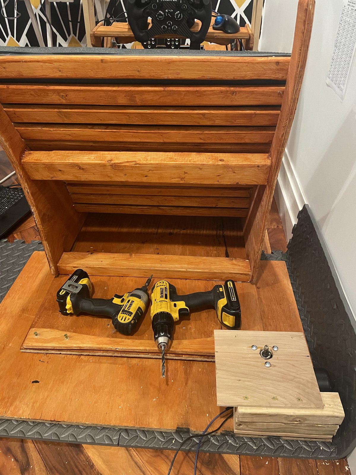

    Rotating the TL motor and offsetting it to one side.

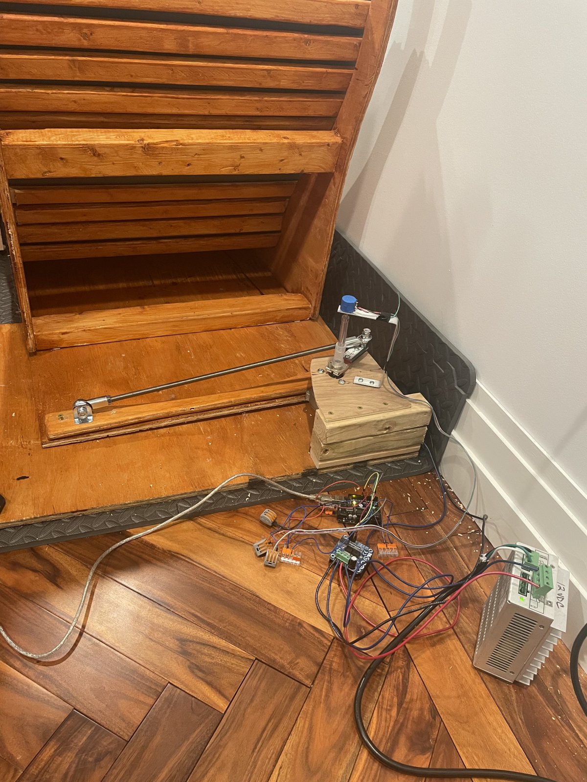

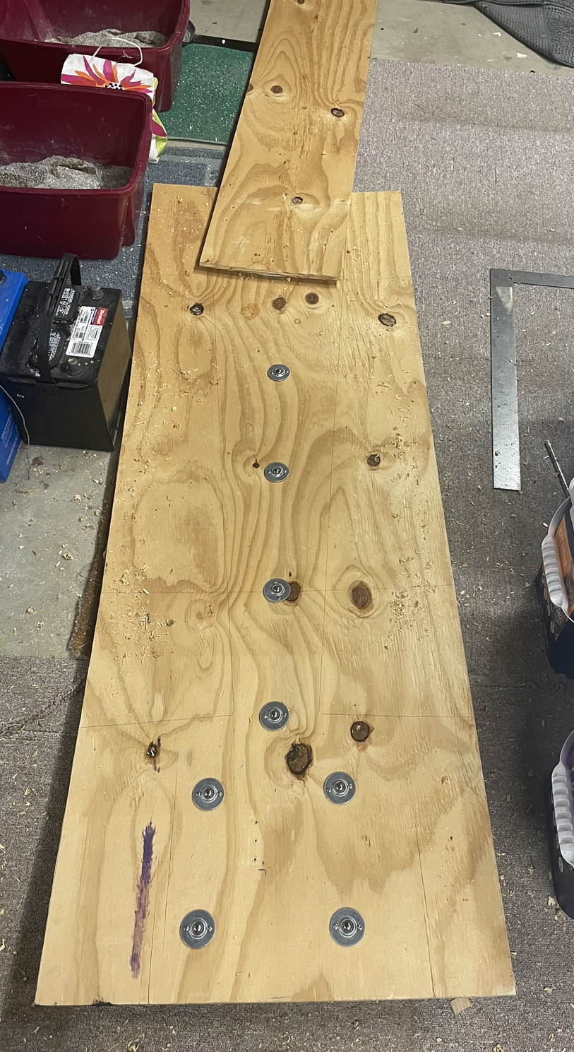

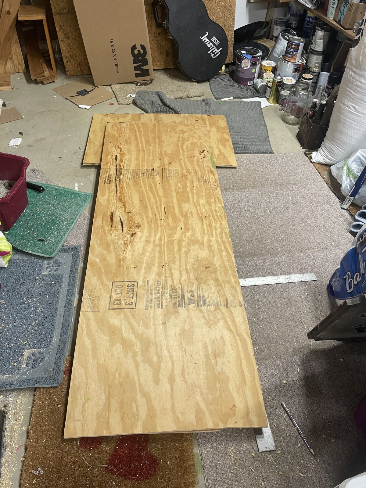

    So I built the base and TL platform.
    unfortunately my piece of plywood is warped, but hopefully once I get weight on it will be in better shape.
    also, I bought a makermotor which seems “better” than my wiper motor. At least it makes way less noise in SMC3. I need to get a shaft coupler and then make the lever arm, but I’m a little closer.

    I stained it this morning and then tried to wet it and unwarp it. Fingers crossed.

    The un-warping has been mostly successful.

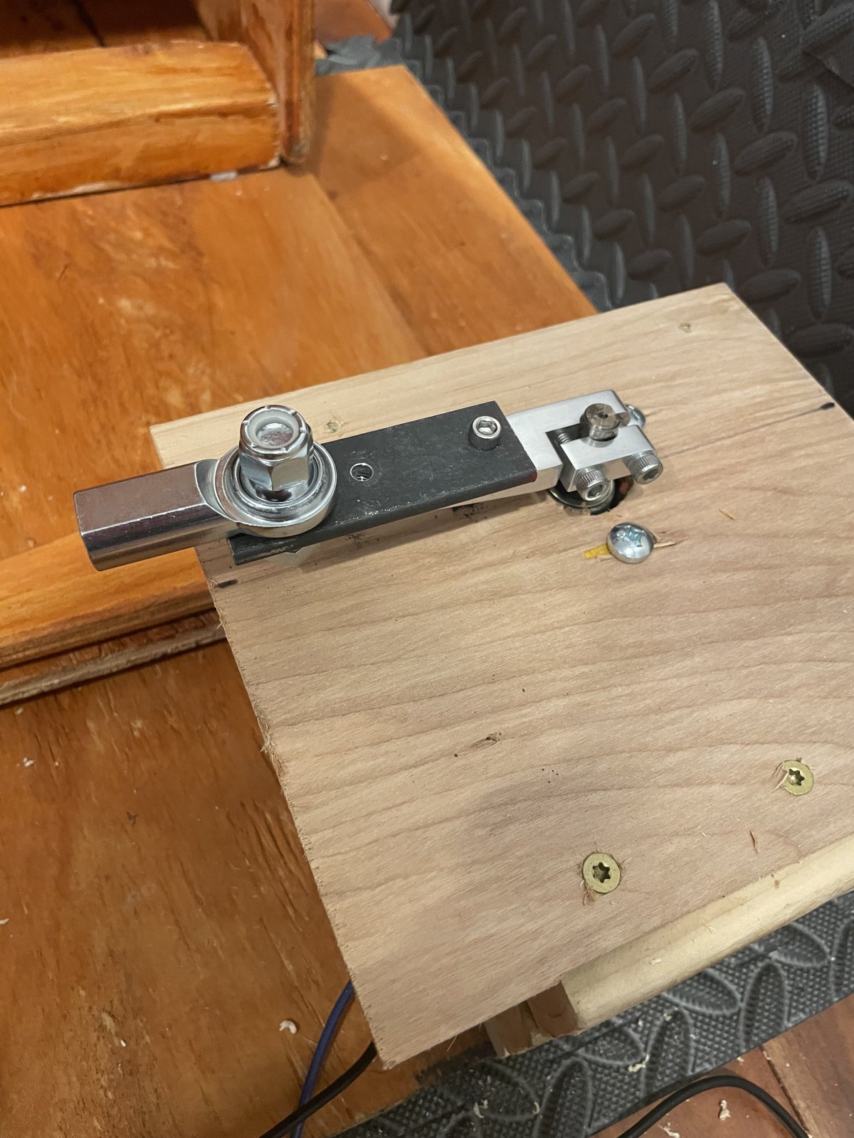

    The ball bearings are quite loud when moving the TL platform back and forth. Also, I need a solution for the motor “crank”. The motor has a D shaped shaft but no method of “locking” it. I think a clamp like Simulink sells would be the way to go. I need to be able to move the TL platform as well as get the potentiometer linked.

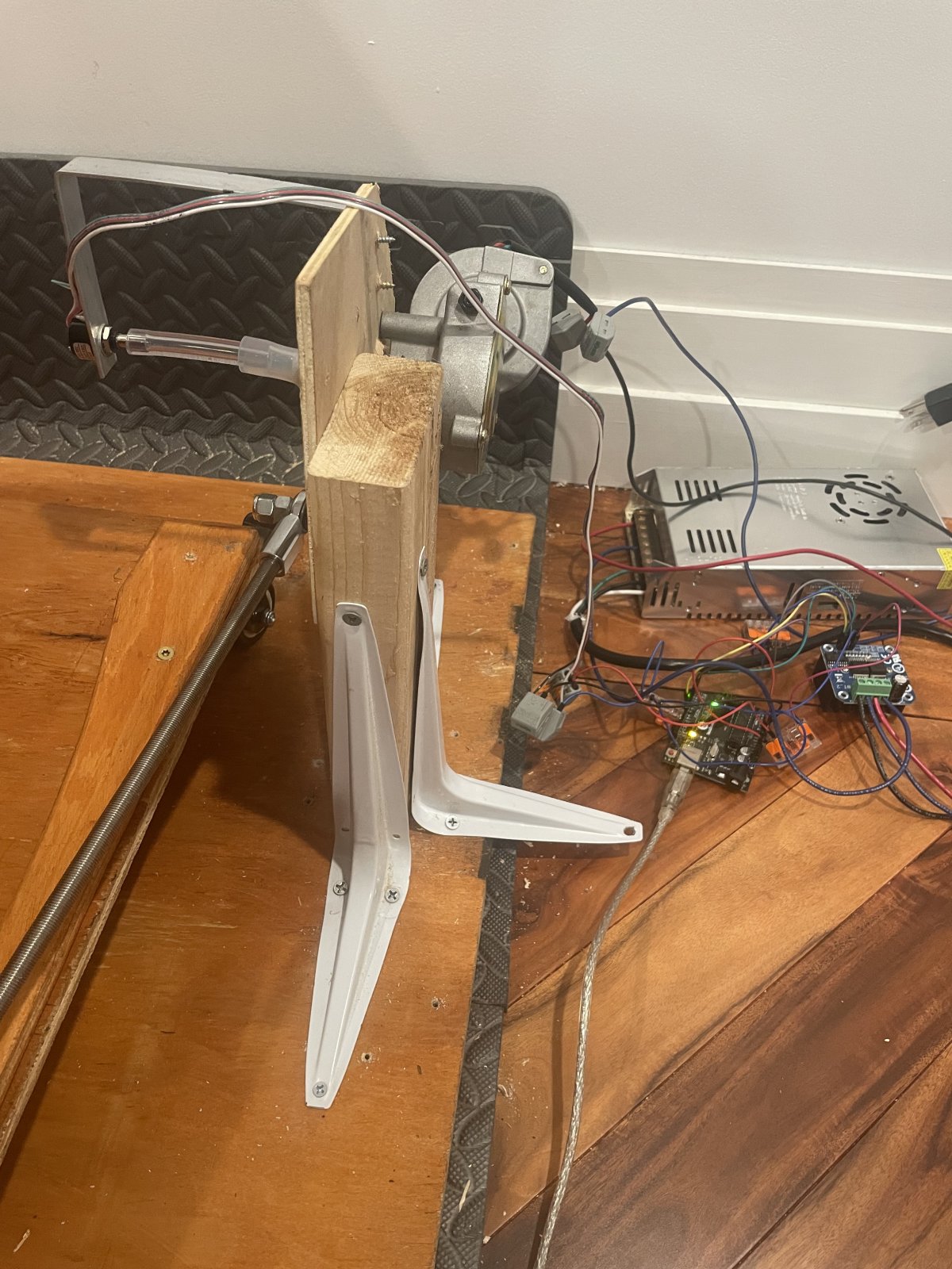

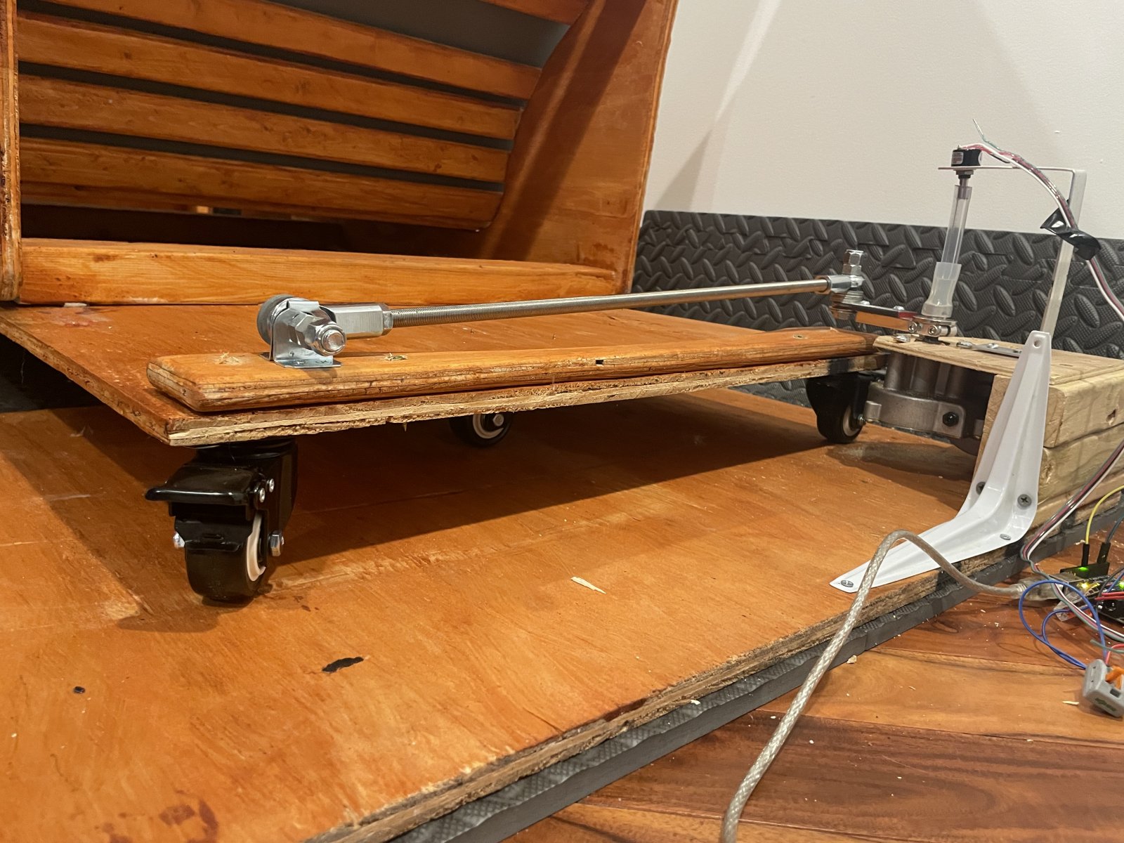

    Mounted the motor. The motor crank should arrive later today. I found an arm on Amazon for throttle body linkage that I hope works.
    The thread pitch on my threaded rod didn’t match my rod ends so I had to order a new one. Just another delay.

    DC motor, Arduino
    So the lever arm was delivered. It will probably work, but I had to make an adapter to accommodate the 3/8 bearing at the end of the rod end. I’ll need another bolt to secure it to the lever also, but I’m starting to see the light at the end of the tunnel.
    I’ll need to trim the wood near where the rod end is now so I have room for the threaded rod to drop to the TL plate or maybe I’ll just build up a mount. Not sure and I don’t want to induce any loading into the mount that would fail.

    Everything arrived and is hooked up!
    It even moves with me sitting in it!
    Now I have to tune it.
    And I’m thinking of replacing the roller bearings with casters. It is loud and also they seem to have created dents in the plywood that are detents that don’t help the movement.

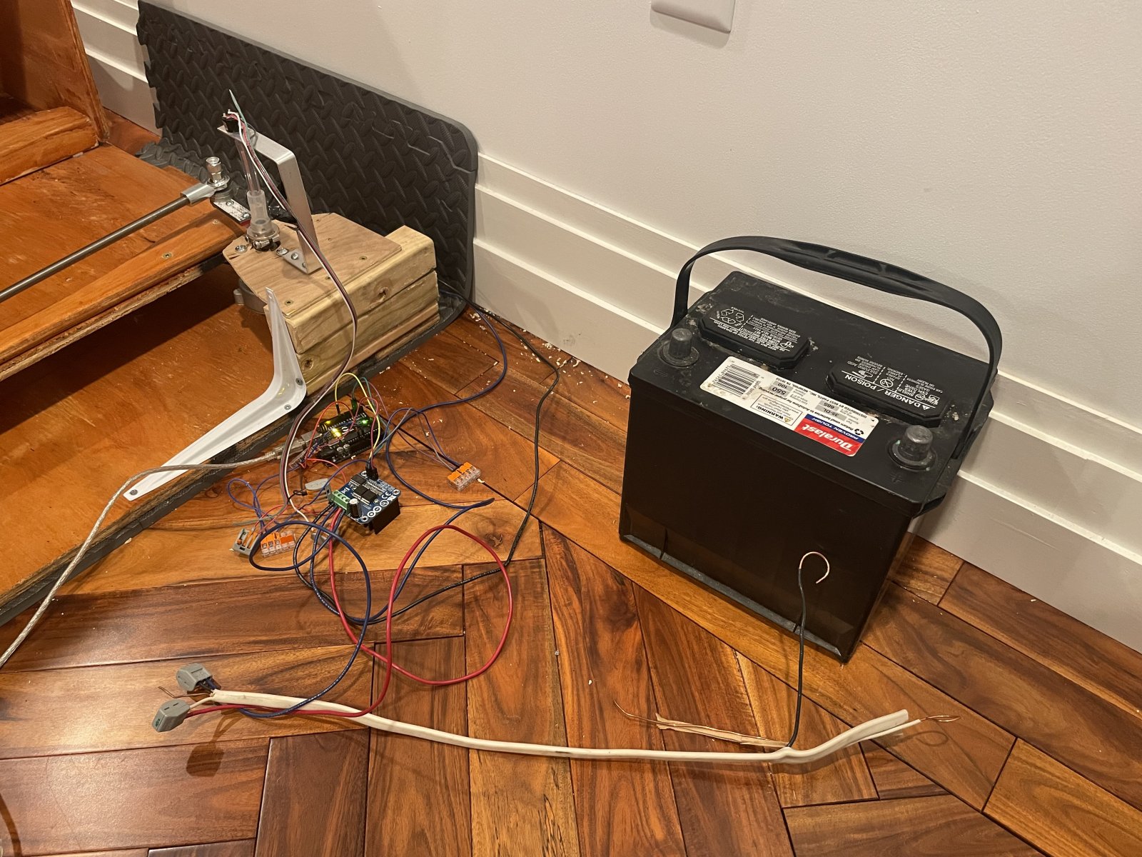

    Here’s a pic of the new casters under the TL platform. it is much smoother and quieter than the bearings.
    i had to build up a base between the bottom plate and the TL platform for the lazy Susan to mount to, but that wasn’t difficult.
    I ask noticed that my 8.3A PS was cutting out, so
    I took a page out of DMAX’s playbook and hooked up a car battery.

    The motor mount was not solid enough so I had to reimagine it. Seems more solid in some brief use.
    Also, the new 12V 30A supply arrived so no more car battery.
    Tuning is ongoing.
