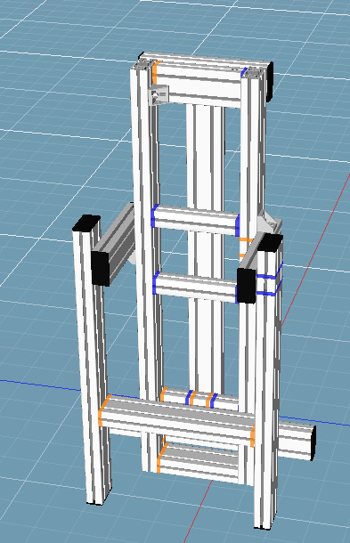

    Next step was finding xsimulator, I think it was after reading the forum for a couple of days I decided to jump in. I had decided to make a sim rig with aluminum profile for strength. Decided on 1DOF because it seemed easier and cheaper to start with only one axis and decided that the yaw movement was what I missed the most from driving. Another part of choosing traction loss is that I believe that it will be easy to build on top (literally) of it later, maybe adding an actuator in each corner. That would be a sim rig I would be really really proud of, but right now being tight on cash, noise level and space are a serious limiting factor. Talking about space, the last and most important call was making the rig foldable, I will lock my office chair in place while racing and when Im done I can fold down the wheel stand to store the rig and use the same chair to work on my desk.
    This would be the racing position to call it something, wheel and pedals like regular rigs, attached round the wheel I will also include one of my Oculus Rift sensors. IIRC having the sensor mounted with the rig should cancel any tracking problems, but I have also read about motion cancelation with controllers for different headsets. I would really apreciate it if someone could confirm that the Oculus Rift with the sensor mounted on the rig it the right way to go!

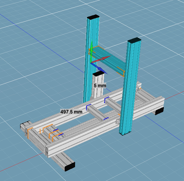

    This would be the storage position, the chair is removed the rig folded without having to remove the wheel or pedals. Ill have to make a box to add a usb hub to connect everything (wheel, pedals, rift sensor) as well as housing power supply, jrk and the wheels power supply.

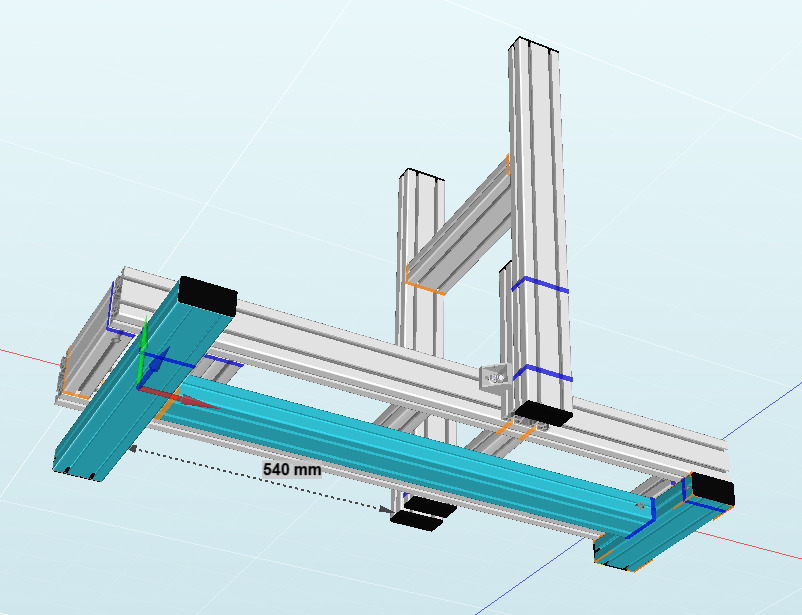

    This is a shot from below with the platform highlighted.
    The aluminum im buying from Motedis, seems to have everything I need and they ship from Germany. (I live in Spain).

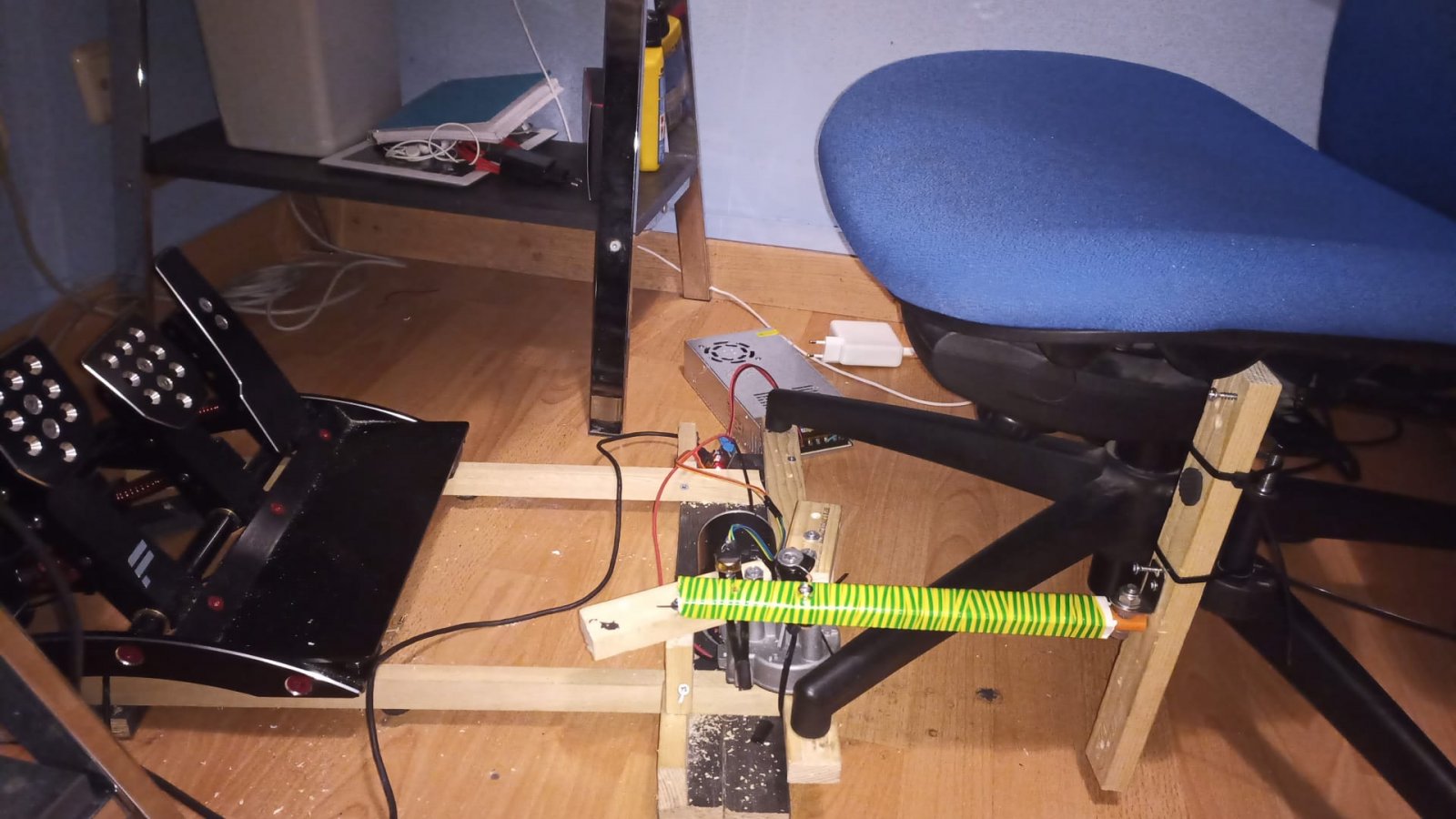

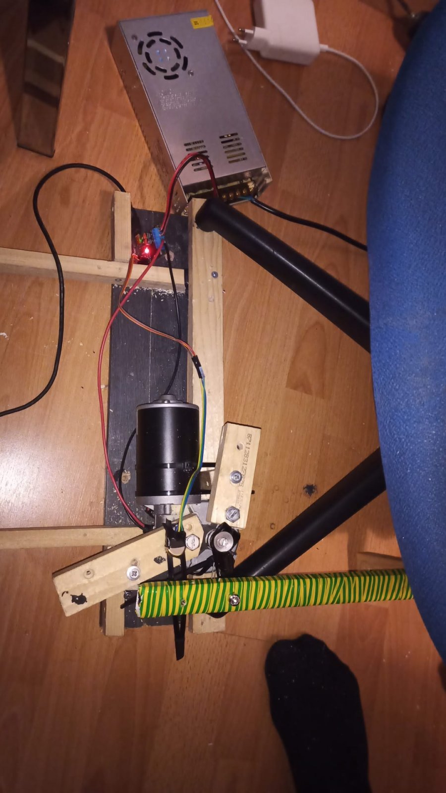

    So now I had the motor working, I was getting signal from LFS correctly so I decided to buy the aluminum profile and complete the build. Good thing was I could order everything I was missing from one place, bas thing was that due to the coronavirus Im not getting my order shipped until next week, so that leaves me with 10 to 15 days of having a perfectly working setup and not being able to feel it..... NOT REALLY, I went all McGyber and set up a sort of testing rig with my office chair, scraps of wood, pieces of gas tubing etc etc...
    It look a bit... not pretty, not at all.... but man, feeling only that small amount of movement... its just WOW, im completely sold on motion simulators, this looks to be the begining of a long upgrade journey.
