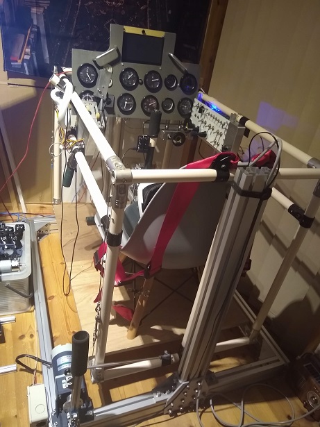

    Overview(PC and monitor is not included)
    My rig is for flight sim and roll direction only.

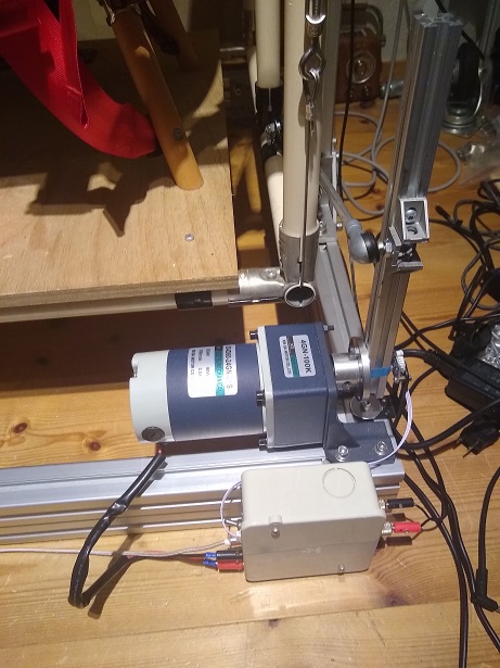

    Engine (60w DC motor and controller in white junk box)
    My lift is shaked by 30cm aluminum arm.Current position is 15 cm away from motor axis.

    BOM (Only for mortion simulator area and major parts only. I may missed something....)
    1.Lift
    φ28 x 900mm steel pipe x 4 (optionnal: +2 for enforcement)
    φ28 x 600mm steel pipe x 10
    φ28 x 200mm steel pipe x 2(optionnal: +1 for enforcement)
    L shape metal joint x 8 (optionnal: +2 for enforcement)
    T shape metal joint x 4 (optionnal: +4 and +1 extender metal joint for enforcement)
    600x450 plywood x 2
    2. Base
    800mm 4080 aluminum frame x4
    1100mm 4040 aluminum frame x4
    4040 corner bracket x 12 (Optional: frame joint bracket x2)
    M8 20mm Screw, M8 Spring nut, M8 spring and washer x 48(Optional: 24 for frame joint bracket)
    3. Axis
    swivel caster x2 (Need manual modification)
    M6 x 50mm bolt and nut(PTFE or Teflon type is recommended) x 2
    M6 spring nut x 8
    M6 20mm Screw , M6 spring and washer x 8
    4.Engine
    DC 24V 60W motor with gear(XD4D60-24GN-21S) x1
    Motor bracket x1
    10mm shaft adapter x1
    300mm 2020 aluminum frame x1
    250mm m6 rod x1
    m6 rod end and nut x2
    Metal joint for panel mount x1
    2020 corner bracket with screw x3
    5. Controller
    24V power supply x1
    Motor driver BTS7960 x1
    Arduino Nano x1
    Magnetic rotally encorder AS5600 x1

  9. GNZ3
    GNZ3 New Member
    Apr 8, 2024
    28
    Japan
    189Coins
    +16 / 0 / -0
    DC motor, Arduino
    I have posted movie to see how my rig moves.
    The input signal was triangle, motion and square. These signal was produced from SMC3 tool (thank you).
    You can check signal waves from SMC3 tool on top left.
    Please allow her to hide some area of my room.

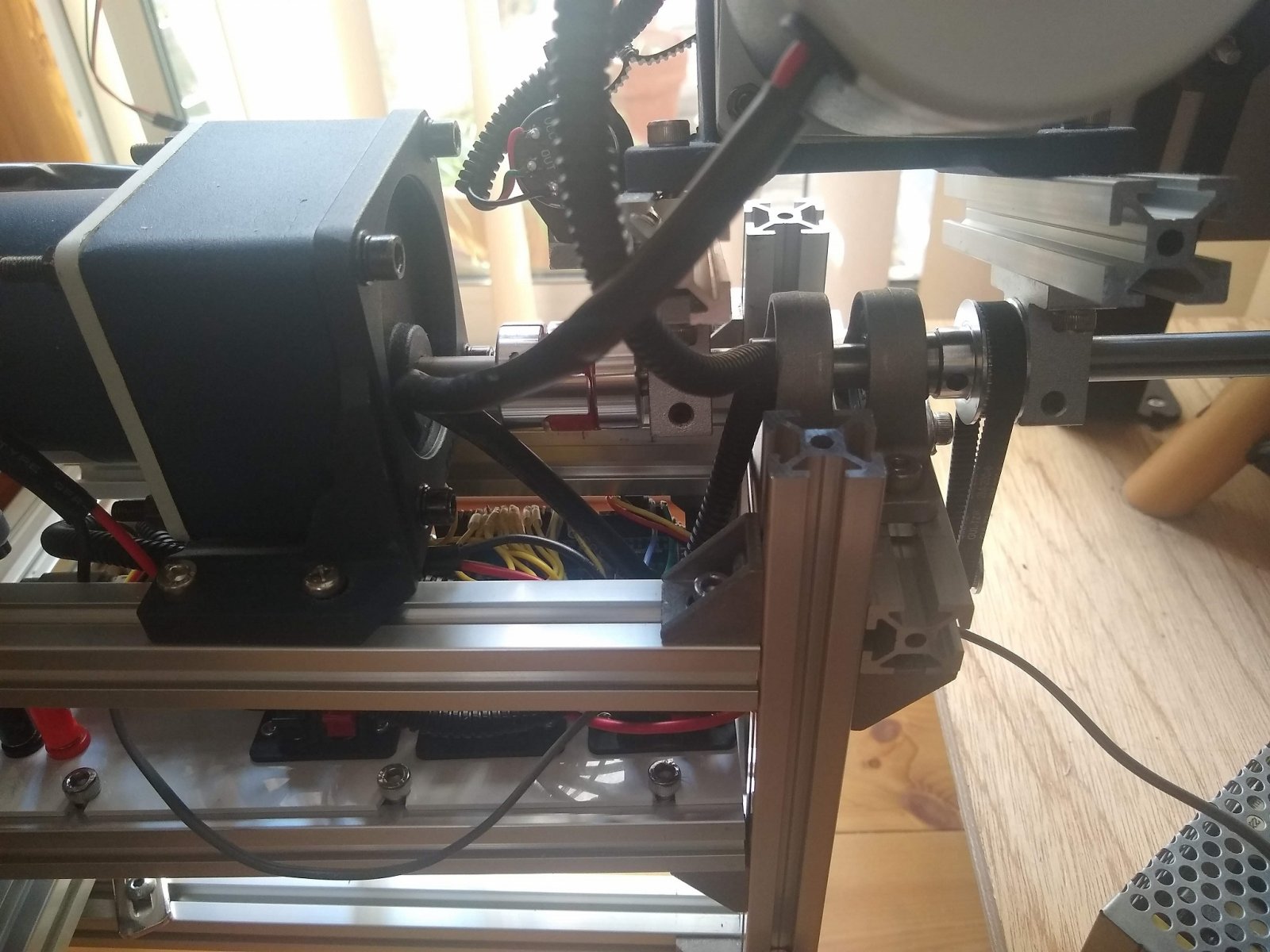

    Sorry guyes not updating this thread for a long time.
    I had been working on Force feedback rudder pedals, but I could not make it work.
    I realized that I do not know well about FFB.
    So I decided to build regular X-Y axis type of FFB joystick first and it done.
  18. GNZ3
    GNZ3 New Member
    Apr 8, 2024
    28
    Japan
    189Coins
    +16 / 0 / -0
    DC motor, Arduino
    Here is a video.
    First part, FFB effect was 100% and I needed both hand to control my air plane. Rest of the part, FFB effect was 50% and I could managed by single hand.
    You can find my code in Git.
    https://github.com/GNZ-3/ArduinoFFBJoystick

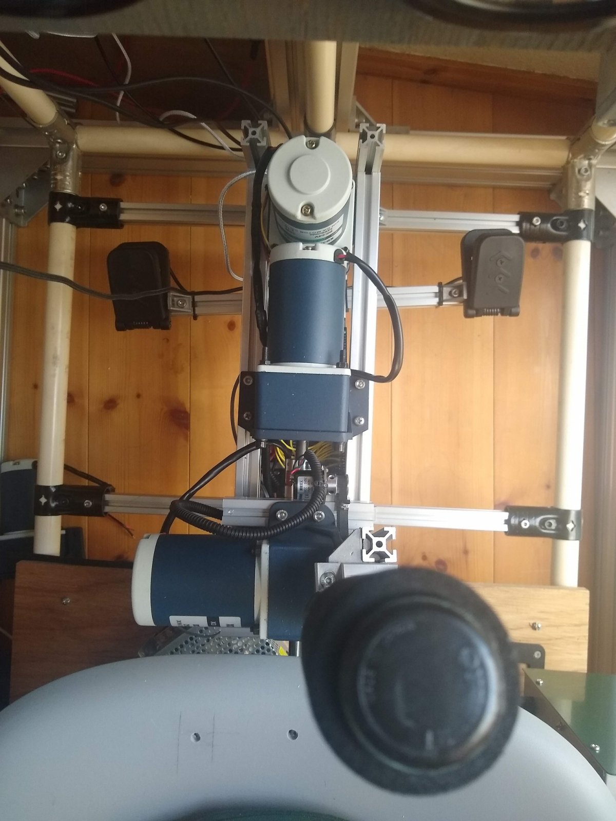

  19. GNZ3
    GNZ3 New Member
    Apr 8, 2024
    28
    Japan
    189Coins
    +16 / 0 / -0
    DC motor, Arduino
    Here is a overview.
  20. GNZ3
    GNZ3 New Member
    Apr 8, 2024
    28
    Japan
    189Coins
    +16 / 0 / -0
    DC motor, Arduino
    My design is to use geared DC motor and one axis motor is mounted on the other axis motor rod . You can see it right photo above. Pros vs Cons is below.
    Pros:
    1. No custom parts is needed (e.g. all parts can be purchased from Amazon.)
    2. High torque / low power consumption
    3. Easy to build
    4. Cheep cost
    Cons:
    1. Not smart look. ( Y axis motor is visible.)
    2. Some friction comes from gear (you can not move joystick so quickly)
    3. Shorter lifetime
    4. Difficulty to implement a movement limit
    5. Play of gears for joystick movement.
