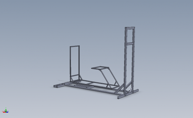

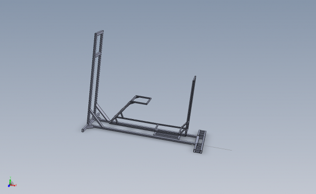

    I own a small custom cabinet shop (that is where all my toys come from) and have been using pen and paper to create my elevation drawings for years. I am struggling to learn a new medium for several reasons, one of which is that it is fun and this project gives me a very good excuse to learn.
    Anyway, after an afternoon of smoke coming from my ears I endeavored to produce these drawings. The motion base is drawn in ISO 20x30x2 tubing and the motion platform is done in ISO 20x20x2.2 tubing. I am actually going to use all 20x20x2.2 tube but chose the wrong size when doing the weldments. I can fix that the next time I go into the file. I do want to double check with the buddy who is going to do the welding, he is a professional fabricator who owes me a few favors. He really knows his stuff.
    I am going to do a mockup for these in wood just to make sure the fit is good for me (I am a very big guy).
    The extra tall framework in the front of the base allows me to mount a 55 Samsung 3D plasma up there, a few people have had pretty good luck using them for gaming and even if the 3D doesn't pan out I still have a 55 screen! :D And if I am especially good it might be fruitful and multiply, lol (it could happen...).
    EDIT: Just got official permission to use the 55 Plasma for the motion pit!! :)

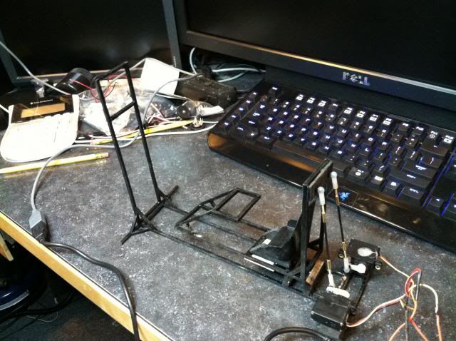

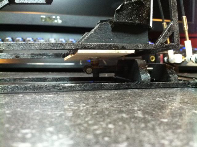

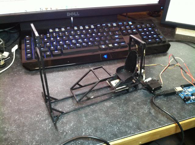

    Please excuse the crudity of the miniature prototype motion rig. I was rushed for time.
    As you can see, there is plenty of room in this design to add more monitors beside, above and below the main monitor (well, not really below the 55, lol).
    I too am attempting to move my platform using the arduino and R/C servo setup ala eaorobbie and aarondc.
    But I hit a snag. Unfortunately the script does not seem to work with X-Sim 3 (which all that I have access to at this time). Not sure what is going on but I am sure it is my fault. X-Sim 3 does not recognize any input from the Arduino on the serial port.
    Anyway (again), here is the miniature prototype. I used a ball link as the center pivot and like Rob, I used ball links on the servo arms and seat mounts.

    Still beating my head against the table trying to get Rob and aarondc's arduino script to work.
    X-Sim 3 is setup for left and right actuator, I am receiving telemetry from the game (using Race 07 for testing), USO see's the arduino and I have the comm settings correct (I think).
    I am pretty sure the script is working as for controlling the servo's as both snap to their mid-points when I start it.
    Am I forgetting something?

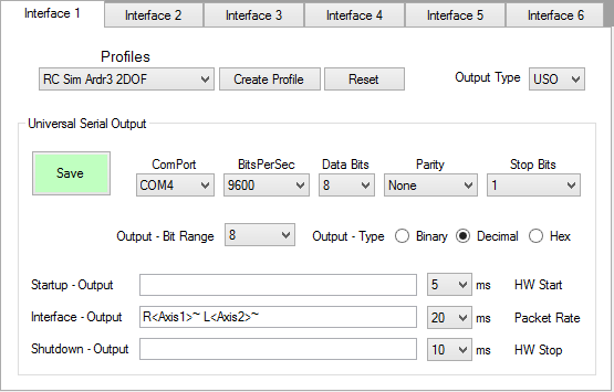

    Ok the data packet to send for this a little different in Xsim.
    1. set up the maths for 2 axis.
    2. then set the uso for each axis, I would send a pic but since being removed from xsim I no longer have access to xsim, lol, sim tools is way better anyway.
    3. In uso you will need 9600, no paraity, 1 stop bit. on the comport set on the ard plus needs to 8 bit, dec.
    4. The datapacket to send in xsim is R~a01~~ L~a02~~.
    Should work, use to move with my first code with the datapacket to send as R~a01~ L~a02~.
    Try to catch me on Skype where I can kindly give you one to one information, anytime Im online.
    Sorry will not post xsims information as I no longer support that software in a public way.
    Maybe ask Rene nicely for access to sim tools and I will gladly post the screenshot showing the setup information.

    Ok once you have Sim tools installed, its fairly easy to set the axis assignments to the way you want it to move. Then set the interface settings to this, and with Aarons last revision is where I did video test, of his revised code. Then test with the output, once happy, as if the packet rate is too quick as in ms then the movement can be a little crazy so it can be adjusted by this. Then patch a game for motion and test the model with profile editor. Can explain more but once you have access you will see the write ups take time to read them.
    Welcome to Beta :cheers:
