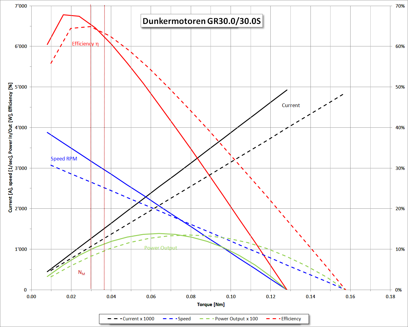

    If you compare two motors of the same spec but one with different nominal RPM you will see that the motor with the lower nominal RPM has
    • higher nominal (continously applicable) torque (dotted line MN at 3.7 vs 3.0 Ncm)
    • higher starting (maximum) torque (point, where the three lines cross the x-axis at 15.7 vs 12.7 Ncm)
    • is more efficient at lower speed (see dashed vs solid red line).
    Bild.png However with 180W power you have enough buffer to compensate for the lower efficiency :)
    And the position is controlled by your driver (jrk, amc, whatever) and not by the motor. So the driver will just issue less or shorter impulses to mover your sim.
