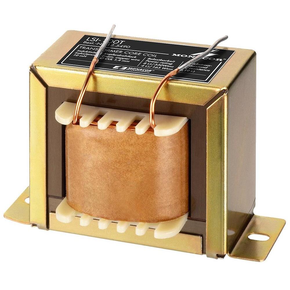

    7. is there difference between Switching power supply and PSU?
  3. RacingMat
    2,237
    21,020Coins
    switching refers to technology inside the Power Supply Unit
    it's electronic transformer versus coiled transformer
    65W_Open_Framed_Single_Output_Switching_Power_Supply.jpg versus 1331868_00_1000.jpg
    21,487
    150,542Coins
    +11,017 / 55 / -2
