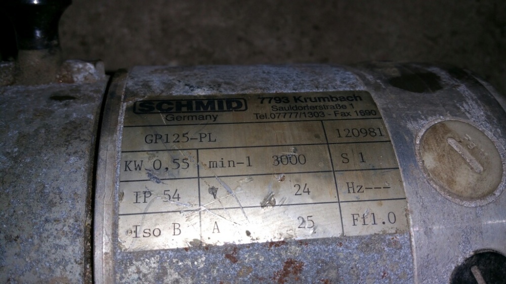

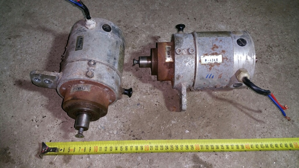

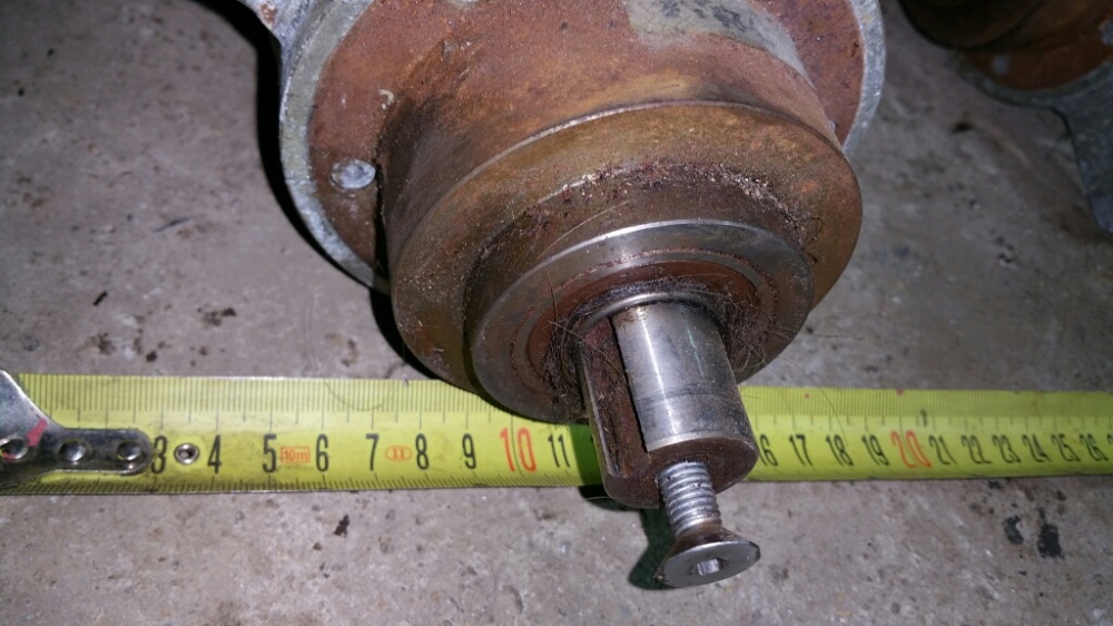

    I have been planning to build a 2DOF for some time now and i have been also gathering info and materials.
    I have just found some motors that i like but i do have some concerns. I would really like to hear your opinion about them.
    Motor specs (written on the plaque on them):
    24V/25A/0.55KW
    3000RPM @ motor shaft
    125RPM @ output shaft
    Things that i like:
    They seem more industrial orientated rather than consumer orientated: general construction, removable brushes, 25mm shafts with key, waterproof connections,etc
    Made in Germany by what seems to be a reputable company. This makes me trust the specs on them.
    Things that i have concerns about:
    125RPM. I saw that most of builds use motors in the 50-60 RPM range. These are double that.
    Gearbox seems to be planetay and not worm driven. It might move free if not powered on.
    Please ask me any questions if further details are needed.

    DC motor
    The motors are more than 30 years old:eek: Where did you find them?
    With 125 rpm you can go really fast, also with the 550 W:thumbs Huge G-Forces.
    Cannot say anything about a planetary gearbox, sorry. But the rest should be fine.
