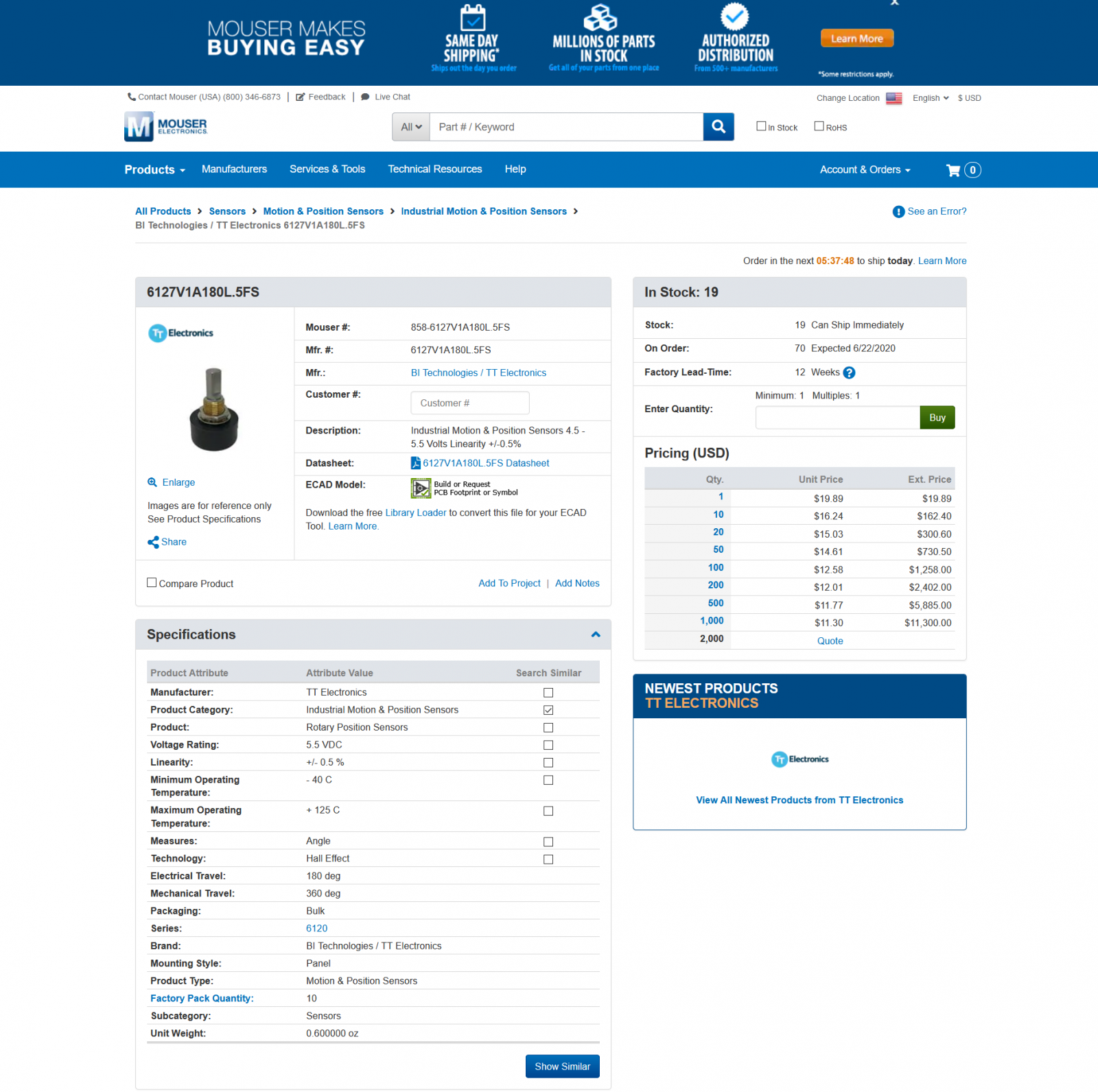

    the one over on Digikey are on Backorder,I put the part number in on the mouser search..came up with the Sensor? will it do? are they the same?...Also looking @ the Shaft on the Sensor..It has that little cut out ..instead of it being a full round shaft..At the end..Does this cause problems when using the flex connector set up..

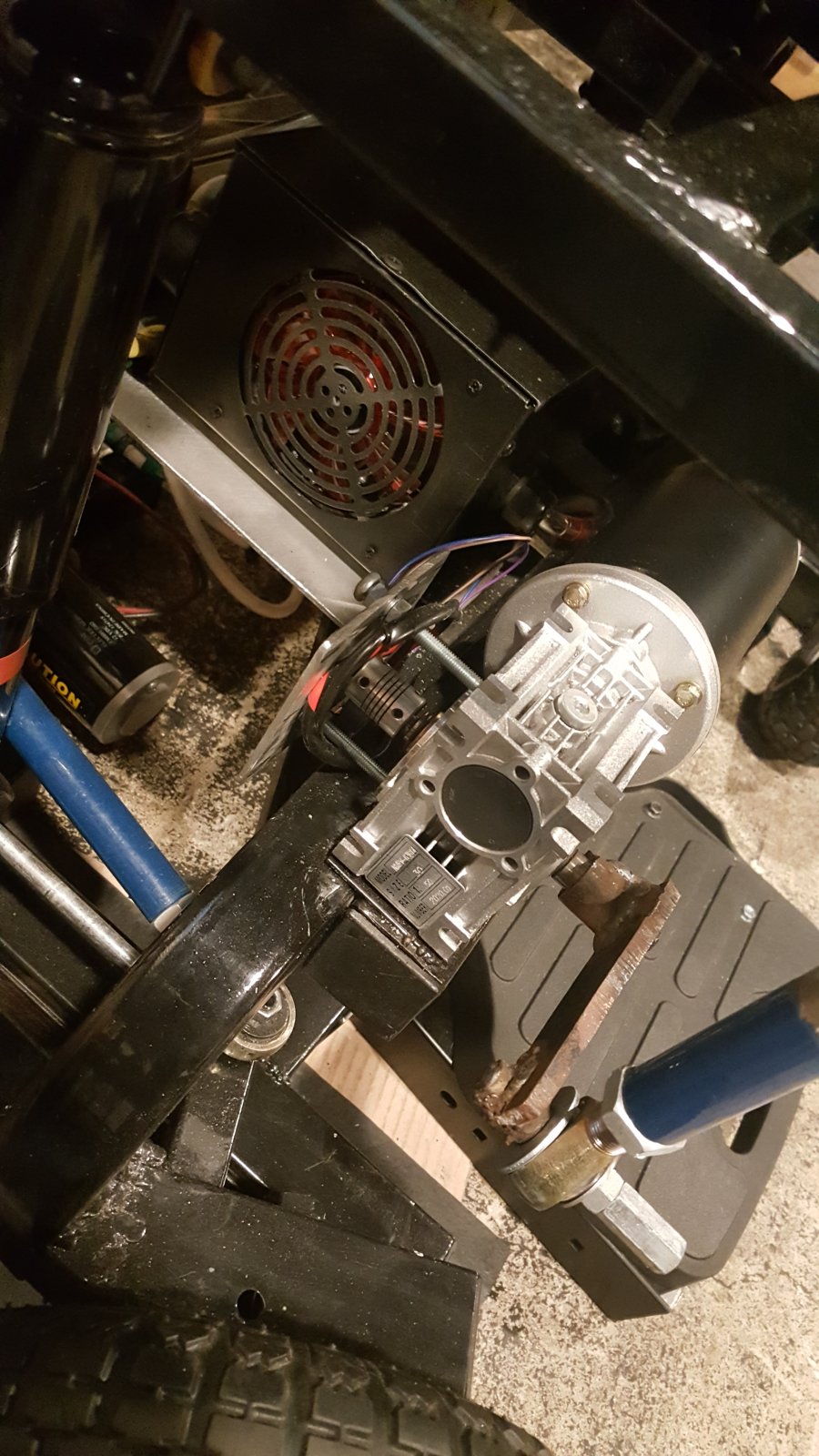

    I'm not sure what your build is like, so I'm not positive this one will work for you. This model is 5 volts and has a 180 degree rotation range. It actually turns completely around freely, but it only senses position for 180 degrees. So you need to make sure that is okay for you. For most sim's that use a lever arm that works great.
    The flat spot is helpful to keep the sensor shaft from turning separate from the motor. Ideally you would have set screw locking into the flat spot. But even if you don't have a set screw (I don't) it helps a little to keep the motor and hall effect sensor aligned. It is also make it easier to see where the zero position is.
    Here is my setup with a piece of hose attaching the motor shaft to the hall effect sensor with a short piece of hose. If things malfunction and the motor just keeps spinning, the linkage will hit the hose and pull it off the hall effect without breaking anything. It is just friction that holds that end together. I have enough clearance the motor lever won't hit the ground or any structural piece.

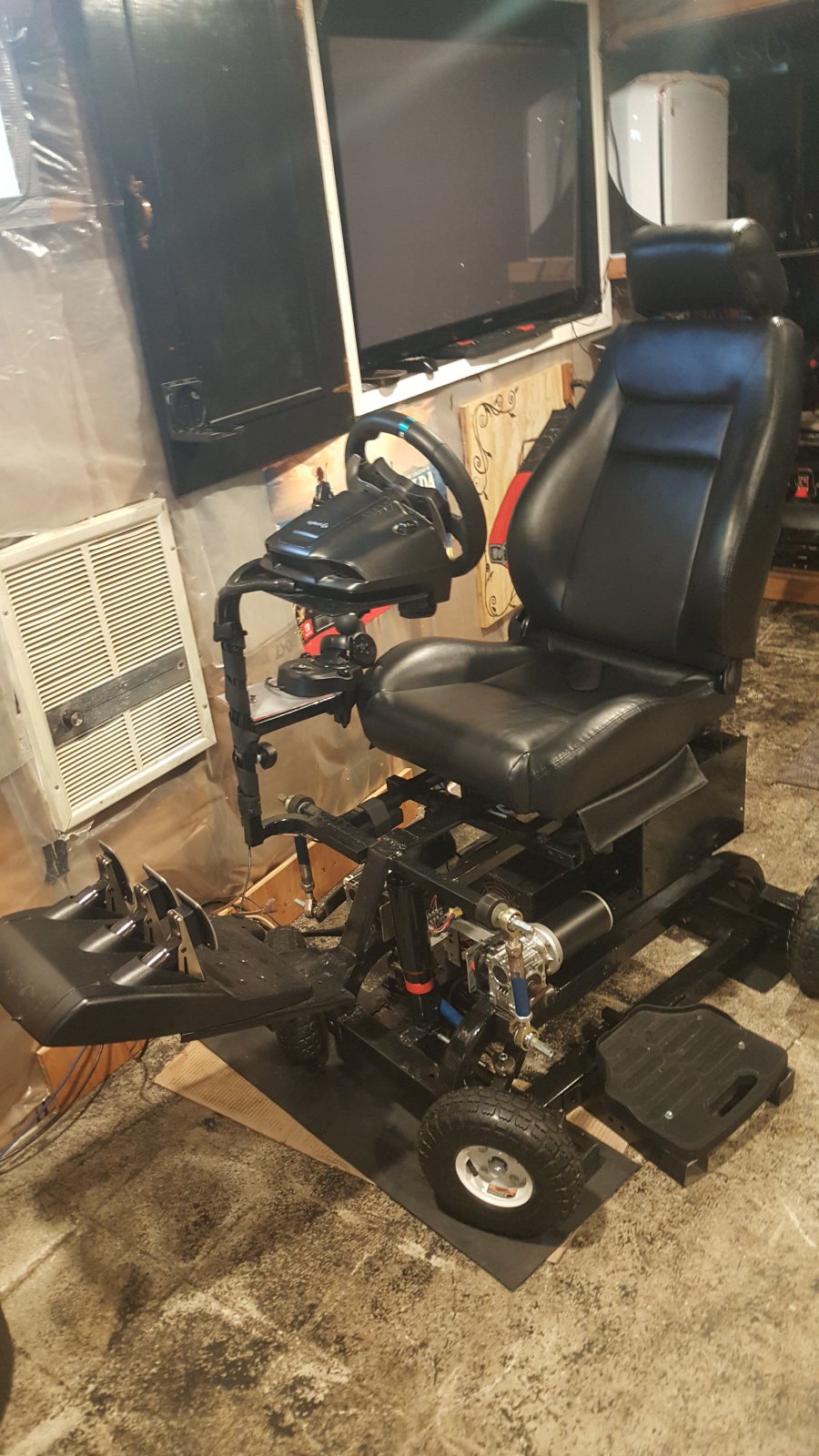

    Thanks for all the help...Yeah I got mine set up like Dof Reality..and I use the set flex coupler..works great..I won't build another one of these type gear motor builds without them now...So they're the Hall Sensor I need to Buy...Cool..awesome..Thanks so much ..everyone..for the input..:cheers

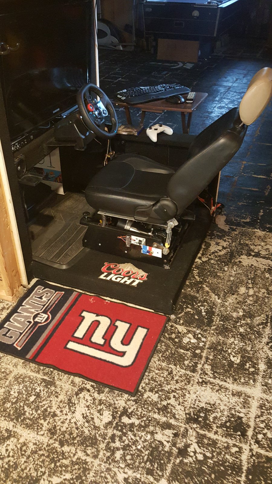

    Here,s my 2 DiY builds...One set up for just Vr ..the other one under the stairs is more set up for Arcade style flat gaming....but,is also Vr...but..I like both Styles of Gaming...
