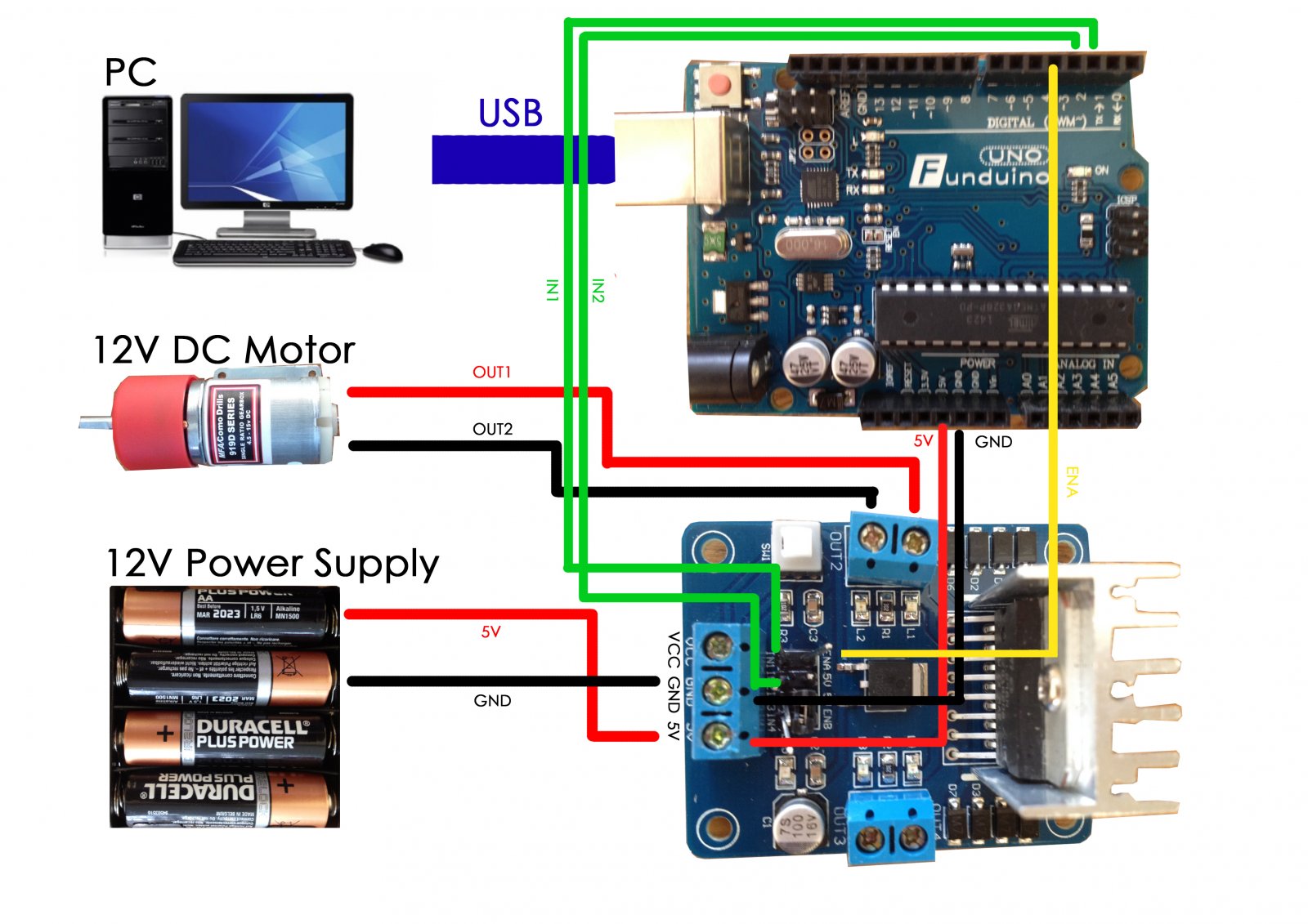

    I have bought some parts just so i can test a small setup. as below.
    I have looked at most of the tutorials on line on how to wire all this up but dont seem to be getting anywhere. everytime i plug the funduino board into my laptop, the laptop switches off completely.
    Here are the parts and how I wired them together. Any help or guidance please.
    Thanks,
    Tom
  12. eaorobbie
    20,504Coins
    +1,687 / 23 / -2
  13. Thomas Harvey
    Thomas Harvey New Member
    Aug 15, 2014
    8
    110Coins
    DC motor
    Yes a model first of all and then step it all up when i understand it all a bit more.
