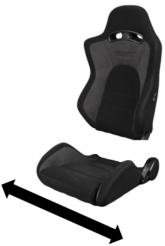

    I want to build an otherwise static rig except with a 1 DOF seat. The idea would only to have the bottom of the seat move, while the back remains fixed. The motion would not be far, maybe +/- 2 inches horizontally. The seat will rest all its weight on a base supported by ball bearings. (or something similar)
    The goal is to have the seat bottom provide feedback similar to what the wheel does. Not to much to throw you around but enough that you get a "seat of the pants" feeling.

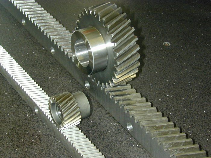

    - Helical rack and pinion (rack bolted to bottom of seat platform)

    Images are just stand ins, not actual items. Would love to hear your opinions.

    Consider moving the back and not the base. I would think it would be lighter with less mass to move. Thats what stirling does anyway.

    This weekend I spent time with the wife going over whether to move the back or the base. The problem for with moving the base is weight, and developing of a base that can move freely in a stable manner. Hands down I think the back is the simplest and most proven way to go. Which is why we ended up looking for a solution for doing the base. If nothing more than providing some lessons learned.
    Fortunately we have a positive direction we are going with. We discovered that small movements to a base with a stable back are super communicative to the user.
    The "possible solution" we tested were with a 6 way power car seat base. These frames are built in a way that allow for multiple degrees of movement, existing track framework and above all else support the weight of the user. As of now small motors offer plenty of strength to move the user. The movement of the base alone provides positional information, combined with a fixed back gives a feeling of a g-seat with sustained forces.
    As of right now the intention is to rotate a power seat mount 90 degrees. The original forward and back motion will become sway for longitudinal G forces (The most important for this application). We also plan to test implementing heave as well with a second track. The 6 way also leaves small pitch and heave function that could be used.
    Being able to use an existing structure will bring the complexity and price of the build down greatly. With smaller inputs than a traditional seat mover I think this will fit this project right in between simvibe and traditional motion simulators.
