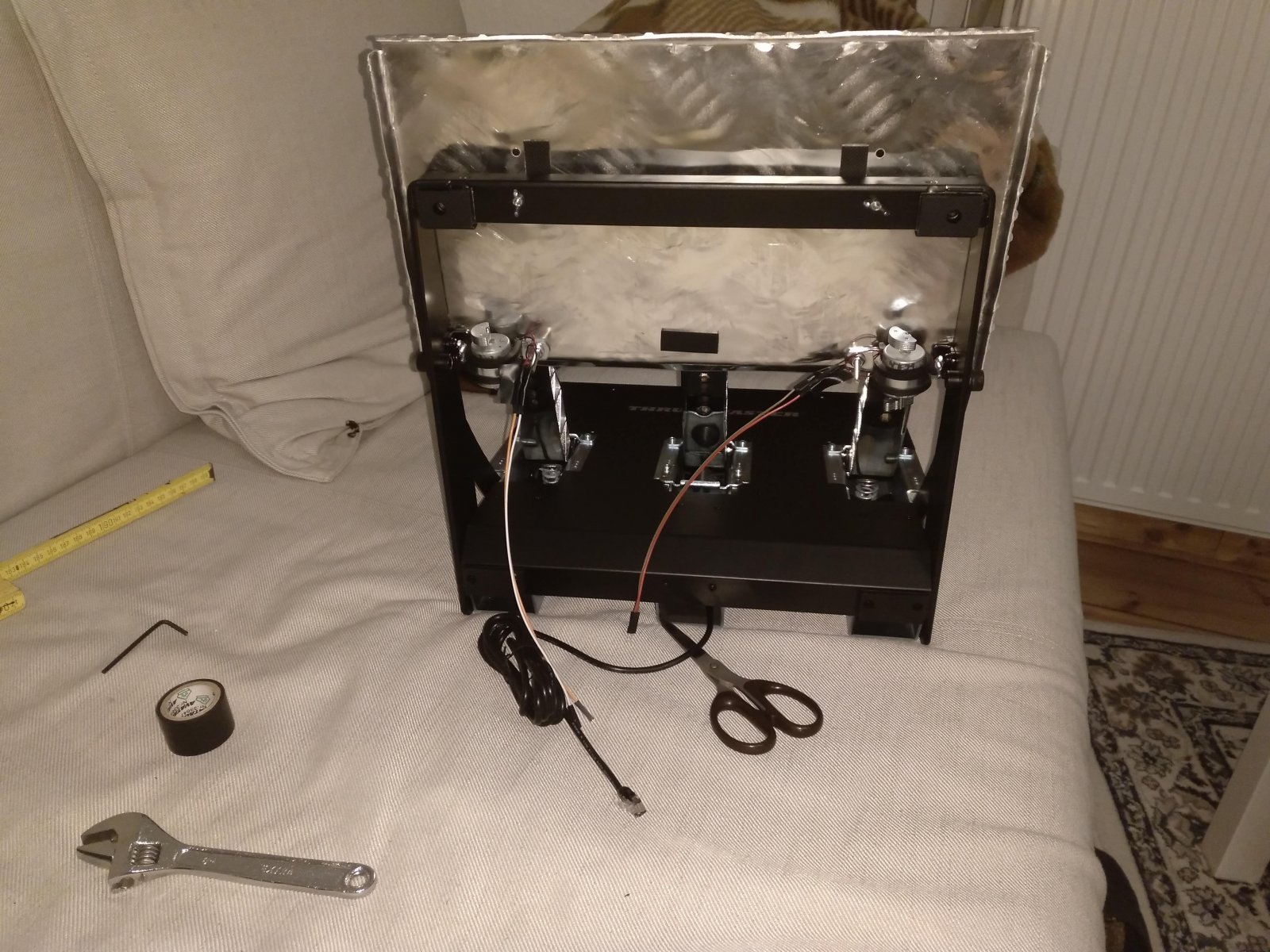

    Let me try to tell you about the FFB effects I managed so far:
    - motor RPM / wheel slide in gas pedal (1 rumble DC motor)
    - ABS stutter / wheel lock in break pedal (1 rumble DC motor)
    - front right vibration / shift "knock" on pedal mount vertical backside (2 rumble DC motors)

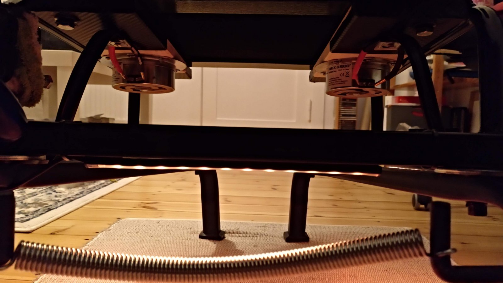

    - front left / right vibration ("road texture") on pedal bottom plate (4 rumble DC motors) IMG_20190124_212120_529.jpg IMG_20190124_224534_403.jpg

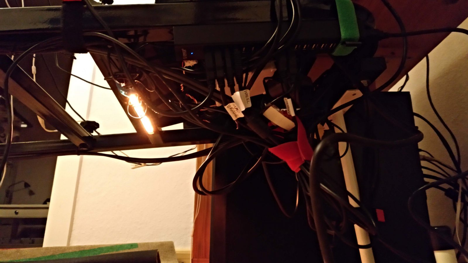

    - Road texture / bumps / curbs etc on 2 x 100W bodyshakers (DIY buttkicker) @H&K amp IMG_20181120_184129_565.jpg

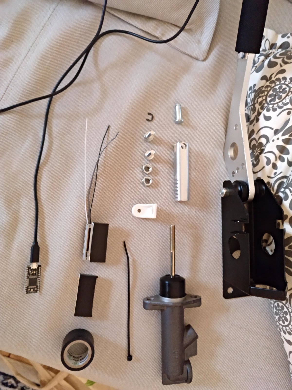

    accessories: Sparkfun Pro Flyoff Handbrake DIY from

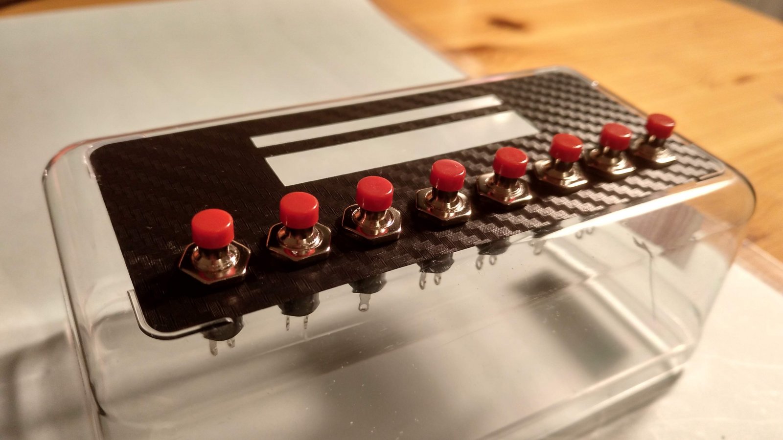

    Button box DIY from Ferrero Rocher box :D IMG_20181028_231910_836.jpg

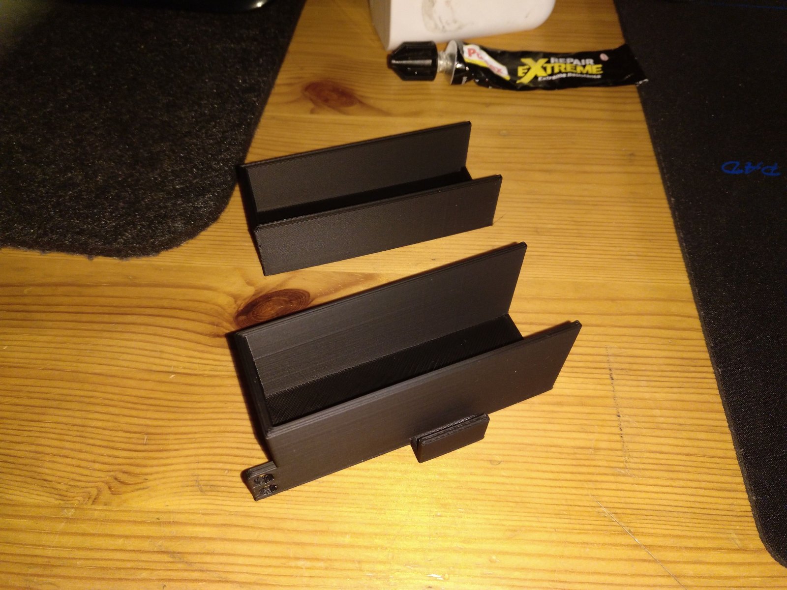

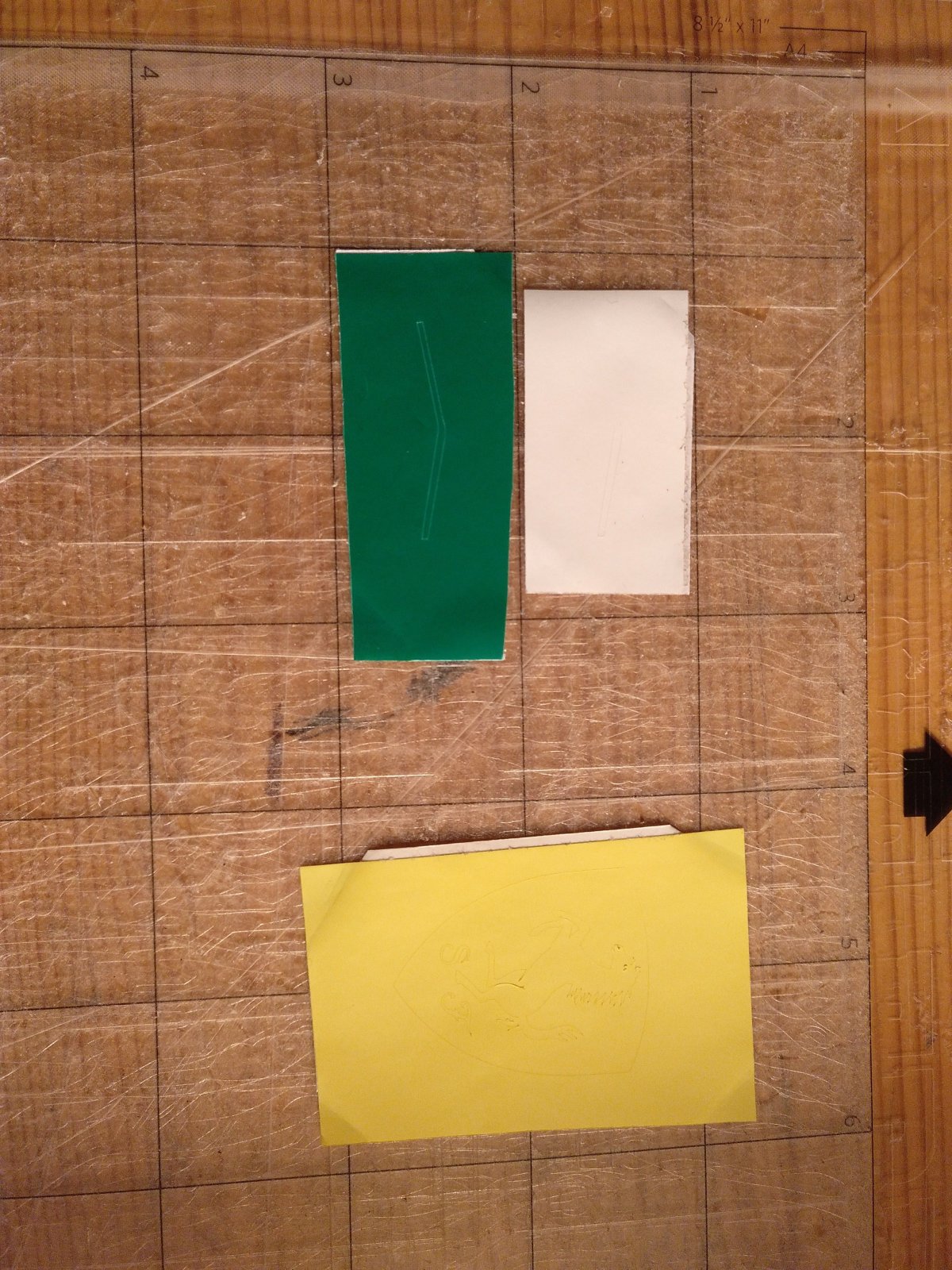

    I enjoy 3D printing accessories and parts like Arduino cases, mounts, holders etc and cut-plotting vinyl foil IMG_20190111_232701_511.jpg IMG_20190119_185004_193.jpg IMG_20190119_192041_344.jpg

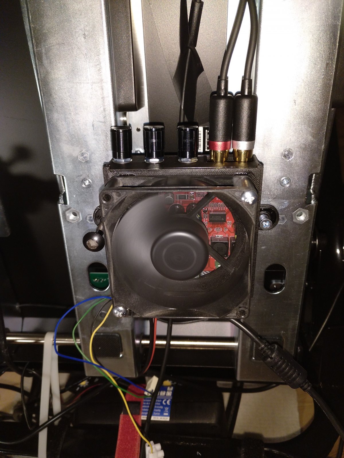

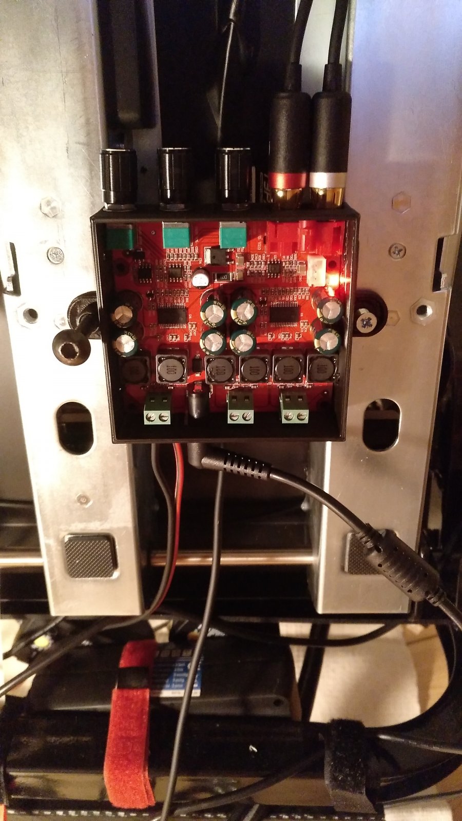

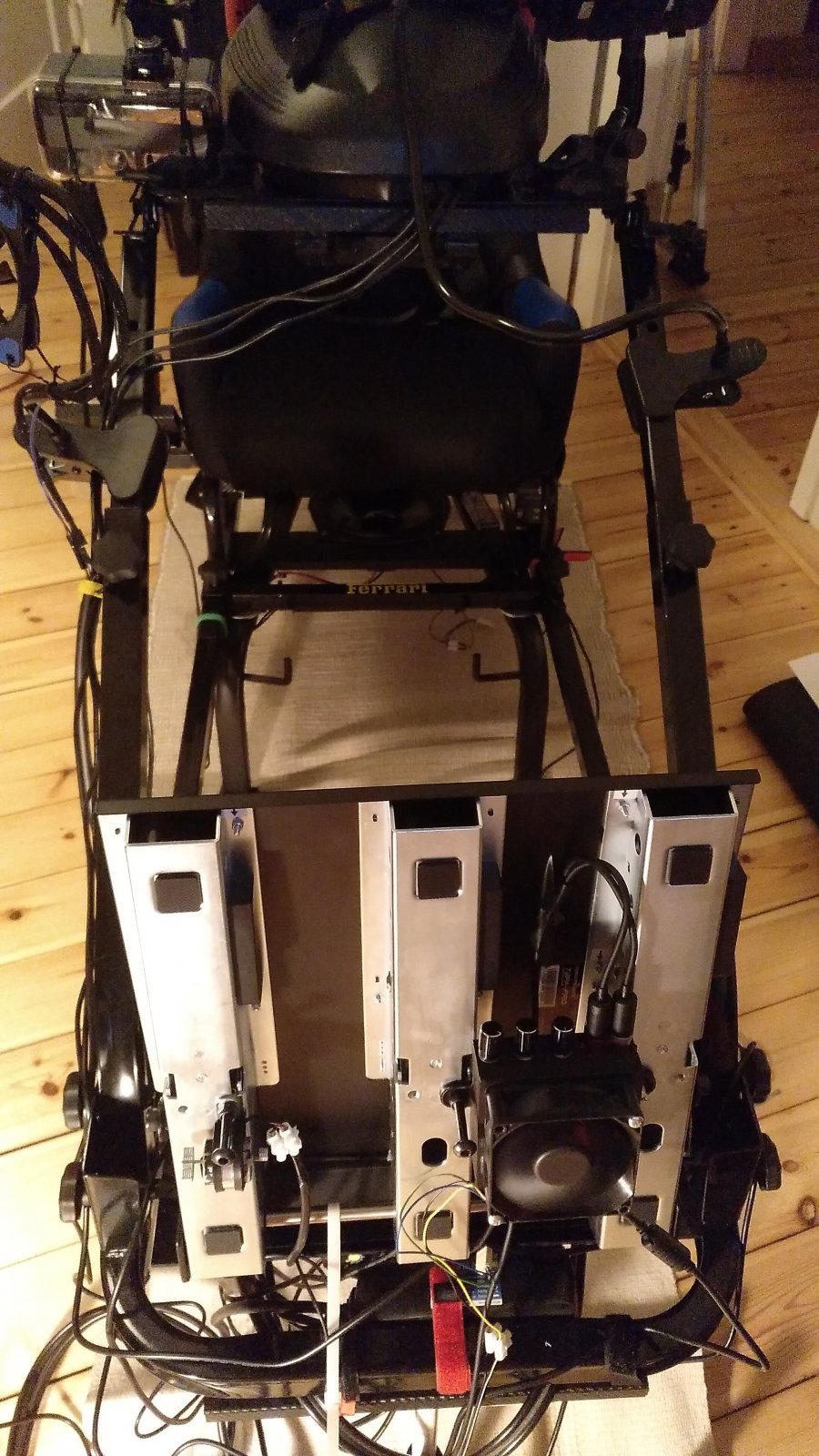

    Added a 100 watts chassis subwoofer and 3D printed a case for the amp... IMG-20190302-WA0010.jpeg
    Really adds an engine feel to the whole rig. I can even feel the vibe in my feet. I didn't know that it was missing until i saw some builds on this page. IMG-20190302-WA0016.jpeg Because it was getting a bit toasty I mounted an old CPU fan on top, undervolting so it turns quietly. IMG_20190302_201250_036.jpg Also found out in the process that I can configure the audio ports front and back to what I want them to be. Since I'm still using the headset with motion tracking and Yamaha monitor speakers, that saves the connectors from wear from being plugged in and out, and who needs a second mic input on the backside anyways?!

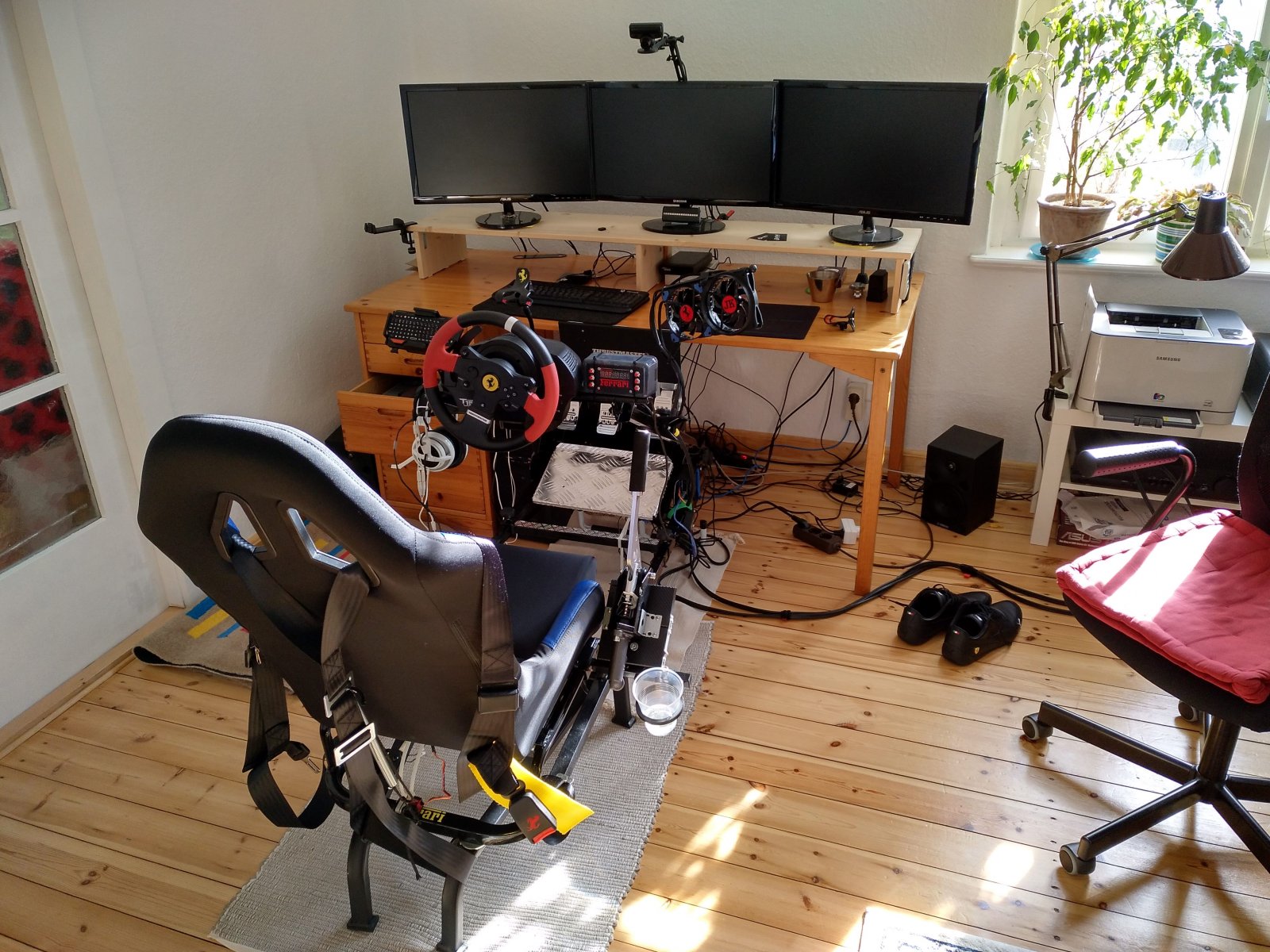

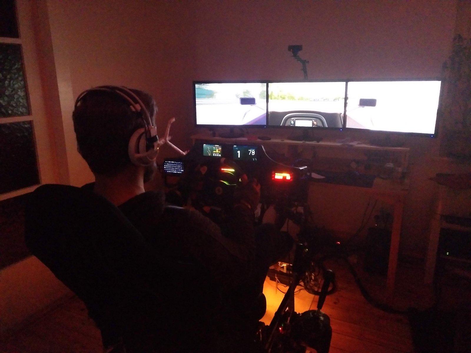

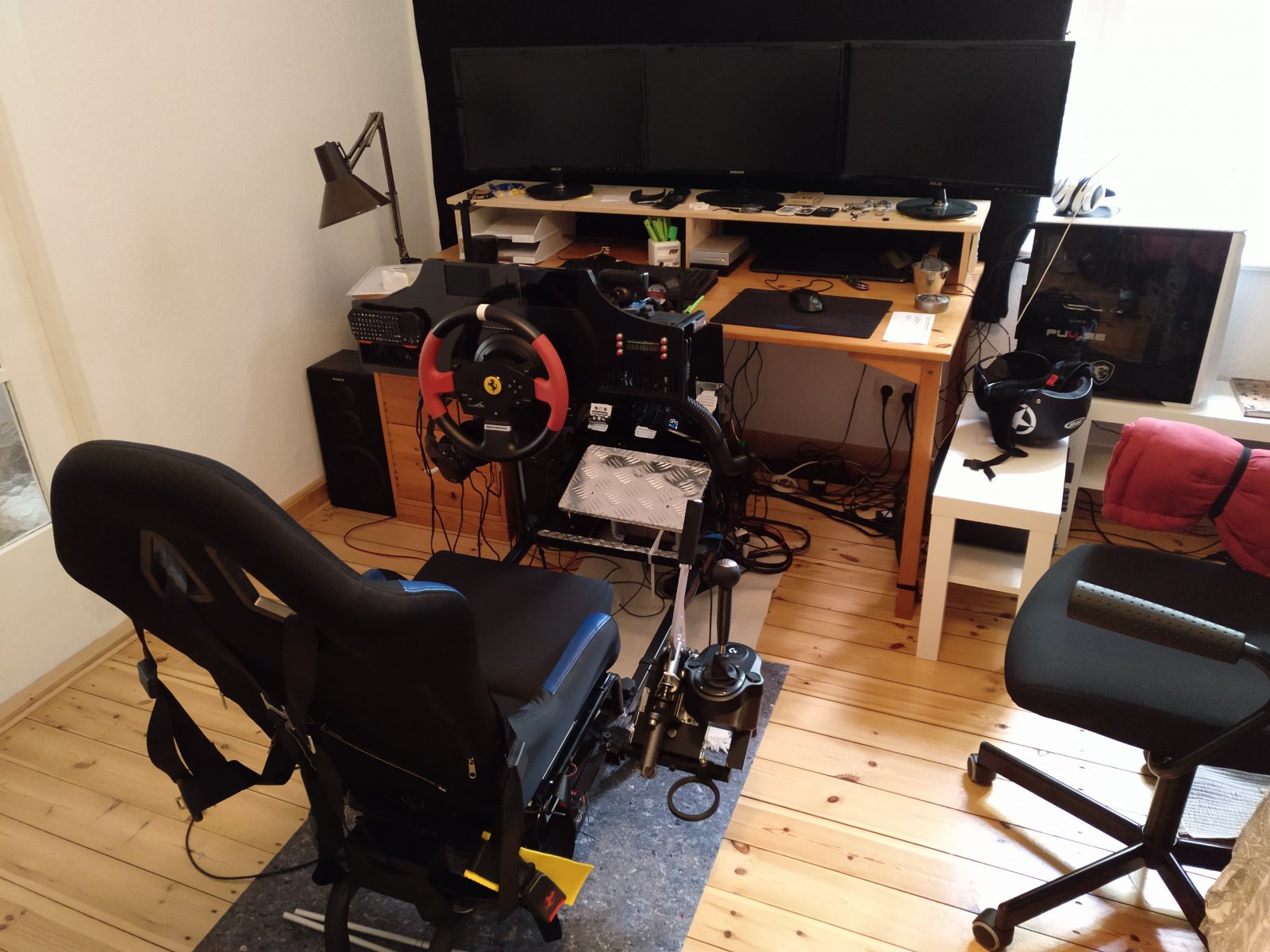

    Fully 3D printed cockpit with 3 adjustable fans rev RGB led 2 samsung phone displays, illuminated bluetooth "keyboard" with one finger "mouse pad" 7 gears H-Shifter, 150W bassreflex subwoofer under seat, surge dependent 3 point belt pully with 37kg force max and some idle and speed dependent rumble FX done with different arduino types and sketches. Going for the DOF finally because the driving experience is pretty realistic except of actual movement now. Will be an interesting 2020. Looking forward to reading your amazing posts and copying some good ideas, and remember don't drint and drive ;)

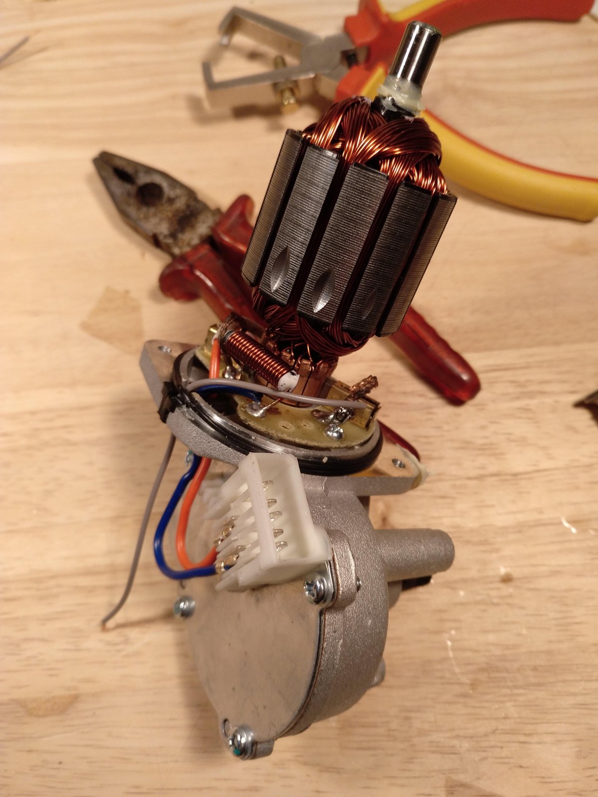

    So, I'm finally joining the 3DOF squad
    Wiper motor 2DOF + Actuator Yaw (traction loss)
    This thread will become my diary...
    And yes, I grounded these Wipers like they were my teenage daughters coming home late...

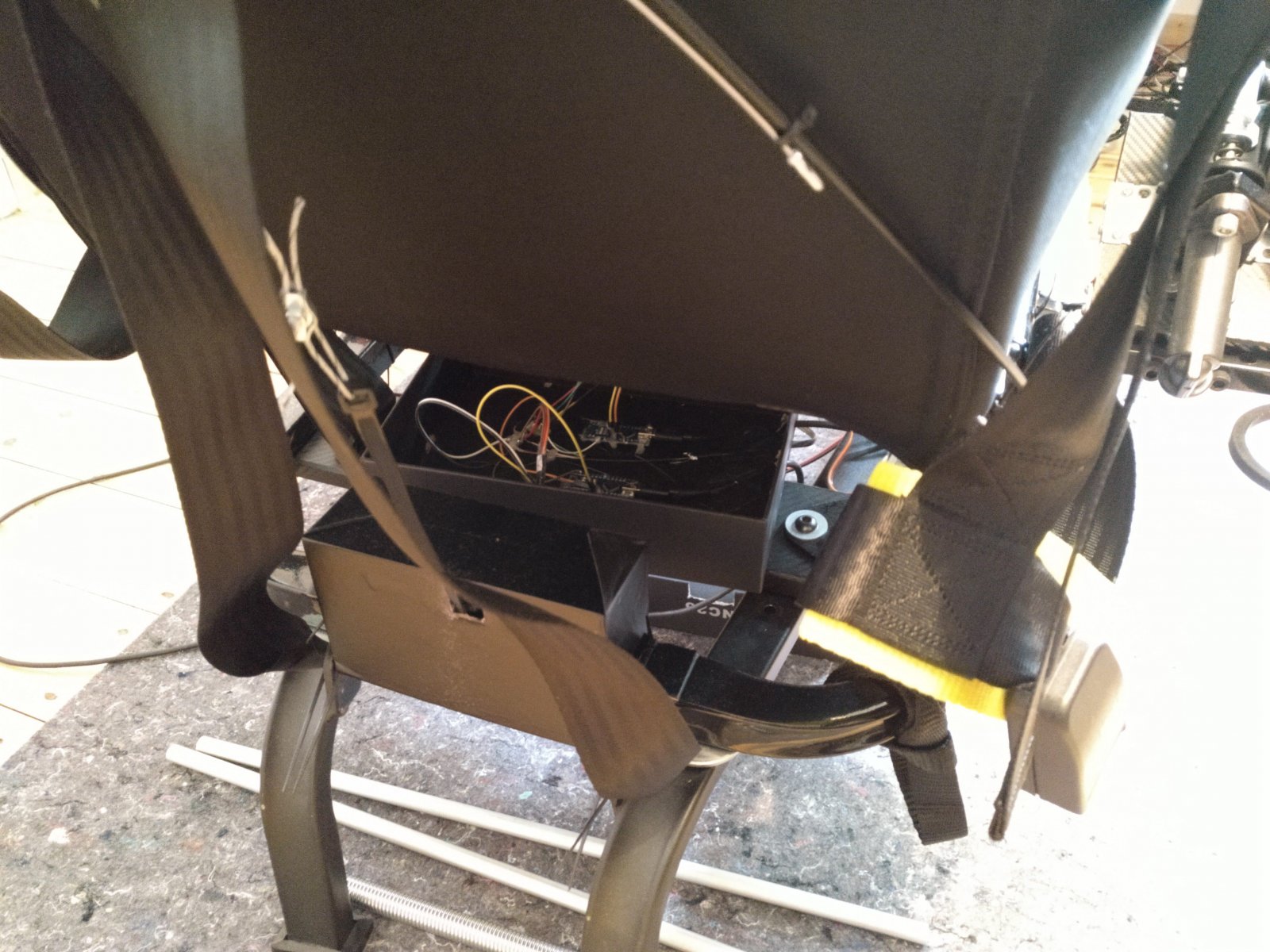

    3 way harness pulling tensioner servos: sway each 25kg @6,8V
    surge (only breaking of course) one 45kg pull servo @8,4V

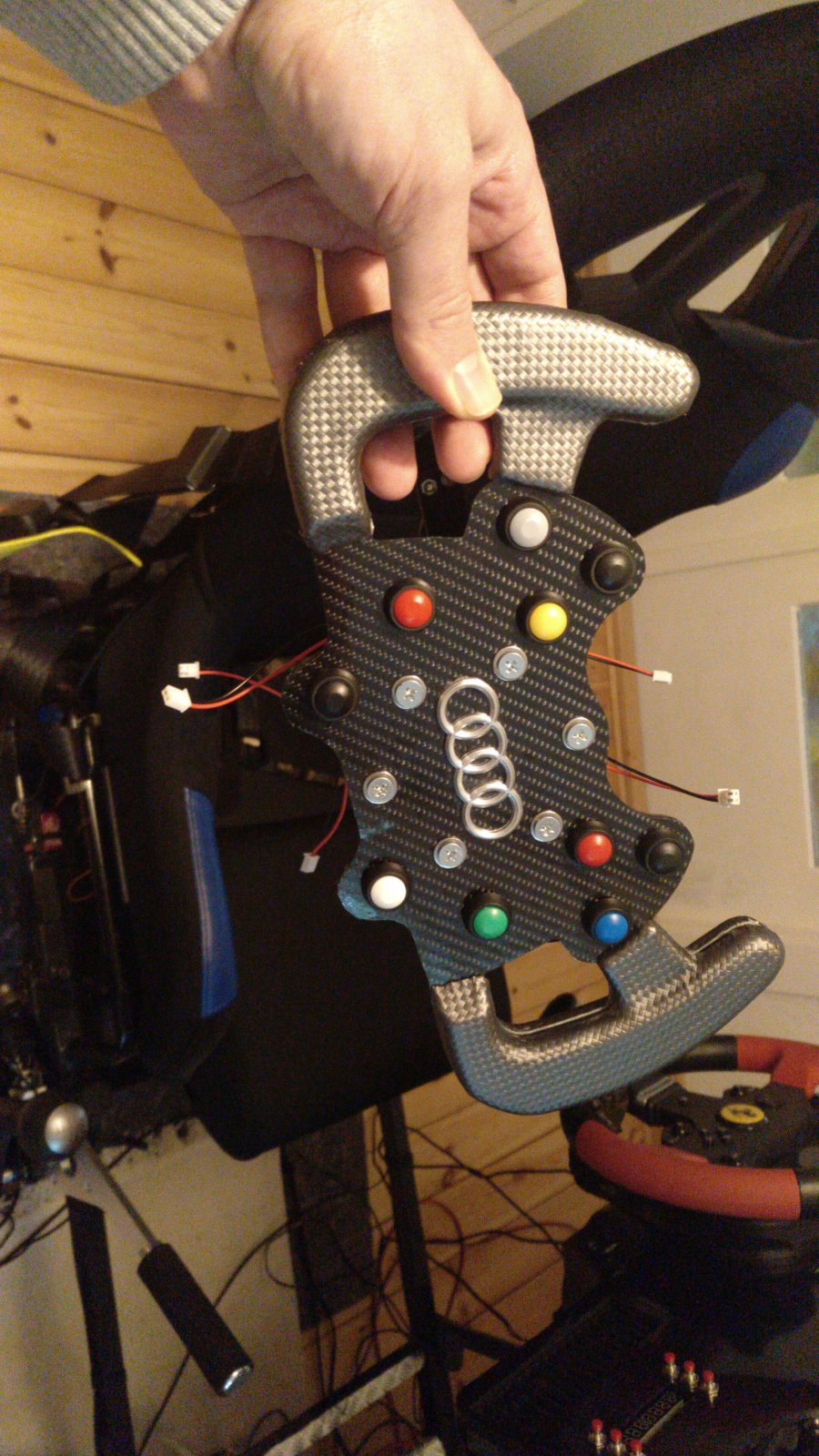

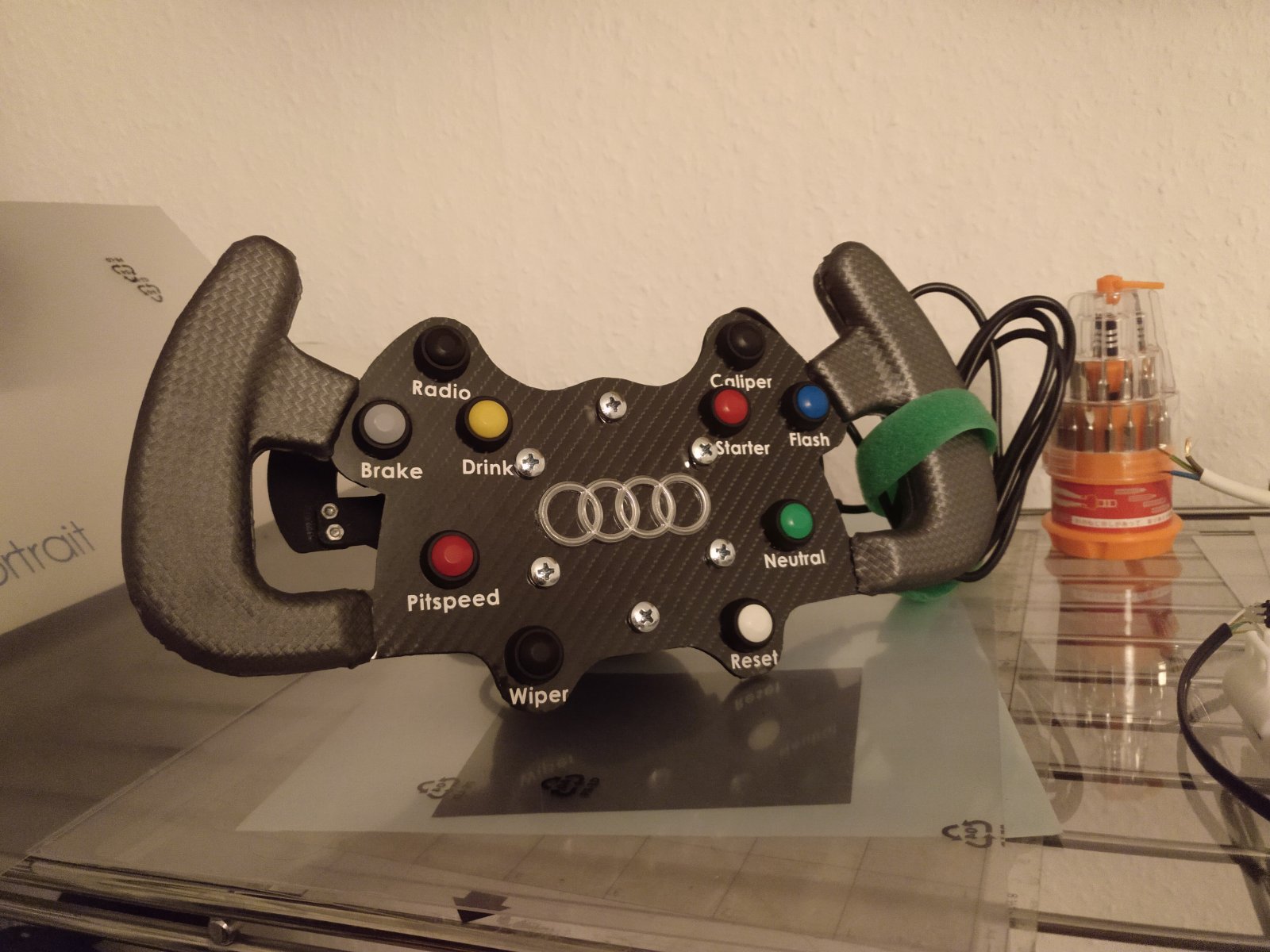

    DIY wheel. Took me a while...a few dead ends later and evenings wasted: It was not in vain. Aluminium with 3D carbon optic vinyl looks and handles better than an actual carbon fiber sheet. The drilling holes are a pain in the ... with real carbon fiber.

    Hi! could you please elaborate a bit more about your "3 way harness"? that sounds interesting :)
  8. Jonas Canopee
    Jonas Canopee Tech & fitness geek, daddy, car enthusiast
    Feb 14, 2019
    17
    Graphics designer
    Berlin, Germany
    145Coins
    +15 / 0 / -0
    I'm on vacation in Denmark atm but i found this snapshot on my phone: basically three 180° servos, two pulling the harness at the top to the left or right, so your outer shoulder feels "more weight" in the corner. One stronger servo pulling down on both shoulder straps for deceleration. Even if i don't have actually movement in my rig atm it feels pretty good. I've collected and assembled everything I need for a 2Dof but I wasn't able to mount it onto the rig and flex off the seat base yet. Then i will have to review the harness system and probably change the mounting points and reverse direction (for me it's hard to imagine physics & forces when I don't have the rig in front of my eyes) i will keep updating this thread. I have a 360 Modena drive ahead of me in September, I will have two gopros, one on the road and one on me driving, I'm going to fine tune the system to my body memory and video "evidence" that evening. I already know i will need some heave motor sooner or later...
