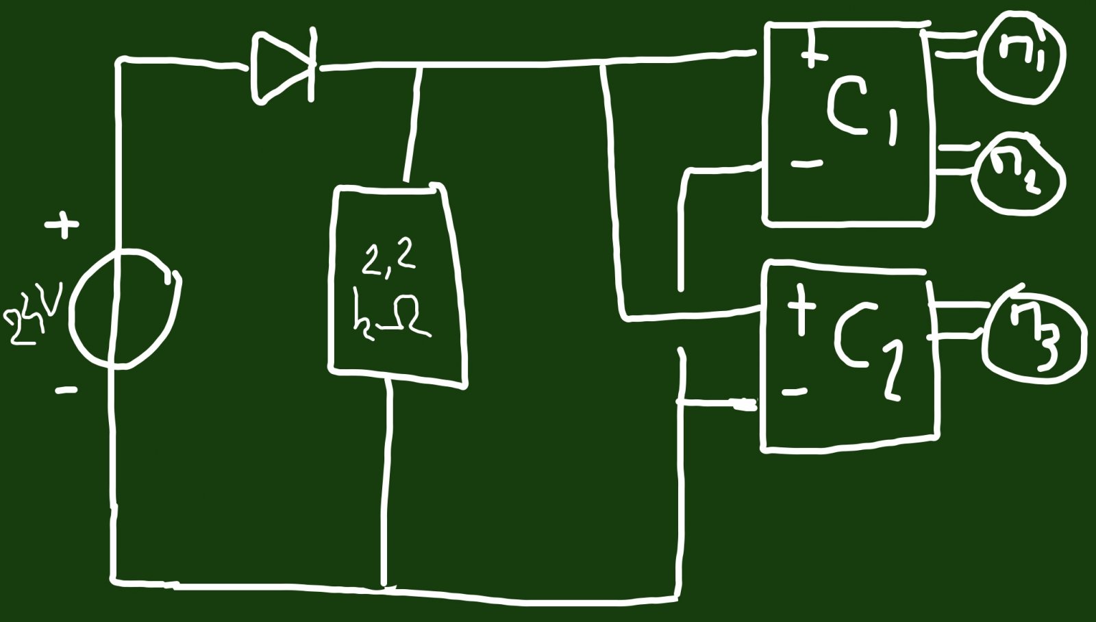

Question Électrical issue with my controler
Discussion in 'DIY Motion Simulator Building Q&A / FAQ' started by Horker, Jun 18, 2019.
  1. Horker
    Horker New Member
    Jun 3, 2019
    21
    164Coins
    +16 / 0 / -0
    Hello everyone. can someone reassure me about my motor controllers? they are not protected against regenerative currents and I thought I would use this circuit to protect theme. power supply 24V 1500W
    I already post it in my project but i had no answer...
