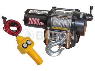

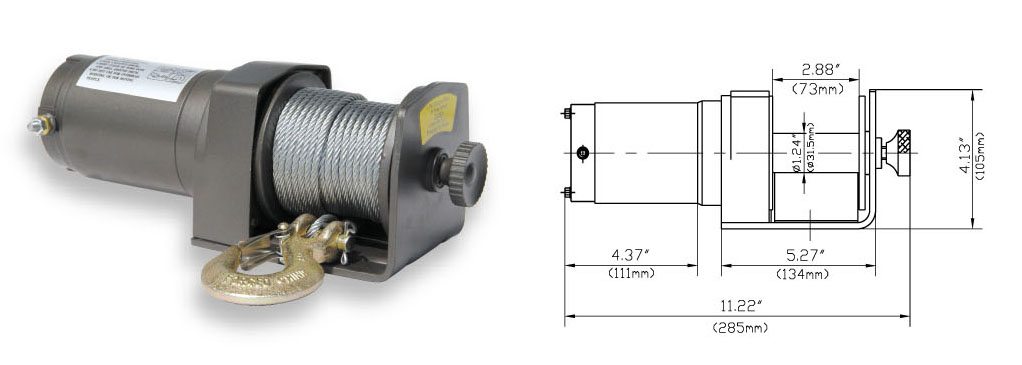

    I managed to get some winch motors cheap and i think i will use them, so i did some math...
    http://www.northerntool.com/images/downloads/manuals/999364.pdf
    I found this winch spec...
    Say 153:1 and 23 rpm as pit already related. Also says that has 0.85HP
    Taking count 0.7HP for tolerance.

    So, with a 2000 lbs winch, we can travel +/-40cm with a speed of 481sec, lifting 100kg?
    I think i'm wrong somewhere, but all looks fine....
    Please, let me know if i get some wrong info!

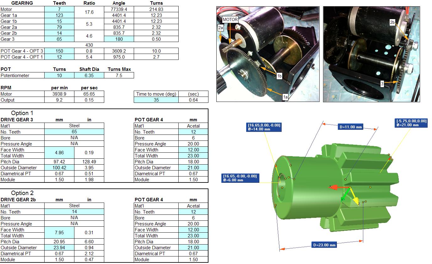

    A couple of comments based on my experiences with both types of winch motors. The boat winch motor you can indeed remove the motor and remount it elsewhere. But the planetary gear type winch motor is integral to it's housing and would be much more difficult to use in a different configuration. Not impossible, I did it myself but your mounting options are very limited.
    As @Pit mentioned; you would need some type of reduction to get torque from the RPM of the motor (converting one to the other) but a ball screw would not give you that torque. This is how I know the difficulty of using the planetary gear motor without the gearing. I have a ball screw on my flight simpit seat (for heave) and without the gearing there is zero movement under load (even a light load) so the ball screw does not give much mechanical advantage.
    The ball screw was never intended to give mechanical advantage really, I just needed a linear device for that DOF.
    I am actually using a boat winch motor to drive the ball screw now. I removed the final gear (430:1 @ 10rpm gear 3 in picture) and am using the next to last gear (100:1 @ 40rpm gear 2b in picture). I am getting around 50mm/s travel which is great for flight but not at all usable for driving sims.
    Here is some information about the typical boat winch created by another member @boosted-lt1 and posted in his build thread here:
    http://www.xsimulator.net/community/threads/2dof-jrk-winch-build-thread.5369/
    I use this exact winch setup myself.

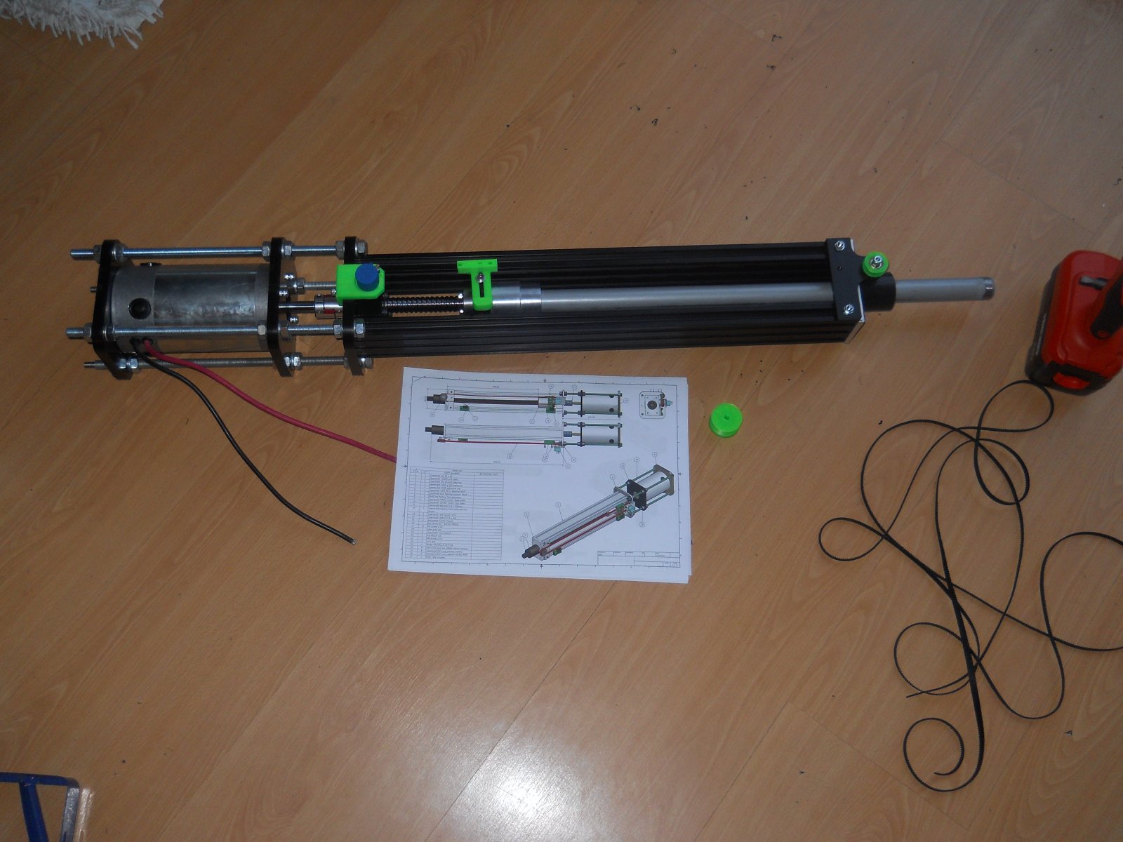

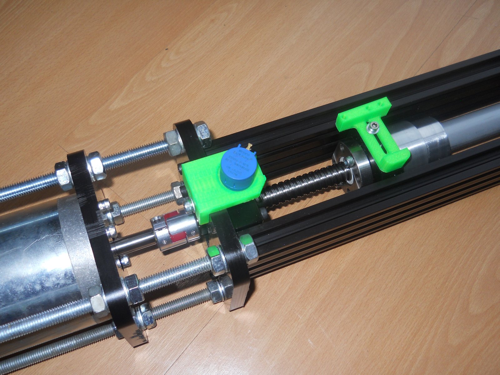

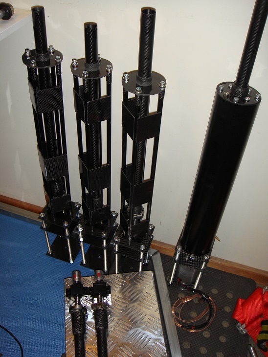

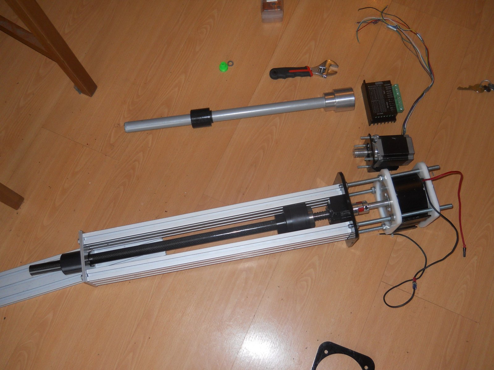

    @SeatTime own linear actuator with gearless motor 350watts 4500rpm (at least one of the motors he tested):
    @wannabeaflyer2 linear actuator with gearless
    Scooter Motor MY1016 2700Rpm 24Vdc 250 Watt and later with 300watts 4000rpm gearless motor.

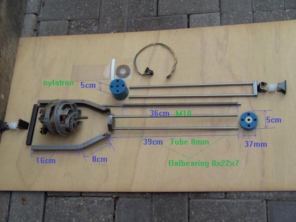

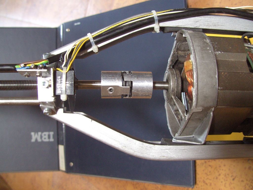

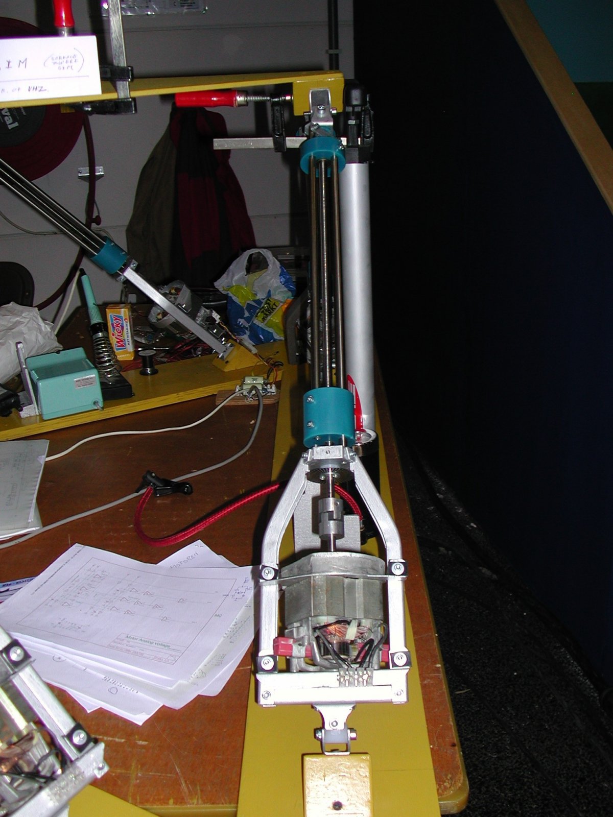

    @douwe http://jippes.home.xs4all.nl/Hi5/index.html Using household vacuum cleaner motor and a m10 threaded rod
    None of them used gears and all of them worked more than fine, maybe I'm not explaining correctly because English is not my language.

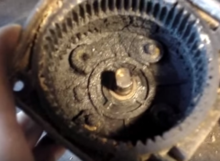

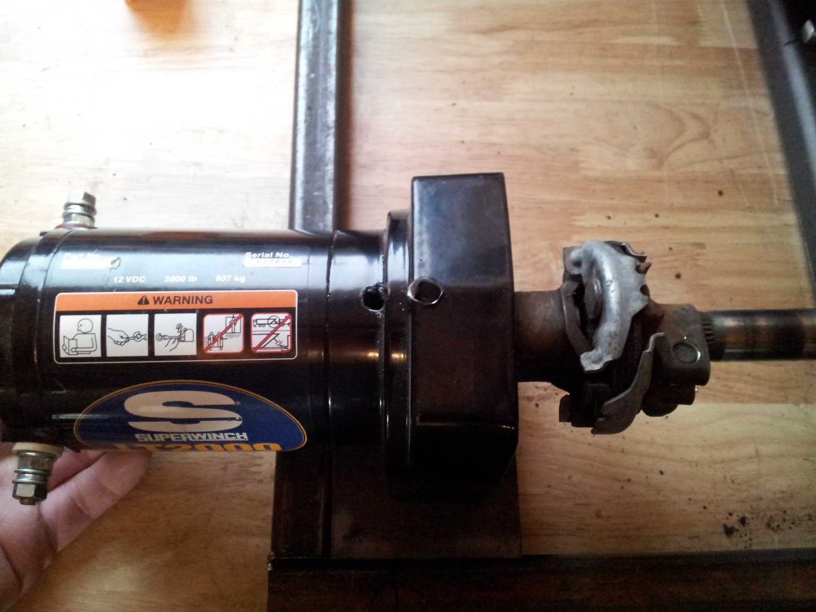

    I saw some winch teardown videos in youtube, not much of a problem to get the planetary gear out, and to do a hole in the housing to adjust a shaft coupler. it also depends on the winch, as there are some with the planetary in one side, and other with the planetary at the other side:
