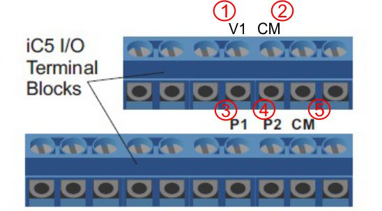

    Hello @speedy
    please look at this picture of ic5 I/o terminal block
    ive seen you have connection on both com No.2 and com No.5
    what is the deference between com No.2 and com No.5
    and where do you connect each one to?
    thank you friend for all information you share
    yours
    Hooshang
