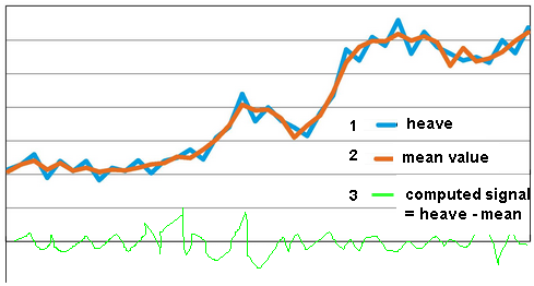

    - for bumps:
    I would suggest that road bumps would be acquired like this: the variations around the mean value are the signal to be transducted by buttkicker.
    In both cases, the cuts (start or end frequency) would distort the reality...

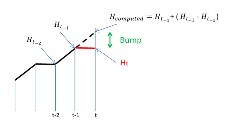

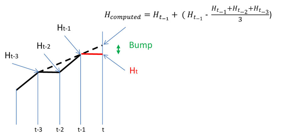

    For Road bumps effects:
    Frequency: if Heave is sampled at constant rate,
    we can store previous Hdata(t-2) and Hdata(t-1),
    acquire Hdata(t),
    and we can compute BumpFrequency(t) as Hdata(t) - Hcomputed(t)
    or smoother with a moving average over 3 periods for example heave mean3.jpg
    Volume:
    like RPM, the sound volume has to vary opppositely to frequence.​

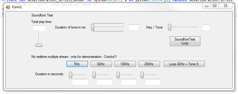

    Interesting stuff...have to examine that more! The code i posted is not usable because there was no way to have multiple streams. Also there are cracks when the single tones are played multiple times in a loop so i decided to look for a real software synthesizer which is able to make tons in "realtime".
    I found a library which is able to load Soundfonts. This are (midi) patterns which can played with various settings.
    Library is called FluidSynth.
    A Soundfont is something like a set of pattern from a specific instrument like a e-Bass, drums, synthesizer etc. Unfortunately i did not found a clean sinus wave as a Soundfont (Its able to create such a sounds with several audio tools but i tried several instrument patterns and the result is very good imho, much better than a clean sinus wave.
    I wrote a small quick and dirty testapp for the Soundfonts possibilities.
    Download here (22mb): http://www.xsimulator.net/download/tonegenerator.zip
    Attention: Some sounds, specially the one with deep frequencies are very dangerous for your speaker. So tune them down:)
    Go in the code and look for .sf2. There you can try out different instrument patterns.:
    Code:
     ' load soundfont files
            ' Thats a bass guitar
            'Dim path As String = "sounds\BassFing.sf2"
            ' Thats a Piano
            Dim path As String = "sounds\gorts.sf2"
            'Thats a Drum Kit
            'Dim path As String = "sounds\StomperSet.sf2"
            'Thats a synthesizer
            'Dim path As String = "sounds/198_Juno_StringPad.sf2"
            'Dim path As String = ""
    As there are real instrument pattern played and not only steril and clean sinus waves its very easy to create realistic engine vibrations:
    Try out (gorts soundfont):
    • Total play time = 5sec
    • Duration of tone in ms = 48ms - 100ms
    • freq / tone = 20 (thats the lowest adjustement of the slider)
    If we want very clean sounds we only have to create some sinus soundfonts.
    Alternatively i think a similar result can be reached with sinus wave samples. I deliver some of them in the download package.
    Btw. Every note is played separately. The volume can vary with every tone.
    The slider freq / tone plays the different tones which are on a bank most times roughly from 20 - 60 less or more. So its possible that you select a soundfont and there is no ton when u set the slider to 1-35. So u have to try out to find the range of tones on the virtual keyboard bank,
    One thing is still missing in the testapp:
    Selection of a specific soundcard. Per default the MS audio driver dsound is used (primary one - can only be changed when the FluidSynth dll are recompiled. )
    But its possible to write the sound into stream and choose than the audio card we want:
    From: http://fluidsynth.sourceforge.net/api/index.html#MIDIPlayer
    Some resources:
    http://sourceforge.net/apps/trac/fluidsynth/wiki/SoundFont
    http://fluidsynthwrapper.codeplex.com/wikipage?title=Samples&referringTitle=Home
    Download Soundfonts:
    http://soundfonts.homemusician.net/
    http://hammersound.net/cgi-bin/soundlink.pl
    About Midi Keymapping, notes and frequencies (german)
    http://www.sengpielaudio.com/Rechner-notennamen.htm
    If someone can deliver better code, please go ahead.
