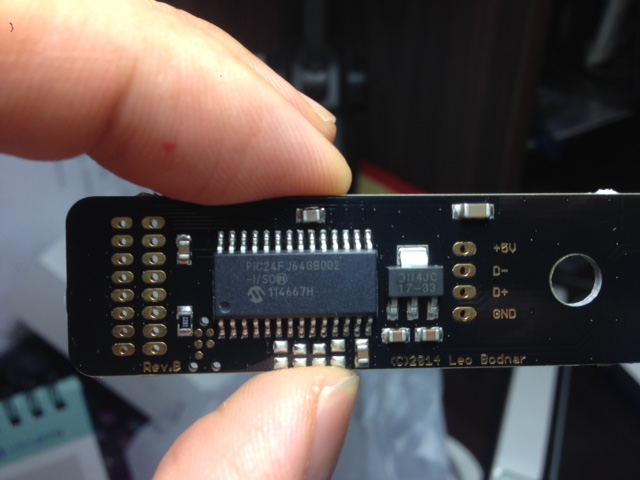

    Hi Simracers,
    This is Jason from Korea.

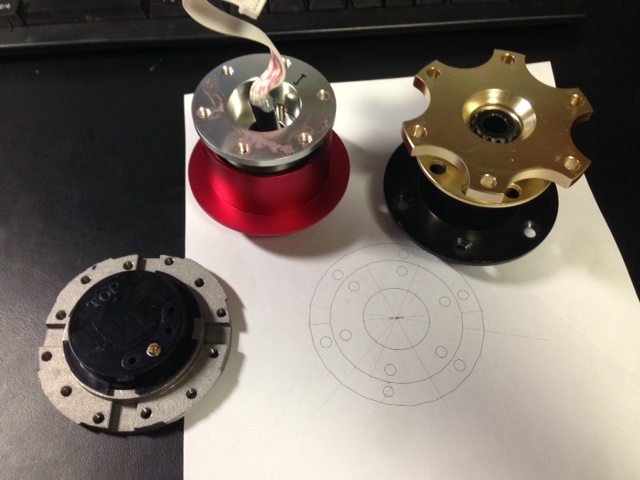

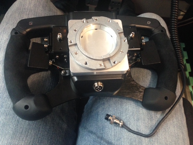

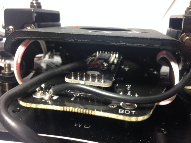

    I'm going to introduce Fanatec Rim Standalone USB Conversion PCB from Leo Bodnar.
    This product makes you use Fanatec rims with your Open SimWheel easily.

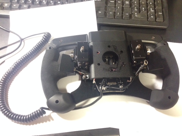

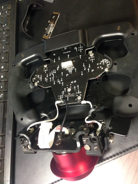

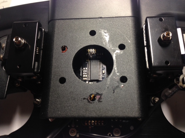

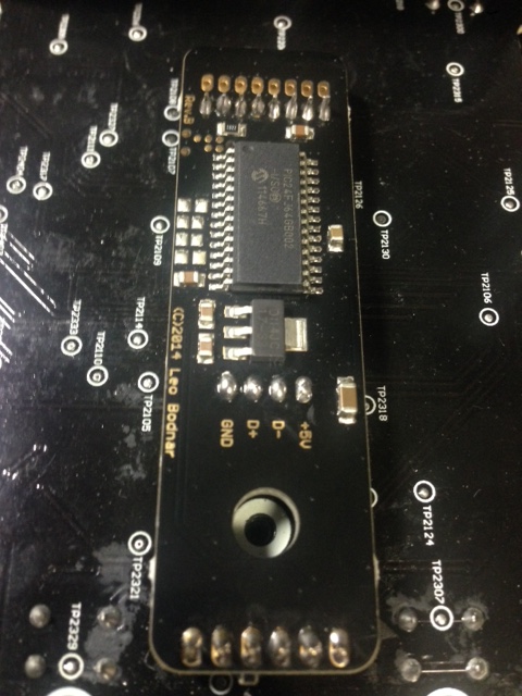

    This is the Fanatec Rim Standalone USB Conversion PCB.
    tearing down and soldering.
    then assembling
    There is an adpater is needed to attach quick release to this rim like below.

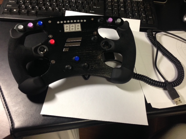

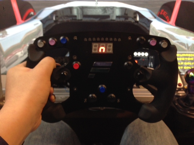

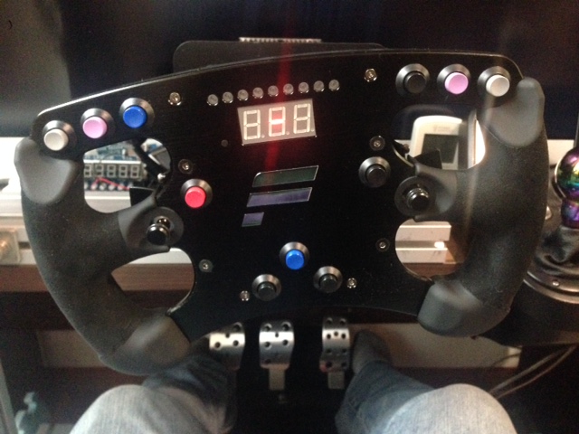

    This is the result.
    Works like a charm.
    Here is a video for this.
    You can purchase this useful PCB from leobodnar.com
    I'm not an employee @ LeoBodar.com ;)
    Regards,
    Jason.

    Can you please post more details about what adaptor is require to fit the fantatec quick release to the 70mm PCD on the OSW side?
    Its there a commercial product available for did you fabricate your own?

    DONT WASTE YOUR $$$ on this Leo Bodnar chip. Teensy LC to the rescue, 11$ and does everything the leo chip does. there's documentation on the AC forum ill dig up. Pretty sure its in the OSW thread if i recall.

    Wow! Nice project! Explanation of CSW rim's pinout is extremely useful :)
    README.md is also mentioning some troubles whis Fanaleds
