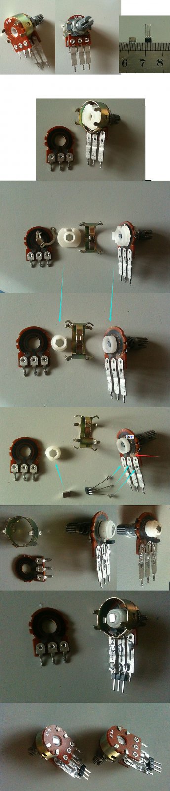

    Hope useful to you

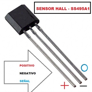

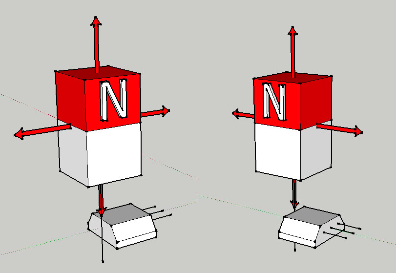

    Subtle changes in position of the magnet will affect the accuracy and range of the potentiometer
    This is a Hall sensor model I used:SS495A or SS495A1

    Hello ! This is a Hall sensor model I used:SS495A or SS495A1

    I already have a pair of hall sensors and a pair of neodymium magnets, so I will try, thanks!

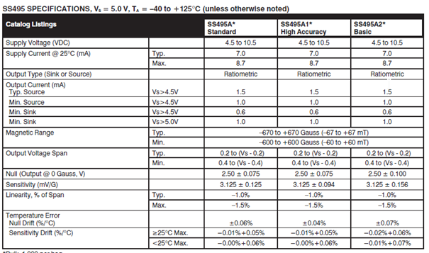

    I just get interested in the datasheet SS495A sensors A1 and AE
    They do not suit me because I intended them to be connected to the analog inputs of 3.3V Arduino Due working
    These sensors apparently operate only from 4.5v
    My use of the Arduino Due to 3.3v I 1024 10-bit and 12-bit 4095
    Has anyone ever used these sensors 3.3v?
    For my part, I will look for references Hall sensor operating in 3.3v

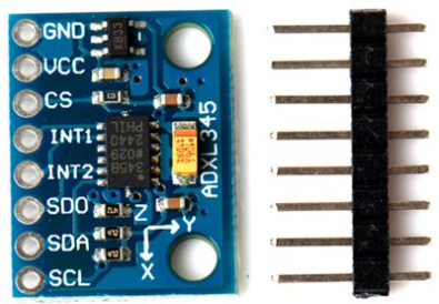

    Thank you, it would be to try the A1304 using this type of case
    But at the same price you can have an module ADXL345 3-Axis Output Module Sensor Accéléromètre Gyroscope for Arduino operating from 3v and to put directly on the dynamic simulator

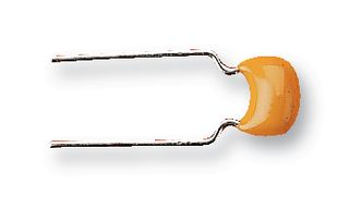

    Ensure the supply voltage is well filtered with an electrolytic and ceramic cap across the supply close to the device. If the device itself generates a noisy output you could place a filter (resistor/cap) across the output. Your electronics should be 'star' grounded with care paid to ground and 0 volt plane separation.

    Un problema que nos podemos encontrar con los "potenciómetros" una vez instalados es que por más que intentemos eliminar esas pequeñas vibraciones no lo consigamos, aún incluso variando los valores que nos ofrece el programa XSIM o el Software de Prilad.-
    Normalmente ese problema es originado por las denominadas "corrientes parasitarias" las cuales crean movimientos no deseados (vibraciones) de los motores al no tener la "señal" (patilla central del potenciómetro) una estabilidad correcta.
    Podemos intentar solucionarlo/afinarlo instalando un "condensador" de unos 100 nanofaradios (100 nF). Necesitamos conectar la patilla central del potenciómetro (señal) y la patilla de tierra (GND) al condensador.-
    Gracias a "PETAR2" por la aclaración.-
