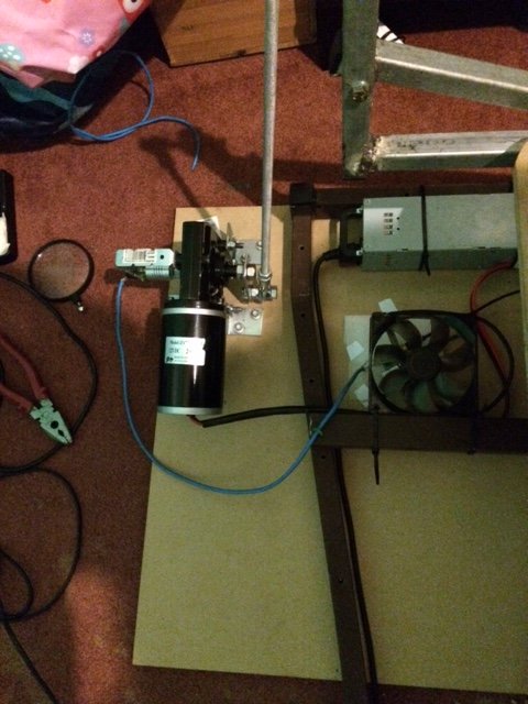

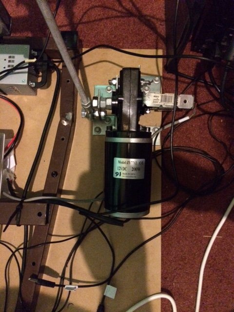

    Feckin Gremlins in the System for sure. Turned everything off to go for family dinner, come back and turn everything on and the motor that was perfect before now goes to a funny off angle the wrong way and no amount of feedback config seems to assist. I'm over it for the night. I even replaced all the wiring on the Pots just incase and still no good. Just one motor is behaving, the other won't play ball.
    (In JRK after I hit learn it inverts the feedback which I noticed it did the first time, but now no settings seems to work)
    Dicky motor: (Not powered or in the odd angle, just for placement reference) (Left side front)
    Working Motor: (right side front) *when sat in Sim
    And this is a quick video before I went to dinner - both motors working just fine. Grrrr. (Using JRK tool to move motors with slider)

    Then turned my attention to the wiring.
    It appears my Emergency Mushroom switch was playing up. Removed that and wired straight to the JRK.
    (Kept powerboard with an off switch close at hand!)
    I had also screwed down the JRK to the base. I suspect the motor start was giving it a "jolt" so I've rested the JRK on some padding while keeping it raised a little for cooling.
    When motors snap to Centre on Power up, no more disconnects. :)

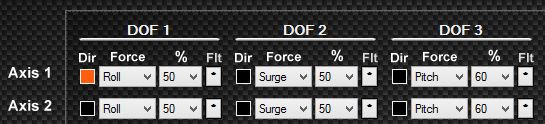

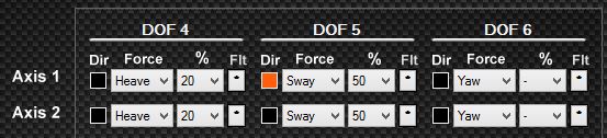

    Simtools
    Fired up Simtools and set Interfaces. Used the 7bit JRK profile, following Rob's observations. (might revert back to 12bit after a few games)
    Set my Axis assignments for Assetto Corsa.
    Got in my seat and drove off into the virtual sunset.... a happy man!
