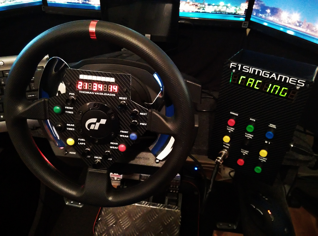

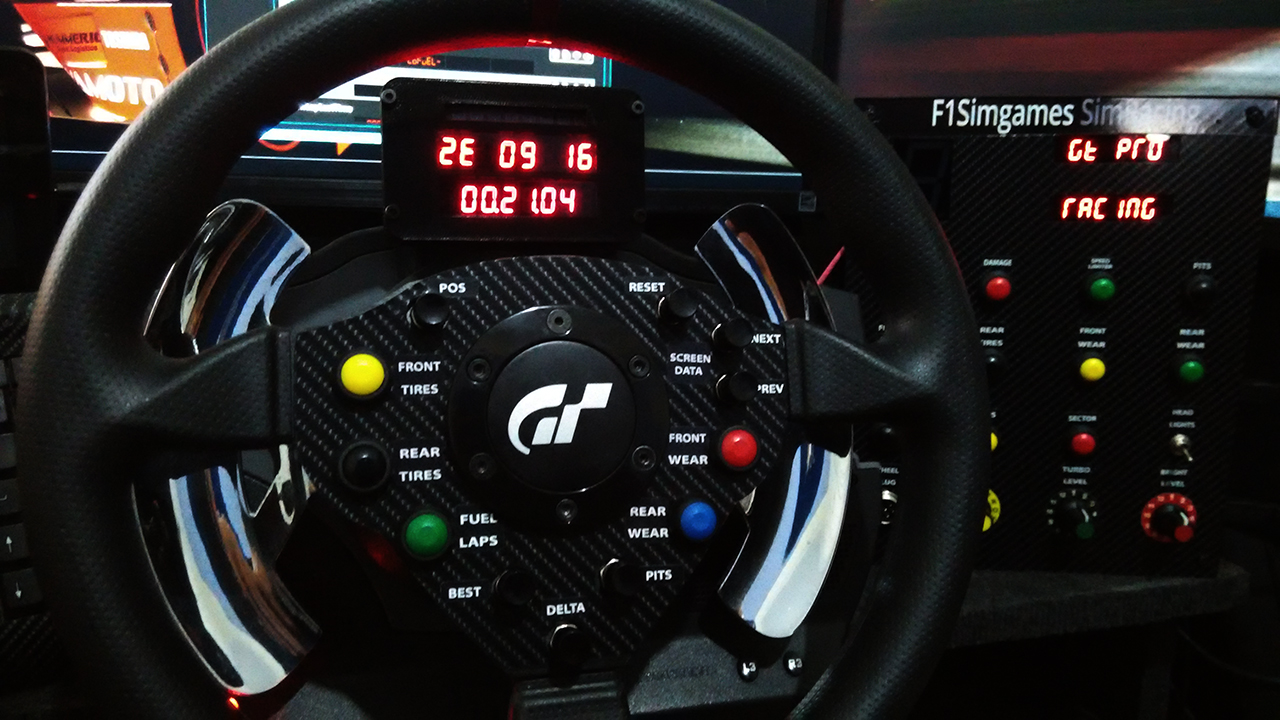

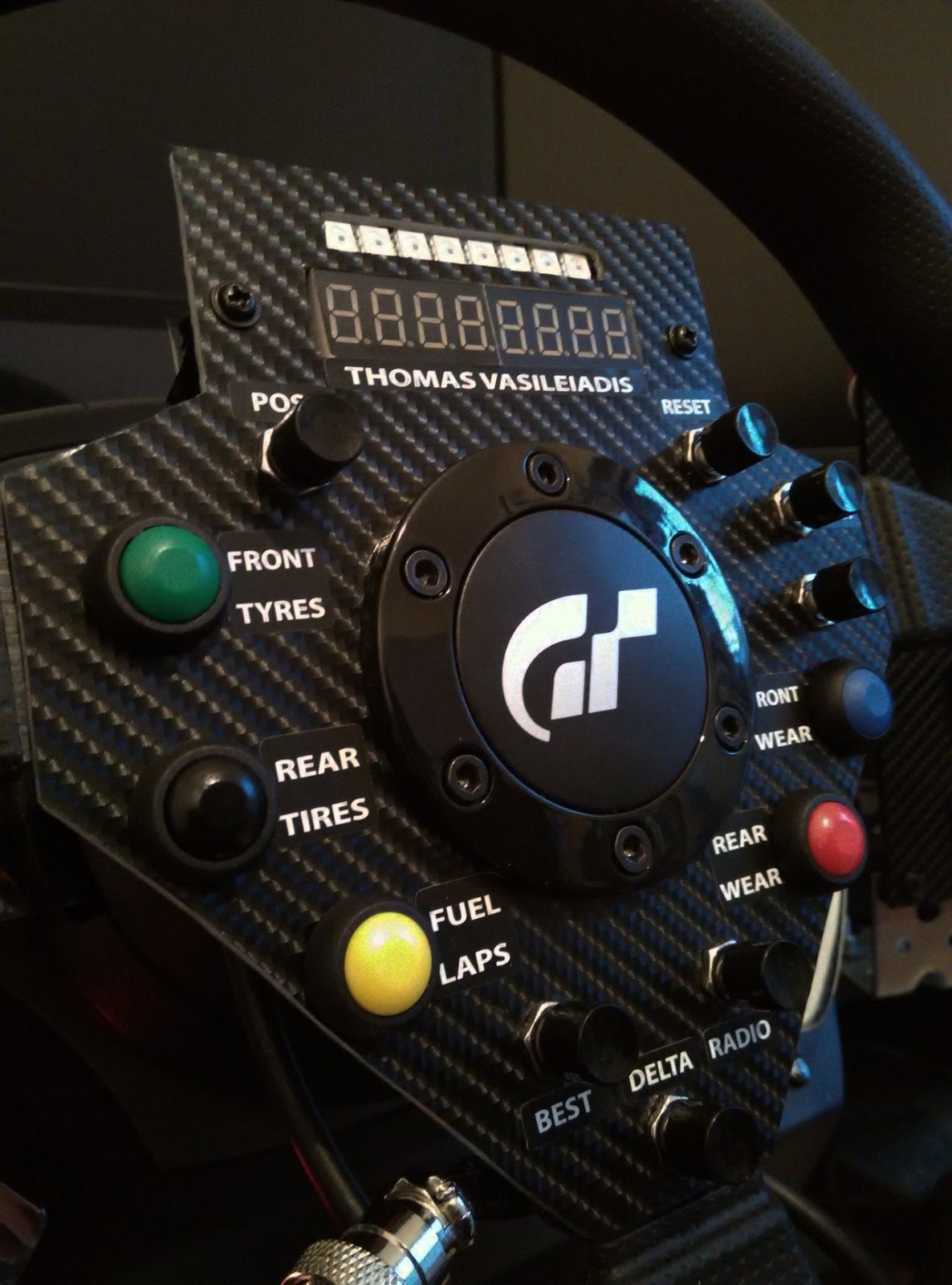

    i start modding my original T500RS GT wheel to an update GT Wheel version with lcd display , rgb led rpm indicator and more push buttons.I use MAX7219 for display and WS2812b for RPM.So let's start,
    THE WHEEL

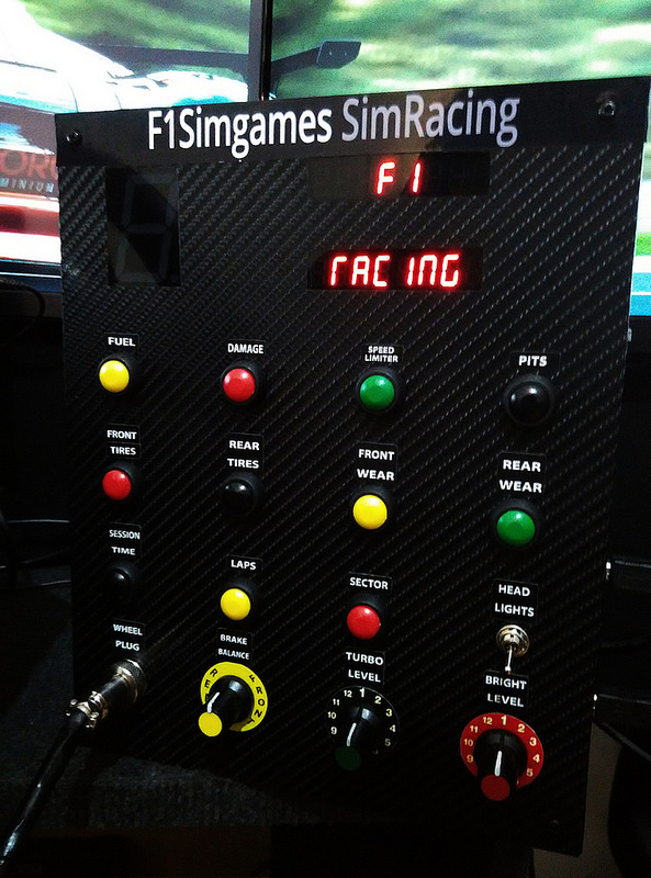

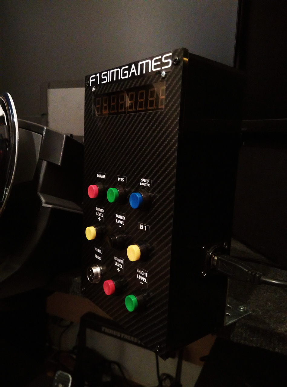

    After that , i think to create a button box for more data that is not so important to be in wheel.As i mod the button box i decide to use another one TM1638 lcd for show there the "secondary" informations.
    THE BUTTON BOX

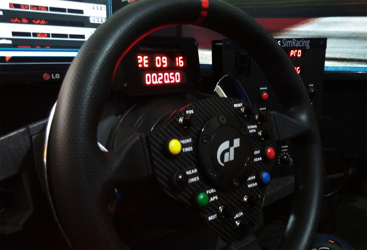

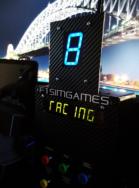

    And then...i think to make an external Gear Indicator....cutting....drilling...carbon vinyl wrap..and...
    THE GEAR INDICATOR
    So the project was ready to test....let's go...
    I hope you like it...
    Thank you for reading....Thomas.

    So .... new update on PanelBox with a totaly new design!...Hope you like it!

    Can i ask what you use to drive big 8 segment indicator i made mine and the light is barely visible.
  10. f1simgames
    f1simgames Member
    Mar 21, 2014
    34
    516Coins
    +27 / 0 / -0
    What display do you use?....must be high brightness display first and second how do you powered the display?...
    i use high bright display and i powered it with a USB cable from PC USB port directly to power connectors of the display.

    i use arduino but current they want is more than 40 ma and i need driver for this to be able to provide them more current.
  13. f1simgames
    f1simgames Member
    Mar 21, 2014
    34
    516Coins
    +27 / 0 / -0
    All stickers is created by me Foehn....i print it in vynil sticker paper with laser color-graphite printing.

    You can powered the gear indicator with USB Cable directly from PC USB port.I use a simple use cable,cut the end and i solder + and - cables to a male-female adapter and i powered the gear indicator.

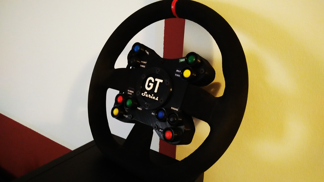

    Hello again guys,
    i just finished 2 new mods.

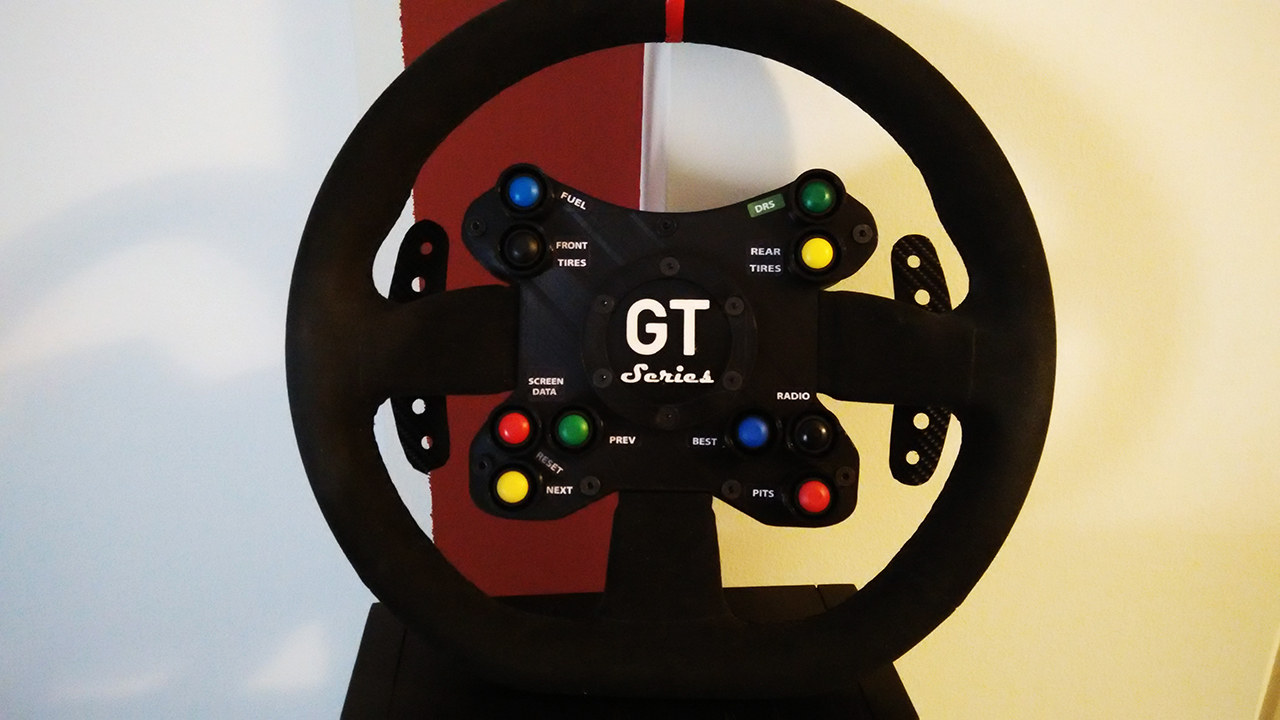

    TM 599XX EVO 30 Alcantara wheel mod.
    Wheel have 10 push buttons with button guard , magnet shifter paddles and custom center logo.

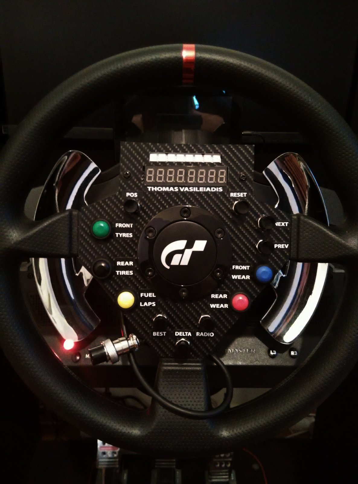

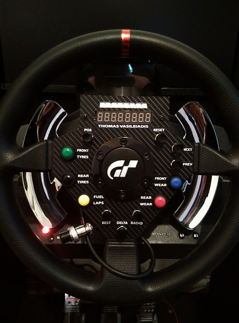

    T500 RS Original GT wheel mod
    Wheel have 13 push buttons (Original and custom) and will install magnet shifters paddles too.
    Also you can see SimDisplay.Working with 2 X LCD Digital displays for Simulator data and 1 X RGB led strip for RPM indicator.

    hello
    nice project :)
    i ve a question about your dash, how do you fix it on the t500 base ? behind the soft part ? how you can see it into the whell ??? i ve a ferrari GT and i cant see the dash into it , and when i turn it ,the 2 levers hit the dash.
    fot ur plate on the dash you use plexi ans vinyl or real carbon because look very good

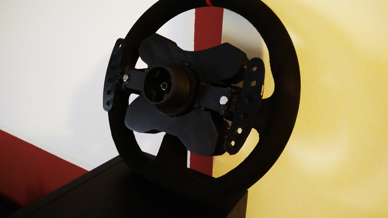

    Hello ,
    all dash is design by me and it is 3D printed.So it is perfect in T500RS wheel.Noone of shifters hits the dash.
