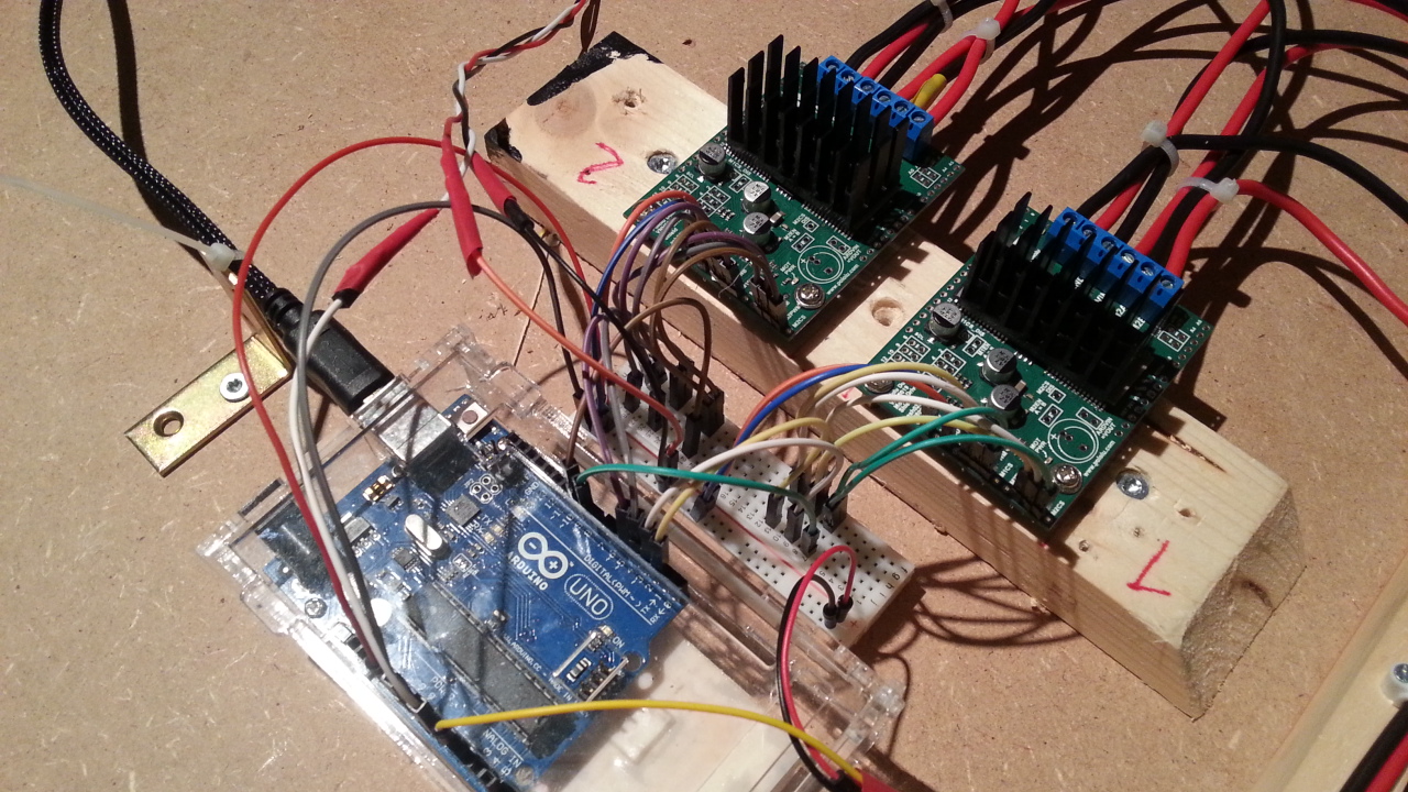

    To start with I am using the following...
    PSU = Dell server 12v , 47 a
    Ard board with racingmat code from the tutorial
    Hummer motormonster board
    12v wiper motor and 25k linear pots
    This video shows the issuse.
    I have done the fallowing tring to solve the issuse.
    Changed the pots from 10k to 25k
    Isolated and insolated the pot wires from the motor wires
    changed the psu from 47 amp to 59amp.
    what I wil try next is a 2 MM board set up
    if anyone else has had this issue or know what the cause is plase help.

    ok i have been workng on setting up a 2 driver system. i have wired it as follows insync with racingmat 2dof code
    On 1st driver board
    ARD > MM Driver
    pin 4 > pin 4 m1a
    ____> pin 8 m1b
    pin 5 > pin 5 pwm 1
    ____> pin 6 pwm2
    pin 7 > pin 7 m2a
    ____> pin 9 m2b
    On 2nd driver board
    ARD > MM Driver
    pin 6 > pin 5 pwm 1
    ____> pin 6 pwm 2
    pin 8 > pin 4 m1a
    ____> pin 8 m1b
    pin 9 > pin 7 m2a
    ____> pin 9 m2a
    I used the photo as a refference[​IMG]
    the resaul i am getting is that on thje 1rst driver i have a red light and on the second driver i have a green light once i hook up the ARDs 5v and ground even with no psu attached

    @Pit what code is the ARD using. I ask because I notice the pins are not starting at port 4 and running to port 9.
    also why do I get a green and red light.
    After studding your picture it appears that the wiring is opposite then the reference i got from
    Monster Moto Shield acts as a single motor driver = more power!
    In the reference the split wire shares the same motor.
    Expamle
    2dof code pin4 = M1inA and in the reference M1inA is shared with M1inB
    However in you picture the split wire shares the same channel.
    Example
    2dof code pin2 = M1inA and in picture M1inA is shared with M2inA
    So I need to wire Racingmats 2DoF code as follows
    ARD...............> MM Drivers
    Pin4 (M1inA) > Pin4 M1inA + Pin7 M2inA (1rst MM driver)
    Pin5 (pwm1) > Pin5 pwm1 + Pin6 pwm2 (1rst MM driver)
    Pin6 (pwm2) > Pin5 pwm1 + Pin6 pwm2 (2nd MM driver)
    Pin7 (M2inA)> Pin4 M1inA + Pin7 M2inA (2nd MM driver)
    Pin8 (M1inB)> Pin8 M1inB + Pin9 M2inB (1rst MM driver)
    Pin9 (M2inB)> Pin8 M1inB + Pin9 M2inB (2nd MM driver)
    Does this seem more correct than my previous post?
    The reason I am doing all this is, after changing the configuration of the hardware and adjusting the tolerance in the ard code I am triing a new board configuration.
    If this solved the issue I will try with a Ard and one MM driver to see if it is a power management issue. If it works then I will swap the Ard boards to isolate weather it was a issue with the Origional Ard or MM driver.

    You used the VNH5019 board layout as a reference so I uploaded the wiring of the VNH5019 but using the SMC3 code

    Sorry I should have mentioned the set up
    Ard-2 hummer motor monster & racingmat 2dof code.
    The code is written for the mm driver as a shield. I simply converted the pololu vnh5019 to a Mm configuration. But when comparing the diagram and your actual picture it appears that the setup is opposite.
    Have you ever got a red and green light as I showed in the end of the video?
