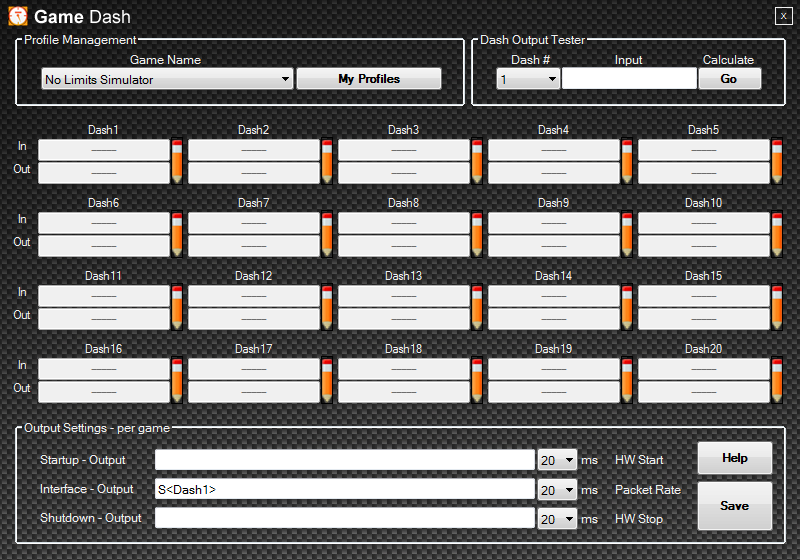

    Hello All !!
    After months of messing and tweaking I have attached my Final code for my simulated wind using an Arduino Uno and a MonsterMoto.
    There are no wires to solder/connect just pop the MM straight on top of the Uno. Of course you need to connect your power cables :)

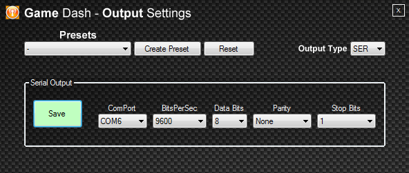

    The settings I used for the connection to the Uno obviously yours maybe a different COM port
    The settings in GameDash for NoLimits2

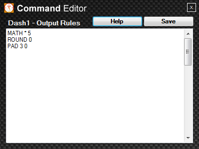

    For other games you can adjust the MATH value to suit your needs for how quickly you want your fans to reach full speed.
    For a driving game you would possibly not need the MATH value at all and just delete it, but possibly a x1.5 or x2 would be needed its entirely your preference.
    Hope this helps the masses somewhat ;)
    Any questions just give me a shout .
    Thanks to @eaorobbie for the original GameDash code which I've added to to get it working :)

    Hey @SilentChill - Just a question around Gamedash and Arduino code... I've noticed a few post referring to the different Gamedash value, like S<Dash1>H<Dash5> etc... (examples, not actual)
    I can't seem to find how people know that DASH5 is H or DASH1 is S. Do you know where this information is??
    Thanks mate. Great work!!

    It is in the code you define "S" as the data coming from the gamedash as speed. You can define what ever you want from gamedash to the Arduino and map what ever you want to it. If you get my drift ;)

    Ahh yes. That makes sense now. I assumed the values were passed from Gamedash, but it's actually the code assigning its own variable to the Dash. Thanks @SilentChill - I love those "penny drop" moments!

    I bought a marine inline blower 12V 10A, the performance is very good. But until the coaster not reaching 5m/s of speed the blade is not spinning and there is a noise coming from the motor.
    I changed the value on game dash math section to 6.2 now it is working at 4m/s ...I prefer to change it to math8 but when I do that, at top speed, between 35m/s to 41m/s the motor stop working then come again when the speed drop to 35m/s.
    How can I solve this problem?
