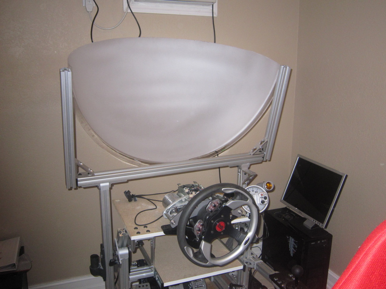

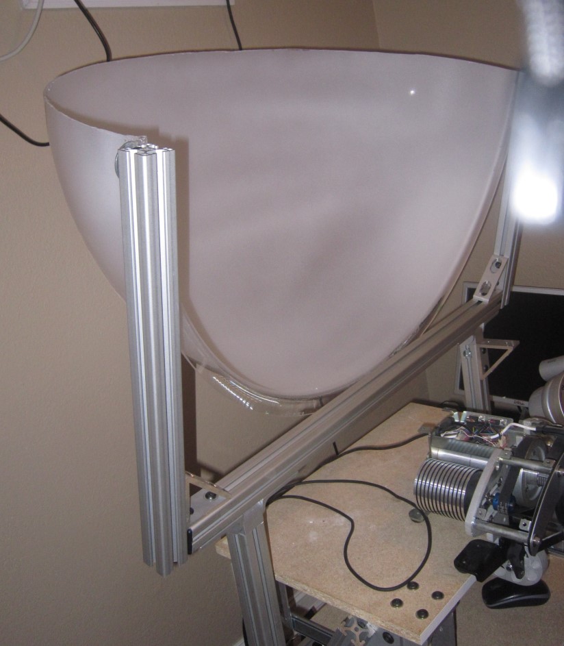

    Just a few more shots of how the dome mounting has been modified I used two 8020 Living Hinges to allow the dome to swing up.
    I will be adding an actuator to automate this motion sometime next week.
    I received a sample of the P95 and it is perfect I held it up to a projected image and it looks fine they sent me white and clear basically the clear is opaque just looks like it has been sandblasted the same effect you would use on a shower door. It is as good as Goo and no spraying an even color across the whole piece with the cost being marginally higher than regular 1/4 acrylic.
    The white works but the image not as clear due to the denser shading
    Still need a taker for the 2nd half of the dome to offset some of my cost…… common guys Frex 24” X 12” $1500 ++ this one 60”X 30” $300 shipped this is a no brainer!

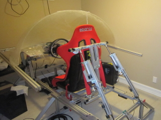

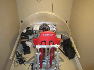

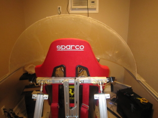

    As I progress I am trying a different approach to the dome screen concept, instead of Goo paint I opted for a “P95 Acrylic” this was supposed to be a perfect surface to project an image onto… alas It did not perform as expected the sample piece the company sent me looked fine holding it in front of the beamer but the dome is a disaster the image is nowhere near as sharp as using a clear acrylic and the Goo Paint.
    It also has a huge hotspot
    I have contacted the Goo paint manufactures and I will attempt to spray this dome hopefully that will solve the image issue.
    If not I will go back to the clear acrylic and the GOO paint as that offered excellent results.
    Looking back I should have stuck with what works and the Goo paint is without doubt the best option.
    The photos are of the dome just after it arrived so it still has all the protective film on it.
    I will post a Youtube of this to show the results and then another once I have sprayed it.
    Another issue is I wil have to use two beamers, as one canont cover the area of a 60 dome. But first I need to make sure using Goo paint over the P95 is going to give me the results I was looking for.

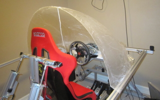

    Here is a short video of the issues what works and what does not work.
    http://www.youtube.com/watch?v=zxMAmXyz6aI
    This is the largest dome I can get my hands 60 X 28 If you go with a dome they can blow it to 50% height of the width that is say you have a 60 Diameter dome you can make it up to 30 max height .
    In saying that I should of made this one even squatter 60 X 26 I think would be a better scenario as 28 is too high it would be more in tune with a cockpit if it was not as high.
    Although it is rather big but seems to be working very well.
    I want to try two beamers as you still lose about 10% at bottom corner leading edges but the image spread is very good with the Gametime PJ. However, right now it is a little cost prohibitive.
    3D was always something to try with this but again it will have to wait.
    I also tried projecting some Youtube video and that looks very good as well, so if anyone has a flight or race video that is exceptional send me a link and I will try to get it up on this screen.
    If you do this GOO paint is the only product to use I was amazed at the difference after only one light coat.
