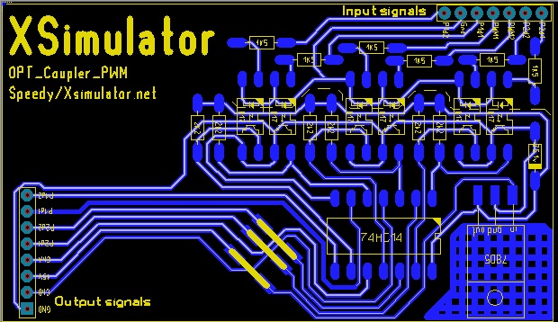

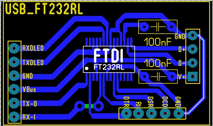

    Here is a USB controller Board that is totally DIY and can operate 2DOF of either DC or AC motors ...
    Running with the Revolution firmware and xSimCTRL software with all it's options for MCU ATMEGA8535/644 with crystals 18/22MHz ...
    SW / FW files are found in the Revolution firmware and software for AMC1.5+1.6 thread

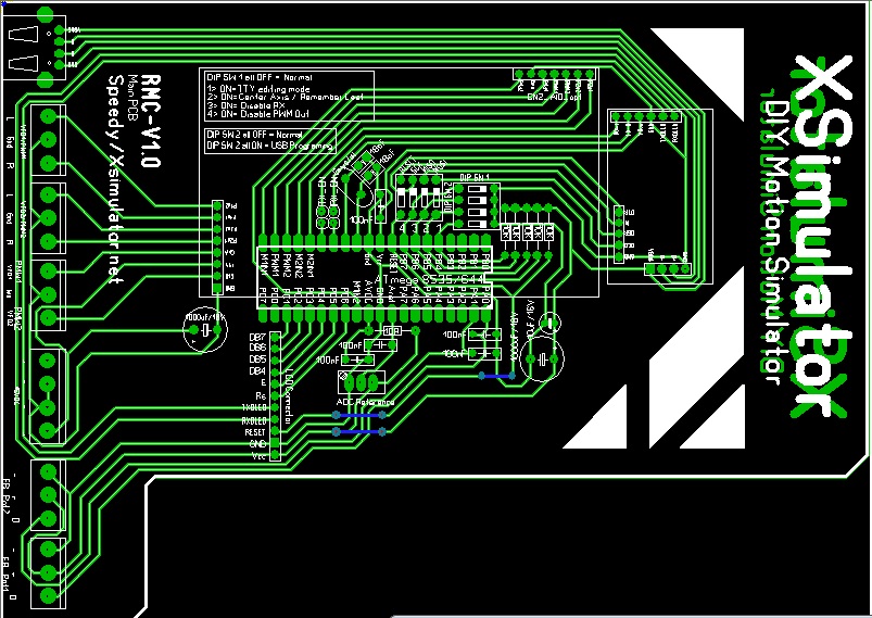

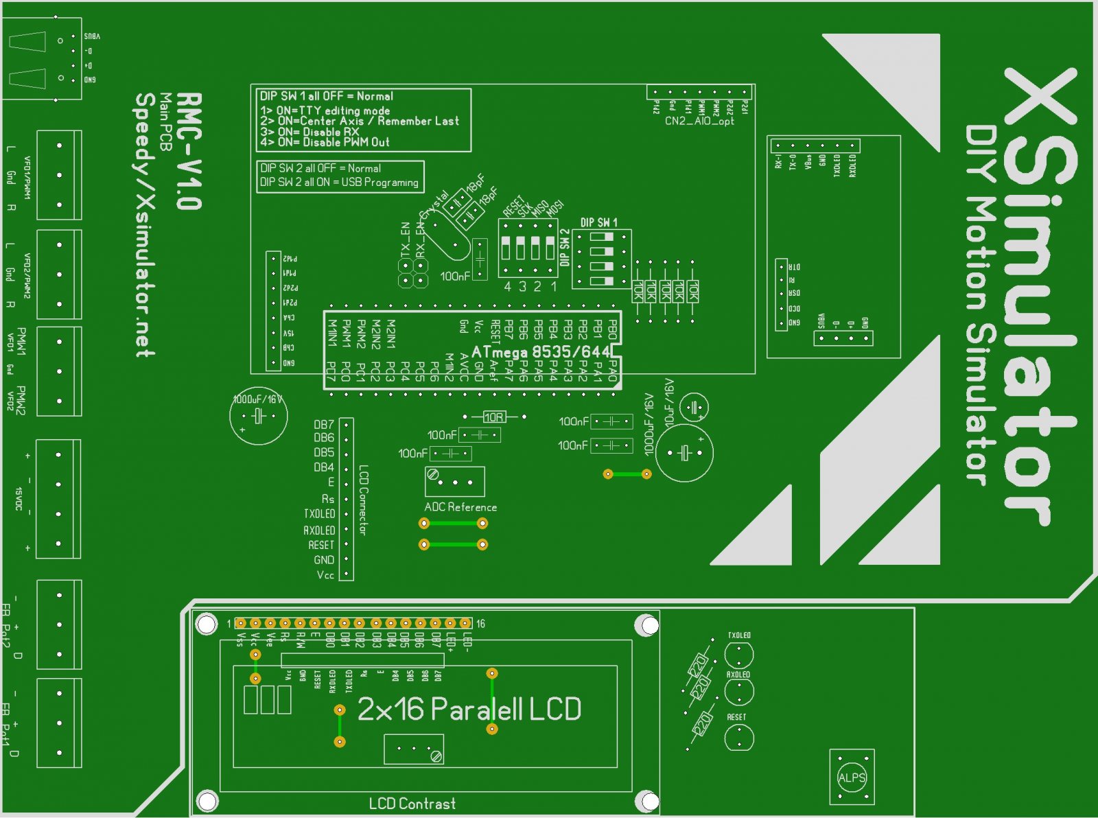

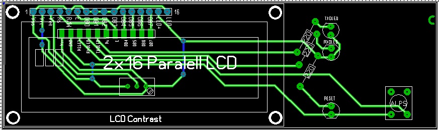

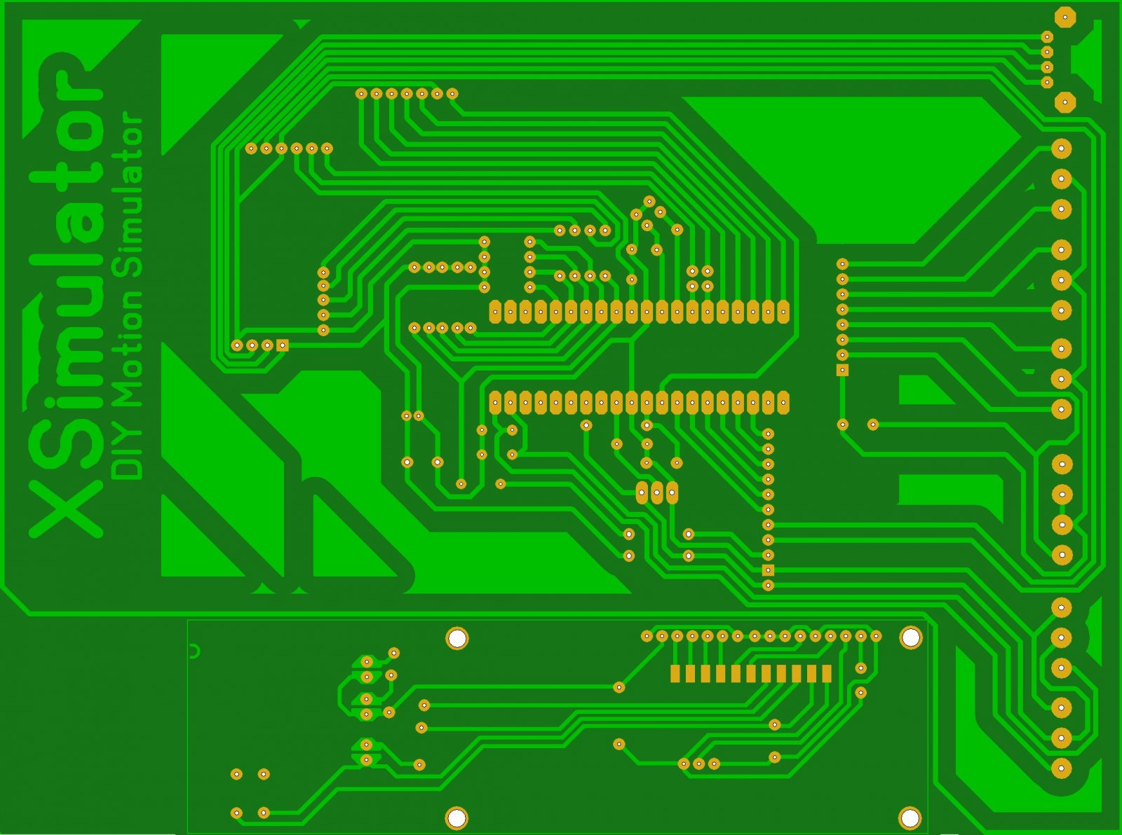

    a preview for the boards used ...
