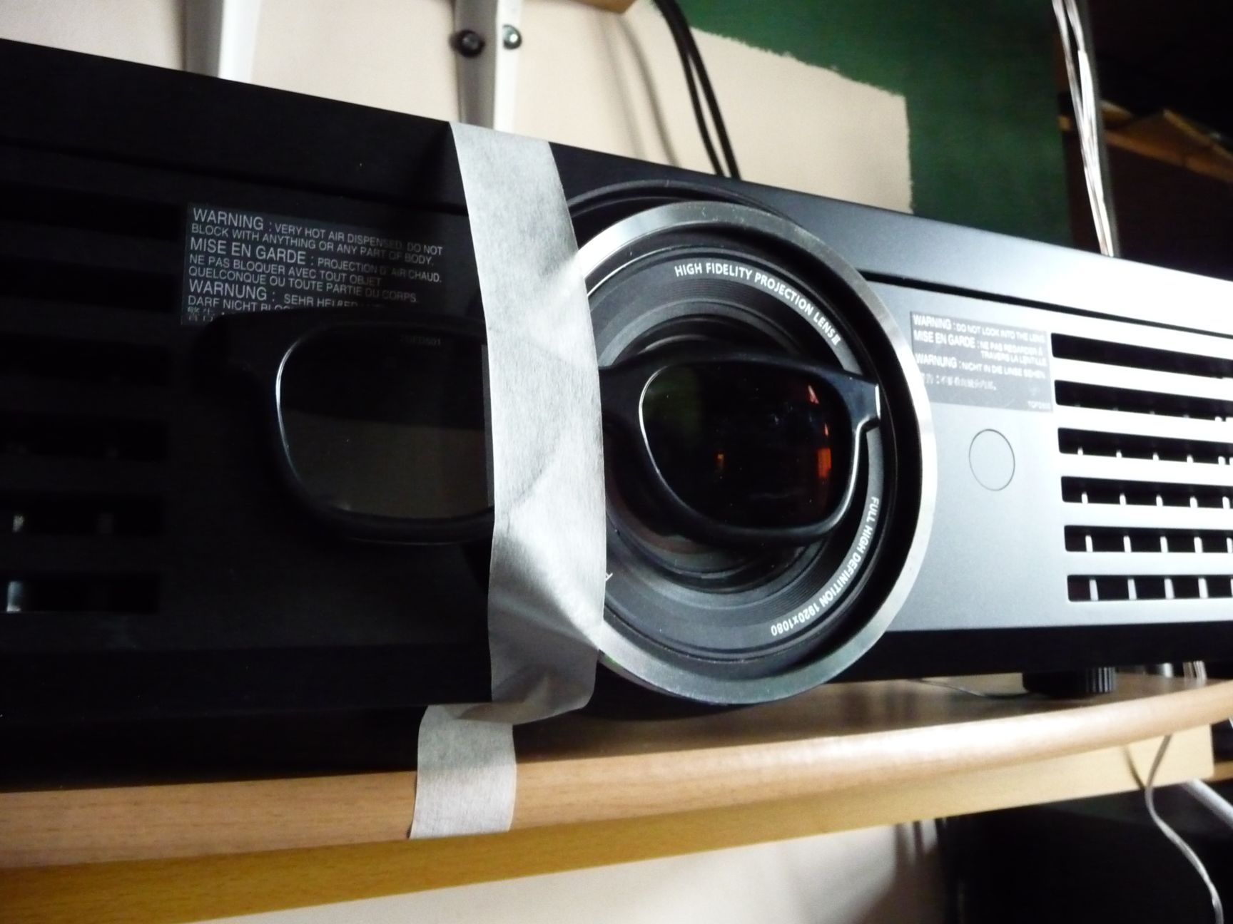

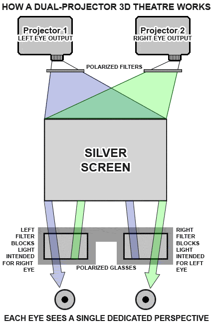

    To create Big Size of 3D picture i used Dual Projector system with polarized filters and glasses - which is one of the best solutions at the moment. Even IMAX is using polarized technology and they are unbeatable.
    This setup creates 3D picture by creating view for left and right eye on one screen when polarized filters on the projectors separating light which you will see by dedicated filters on your glasses. Simple said. Now lets do...

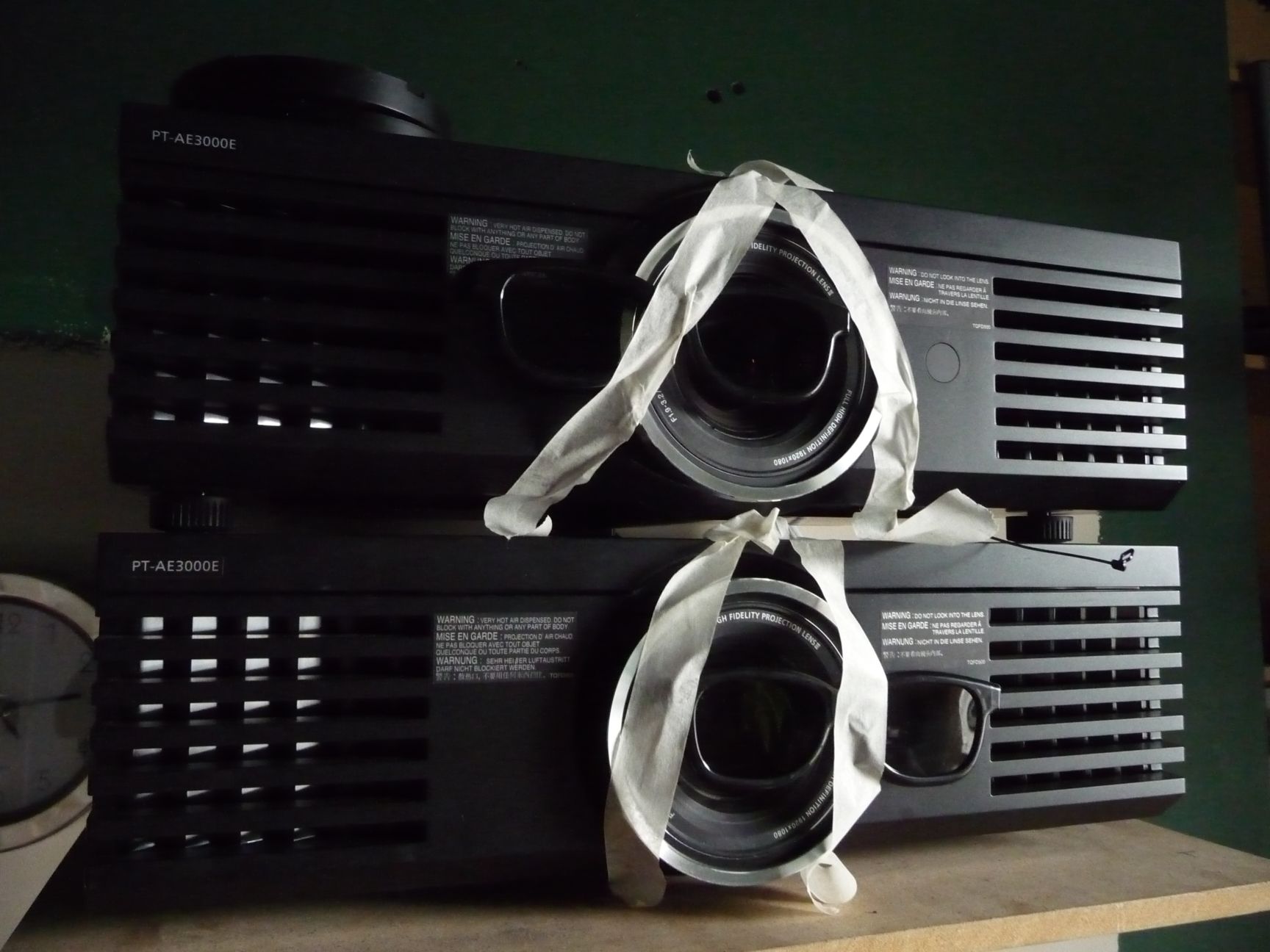

    Projector
    2x any projector. When i am thinking about any it means it can be DLP one or LCD and with any resolution. On 3d forums you can read about problems with some types of LCD projectors and how to manage with it. I did not have problems at all.
    I used 2x Panasonic PT-AE3000 with 1920x1080 resolution on 100 inch screen. Is crucial to use same type of projectors to achieve the best picture before and after transforming it to 3D. Simply - two pictures have to match each other. You are placing them in the same place on the screen.

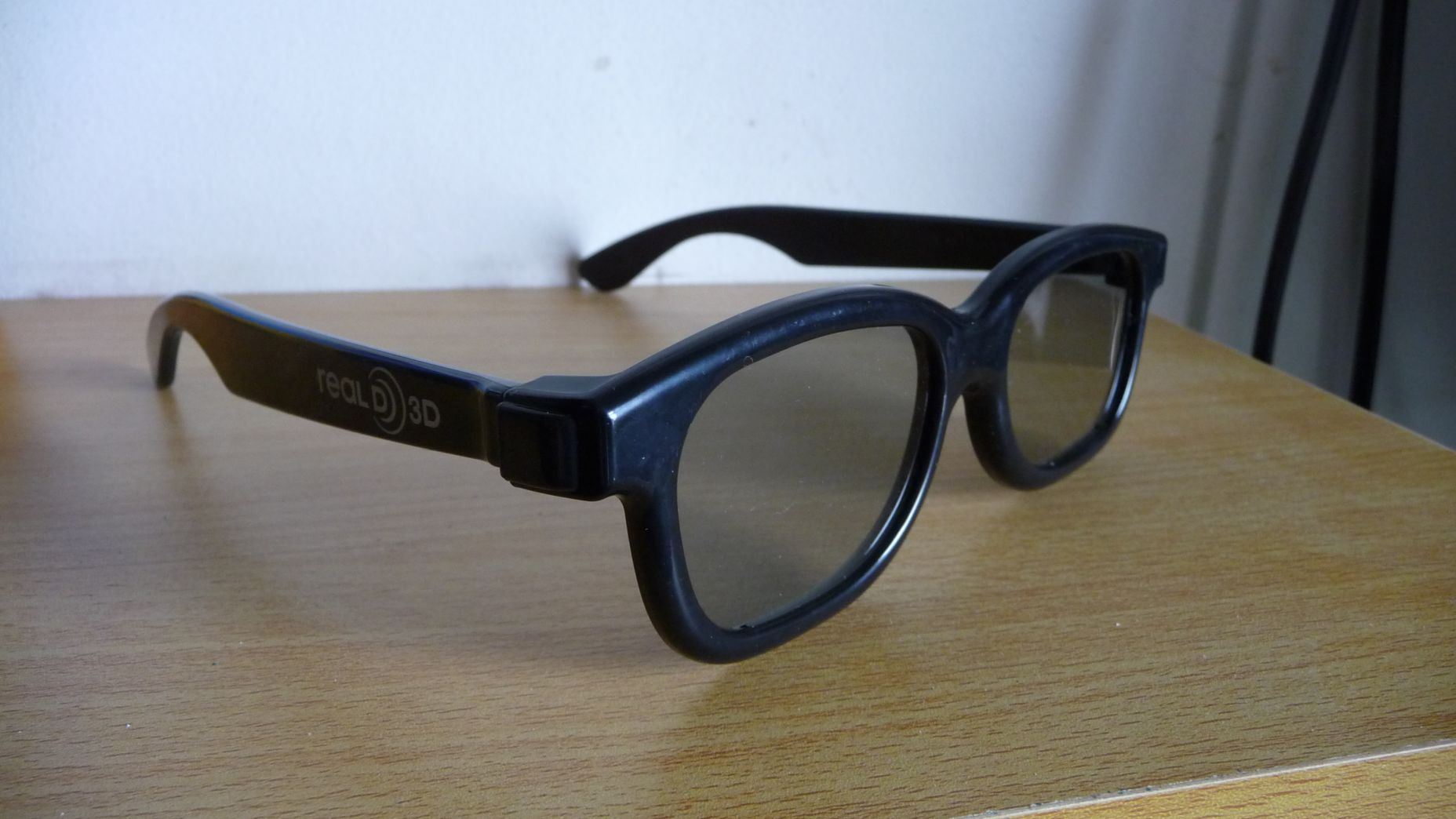

    Filters & Glasses
    I will go back to this subject in the future when i will get some more details about any other options. Since i am happy with this what i got for now i will stick with it as the test setup.
    I have use same filters for projector and glasses. You can split one pair of glasses and put each lens on the projector`s lens. This way you will achieve differently polarized light from each of them. Another glasses are for you.

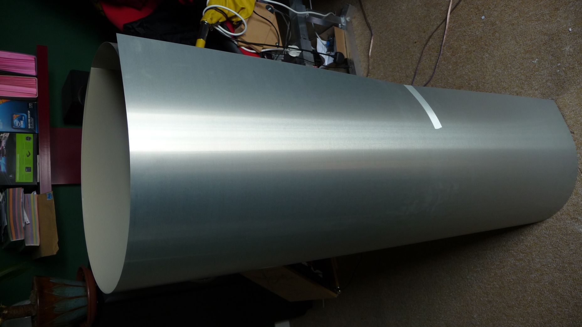

    Screen

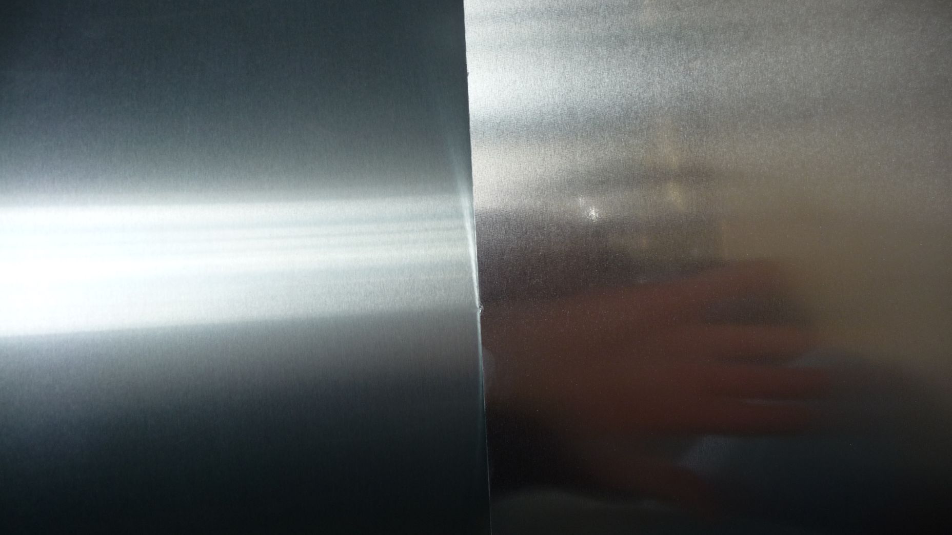

    To be able to see what came from polarized light you need to use special screen. On the market you can find lots of them (they are not cheap). Since everybody knows that it has to be kind of metallic surface - everybody is trying to make his own by using paint with metal bids or just finding some metallic boards.
    For example to my tests i picked up kitchen foil and garage doors (they were hardly painted at the back and metallic surface was still adopting light). Yea i know - there were garage doors in my room!
    But the biggest blast in the face i get when i picked up big aluminum sheet from my friend. Aluminum is kind of matt and maximally adopting polarized picture. It is matt but still reflecting light thats why i shaped screen a little bid to get picture being equally bright and not dazzle me.

    Rock`N`Roll guys that works so good. That is the best additional to Race Sim. Right now i am scared when i am driving - everything looks soo real. You can see how far is to turn and what is yours distance from cars. You rally feel like there is space on the front of you. Don`t get me like i am a Kid who gets a candy. I have experience with 3D from very beginning, when that was about color glasses. Right now i am just talking about Huge picture with impressive quality. Natural sizes of the world on the front of you and this sharpness and quality !!!
    Skipping cost of the projectors the rest is very cheap.
    Glasses can be buy in local cinema (same what they used for Avatar and Alice). I bought some from Germany (3.5 £ two of them).
    Aluminum sheet size 3000x1500 - 50£.

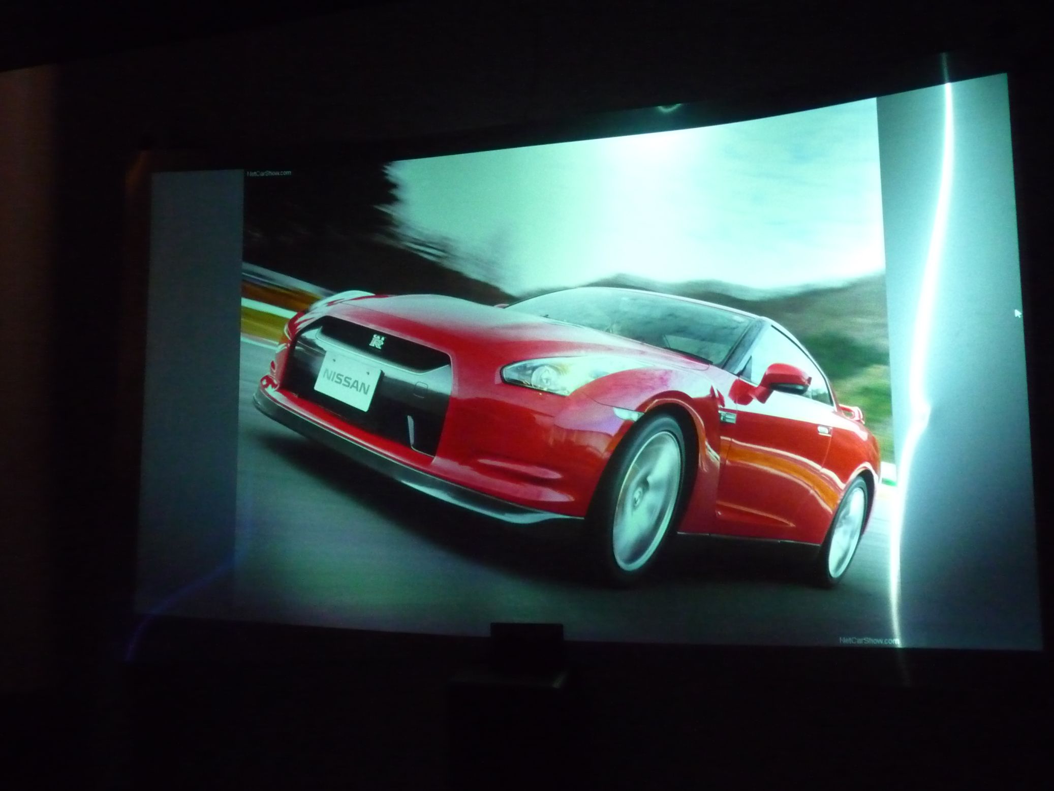

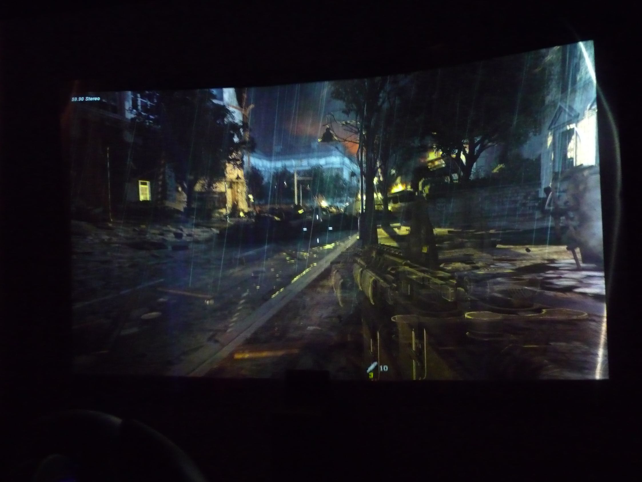

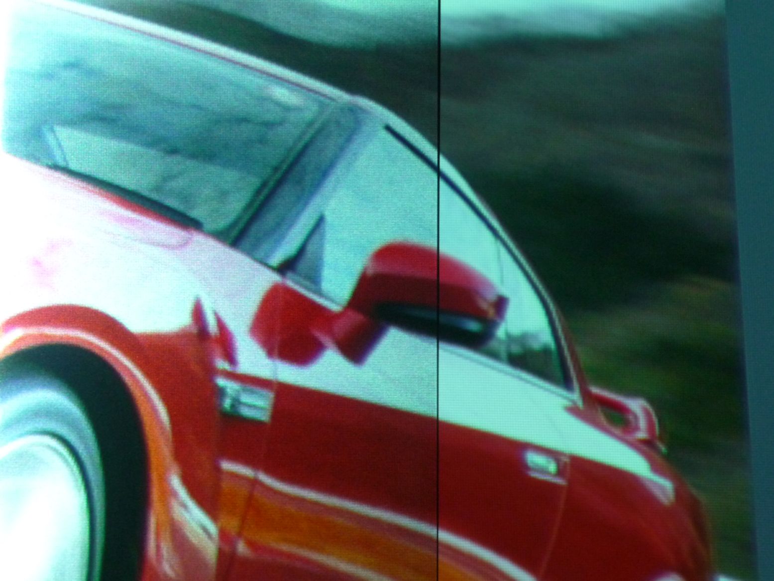

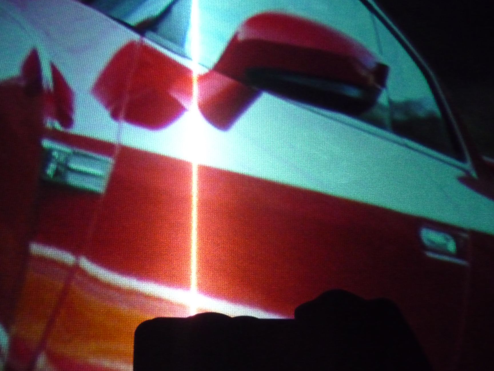

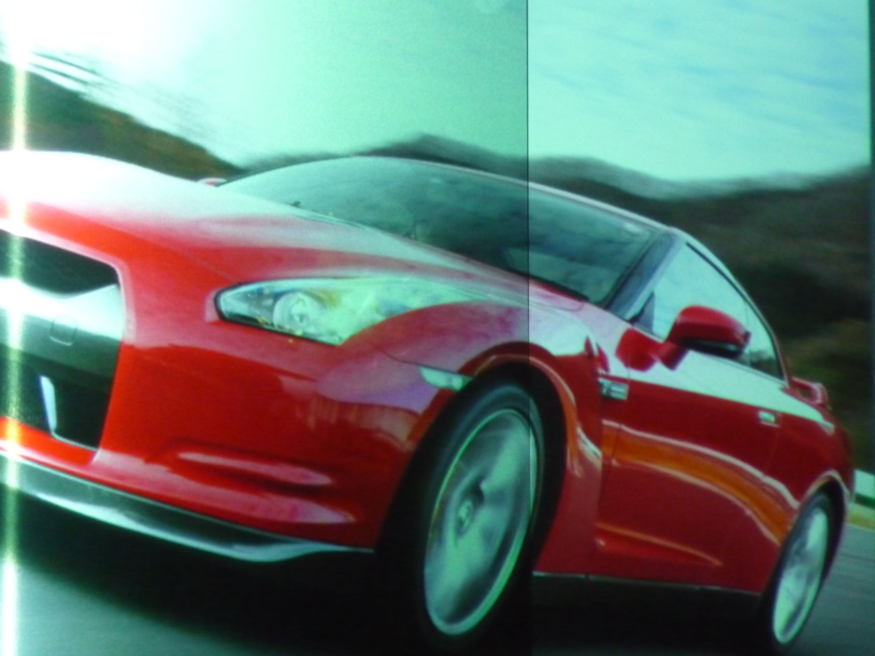

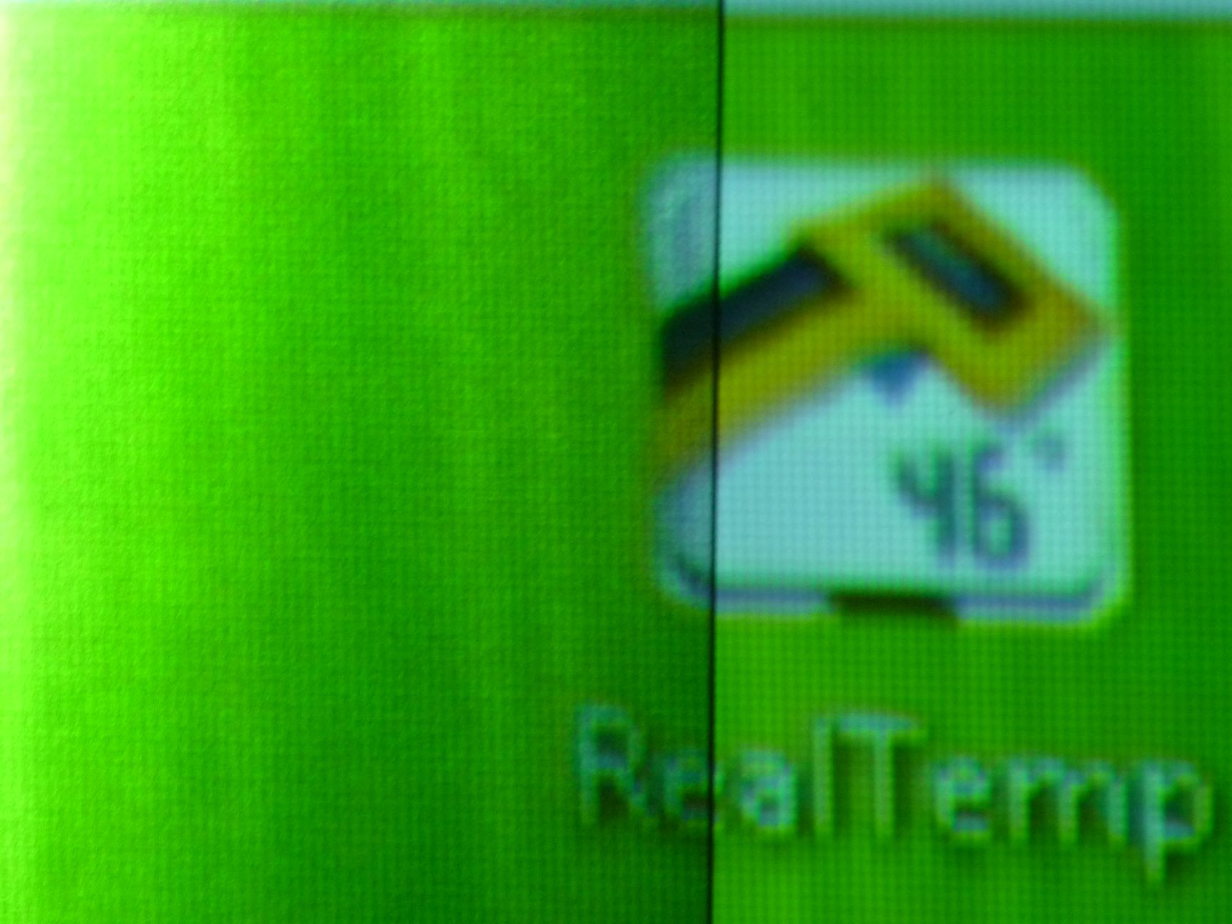

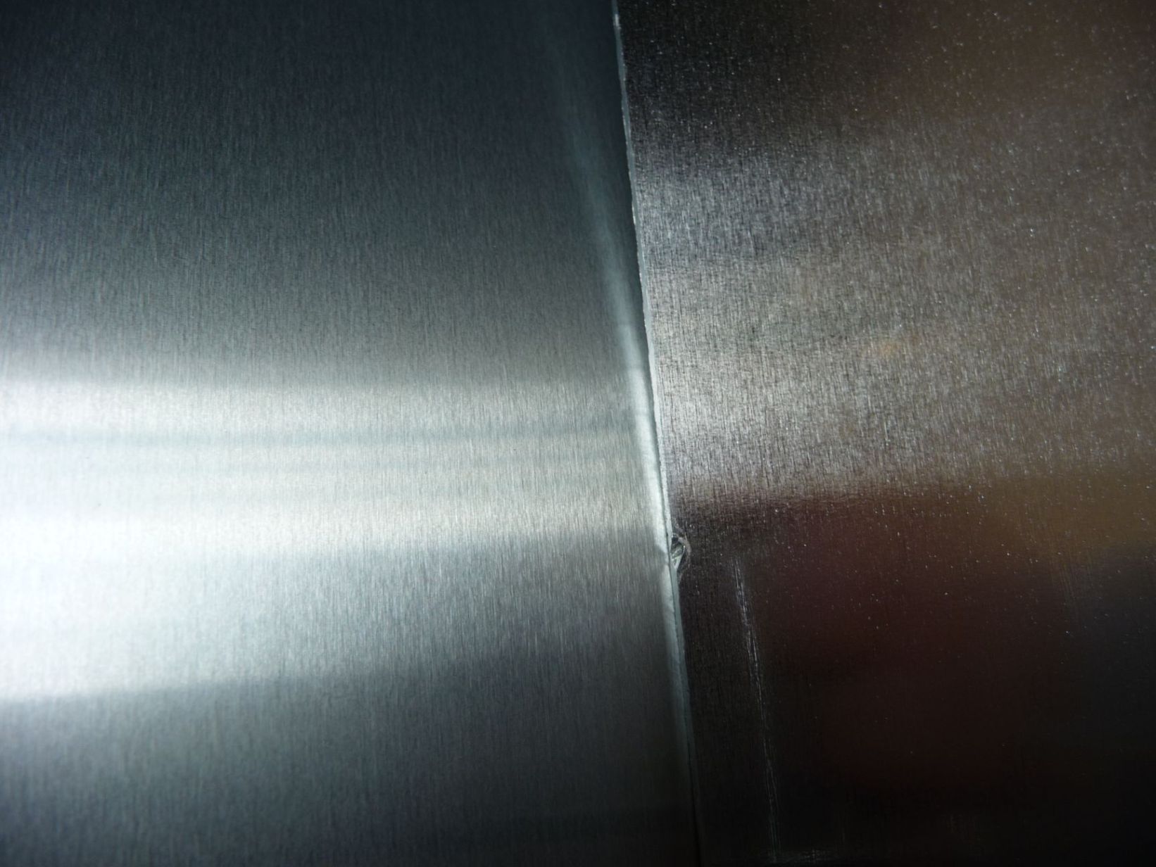

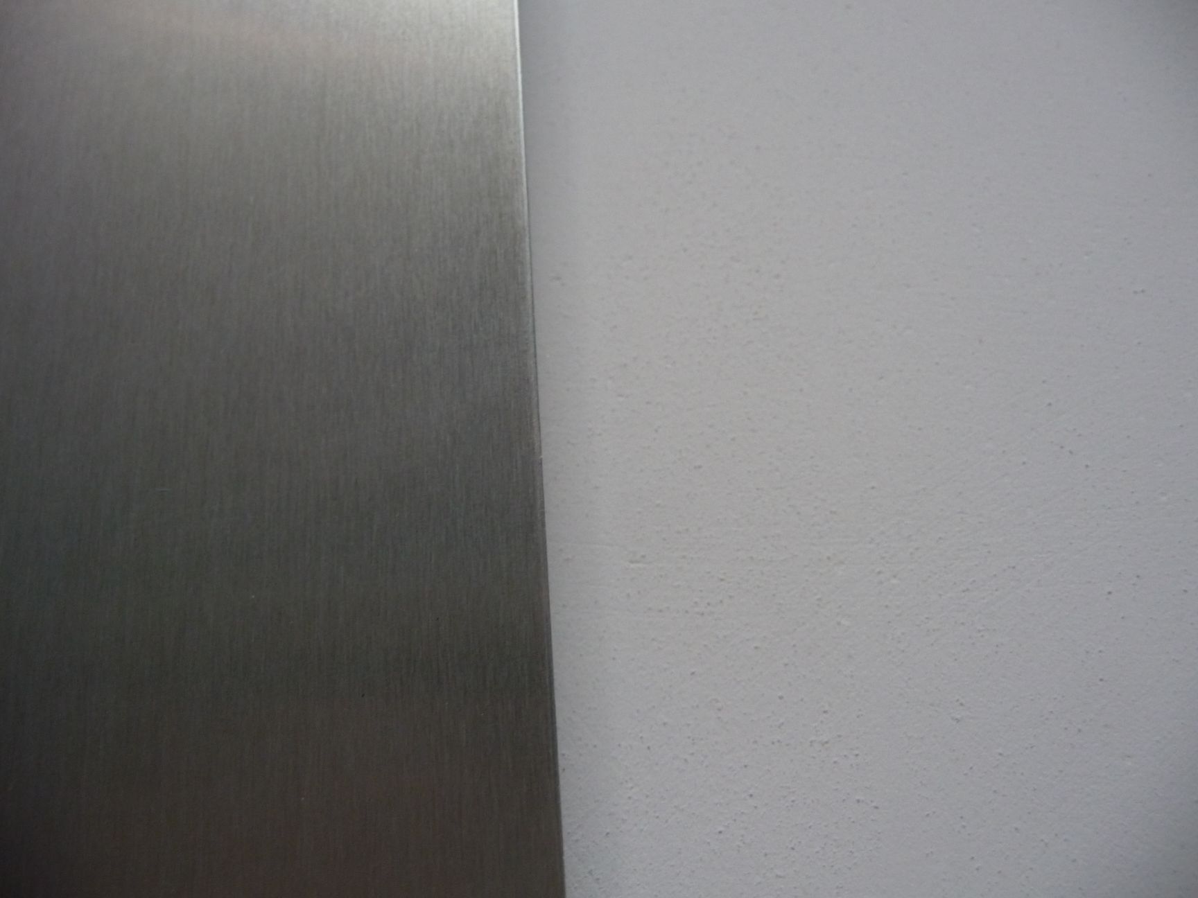

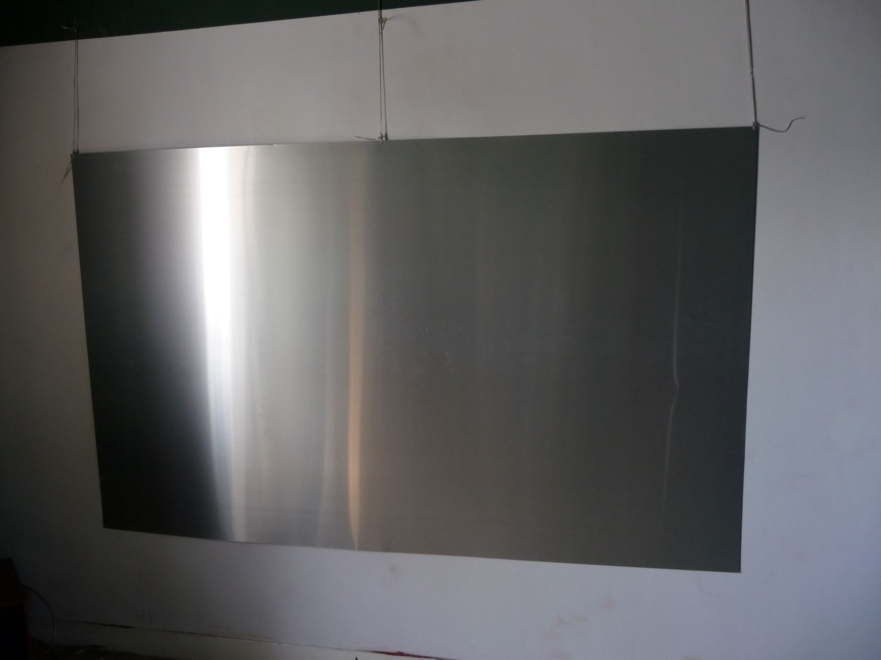

    BINGO ! Like for me it is so great that i`am not looking for better one (at the moment). I just pick up different sheet of aluminum. On the front it is painted but the back is clear alu. Compare to first one which i use - this one is less reflective and surface is smoother. Basically it is better quality one. Actually quality is so good that i can compare that to standard flat screen which i was using before (painted and polished white wall).
    Sheet is very fine (about 0.8 mm). I was only able to buy 1200mm high (thats why at the end it is 2200x1200). I paid 5£ for that!
    This aluminum still reflecting some strap of light from projectors thats why i had to bend the screen a little bid. It doesn`t change picture at all - in 3D still looks like it should be (2D picture usually is deformed). I still have some light on the side of screen (you can see that on picture) but it doesn`t irritate me. In fact i will get rid of it when i will make proper mounting for screen with permanent shape.
    On the pictures you can see how screen looks compare to my old wall and also how 2D (1920x1080) picture looks like on the screen compare to white wall.
