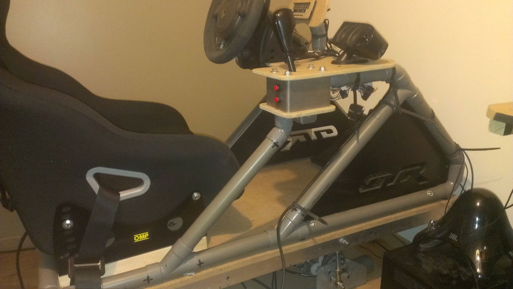

    Hello all,
    This is my simulator 2 dof.
    It is made of wood and aluminum and steering wheel holder is made of pvc.
    The electronics are made of an Arduino and a 24V pololu card.
    The motors are 24V smolka
    Thank Racing Mat because it is thanks to its tutorial.
    currently running with the simulator software XSIM but I show you mine this forum in order to earn Coins.
    That after the brief space for photos:

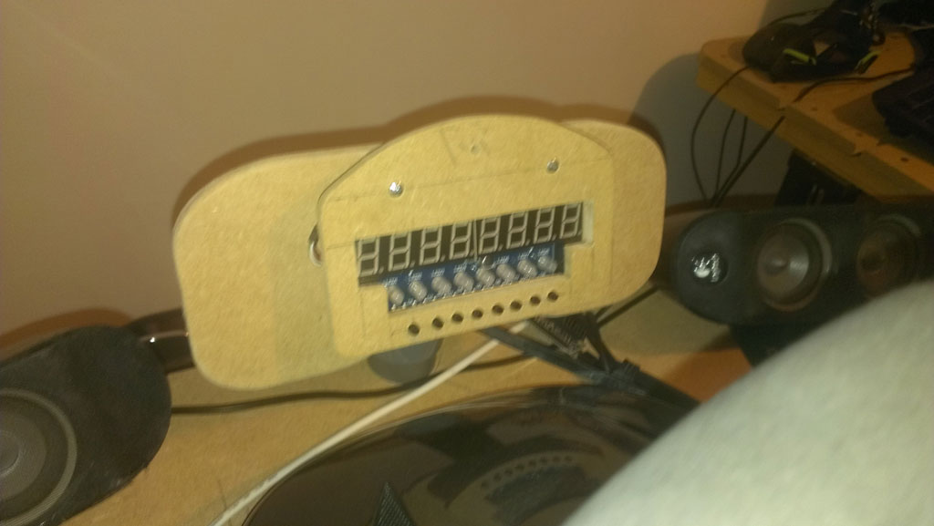

    Nice job on the PVC frame there. Good to see another PVC sim going to motion. I like the work you have done with the shifter box and dash, very neat.

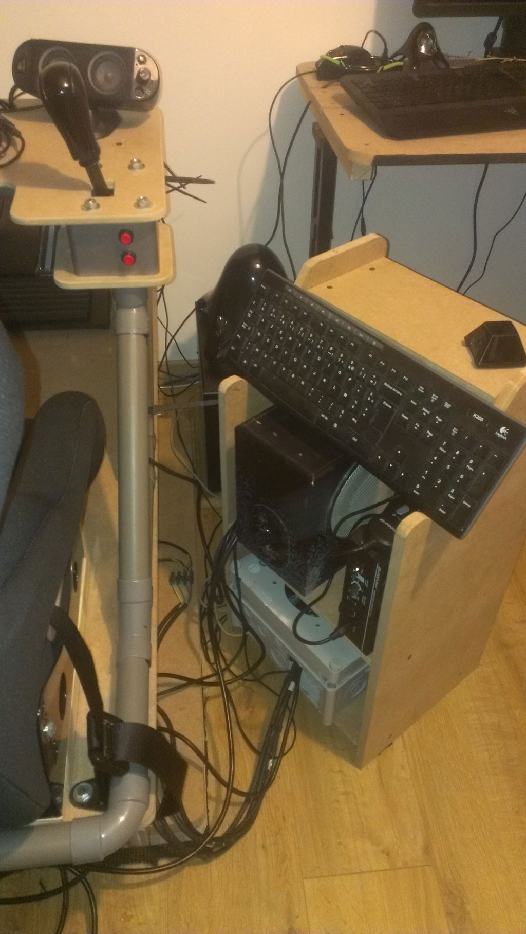

  7. michto35
    michto35 Member
    Jan 31, 2014
    97
    france
    102Coins
    +52 / 0 / -0
    thanks
    The shifter has been done with a selector bmw buy on ebay.
    I show you some pictures of the assembly.

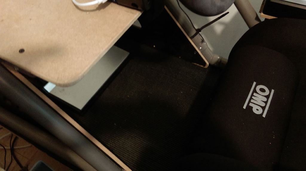

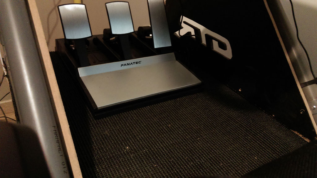

    pvc structures is good but the friction of pvc against wood makes a lot of noise.
    So as a solution I have half a carpet between wood and pvc, now I no longer any friction noise.
    I also rivet any junction structure.
    I add a joystick to play Elite dangerous.
    I also change my pedal that's much better than my old one.
    Here are some photos.

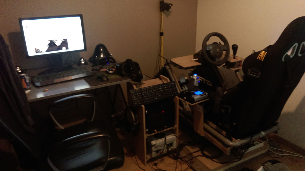

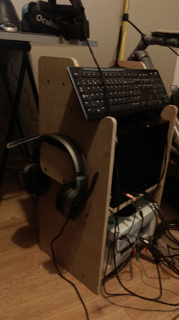

  11. michto35
    michto35 Member
    Jan 31, 2014
    97
    france
    102Coins
    +52 / 0 / -0

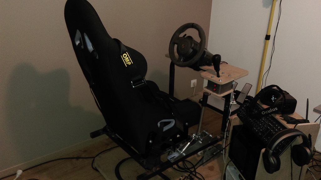

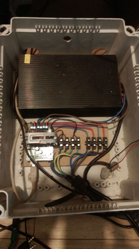

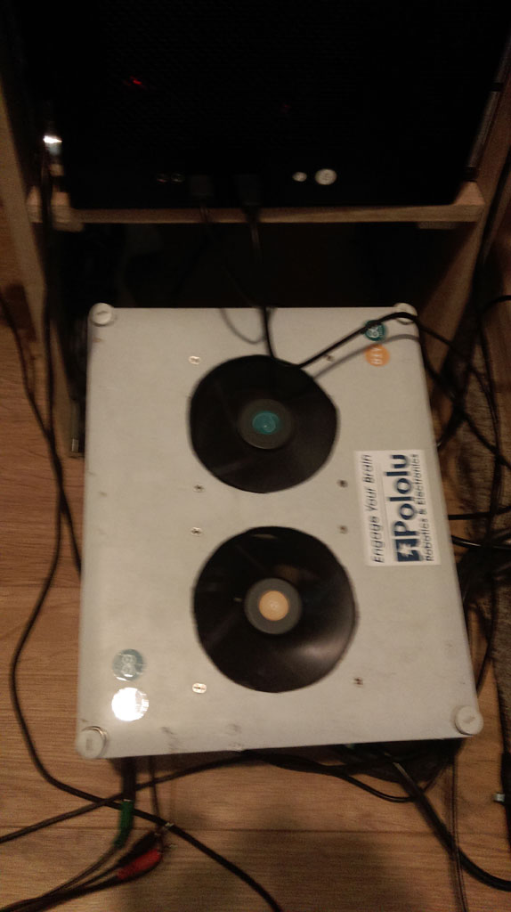

    I take this opportunity to show you an overview of my installation.
    the small cabinet to rate simulator is homemade.
    it allows me to put my keyboard, the rift, my headset and mouse.
    Below I have half my pc.
    then the electronic box that allows you to run the simulator.
    It is a junction box electrician, 2 ventillateur 12 cm to cool.
    was found inside the 24V supply and the card arduino and pololu.

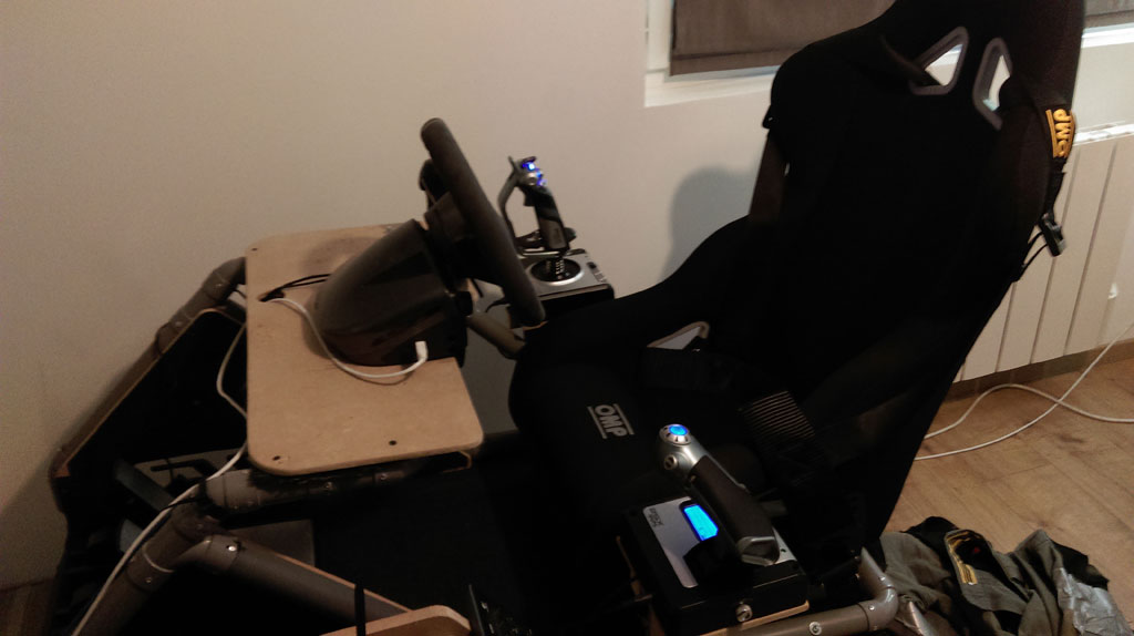

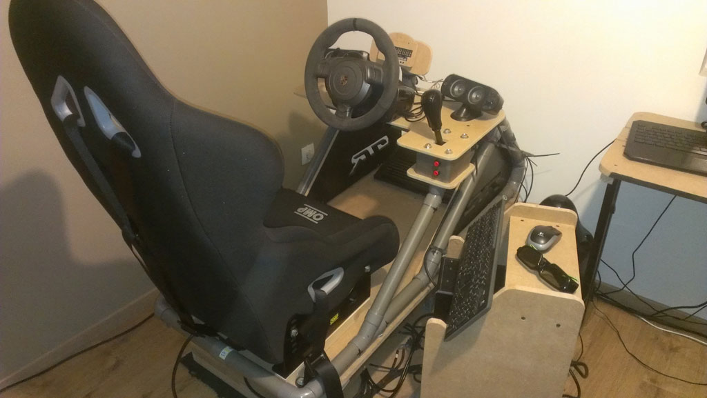

  12. michto35
    michto35 Member
    Jan 31, 2014
    97
    france
    102Coins
    +52 / 0 / -0

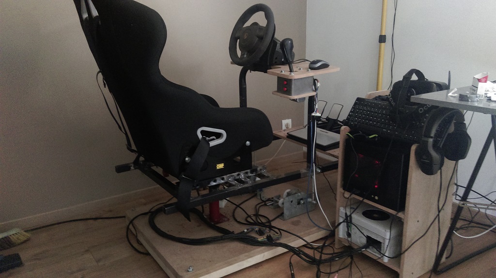

    Hi everybody :cheers

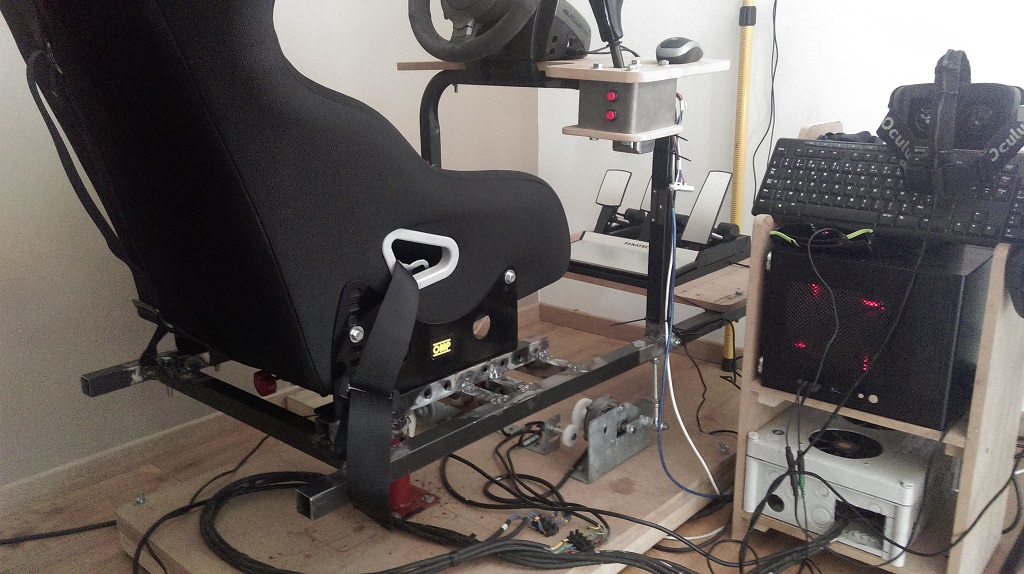

    This week I changed my simulator because it was made of wood and began to grow old and make noise.
    A force to tighten the screws wood crashed.
    So I retrieve an old bed base and I are cut into pieces and weld.
    I am satisfied, no welds because they are not beautiful o_O but it's solid.
    The rigidity of the structure and the sensations it gives on the simulator are exellent.
    no parasite movements to the flexibility of PVC.
    none of grinding noise either.
    This morning I'll make me a hand brake to play dirt rally. :grin
  13. zigzag49
    zigzag49 Active Member
    May 27, 2014
    251
    720Coins
    +220 / 3 / -0
    nice work michto, on the wheel carrier saw diameter tube, a reinforcing bar on it would have been a plus for rigiditer?
    beau travail michto , sur le support volant vu le diametre tube , une barre de renfort sur celle ci aurait été un plus pour la rigiditer ?
  14. SilentChill
    2,645
    20,581Coins
    +3,566 / 34 / -0
    Great upgrade steel a lot better than wood :) Looking good
  15. michto35
    michto35 Member
    Jan 31, 2014
    97
    france
    102Coins
    +52 / 0 / -0
    Thank you :thumbs, I am eager to go to finish.
    For the reinforcement of the steering wheel bracket I wanted to test without a bar because I wanted the lightest possible strucutre.
    For rigidity I find it sufficient but if I see that it moves I would make a reinforcement.

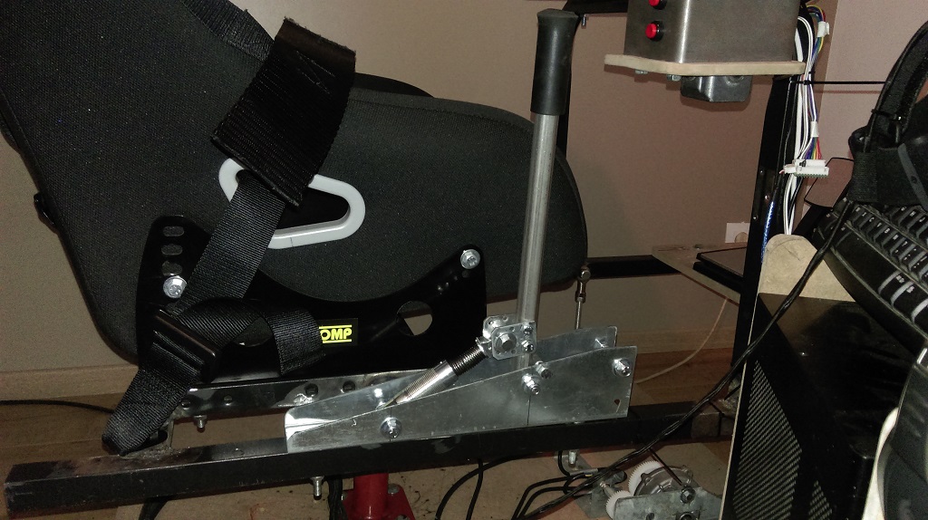

  16. michto35
    michto35 Member
    Jan 31, 2014
    97
    france
    102Coins
    +52 / 0 / -0

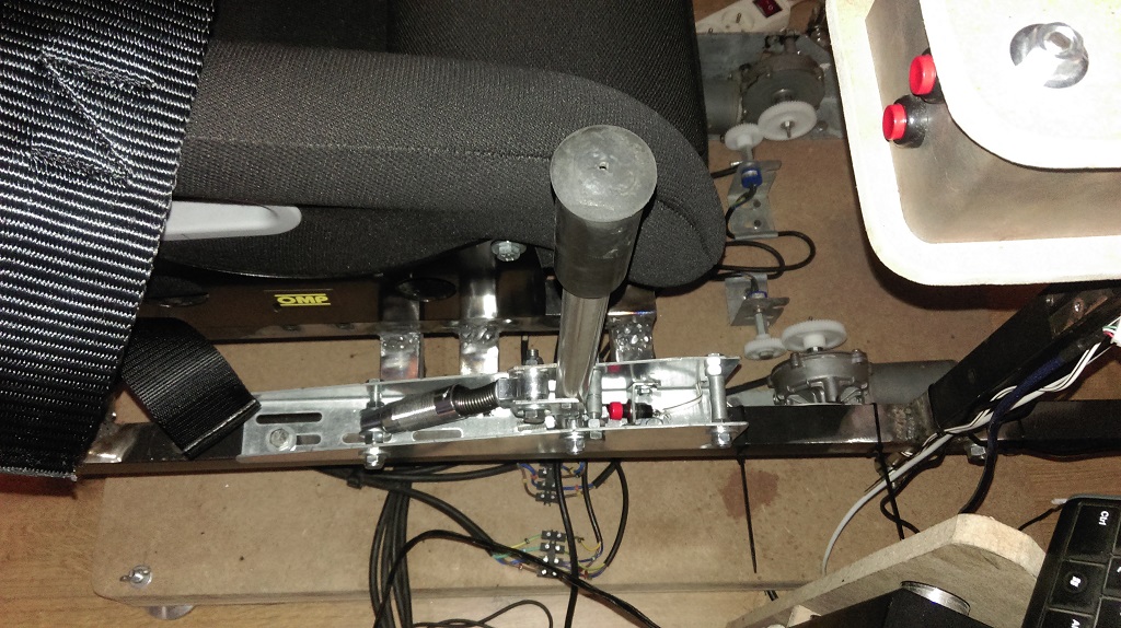

    Here is my handbrake DIY
    it is found that recovery equipment at work and in my garage.
    the base is a cable track support.
    diameter stainless steel tube 20
    bike handle
    push Button
    spring my old pedal FANATEC
    absorber bike
    here is the result
  17. noorbeast
    21,487
    150,542Coins
    +11,017 / 55 / -2
    A great bit of recycling ingenuity @michto35 :thumbs
