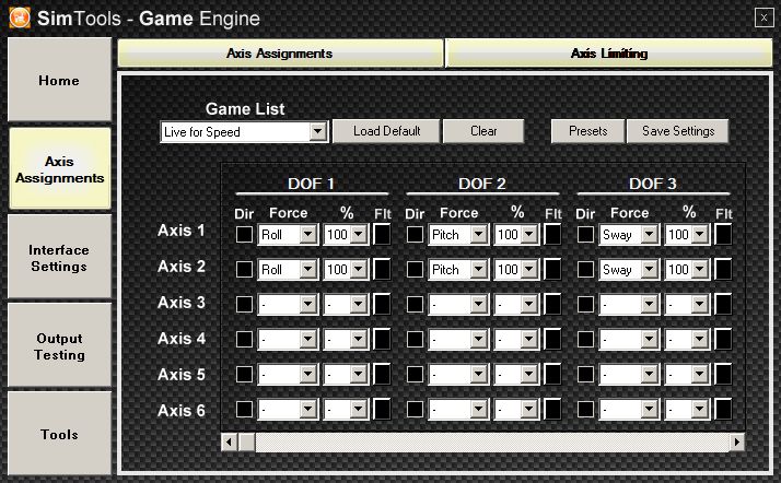

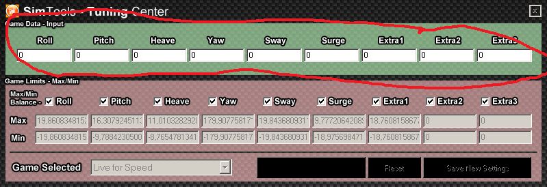

    I threw myself into making a 2Dof for now still at the experimental stage.
    I started with a XSIM K8055 and configuration, and decided to move on
    arduino and Simtools.
    After installing Simtools, I get to a résulat Output in Testing, but no game with LFS data set will appear in Tuning Center (cf. Attached). Can anyone guide me?
    thank you

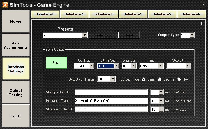

    @Dronneau.Y, do you have a interface setup for output?
    can you post screenshots of your Game Engine settings?
  6. Dronneau.Y
    Dronneau.Y Member Gold Contributor
    Aug 22, 2015
    43
    france
    95Coins
    +7 / 0 / -0
    Here, thank you!

    I am not sure what code you are using to interface with SimTools and some further details would help: http://www.xsimulator.net/community/faq/arduino-code-for-use-with-various-hardware-and-simtools.31/
    The total for each Axis should be 100%, not 100% per DOF: http://www.xsimulator.net/community/faq/axis-assignment-percentage-totals.120/
    The official SimTools documentation is here: http://www.xsimulator.net/simtools-complete-documentation/
    Download @Pit's handy guide to setting up SimTools, installing plugins, setting comport for Arduino and motion profile making: http://www.xsimulator.net/community...t-up-simtools-arduino-and-write-profiles.123/

    Which Arduino Code are you using?

    Yes, I put 100% axes because I had no result, but I understand the need to allocate 100% between all axes.
    In terms of the code is that of Wanegain v1.23

    So, is the game patched OK and does the Game Manager turn blue indicating the game is running: http://www.xsimulator.net/simtools-game-manager/
    And since you changed the language settings of the computer to US do you now see a decimal point instead of a comma in the Tuning Center numbers?

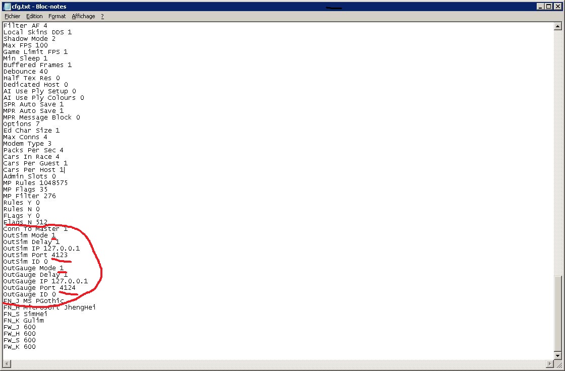

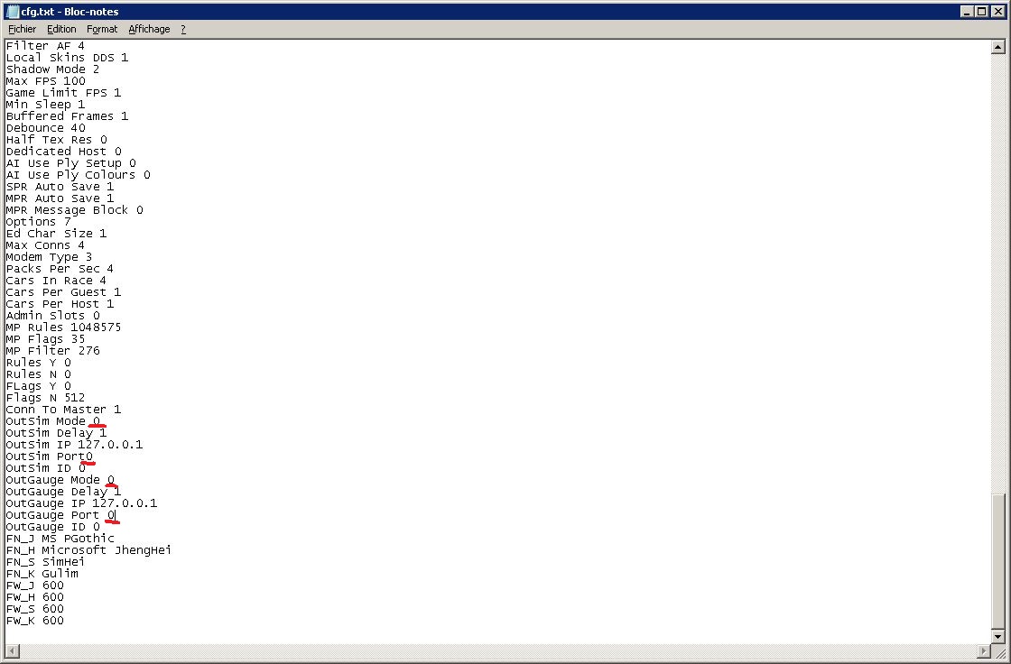

    I just found the file CFG.txt Live for Speed was the Wrong.
    Thank you for your support
    cf. attached files
