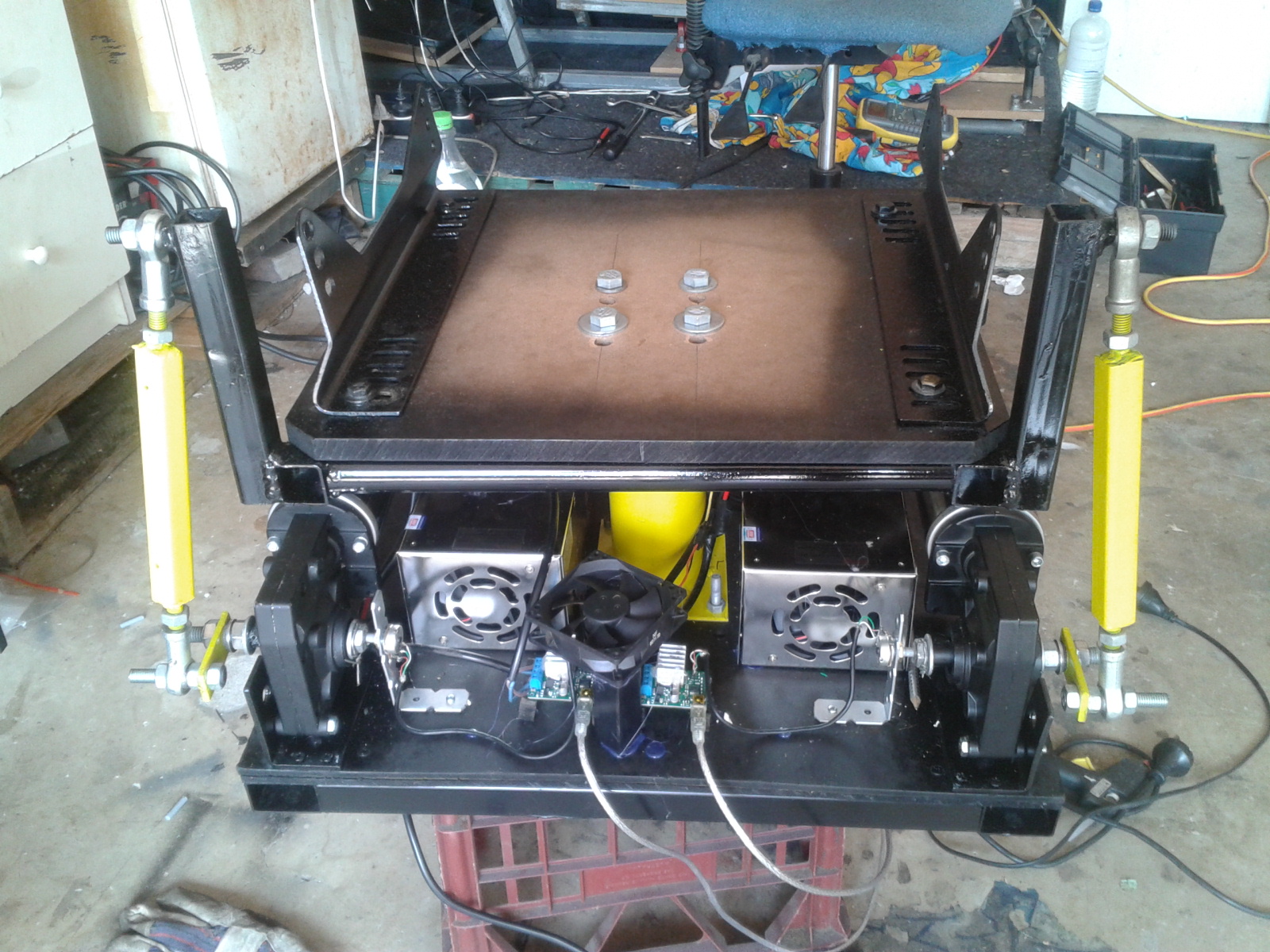

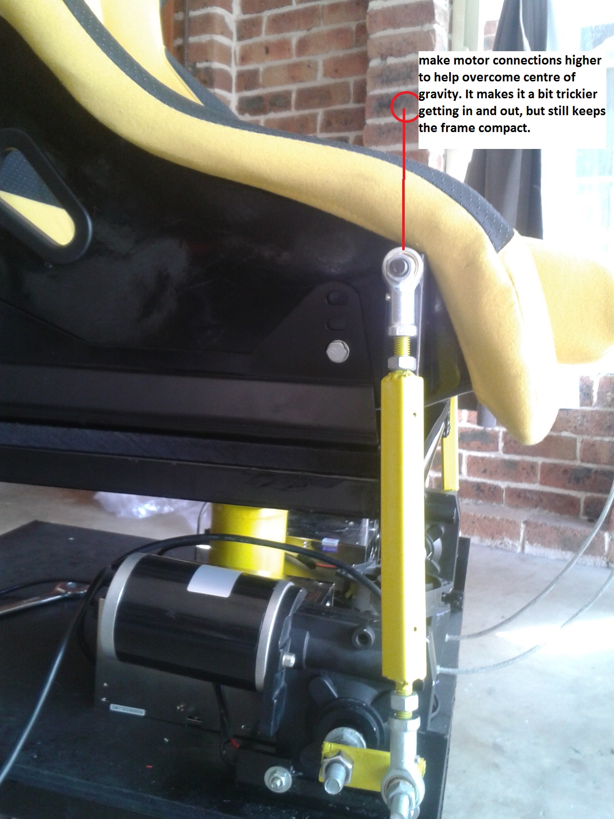

  4. bsft
    Yes they will do, you just need to balance the whole thing right for pivot placement. Low holding torque is more when power is off, but yes they move a bit, just think of it as car suspension getting in and out of a car, it "springs" a bit. Not a problem once you are in game though.
    I regards to your other message you sent, yes you could put the GS4 on top of the desk racer set up
    Just put the GS4 on the base. But you would need to make the motor connections higher up the sides. to help overcome gravity. Even higher if possible than whats pictured.
    Something like suggested. And keep motor lever arms 40mm CTC to help keep as much torque as you can. With 40mm CTC and about 60mm throw it equates to about 250mm per second. Thats what mine runs and gets fine vibrations.

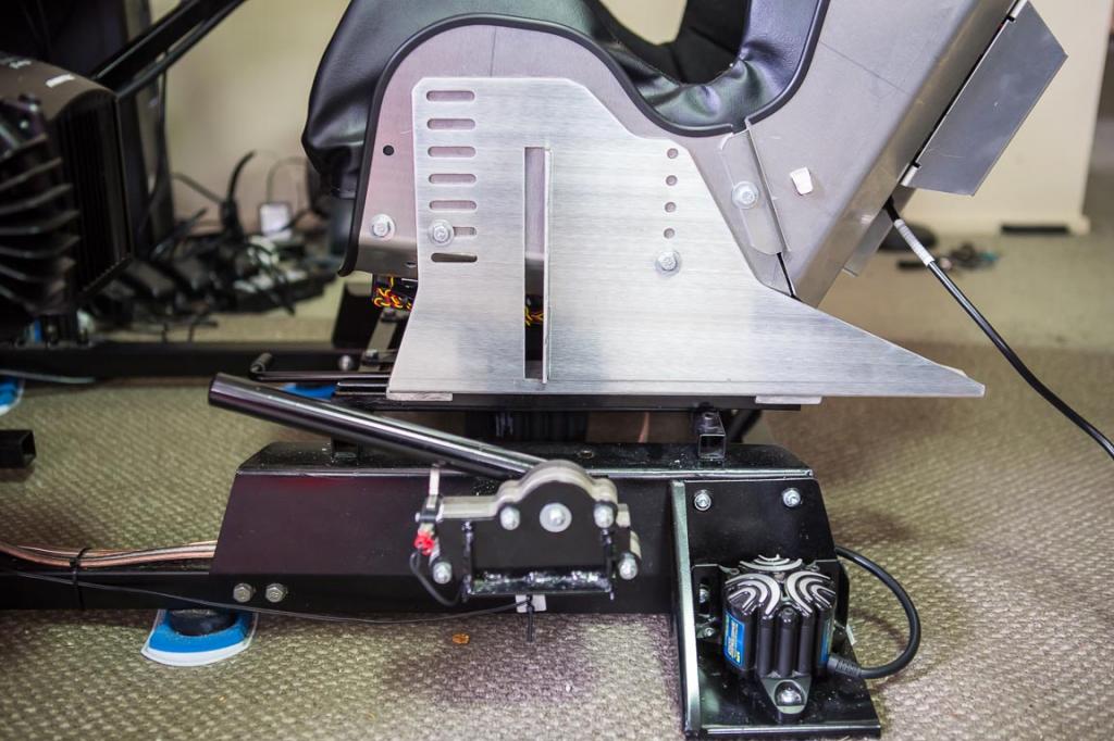

  5. Avenga76
    Avenga76 Well-Known Member
    Jun 29, 2014
    518
    Network Engineer
    Auckland, New Zealand
    3,261Coins
    +859 / 6 / -0

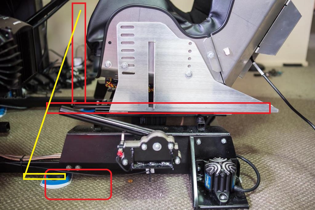

    Cool. Any tips on finding the balance point?
    The GS-4 seat has really tall sides so I can go pretty high. I could go even higher than that because with the GS-4 it is pretty hard to get in to anyway. You can't get out sideways like you can on a normal seat, you need to take off the quick release wheel then step in to the simulator then sit down. It reminds me of how I need to get in to my friends AC Cobra and having to take the quick release wheel on and off reminds me of race cars. it sort of adds to the immersion.
    I have been thinking how all the systems will work together and I think they will really compliment each other because they are each really good at one aspect. The GS-4 seat is really good at providing sustained lateral, longitudinal and vertical g-forces but it is not that great at bumps and the initial motion of turning in. I see the seat mover system being good at the bumps and the initial force of turning but in a long turn it can't really provide that sustained g-force because you have reached your maximum tilt angle and gravity isn't enough to generate the g-force feeling.
    The GS-4 bases all it's motion from the G-force telemetry data and the Seat mover will be getting it's data from the roll and yaw etc. So I think that they should work really well together.
    So how I see it working through a corner is that the seat mover will give you that initial turn in force, then the GS-4 will maintain the G load as you corner then the seat mover will provide the straightening up forces. And the transducers will do all the little stuff like engine vibration, road texture and ripple strips.
  6. bsft
    to find the balance point, build the top desk racer frame, sit the gs4 seat on top, sit on it as you would, and allow if your legs sit up a bit. Its not an office chair.
    Then sit the desk racer frame with gs4 and you on a broom handle. Get a mate to roll you back and forth till you find a balance point, mark it and thats where you put the pivot.
    As for getting in and out , in that case, make them as high as you can without going to shoulder height, so above knee height if your knees are higher than your belly or belly height is gut is above knees would be ideal. The bass shaker would need to be moved. I think @Nick Moxley has good ideas where they can go. He did a static to seat mover conversion as well, but with shoulder mounted motors
    Another rough sketch
