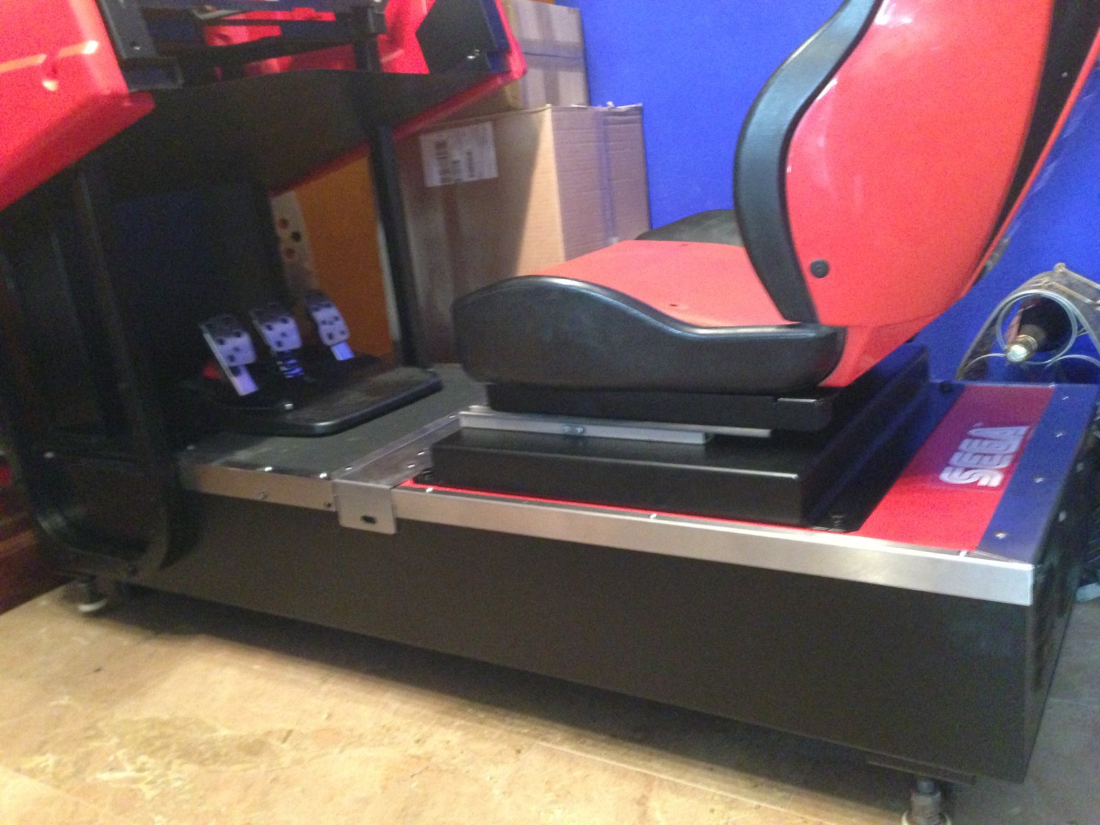

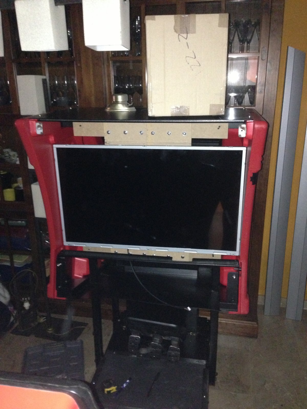

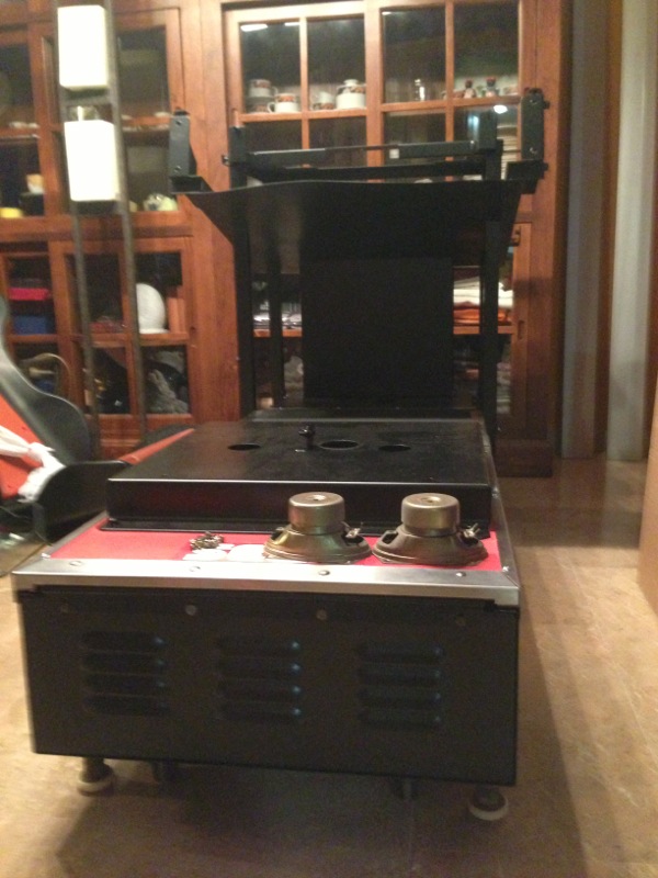

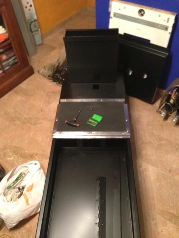

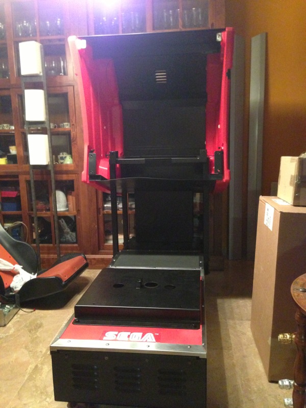

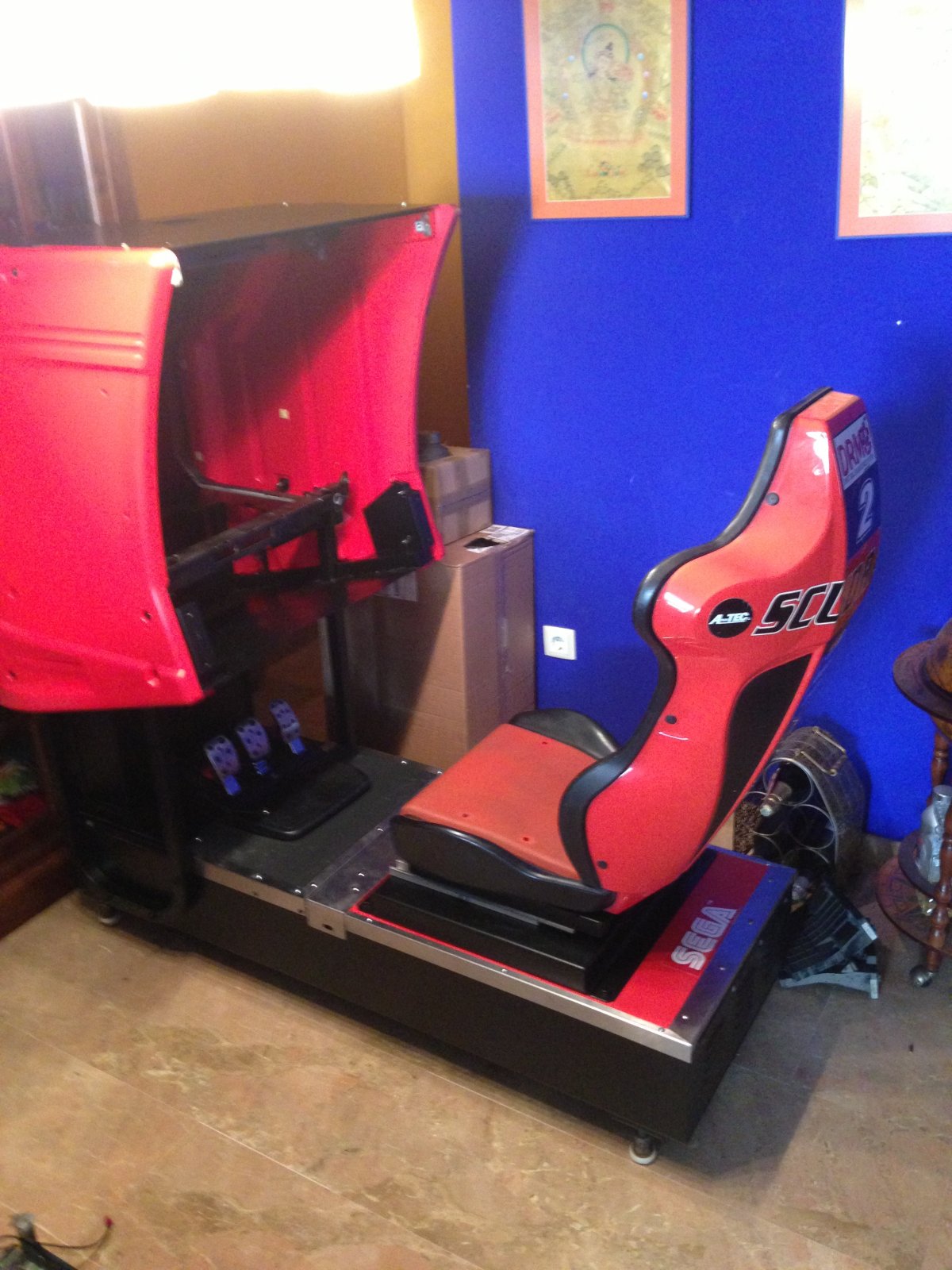

    Hi, I show my project to transform this old arcade cabinet 2dof driving in a simulator.
    The initial project was based on introducing a PS3 and G27.
    After a standing time, discovered the DIY simulators.now I'M decided to modify the concept of motion and give the seat.
    This is the current state

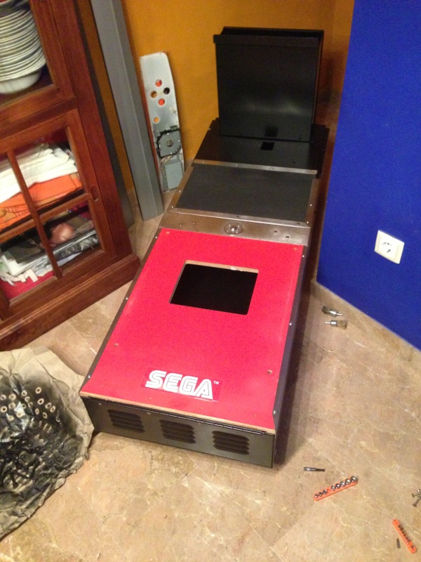

    This shows pictures of Mount
    The idea is to remove the red wooden base and put in the drawer (the drawer is steel) base movement.
    Leaving only the seat.
    The height of the drawer is 20ctm, plus 9 cmt to the chair, so that the structure should be between 28 and 30 ctm in total.
    Hope you like the concept and forgive my poor translation.

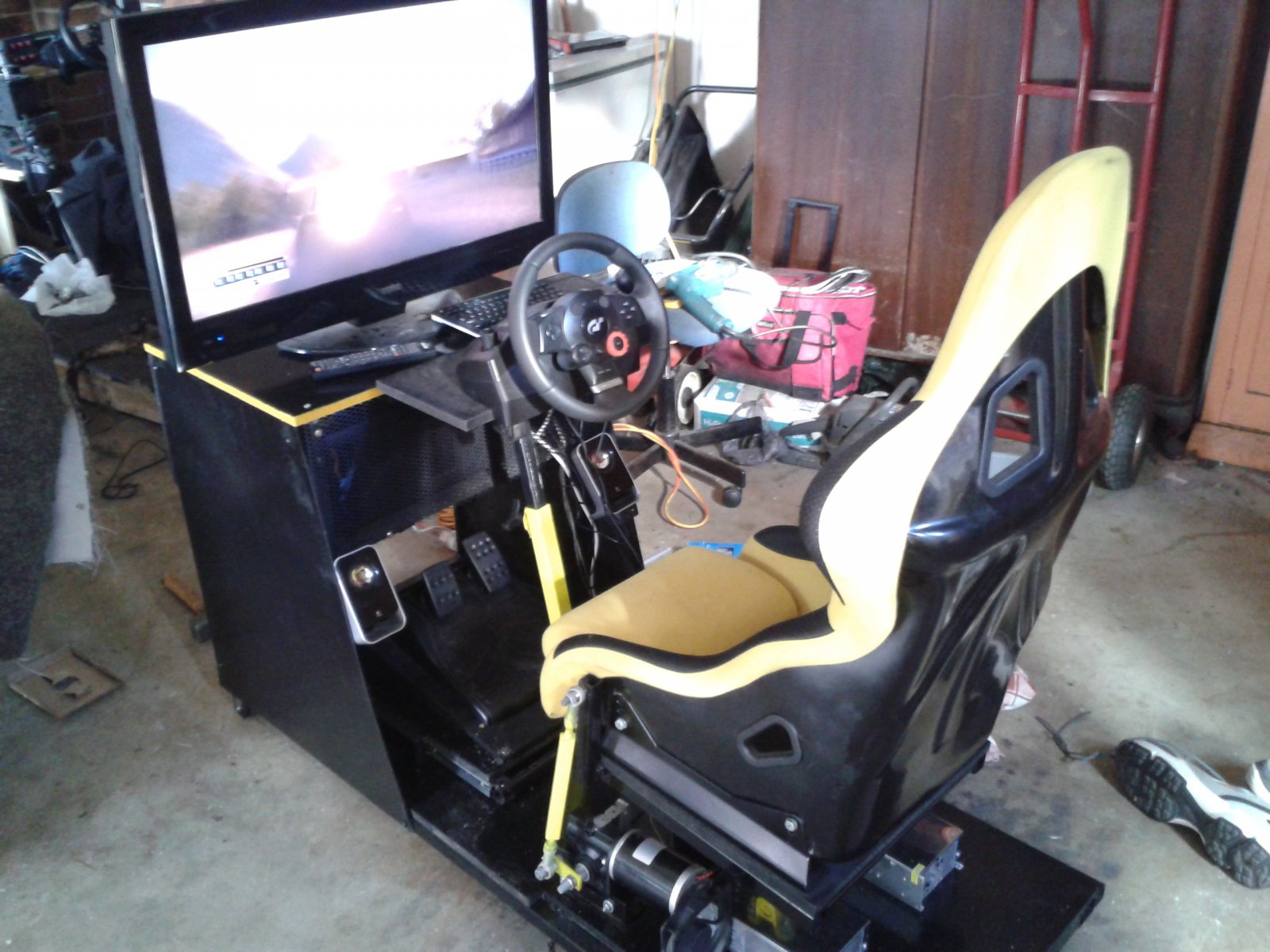

    Looks great man, real good idea, may I suggest something like this for a seat conversion, nice and compact
    http://www.xsimulator.net/community/threads/desk-racer-2dof.5326/
    and for reference, I converted this to an "arcade" machine as well
    And by the way, the photos do not open in the external link you provided when I click the photos.
    Sorry, there is a "download image" button...duh...
    Cheers, Dave.

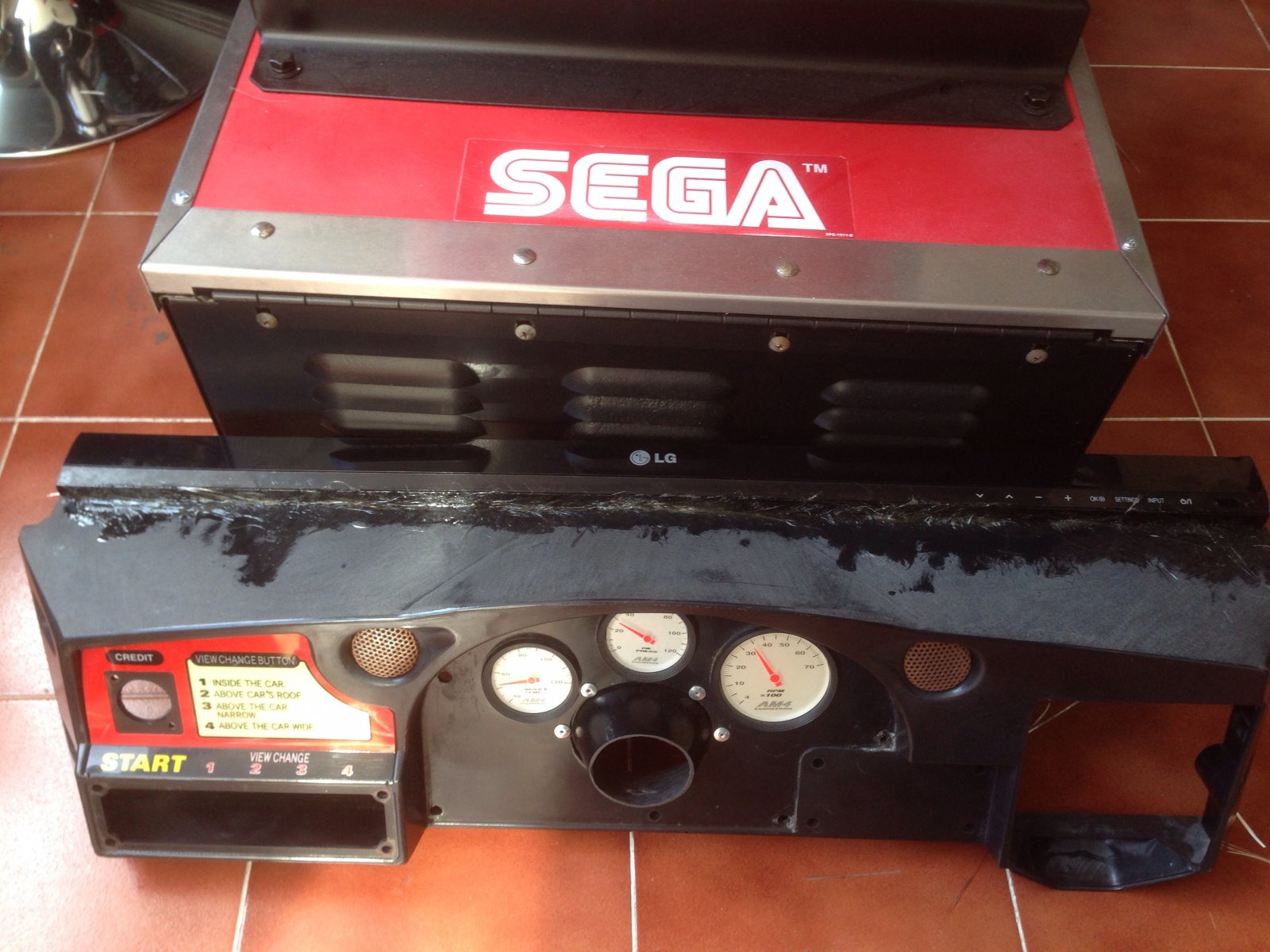

    Siantic Hello, I'm glad you like it and also have a similar project.
    For the screen I chose a lg32LM611S since it is easy to remove the outer shell and leave the inner frame, which gives the proportion.
    But it's not that easy, you have to do serious work of restructuring the bezel with fiberglass and resin.

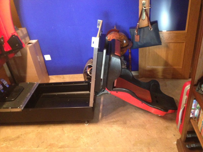

    The engines?'m Going to install two, with a simple 2DOF I think it serves me well.
    Surely if you study further you can include the third motor for a 3DOF, but on this machine, I think plenty of the third axis.
    I'm halfway through my development, I still build the structure for motors and gimbal, which introduce under the seat and hold her to the base with through bolts.

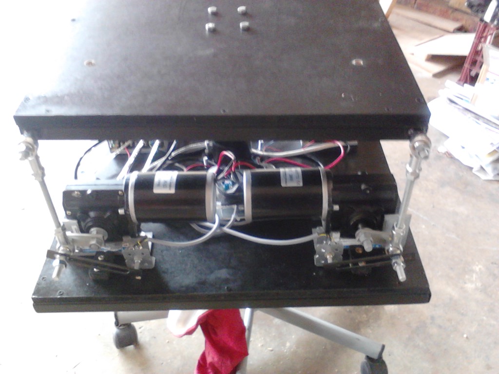

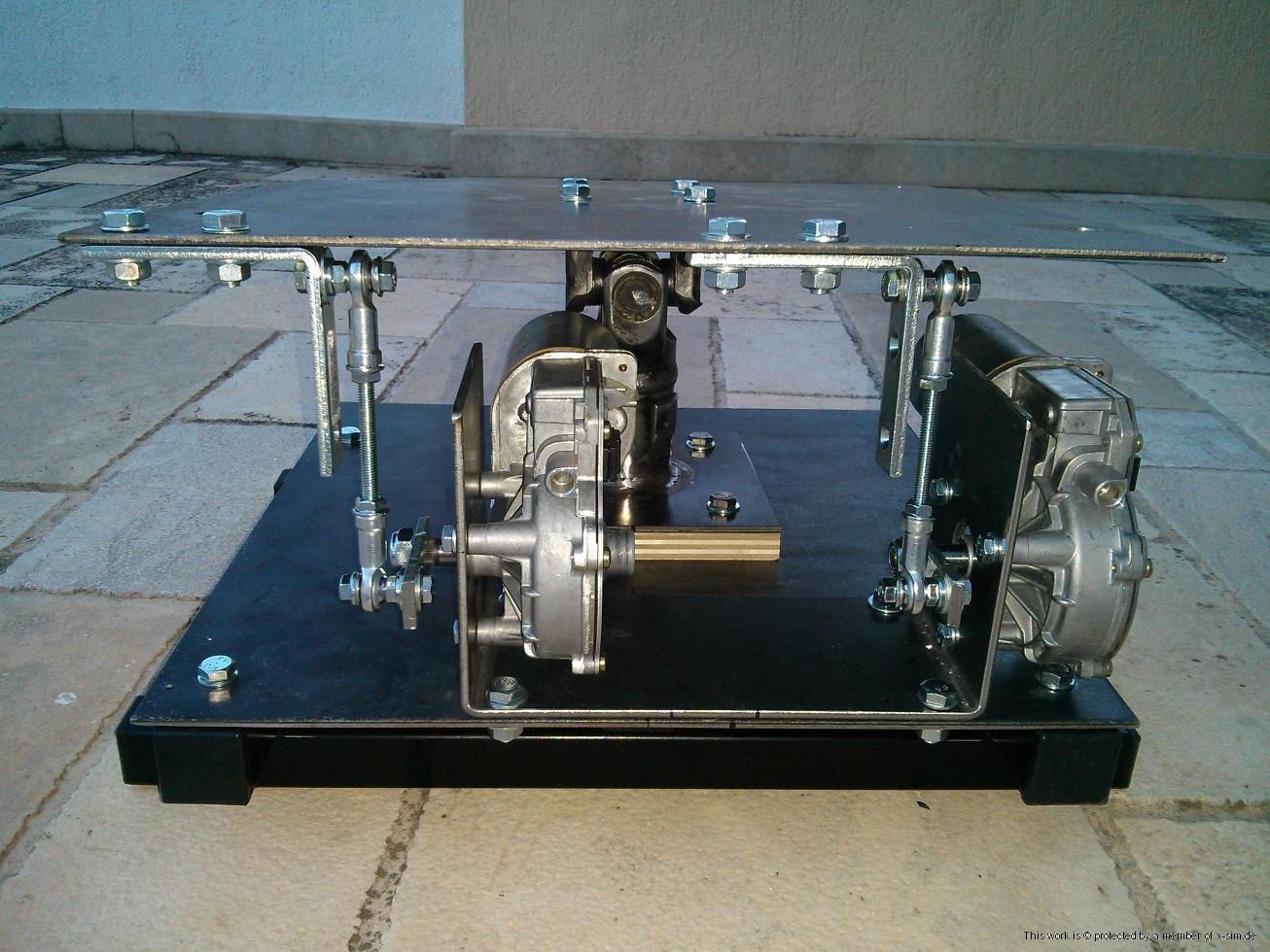

    I noticed on the idea of someone else also , is there another foro. problem by putting the image?, what you say and I delete .
    but the design belongs to someone else not me
  12. bsft
    nothing wrong with that posting another image, but try to mention whom it belongs to though
    that will work as well. something else I have already done in the past
    I found that desk racer motor mounts work better though as they are higher up to help overcome centre of gravity.
    Your choice what you would like to do
  13. Petar2
    Petar2 Member
    May 23, 2014
    59
    Valencia
    715Coins
    +42 / 0 / -0
    The owner of this structure is pipis2014,the is still in the process of building your simulator.still does not have video of his movement.
    Even i have to decide for the mount to make.so i don't limit myself to no suggestion,on the contrary,Thank you.I understand that this latter structure that i samples,works best with the center of gravity.If I am not mistaken, this is due to the push rods are placed in the corners of the platform.which helps the center of gravity work more easily.am I right?
    a greeting
  14. bsft
    sort of.
    Ive been through 11 designs, and found desk racer motor mounts the best for compact frame. Motors underneath tend to struggle a bit more with heavier person
