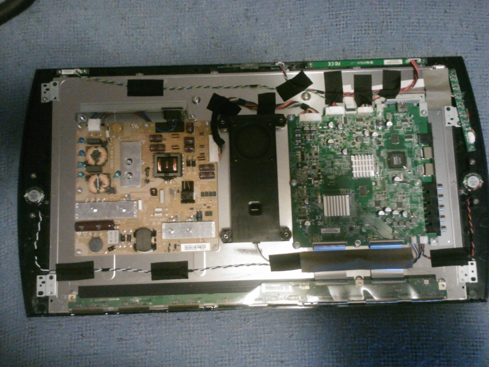

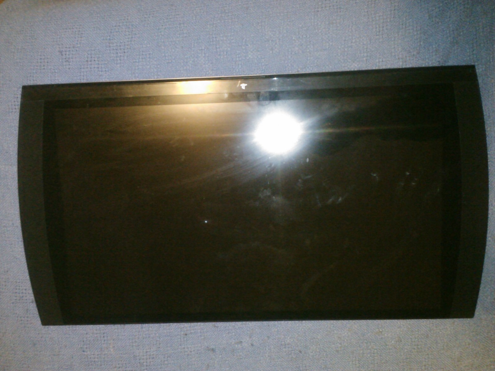

    Once I start my build, I will be using 3 of 4 24" 1080P HDMI Sony 3D TV's stripped from their cases, they have 2.1 sound which I'm not going to need as like most I'll use surround sound. I resurrected these from the red blinking light of death. The one thing I hate most about using anymore then one monitor is the thickness of the black "line" that you get when you put them together. I got about $200 Can tied up in these. And if that doesn't suit us, the projector route will be the next thing. As you can see from the pics how much black will be removed. IMG778.jpg IMG778.jpg IMG777.jpg IMG777.jpg
