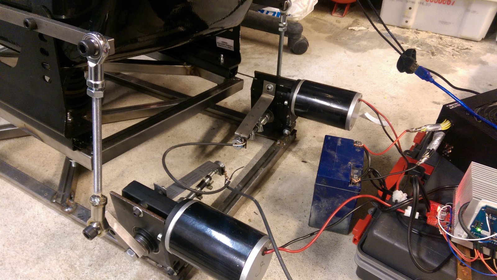

    Hi!

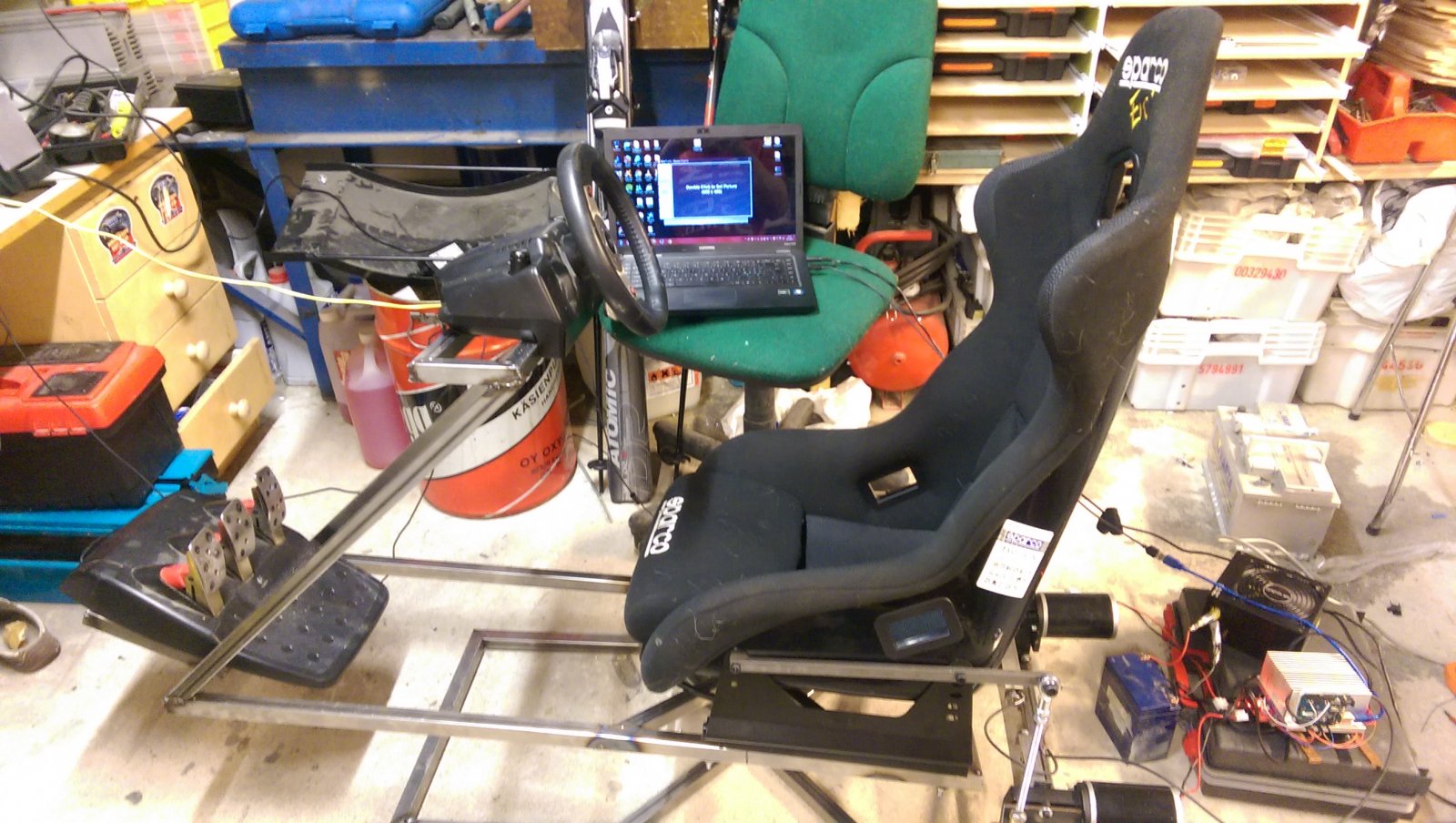

    Here is my way to 2dof...
    Arduino uno R3
    2x motomonster
    2x 1:50 180W wormgear
    Sparco evo II
    logitech G27
    @RacingMat preset
    @RacingMat Ultrasonic PWM
    http://www.xsimulator.net/community/marketplace/ultrasonic-pwm-with-arduino.102/
    Overallview of my messy carage.
    motors and connection rods (60mm arms)

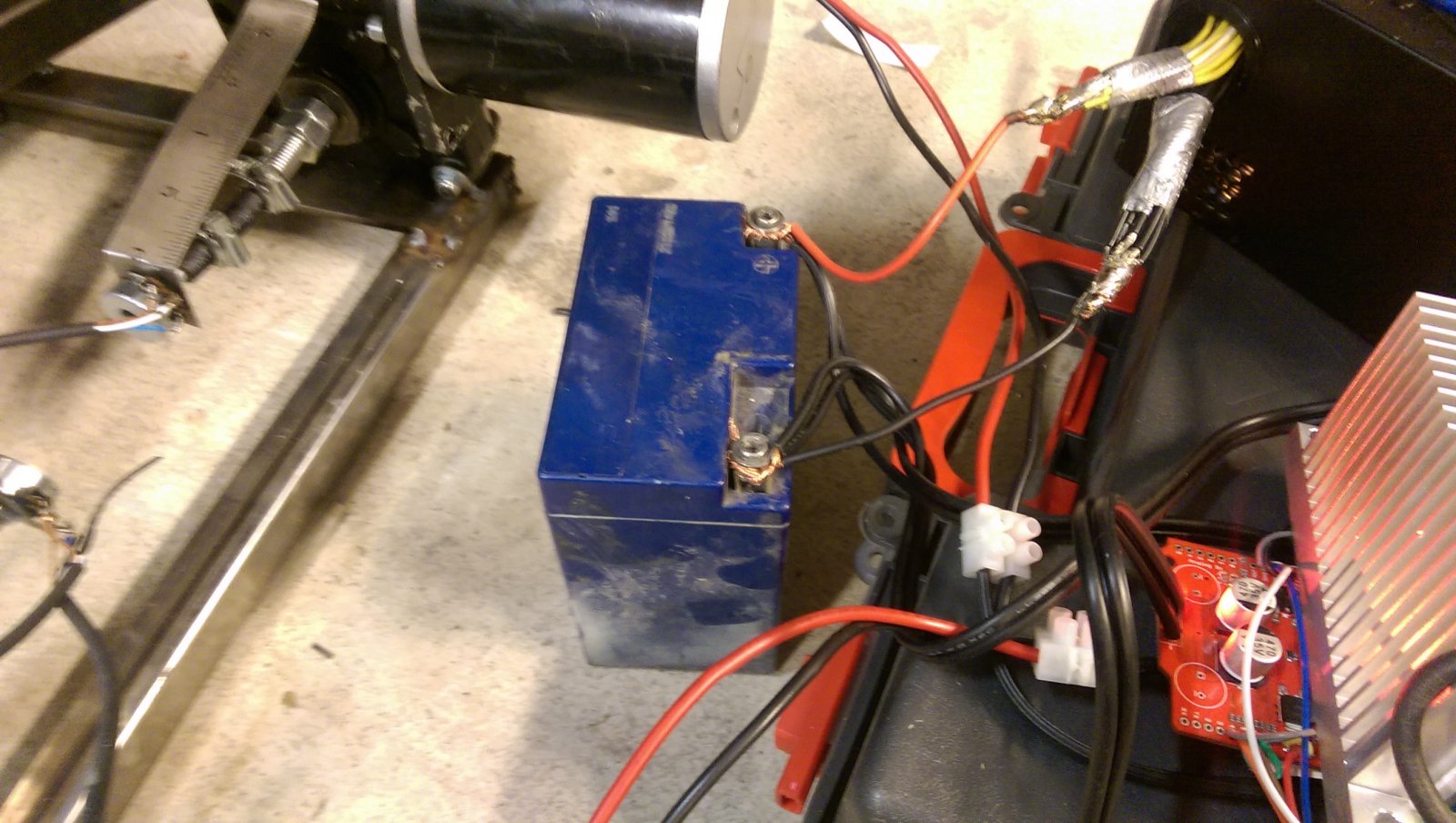

    old quad Battery to prevent my modified ATX power to shutdown

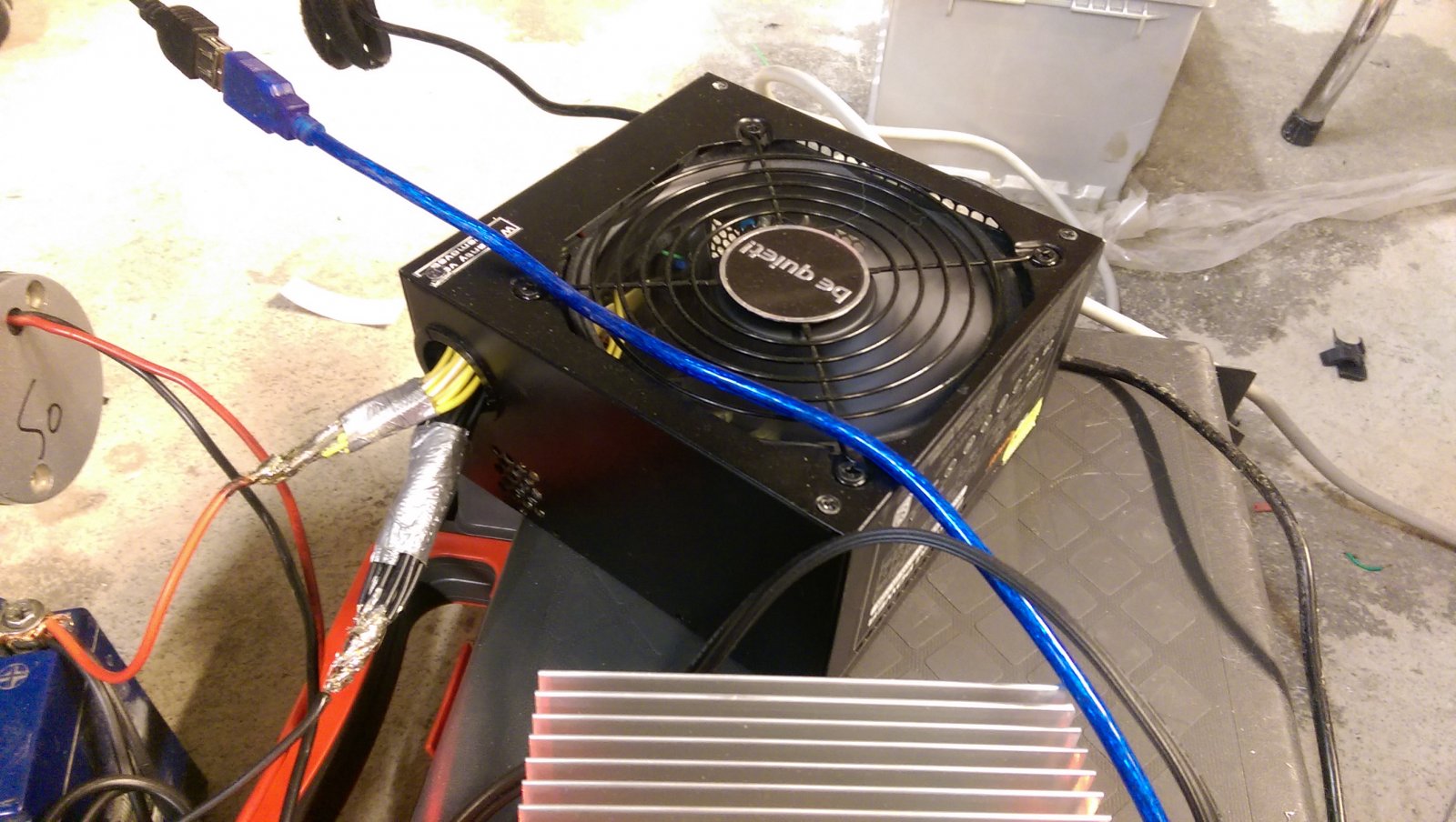

    modified atx power , gives +40Amp no sweat...

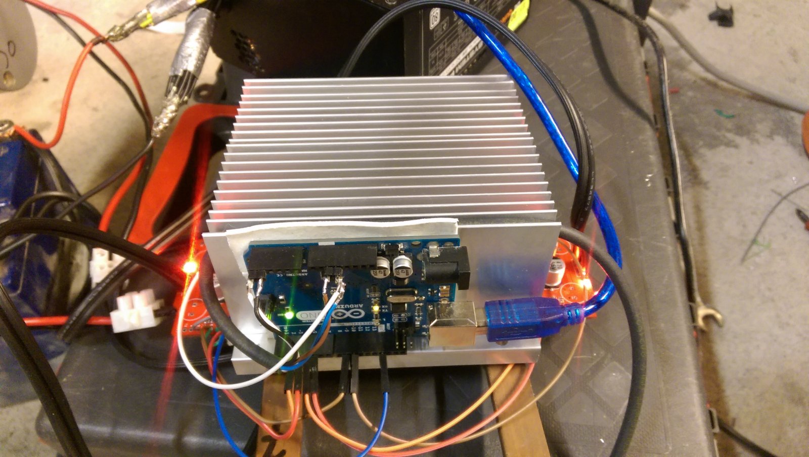

    Arduino uno and motomonsters under the overkill cooler...

    Nice job there @Piilukirves, thanks for sharing the details and photos of your motion simulator.
    If you get the chance members here would really appreciate a video of your motion simulator in action.
    No need to apologise, your English is just fine.

    you should switch to ultrasonic pwm arduino code.
    then the motors are very quiet.

  10. RacingMat
    2,237
    21,021Coins
    @Piilukirves : you're riding your simulator! congrats!!
    Well done
    @noorbeast : you're as fast as ultrasonic PWM!
    @Pit : I wrote this code to allow the Arduino to send 20kHz PWM (instead poor standard 490Hz PWM)
    hence the motors are really quieter (I made a comparison video in the post)

    Upgraded to ultrasonic, I like it :D a Lot.

    Could also be the way you have mounted the potentiometers, try not to have them too far out on the shaft. You would also need to reinforce the bracket that the potentiometers are mounted on.
    It looks like they could have a bit of flex. Maybe take a video of the potentiometers while you are playing and see if they have any unwanted movement.

    I see you have a PC power supply, with all the 12v lines joined together as well as the grounds. Are you using the pwr supply to charge the battery...and the battery to pwr everything else.

    Only meaning of the Battery is to keep ATX powersuply up and running , they tempto shutdown when current goes near to zero...
    4lines of atx is in series (not recommended)...
