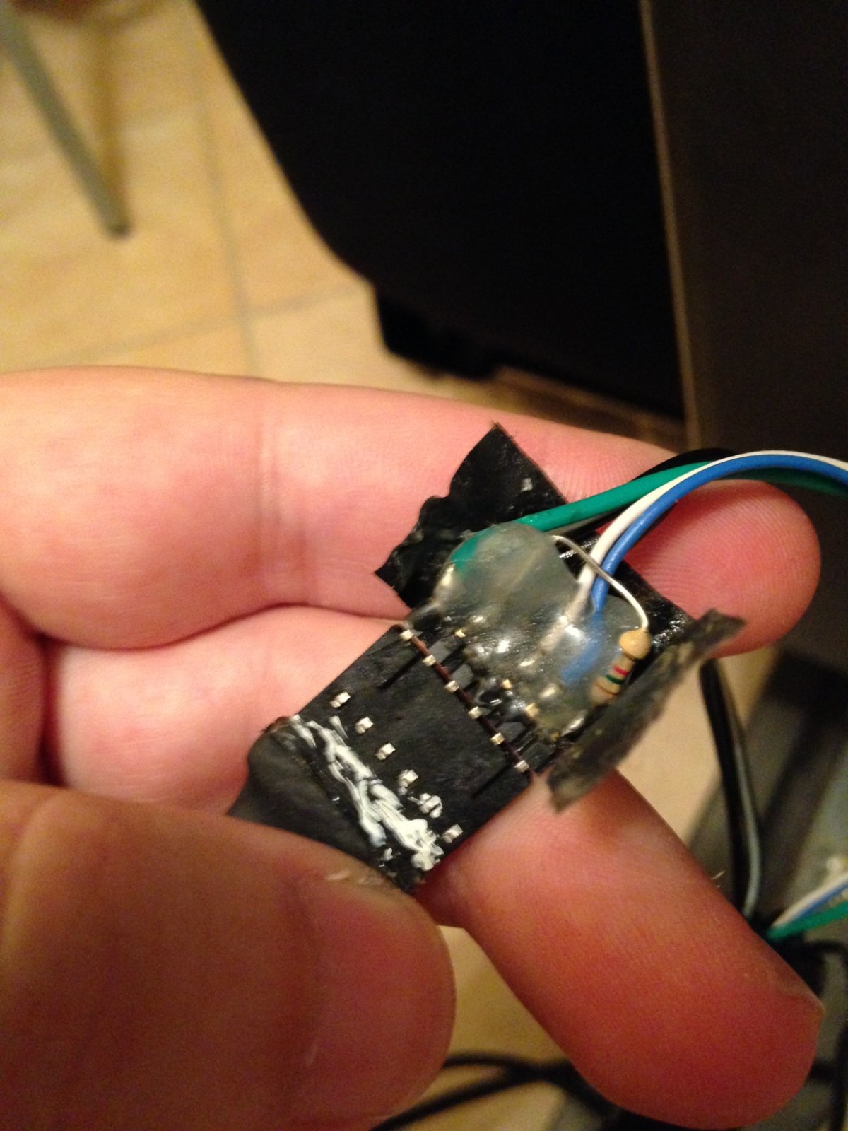

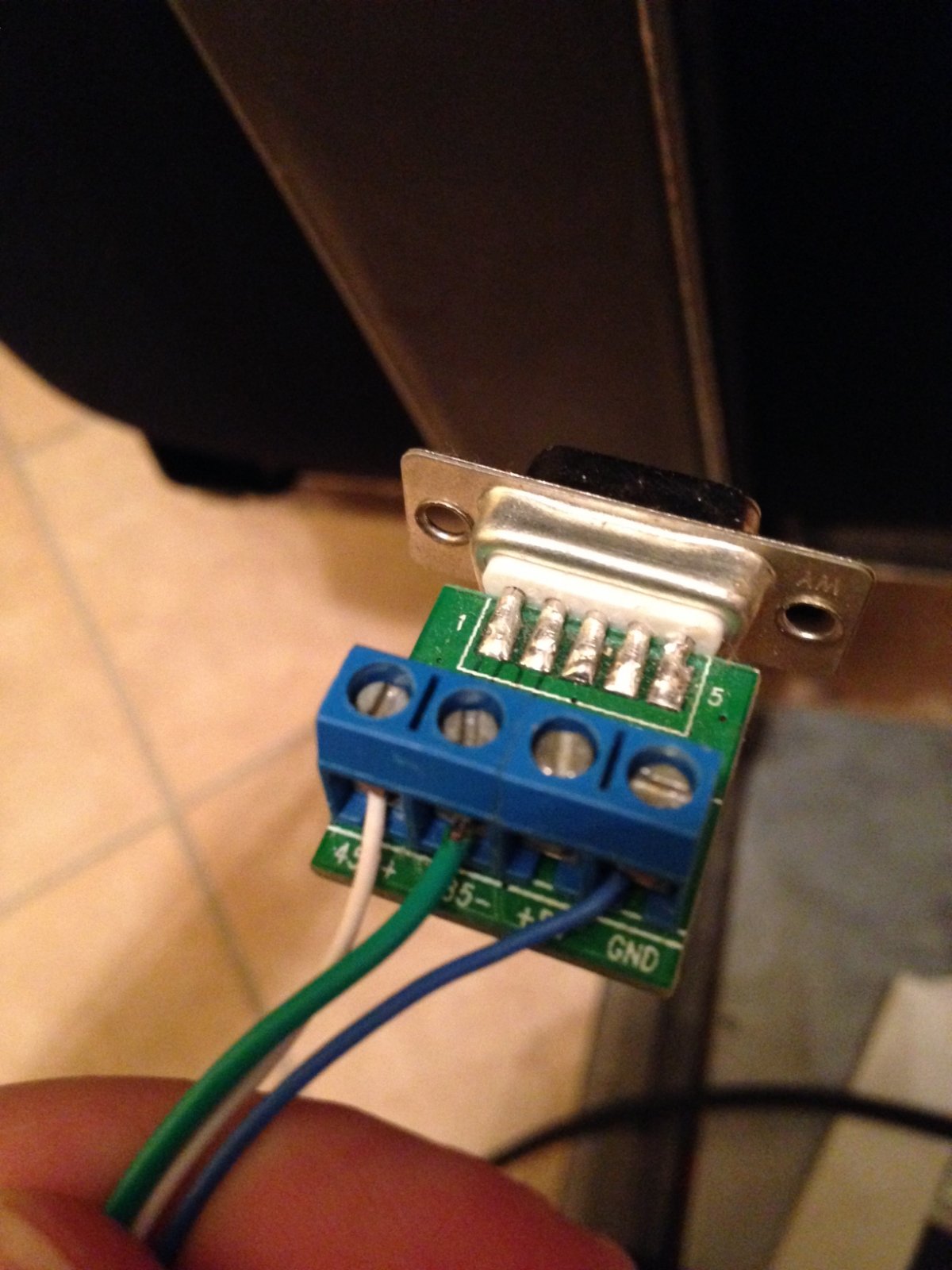

    Here you can see how I connected my SCN5. Sorry for the glue.
    Important: mind the side of the connector, you can see those "steps" that you should have too. Take reference for this side, because in the other side is upside down. I used a standard male pin connector, and I wired it from that.
    You can see the signal wire for the USB converter, White(+), Green(-) and Blue(GND) wire, on the first, the fourth and the fifth connector of that side. The other two in the middle are the power wire, please use a tester to be sure to not damage the actuator, and the sixth pin is for the resistance connection. Please, if you don't have the necessary knowledge in this field (I don't have it neither, lol), don't risk to ruin your hardware and ask the professionals to do this for you.

    As you can see I'm using the SCN5 from simxperience but not the simxperience control box. I'm using two USB RS485 converter. I hope this infos will be enough, 'cause I have no clue to make it work with the simxperience control box. Anyway, here: http://www.xsimulator.net/community/threads/scn5-wiring-tutorial.5566/ you can find the generic tutorial.

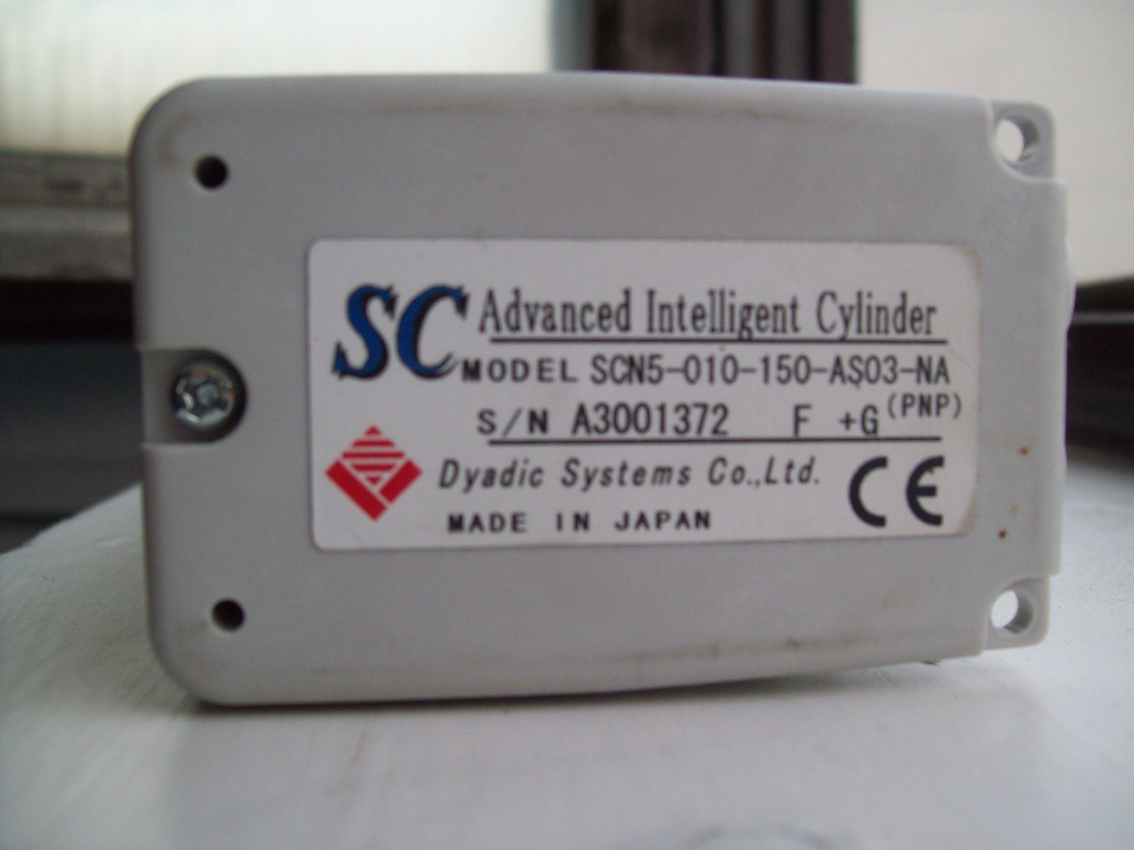

    If I remember well, Yobuddy asked me about which type they are, SCN5 or SCN6... I really confused about these, because they write onto the stick: Model SCN5-010-150-AS03-NA (PNP).
    Tried to connect them to the old, relaible wiring but they are not response.
    Is the Simtools operate SCN6 already? Perhaps these scn's are from the 6th series?

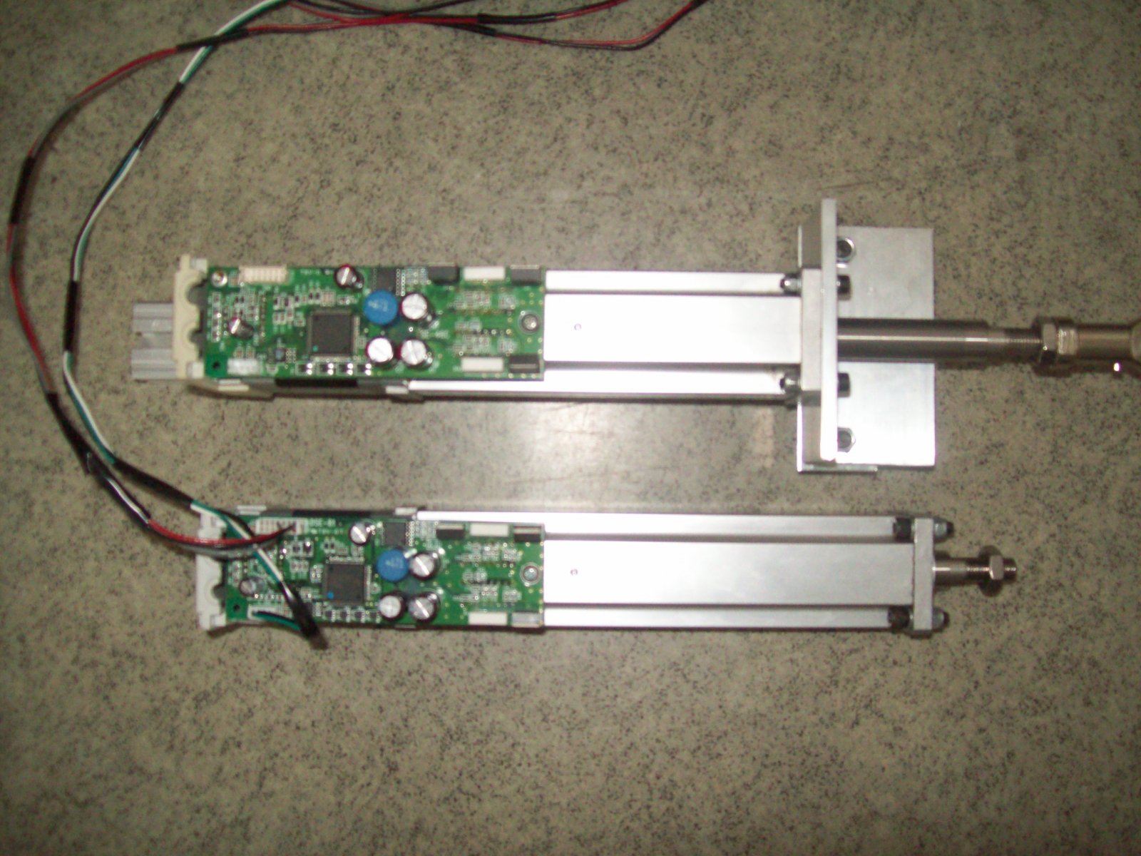

    Here are the old frex 100mm (upper one) and the new 150mm simexperience' SCN
    and here is a picture of new one's stick:
    What could I do more to operate the new SCN's if they are the 6th series? I've never tried simexperience actuators before. I'd like to operate them with my rs485 and powersupply.
    Anyone can help me to find out, what's wrong?
