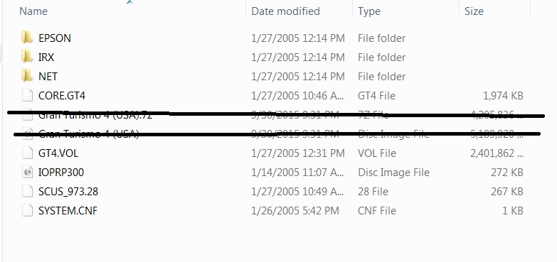

    Ok. Im stuck. I downloaded the Gran Turismo game and emulator and I dont know further what to do. Does anyony have simple instructions on setting up? It asks for a ROM. But how do I do that?

    Download all 3 Bios:
    BIOS
    EUR v2.0
    USA v1.6
    JAP v1.0
    Decompress and copy all 3 "scph*****.bin" files into your "PCSX2/bios" folder located in your "Documents" folder.
    PLUGIN
    USBqemu wheel mod - Version:1-6-2014
    http://pcsx2.net/download/finish/9-plugins/122-usbqemu-wheel-mod.html
    Decompress and copy inside "PCSX2 1.2.1/plugin" folder wherever you installed.
    Then run PCSX2 and choose USA bios.
    Configure your keys, graphics, plugins, etc and load the game (ISO).

    @bsft you should go to plugin/bios selection and under USB you choose the Qemu USB Driver
    now go to USB and select plugin settings
    set the emulated wheel to whatever wheel you wish it to pretend to be
    make Device Port 1 to Wheel (DX input) click configure
    now set up all the controls etc so click under Steer Left click Reassign and now move your wheel left, throttle press down on pedal etc etc
    HAT UP etc is the D PAD
    once done you can click ok and when you load GT4 it will start spinning your wheel etc as it detects it and you will get all the FFB effects ingame now

    btw you don't unzip the iso file....leave it as an iso and just launch it that way
