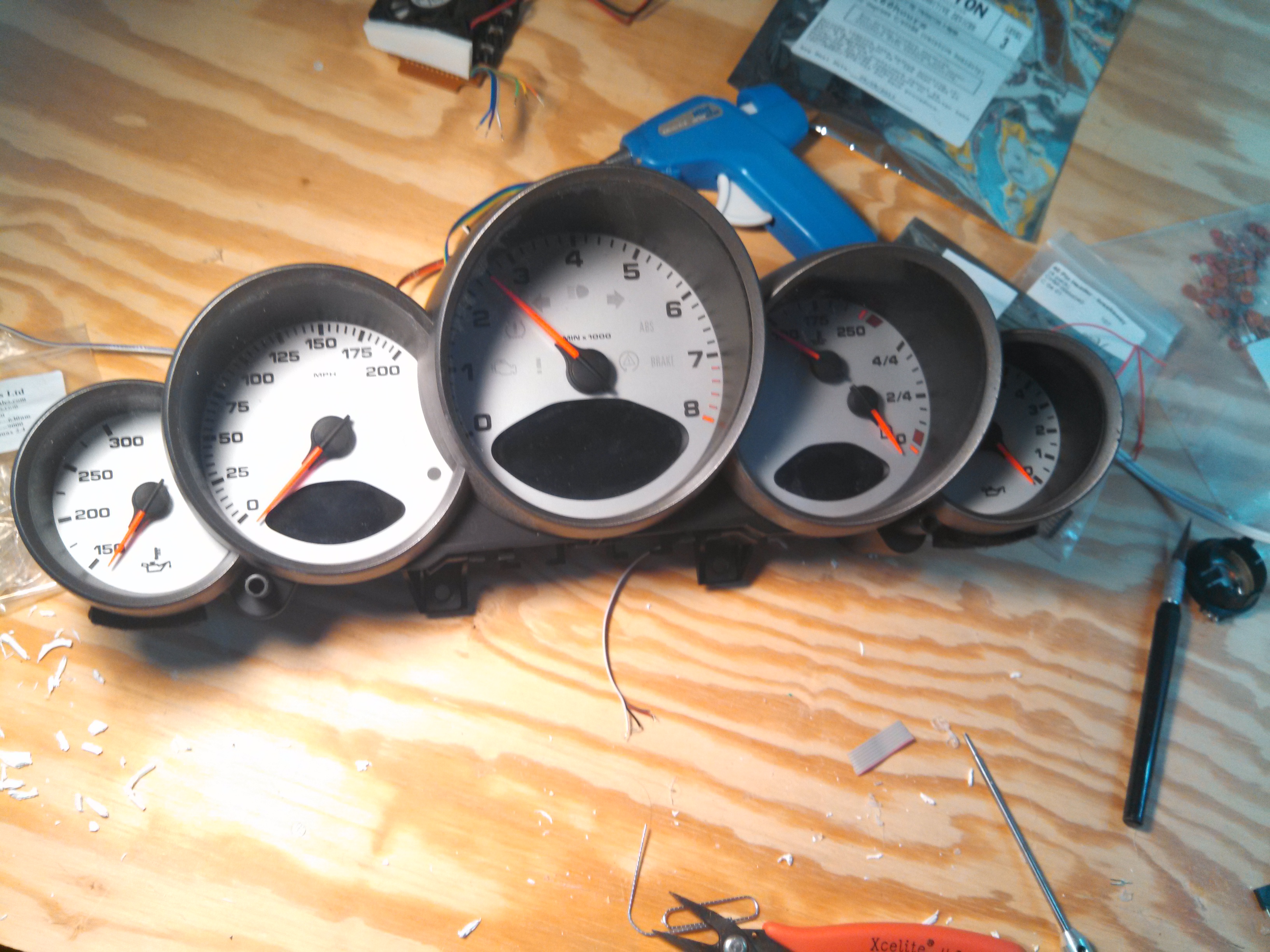

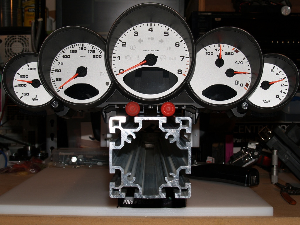

    So I have this cluster I bought on ebay.
    and a friend of mine has yanked it all apart and made it controllable with an Arduino board and he can send commands manually via a serial monitor to make everything move and light up.. BUT..

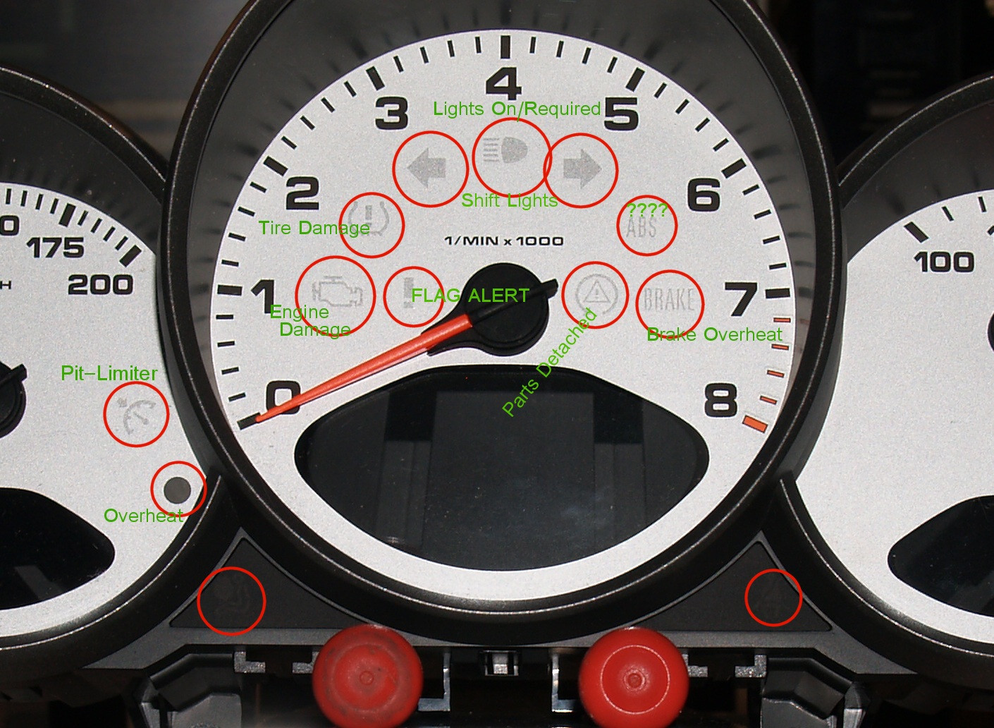

    EDIT.. Here is the photo I sent to ITman when we were brainstorming what data to use for the lights.
    I know some aren't do-able but most are. The actual needles would use their actual values (Speed, RPM, Water Temp, Oil Temp, Fuel) The only analog gauge that is up in the air is oil pressure which isn't in rFactor so that may change up to a gear indicator 1-5.

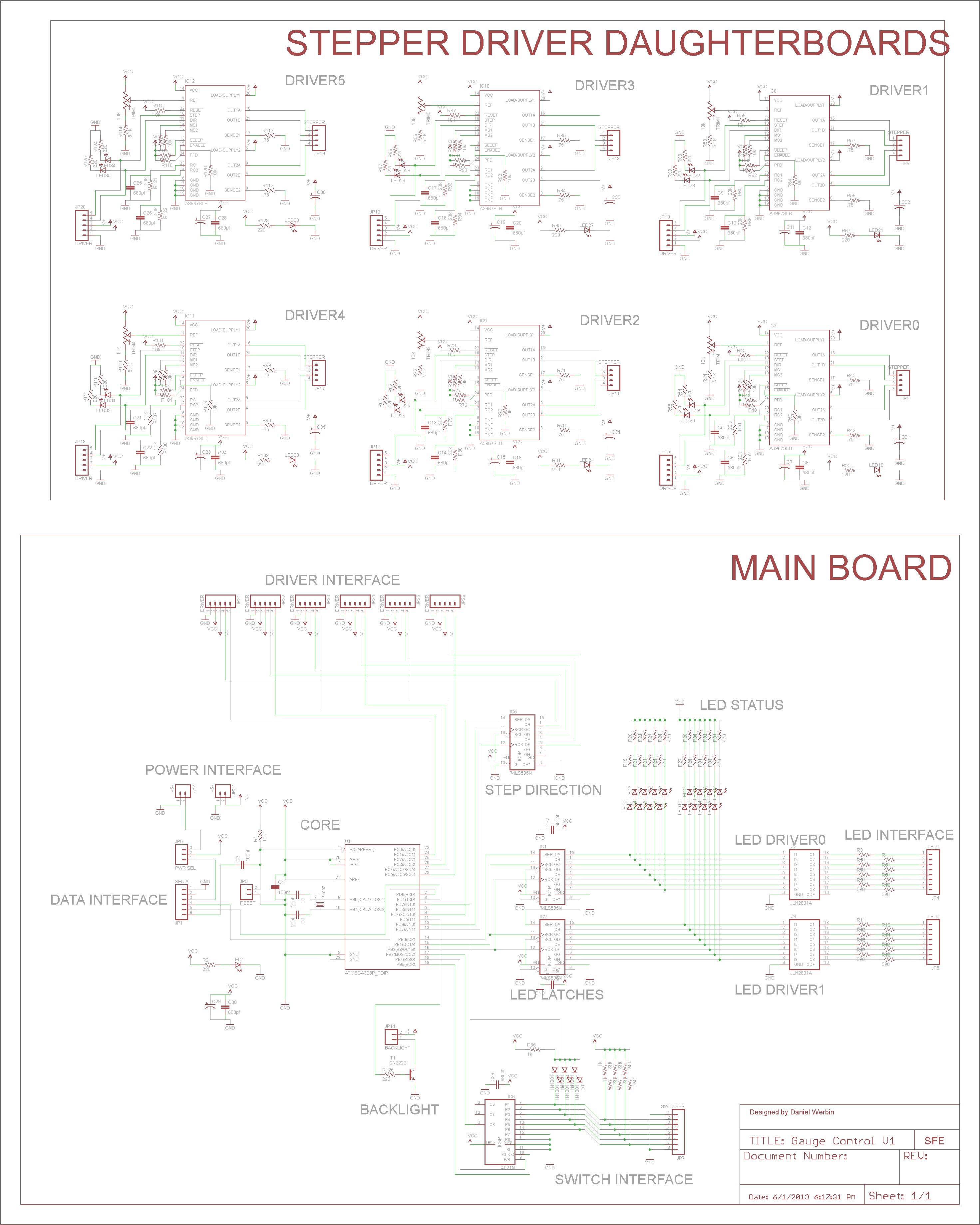

    If anyone is curious, here is the schematic of the circuit to control the gauges.

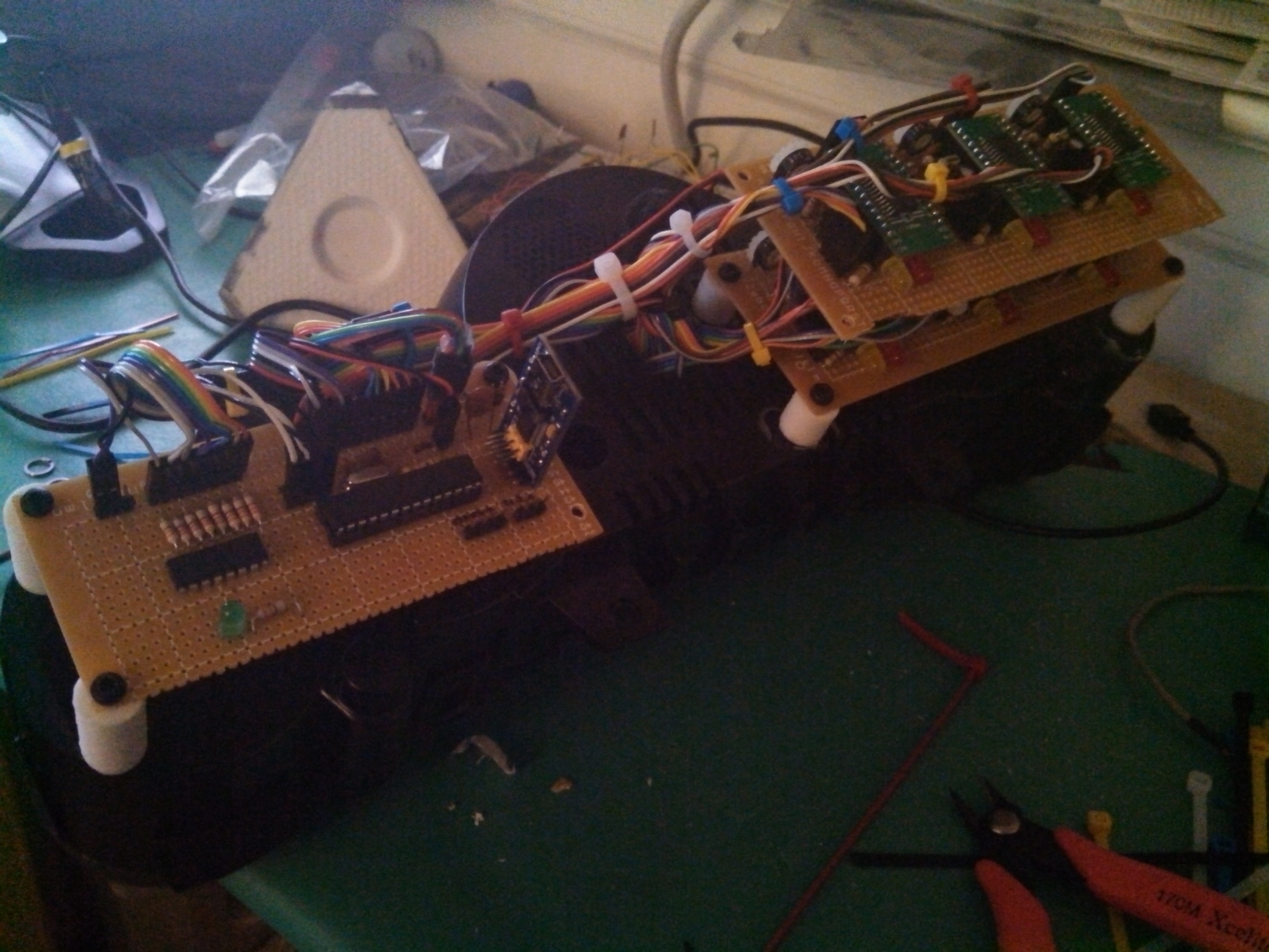

    Figure people would like to see progress.

    amazing work!!! Did you construct the whole curcuit by your own?:)

    They are amazing thanks for letting me be involved. Hope the app works well at the show.
    Again an amazing achievement.
