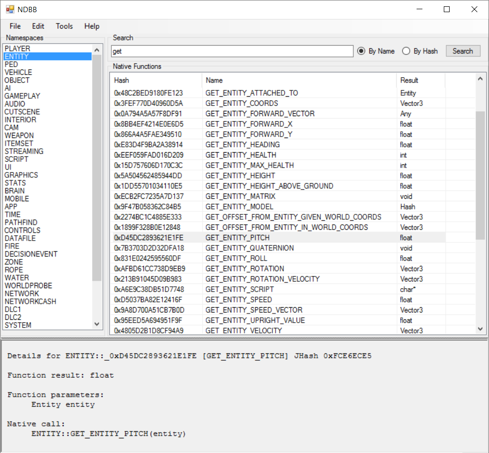

    I'm really struggling trying to make a plugin. I have all the information I need (I think) however I have no idea how to do it since I can't code :(
    I might be totally wrong with this anyways but maybe you guys can say if it can be done or not i'm sure it can someway as Force Dynamics have it working @value1 @yobuddy @prilad
    There is a mod you can add to GTA5 called ScriptHook5.NET so that you can pretty much modify anything and call up data that you need. Here is the post over at http://gtaforums.com/topic/789907-vrel-community-script-hook-v-net

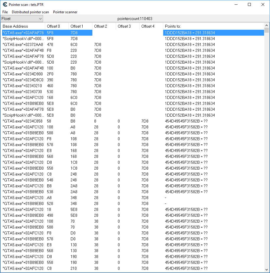

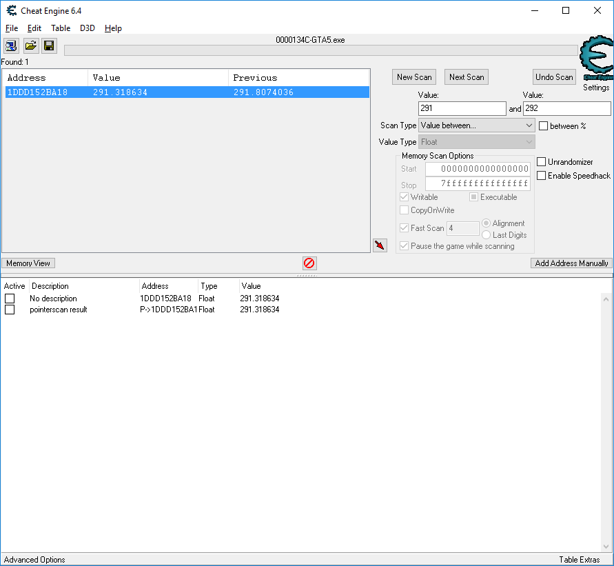

    OK I'm getting somewhere now I have the hook for the Heading
    I know there is 1000000's of results but I know the location as my computer crashed just before I got to save the address :(
    I have no idea what to do with it yet but its progress :p
    edit: I have restarted game 3 times and its the correct address also it only changes when you ghet in a car which is a bonus I suppose :)

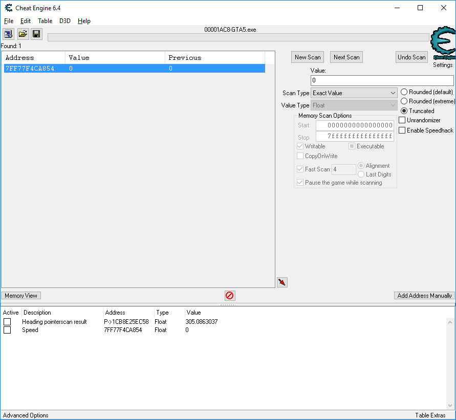

    Okay I now have SPEED location no pointers its a static address :p
    This is a slow and hard learning process :)

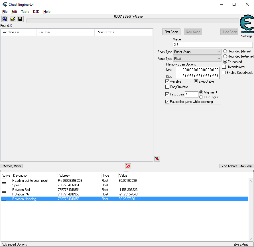

    I have got a mod for showing coords and stuff and changed it to get all the rotation values and vectors and also velocities. Problem is none of the velocity values are any good they go negative and positive with in the 360 degree heading. The rotation values I cannot find the base memory addresses I can find the value in CheatEngine but the value changes to something completely different before I can find the correct address.

    To convert the speed values from world coordinate system into local coordinate system, you must find the transformation matrix, a 3×3 matrix.
    To find stable values for rotation, you must find the pointers to the rotation memory location. There are a few examples in the forum for other simulations.

    There is an entity matrix which should supply the correct values, I will have to write a little C# script and try and display them, i think i'm kinda getting my head around this.
    I have found all sorts of values apart from forces and the rotation angles which unfortunately are what I need.

    Typically pitch, roll and yaw are calculated from the unit vectors like
    Code:
    Pitch_MemHook = Atan2(Vector.Fy, Vector.Uy)
    Roll_MemHook = Asin(Vector.Ry)
    Yaw_MemHook = -Atan2(Vector.Rx, Vector.Rz)
    Depending on the coordinate/transformation matrix, the math varies.
    Surge, sway and heave are transformed from world to local coordinates like
    Code:
    Surge_MemHook = -(ax * Vector.Fx + ay * Vector.Fy + az * Vector.Fz)
    Sway_MemHook = -(ax * Vector.Rx + ay * Vector.Ry + az * Vector.Rz)
    Heave_MemHook = ax * Vector.Ux + ay * Vector.Uy + az * Vector.Uz
    Find stable pointers for speed/accelerations and to the transformation matrix and I can help you further (if I find the time ;) )
