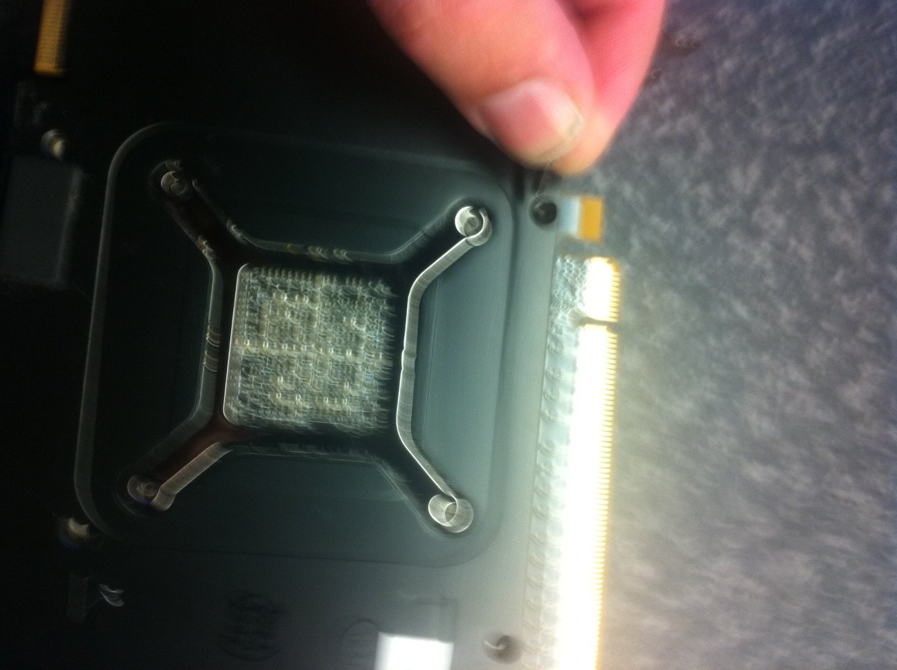

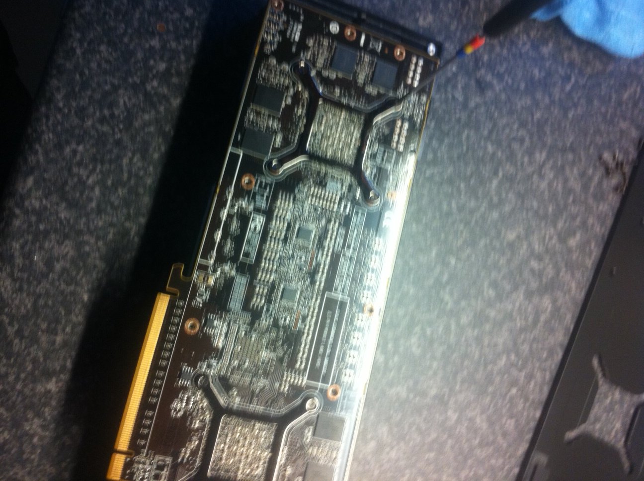

    1. take screws off back cover
    2. now the cover is off take the main chip spring bracket off.
    3. i undo in opposites to equal it out so it don't go ping n chuck your screws away, you can leave the screws in it then.

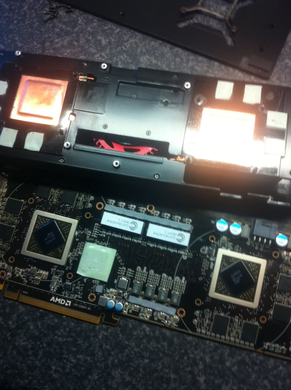

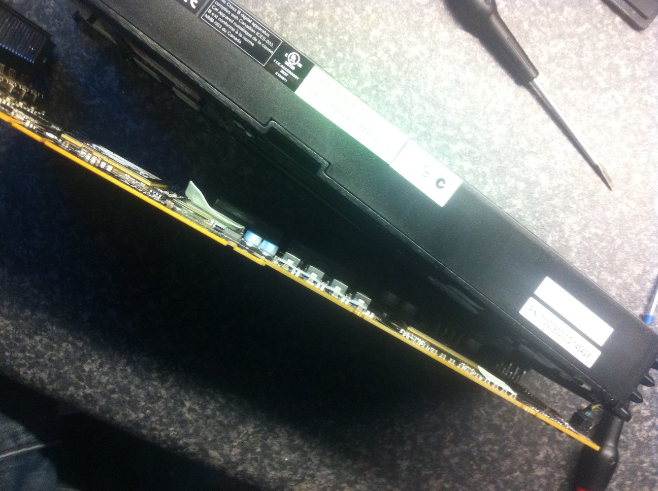

    3. once the spring clamps are off you can prize it open, it will be stuck quite tight as there lots of sticky heat pads.

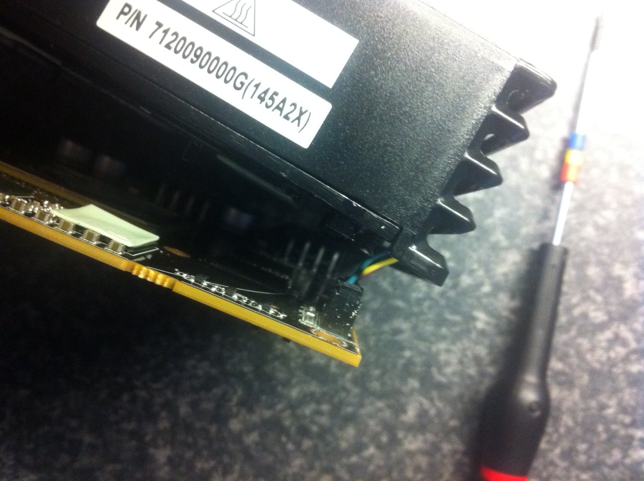

    4.dont forget to look for fan or other connectors then just unplug it to complete the seperation of the card.

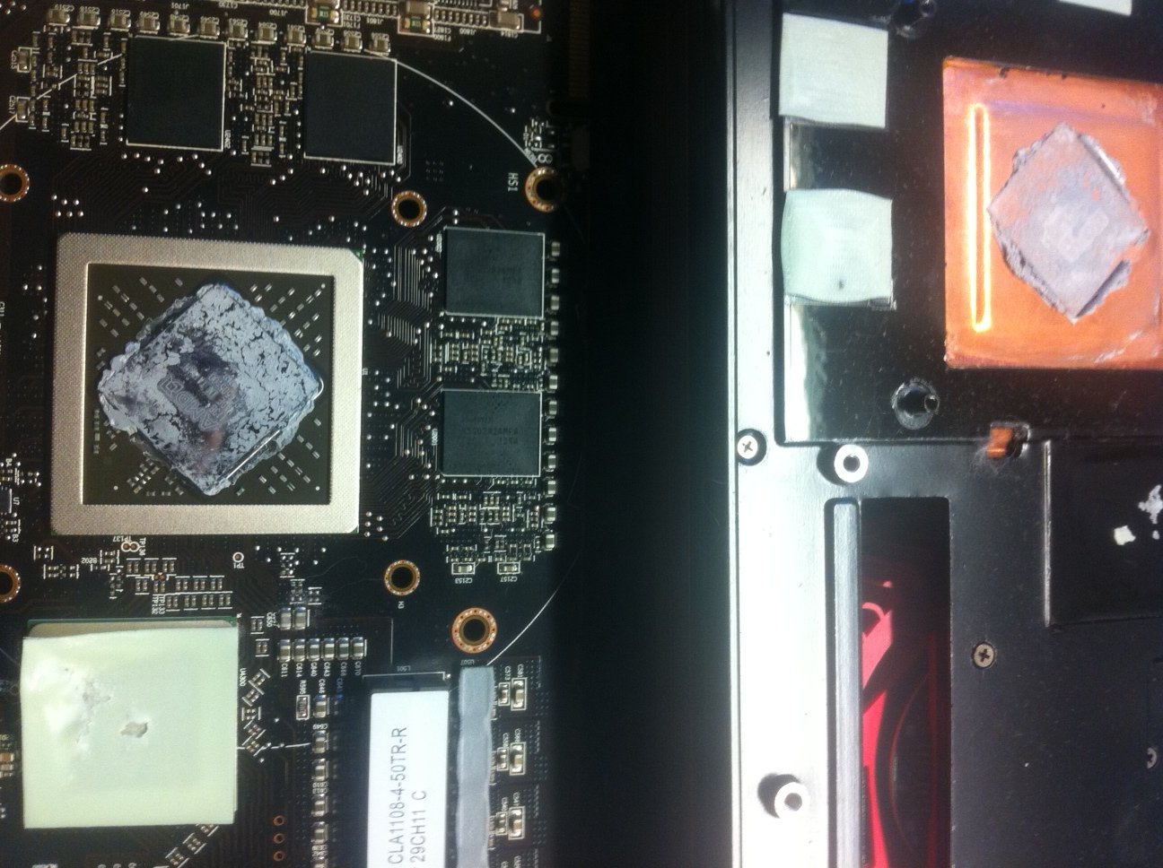

    5. now the card is seperated you can see the paste is completely dry and crusty so can not be doing its job correct cooling you chips.

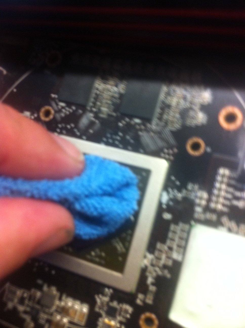

    5. clean them with alchol or something thats gets it off, i used brake cleaner on a rag straight off and evaporates away.
    6. make sure it spot less clean and shiney on both parts the chip and the heat sink. photo (11).JPG

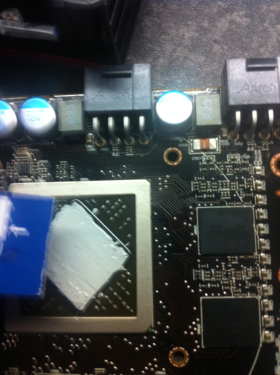

    7. now put some NEW paste on it and ( any paste cpu paste will do but best to use a artic silver or alike ) ive just used what i had which is cpu paste just for now to use it up then next time will get the artic silver or something better.
    8. make sure you spread it evenly as best you can credit card better but i used cardboard ! lol photo (12).JPG

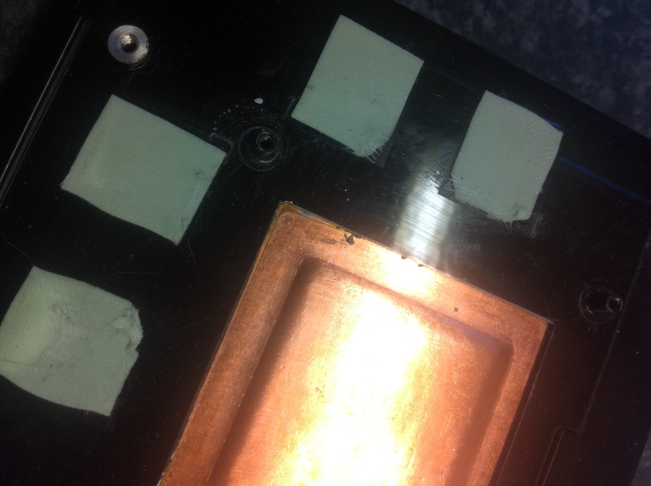

    9. now before you put back together check the extra heat pads are ok and in line and all there, also dont forget the fan or other things you unplugged.

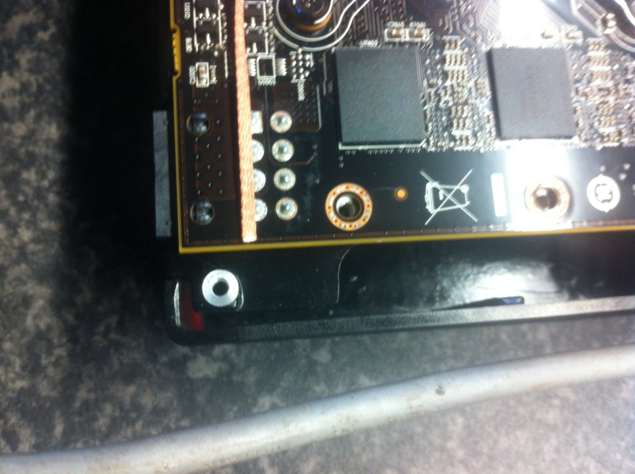

    10.now we can put back together but be careful and try not to slide it more drop in right place then put spring clamps back on with the same opp screws doing it up but little turns at a time so it even the pressure on the chip and clamp.

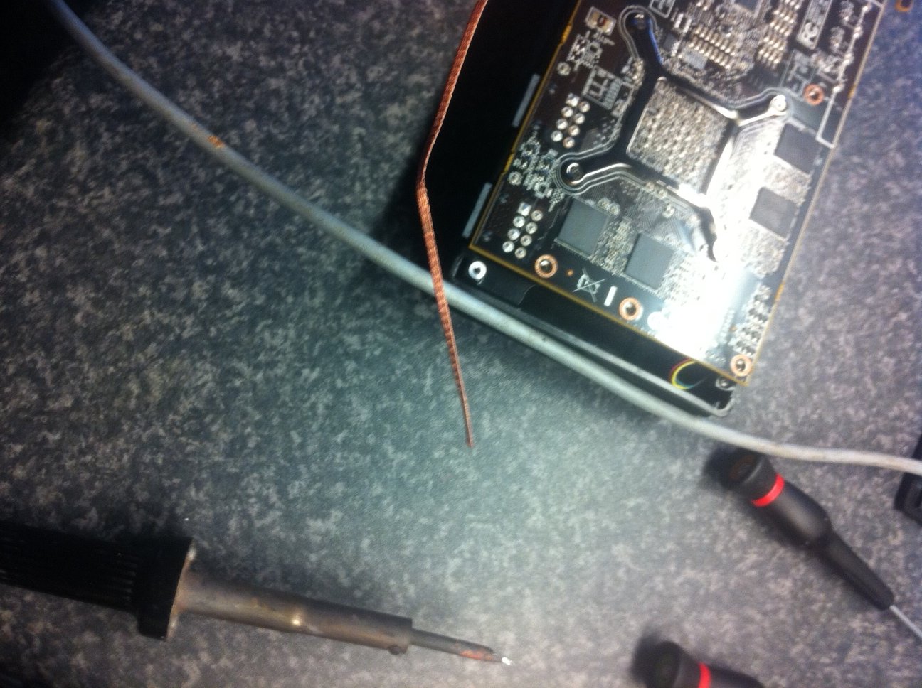

    11. now its built back you can re solder any iffy joints, (mainly by the power sockets you will be looking) i have got some suss dry joints coming so im just gunna top them up with solder this time.
    12. use solder braid if you want to clean them up first and take all old solder off and put new on, mine are not gone yet so will be just topping them up as i know im doing it again in about 3 mths time with better paste. photo (15).JPG
