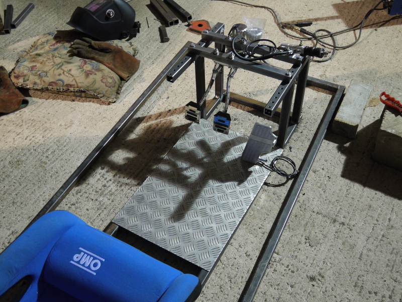

    A little work on the steering wheel mount, very sturdy, no flex even if I sit on it! Hopefully the gearing/lever length of the motors can be tweaked to make it all move.
  13. bsft
    nice, however, are all these adaptability mods going to add much more weight?
  14. bug2k14
    bug2k14 New Member
    Aug 17, 2014
    12
    West Midlands, UK
    937Coins
    +20 / 0 / -0
    It probably adds a little weight, but not too much more than it would need to be rigid. I didn't want to have any flex in the steering or pedal mounts. I haven't weighed it all yet, but it's not as heavy as it looks.
    I don't know how much the motors I have will cope with, I'll find out when it's all connected up and look at what alternatives there are if it doesn't work. I may need your advice on what I need to make it all move :)

    Not much of an update, got the throttle pedal mounted along with a few adjustment holes, plus a couple of bracing bars across the back to attach the motor mounts to.

    Not had much time recently to get much done, but started to make a little more progress! I must be in the running for longest build thread with not much progress.
    Anyway, finally mounted the motors, steering wheel and attached the levers.
    It's not as heavy as it looks, but I think I'll need at least the 50:1 or 60:1 gearboxes rather that the 25:1 that the motors came with.
    It will be nice to try and get it actually moving this year!

  20. eaorobbie
    20,463Coins
    +1,686 / 23 / -2
    Looking good mate.
    Yes 50:1 min to move that with any hope of accuracy, pivot seems too far back, and not enough angle on the connecting rods will not help either, but very nice progress.
