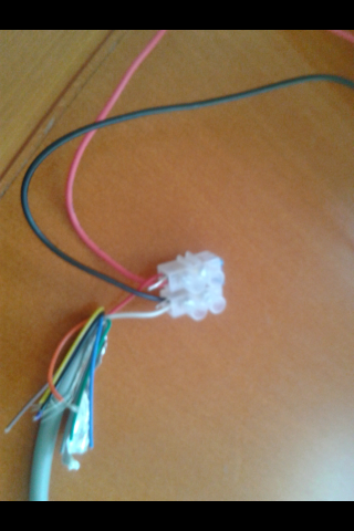

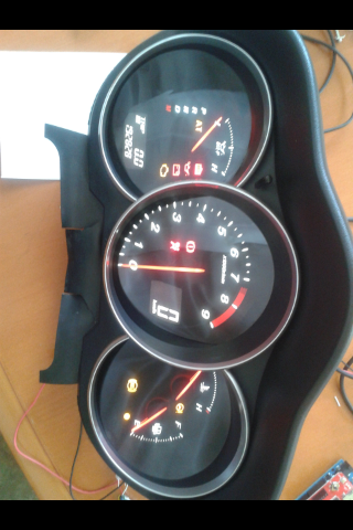

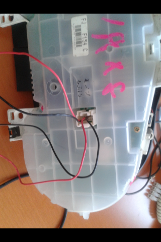

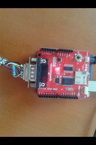

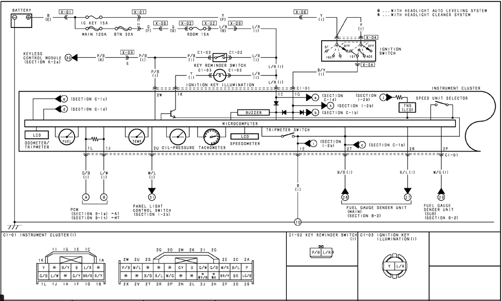

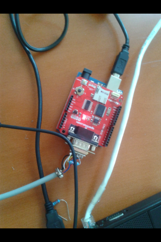

  13. LOOLOO132
    LOOLOO132 New Member
    Feb 21, 2013
    0Coins
    hi All:
    I am unable to get my gauges clusters running. PLease can anyone advise me y?
    This is what I have done so far.
    1. Gotten RX8 guages cluster and canShield and Arduino
    2. hook the guages up to 12v see earlier diagarm(Pin 1G + , Pin 1E GND)
    3. hook up the canbus pin (CANH 1L , CANL 1J)
    4. At both end add 120ohm.
    5.below is my code
    Code:
    #include <CAN.h>
    #include <SoftwareSerial.h>
    #include <SPI.h>
    #define BUS_SPEED 1000
    //global variable used to determine whether loop should
    //be in Tx or Rx mode.
    int state;
    int RPM;
    int mphspeed;
    int kmhspeed;
    void setup() {
      Serial.begin(9600);
      // initialize CAN bus class
      // this class initializes SPI communications with MCP2515
      CAN.begin();
      CAN.baudConfig(BUS_SPEED);
      RPM=5500;
      mphspeed=100;
      //Wait 10 seconds so that I can still upload even
      //if the previous iteration spams the serial port
      delay(1000);
     #if  defined(__AVR_ATmega168__) || defined(__AVR_ATmega328P__)
      state = 0;
     #else
     state = 1;
      CAN.setMaskOrFilter(MASK_0,   0b11111111, 0b11100000, 0b00000000, 0b00000000);
      CAN.setMaskOrFilter(FILTER_0, 0b11111111, 0b11100000, 0b00000000, 0b00000000); //DISALLOW ext packets.
      CAN.setMaskOrFilter(FILTER_1, 0b10111111, 0b11100000, 0b00000000, 0b00000000);
      CAN.setMaskOrFilter(MASK_1,   0b00000000, 0b00000000, 0b00001111, 0b11111111);
      CAN.setMaskOrFilter(FILTER_2, 0b00000000, 0b00001000, 0b00001101, 0b11111111);
      CAN.setMaskOrFilter(FILTER_3, 0b00000000, 0b00001000, 0b00001101, 0b11111111);
      CAN.setMaskOrFilter(FILTER_4, 0b00000000, 0b00001000, 0b00001111, 0b11111111);
     CAN.setMaskOrFilter(FILTER_5, 0b00000000, 0b00001000, 0b00001101, 0b11111111);
      #endif
      CAN.setMode(NORMAL);  // set to NORMAL for standard com
    byte inc = 0;
    void printBuf(byte rx_status, byte length, uint32_t frame_id, byte filter, byte buffer, byte *frame_data, byte ext) {
          Serial.print([Rx] Status:);
          Serial.print(rx_status,HEX);
          Serial.print( Len:);
          Serial.print(length,HEX);
          Serial.print( Frame:);
          Serial.print(frame_id,HEX);
          Serial.print( EXT?:);
          Serial.print(ext==1,HEX);
          Serial.print( Filter:);
          Serial.print(filter,HEX);
          Serial.print( Buffer:);
          Serial.print(buffer,HEX);
          Serial.print( Data:[);
          for (int i=0;i<8;i++) {
            if (i>0) Serial.print( );
            Serial.print(frame_data[i],HEX);
          Serial.println(]);
    void loop() {
      byte length,rx_status,filter,ext;
      uint32_t frame_id;
      byte frame_data[8];
      kmhspeed=mphspeed * 160.9344;
      delay(10);
          frame_data[0] =(RPM * 4) / 256; // rpm
          frame_data[1] =(RPM * 4) % 256; // rpm
          frame_data[2] =0xFF; // Unknown, 0xFF from 'live'.
          frame_data[3] =0xFF; // Unknown, 0xFF from 'live'.
          frame_data[4] =(kmhspeed+10000) / 256; //speed
          frame_data[5] =(kmhspeed+10000) % 256; //speed
          frame_data[6] =0x00; // Unknown possible accelerator pedel if Madox is correc
          frame_data[7] =0x00; //Unknown....................................................
          frame_id = 0x201;
          length = 8;
          CAN.load_ff_0(length,&frame_id,frame_data, false);
          //CAN.send_0();
          frame_data[0] = 0xFE; //Unknown
          frame_data[1] = 0xFE; //Unknown
          frame_data[2] = 0xFE; //Unknown
          frame_data[3] = 0x34; //DSC OFF in combo with byte 5 Live data only seen 0x34
          frame_data[4] = 0x00; // B01000000; // Brake warning B00001000;  //ABS warning
          frame_data[5] = 0x40; // TCS in combo with byte 3
          frame_data[6] = 0x00; // Unknown
          frame_data[7] = 0x00; // Unused.......................................................
          frame_id = 0x212;
          length = 8;
          //CAN.send_0();
          delay(10);
          inc++;
          Serial.println(sending a standard packet.);
          frame_data[0] = 0x00;
          frame_data[1] = 0x00;
          frame_data[2] = 0x00;
          frame_data[3] = 0x00;
          frame_data[5] = 0x00;
          frame_id = 0x0000;
          length = 0;
          rx_status = CAN.readStatus();
          if ((rx_status & 0x40) == 0x40)
            CAN.readDATA_ff_0(&length,frame_data,&frame_id, &ext, &filter);
            printBuf(rx_status, length, frame_id, filter, 0, frame_data, ext);
          if ((rx_status & 0x80) == 0x80)
           CAN.readDATA_ff_1(&length,frame_data,&frame_id, &ext, &filter);
            printBuf(rx_status, length, frame_id, filter, 1, frame_data, ext);

    have you checked total resistance? should be 60ohm, looking at diagram above dash could have 120ohm in it.
    in your sketch i only see Rx and no Tx think you need Tx to send to dash.
    have you tested in loopback mode?
    ive given up for now as the dash i have is an older one and turns out to not have CAN :( has j1850 pwm not CAN
    hope this helps J
