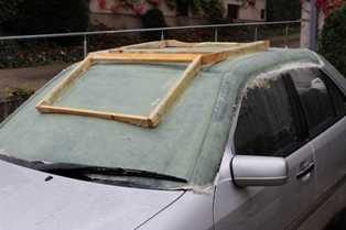

    First I made a mold from my dads car!
    It was really hard to get it off the car without scratches.

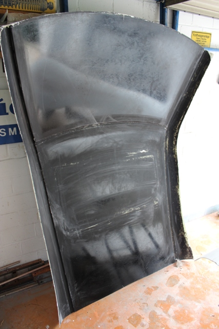

    Here the finished mold

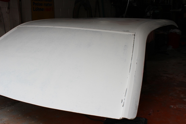

    The Roof is made from polyester
    If you want t know how this will work have a look on Youtube !

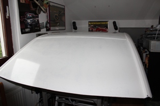

    Gives a real inside Feeling

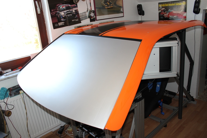

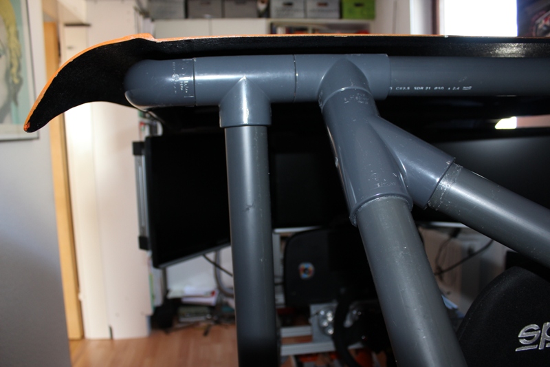

    The whole Roof is mounted on a rollbar made from PVC Tube
    It took approx. 25 hrs
    Total costs 200€
    Any questions?
    feel free to ask!
